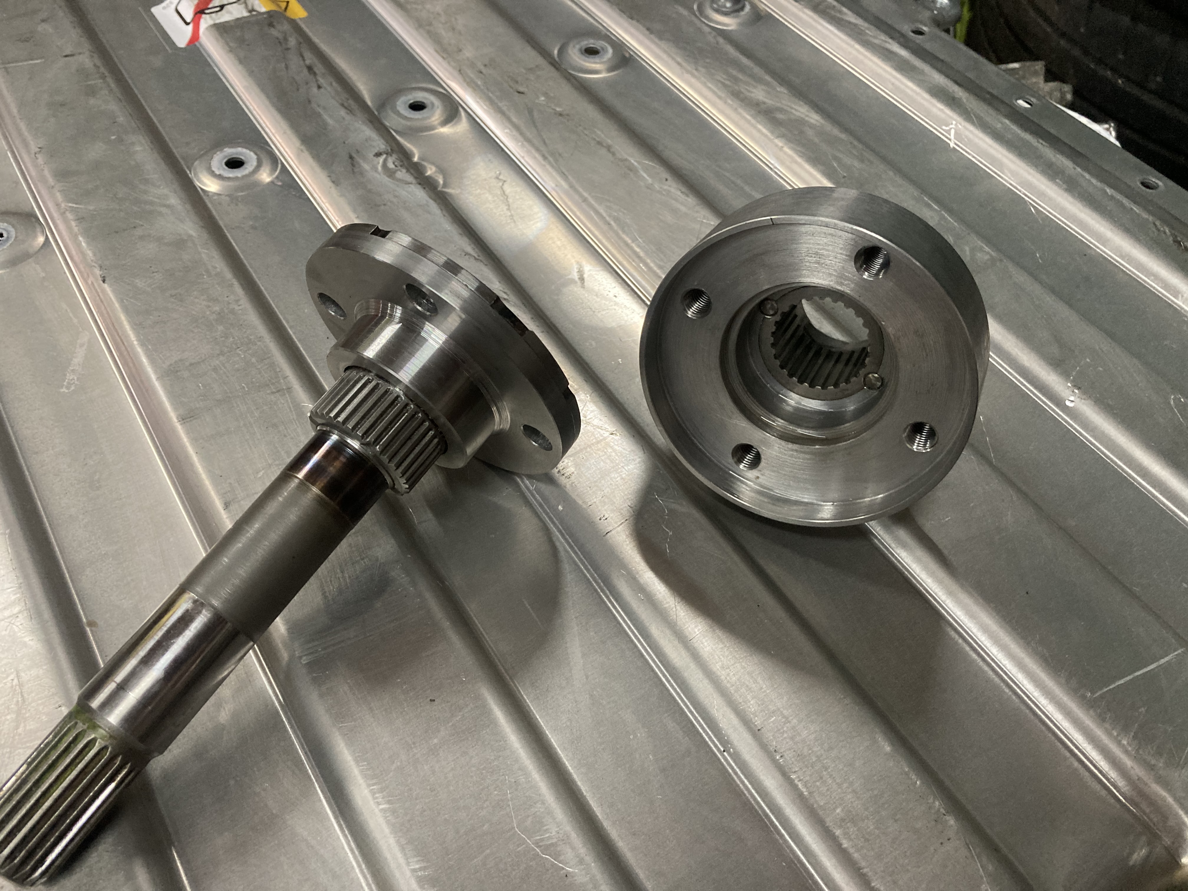

made v2 of coupler and adapter plate, test fit of adapter for a fellow vintage subi getting leaf swapped!
v1 coupler clutch splines deformation 😬 this was an aftermarket clutch. v2 coupler has a larger surface area of spline contact, and is a oem clutch center. so hopefully that helps
Leaf side splines look rock soild :)

Cool. time for 4wd drifts in the snow! New battery sounds like it’ll make a big improvement,
Are you able to make parts with external splines also? At some point I’d love to replace my home engineered parts with something more professional and less bits fitted together! It may not be cost effective though what do you think?

Ev8 wrote: Fri Dec 23, 2022 7:24 am Cool. time for 4wd drifts in the snow! New battery sounds like it’ll make a big improvement,
They are to much fun ;)
Definitely not cost effective for one off, your parts looks well done! Cutting splines is not as strong as cold rolled ones, which those most likely are. And for one off that would be the way to do it
