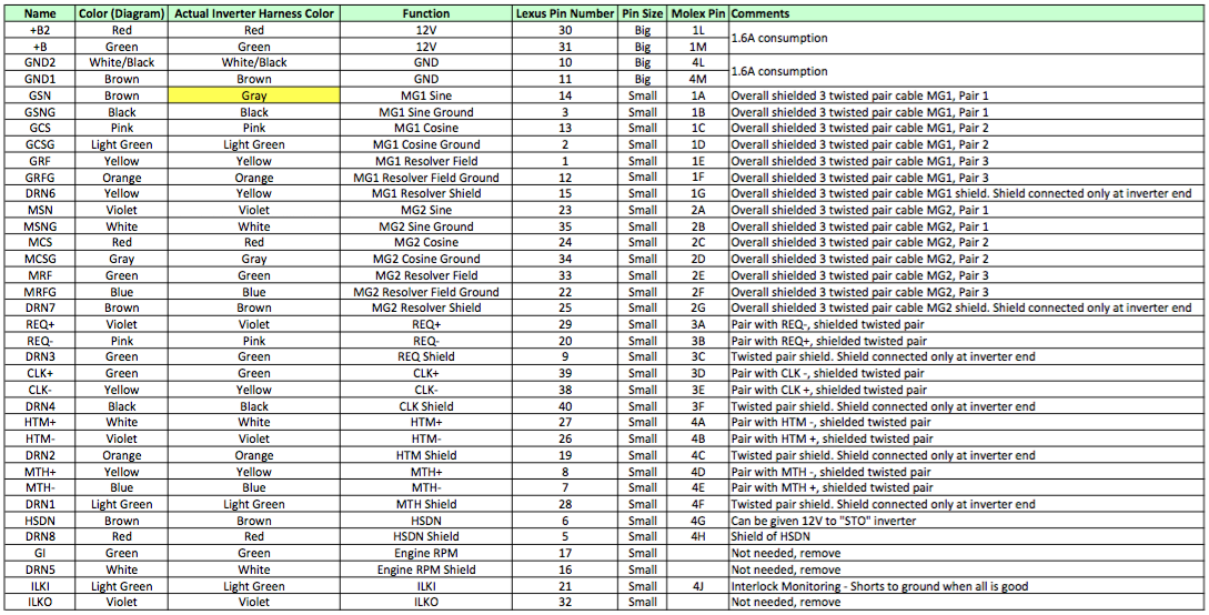

Hi Damien,
Just wondering if you realize that the pin numbers on the drawing of the Toyota 40-pin header are not the same as the numbers on the back of the header? On my header (on a 2010 Toyota Crown hybrid inverter, part number G9200-30070) pin 1 is where you have pin 32 and vice versa.
Please correct me if I'm wrong. It was doing my head in when buzzing out that internal loom!
I needed to buzz it out to check that the Crown inverter 40-pin header wiring was the same as that on the GS450h inverter.
As it happens, it is!
So with the internal looms and 40-pin header being identical, and the logic board part numbers of F1759-30010-01 being the same, can one assume that everything's going to work?
Also, pin 8 of the 32-pin connector on the GS450h inverter/converter internal connections drawing is missing its GND label.
ie. should read MG2 SINE GND.

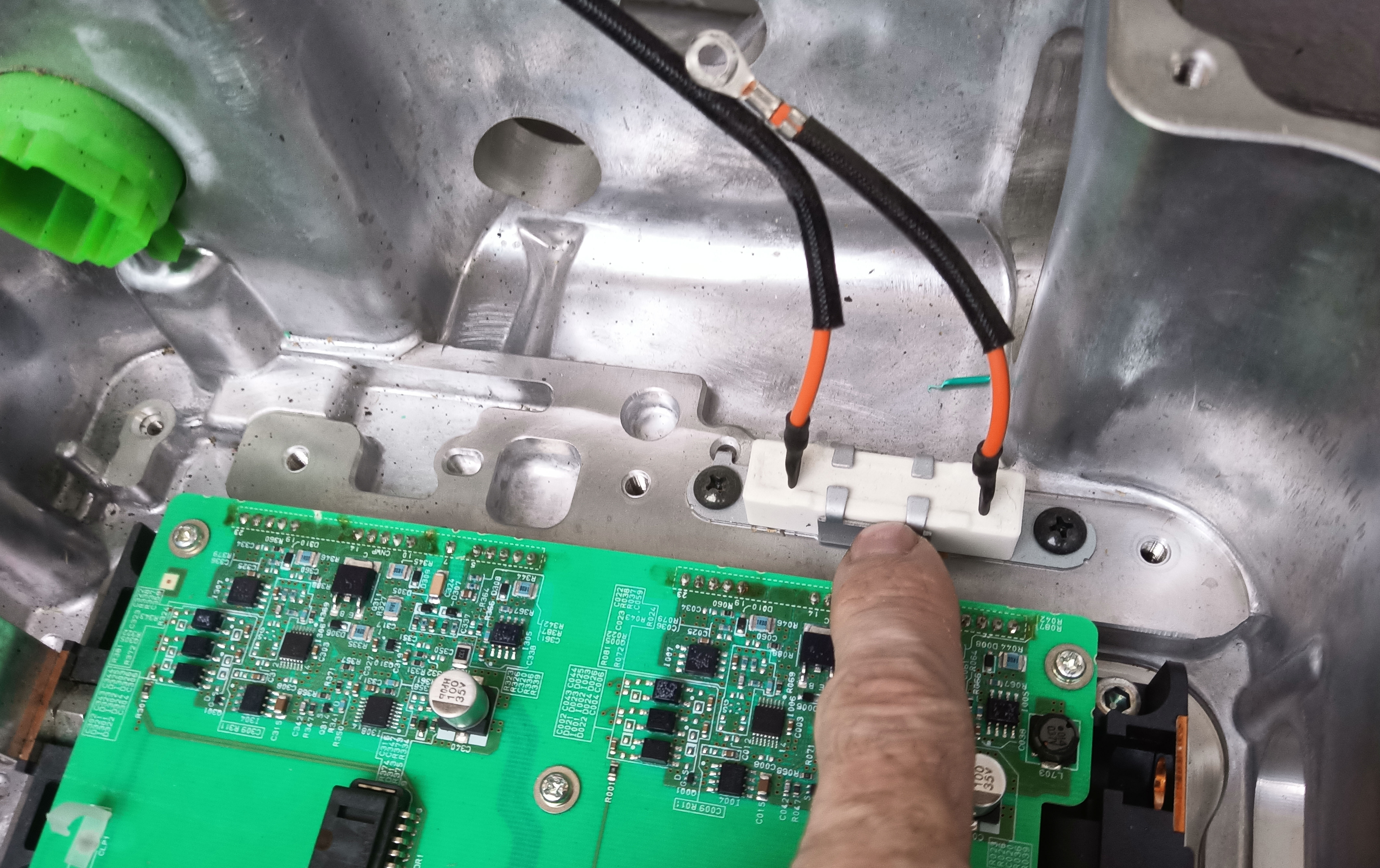

On my build the capacitors in the Lexus inverter are not discharging and even after 24 hours they are HOLDING HV VOLTAGE almost to the level of the battery pack i.e. 400 Volts. If I take a voltage reading, with the HV battery completly disconnected, at the terminals of the inverter I have just short of 395Volts.
As I understand it the inverter capacitors are supposed to discharge through the MG1 and MG2 connections to the GS450H Transmission.
Obviously not a great state of affairs!!!
I hope no one else has experienced this issue.
Any guidance regarding this would be really appreciated.

there should be a ceramic resistor at 15 kohm or so current connected at + and - high voltage. its purpose is to smoothly discharge the capacitor after disconnecting the battery. it's probably missing or not connected to you.
mg1 and mg2 motors are not involved here

hello. the link doesn't open for me. here is a photo for example, this is in the Nissan em61 inverter, but the same detail is in all high-voltage inverters of Toyota, Lexus, Tesla and others. one end of it is connected to the + and the other to the - high-voltage input in the inverter. when the main contactor is turned off, the voltage of the conductors will discharge to this resistor.dadiowe wrote: ↑Tue Oct 25, 2022 1:10 pm Hi Romale,

No, it doesn't discharge through MG1 or MG2. There is no mechanism for that. There is instead a ceramic bleed resistor inside the converter housing.dadiowe wrote: ↑Tue Oct 25, 2022 10:56 am On my build the capacitors in the Lexus inverter are not discharging and even after 24 hours they are HOLDING HV VOLTAGE almost to the level of the battery pack i.e. 400 Volts. If I take a voltage reading, with the HV battery completly disconnected, at the terminals of the inverter I have just short of 395Volts.

Thanks Romale that sorted my inverter discharge problemRomale wrote: ↑Tue Oct 25, 2022 1:16 pm hello. the link doesn't open for me. here is a photo for example, this is in the Nissan em61 inverter, but the same detail is in all high-voltage inverters of Toyota, Lexus, Tesla and others. one end of it is connected to the + and the other to the - high-voltage input in the inverter. when the main contactor is turned off, the voltage of the conductors will discharge to this resistor.
Hey guys, first post here. Been lurking a while and wanted to share the pinout I'm using for the Molex replacement inverter connector, I didn't see this documented anywhere so apologies if this has been covered before. If it looks good I'll add it to the wiki.
