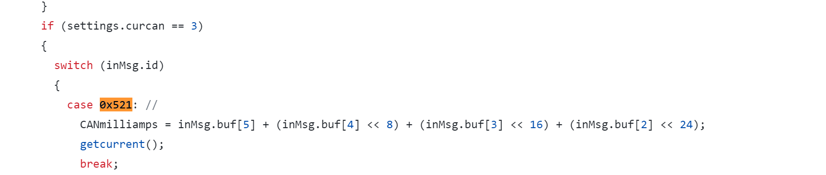

Hi Tom,
Sorry to keep taunting you with code errors.
I think i found another slip in the code. The IVT-S current sensor still not working.
Sorry it took me a while to verify the fix, im now fully buttoning up the car, i was away for a while since july, (out of the country, New Job, LIfe )
so i did flash the new Update that meant for fixing the can messages structure, still no dice from the can sensor, it reads ZERO.
before i dug into the code today, i verified that the sensor is spitting out the correct values, i hoked up the sensor alone to DUE can and indeed all the current values are coming out correctly, SO HW is OK.
I through lunch today at work i followed the code to understand how the current is calculated.
here is your fix where the can message is stored into CANmilliamps
then we jump into getCurrent(); function.
in this function CANmilliamps isnt used at all,
looking at previous and history revision, CANmilliamps should be shifted to RawCur then averaging and all the magic happen then the code proceed to caurrentact which the value is being reported everywhere.
so i think there is a step missing between the CANmiiliamp value and Currentact value.
i tried to make the code like historcally it was by adding
RawCur = CANmilliamps;
right after it gets is from the can value,
the reported current work but it was in the 1000 multiples so i reverted back and now im stuck.
appreciate your help. i try to resolve the coding before bugging you and hopefully reporting back with success but im out of ideas on this one.
i did actually find another issue and fixed it, plus added a balancing indicator in the screen.
i will post those updates when i finalize the work here.
thanks, Karim

Re: Simp BMS
Thank you for responding to this.
I have added this and cleaned the code some more, one thing to note the current sensor is running as "stock" I have not coded any of it.
CANmilliamps = (long)((inMsg.buf[2] << 24) | (inMsg.buf[3] << 16) | (inMsg.buf[4] << 8) | (inMsg.buf[5]));

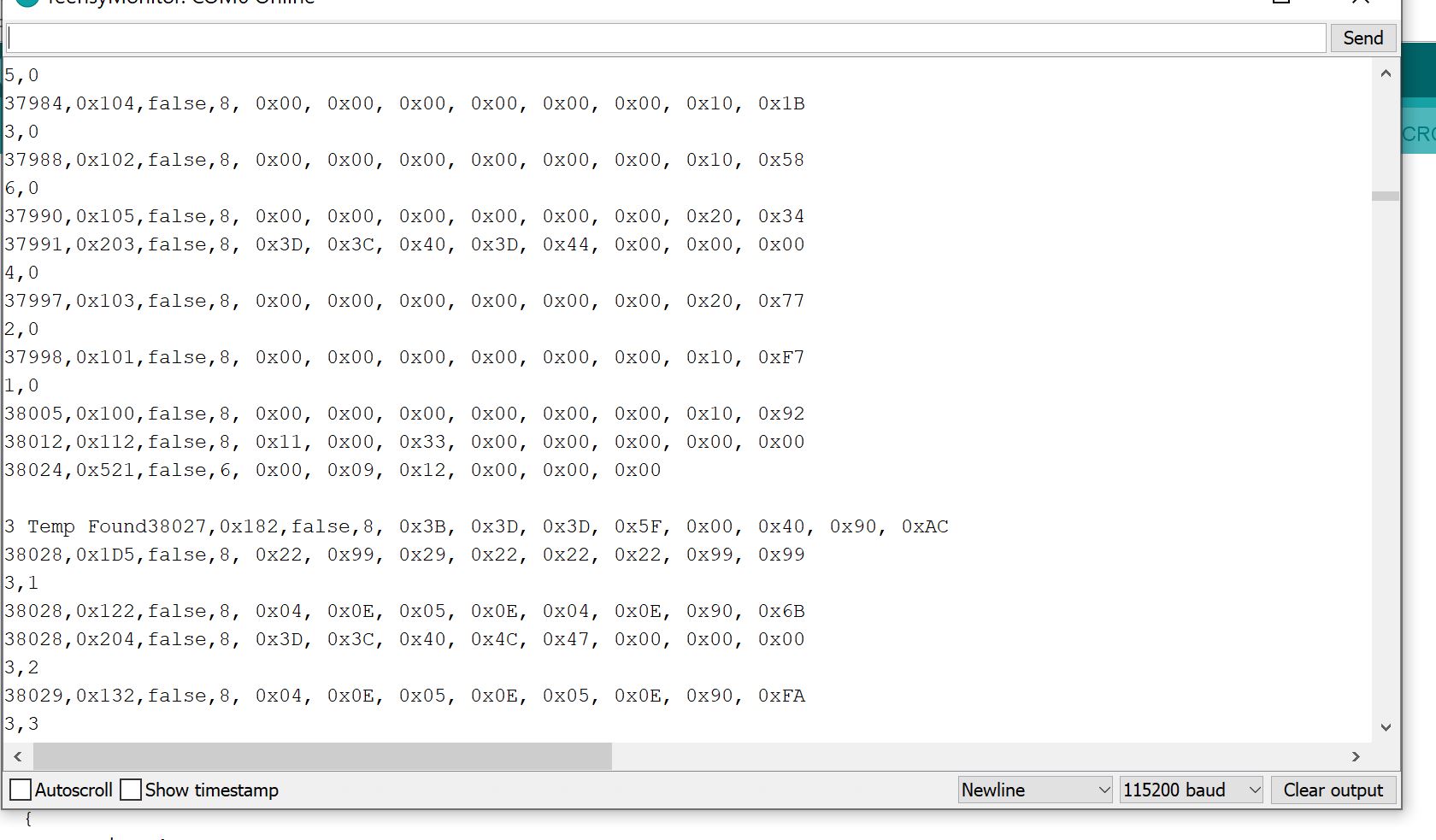

Re: Simp BMS
Hi tom,
Unfortunately the current garbage values still exist.
I added the couple of lines to my code and the problem still presisted,
then i decided to flash the hex file you uploaded yesterday to make sure it isnt my code and issue still there.
check the pictures i took from the debug.
that's the current sensor reporting on canbus, the current is really zero no flow going through it.
and this is the current debug and shows way big or garbage data.
i think RawCur and getcurrent functions are the trouble here,
will look at the code and hopefully i can catch the issue.

Re: Simp BMS
The standard broadcasting is defined the user manual for the shunt. so you need to see 0x521 for current.
I bench tested it, so the problem is on your end.
So if you do not see 0x521 on the canbus it wont work.

Re: Simp BMS
Hi tom,
Yes i agree and that's the very first thing i verified since last July when the problem started, and of course this week when the problem persist.
so if you see my attached picture sorry i didn't highlight the 0x521 but it is in the middle to lower end line but here it is highlighted in this one
the current sensor is reporting 0x521 all the way to 0x528 and is working fine. as well if i disconnect the current sensor from the network the garbage values stops.
meaning the 0x521 id is contributing to the issue.
i agree the problem might be on my end, but the current sensor and can network and 0x521 is out of the picture.
sorry to pick your brain on that. i will debug code and see where the problem might be.

- Posts: 2425
- Location: Bristol
- Has thanked: 209 times
- Been thanked: 578 times
Re: Simp BMS
Garbage probably due to you having set the byte value in reverse so its little endian as byte 2 contains something.
The standard message is Big Endian.

Re: Simp BMS
Hiya Tom,7yatna wrote: ↑Thu Oct 27, 2022 4:47 pm that what i actually was thinking. little vs big, i didn't intentionally do so but i will figure a way to reverse it![]()
so after all it is my current sensor being a square ??
haha sorry tom. will spend sometime reversing that then report back. need now to figure it out.
so here how i initialized that IVT-S Sensor,
I followed this wiki here on openinverter,
https://openinverter.org/wiki/Isabellen ... te_Heusler
and i got the correct Values as expected,
unless the libraries got updated and somehow the fix meant for addressing the little endian problem associated with arduino.
my senbsor is now configures as little endian ? if so is there away to tweak the in.msg buffer to get the correct information from the sensor without reinitializing,
have no idea how to reinitialize the sensor if this sketch is broken.
im trying this format hopefully it will work.
CANmilliamps = inMsg.buf[0] + (inMsg.buf[1] << 8) + (inMsg.buf[2] << 16) + (inMsg.buf[3] << 24);
CANmilliamps = inMsg.buf[5] + (inMsg.buf[4] << 8) + (inMsg.buf[3] << 16) + (inMsg.buf[2] << 24);

Re: Simp BMS
Hi Tom,
wanted to report back that indeed it was a little endian vs Big endian issue. i confirmed it by looking at the script code i used to initialize the IVT-S Sensor it was reading back in little endian.
so after adjusting the SimpBMS to little endian, All is good and i have fully working system.
over the weekend i did the first full charge cycle on the pack. current is reporting Ok both ways, Balancing is active and with my little modified code it can report on the screen if it is balancing or not.
