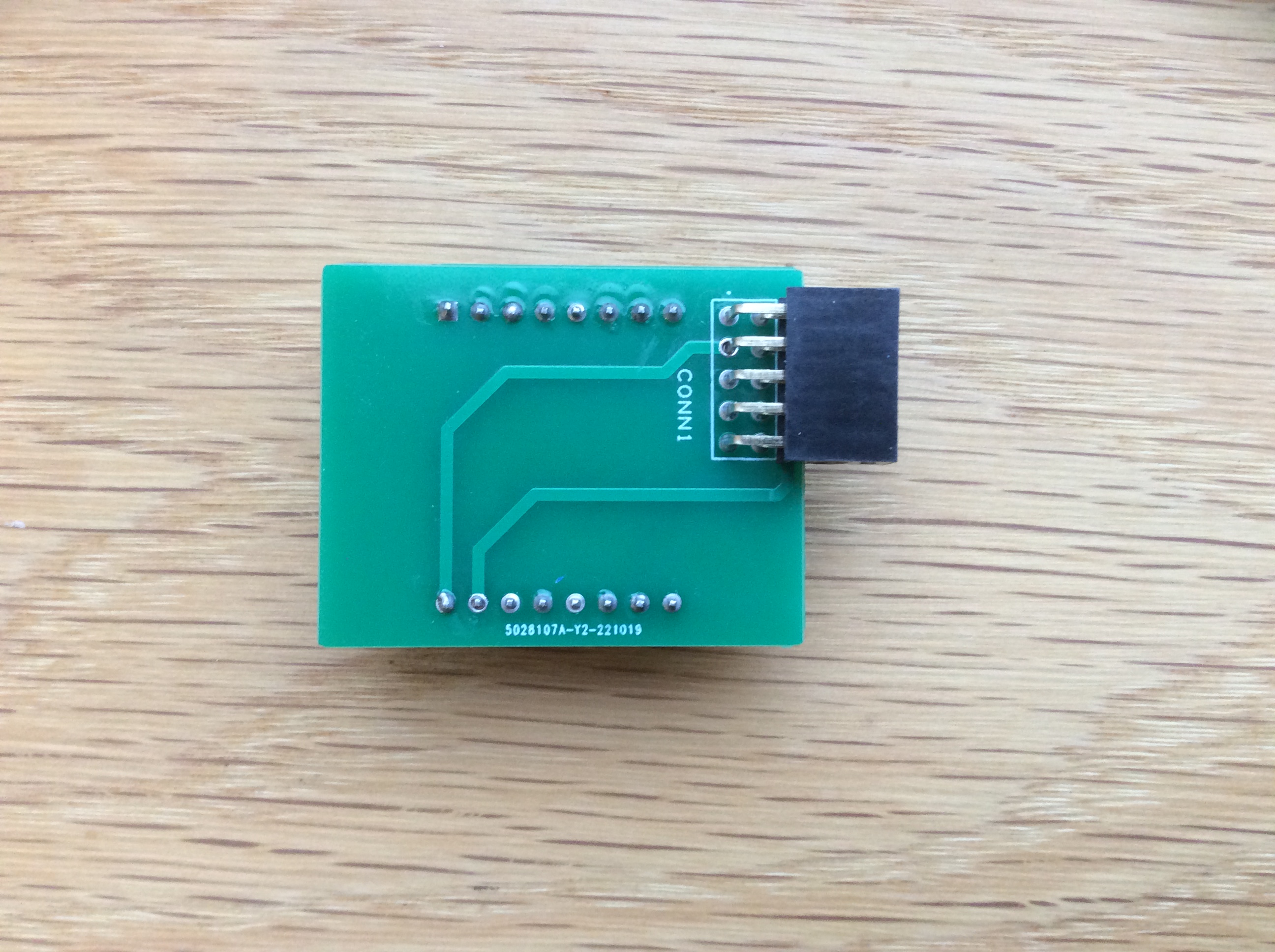

Re: ZombieVerter VCU Support
I’ve built up my Wemos WiFi adapter board. As Damien says it’s quite straightforward. The only thing to watch is that the back of the mini USB port doesn’t short the connector pins. For the 10 pin connector I used item 613010243121 from Mouser.
