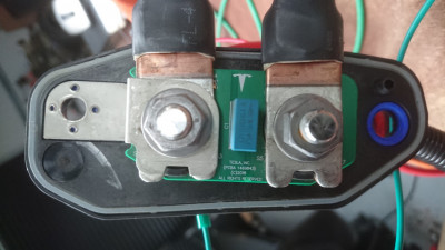

Have another question about one of the error codes also. Looks like I keep getting error: 38claFaulted but I can't seem to find an explanation of what this error is?
I suspect this is to do with the 12V side and possibly to do with a poor quality 12V battery. When I connect the charge cable, DC-DC starts up and the web interface reports system is putting out the required 14V. After a short period, a high pitched whine starts at low volume and gradually increases over a period of 5 to 10 seconds, before stopping...a few low volume clicks, quiet, and then the cycle starts over again. Refreshing the web interface during this shows the DC-DC shuts off, and restarts. This seems to be coming from the small PCB behind the 12V terminal block from the PCS (as in the pics below)

These Olimex wifi modules seem to be getting worse. I am working on that in parallel. Regards activating the DCDC in drive....ooops! Genius here forgot about that one:) Leave it with me a few days. I'm not up on every fault in the pcs but claFaulted is indeed generated by the DCDC so a different 12v battery would be my first port of call. What do your DCDC temperatures look like?

Those temps are fine. Never needed different voltages myself but it would be easy to add a "DCDC DriveV" param if folks want?
