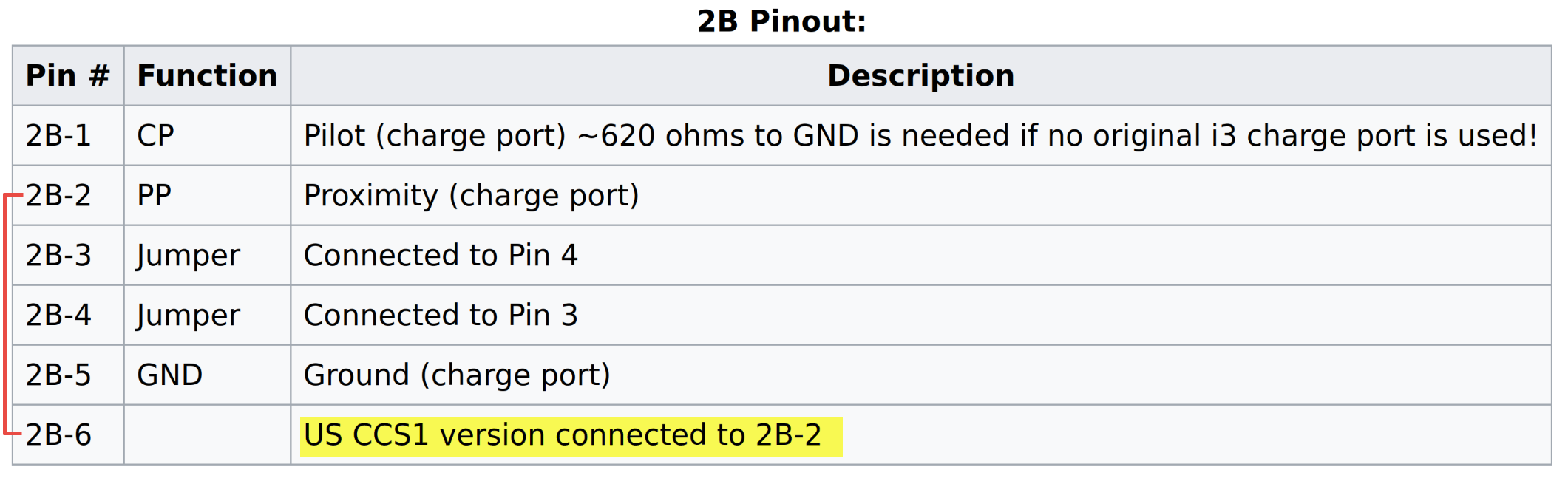

I paid attention to it. I bought the lim together with wires and a conectors. Do I need to put an additional jumper between 2 and 6? Because now there is no connection.

As I said, on EU models, pin 6 remains open and proxi is connected to pin 2, on US models proxi is connected to both, pin 2 "and" 6.

Eltis wrote: Tue Nov 08, 2022 1:57 pm Do I need to put an additional jumper between 2 and 6? Because now there is no connection.
https://openinverter.org/wiki/BMW_I3_Fast_Charging_LIM_Module#Connectors_and_Pinouts
If your LIM was sourced from a US-coded vechicle, very probably you will need to jumper 2B-2 to 2B-6.

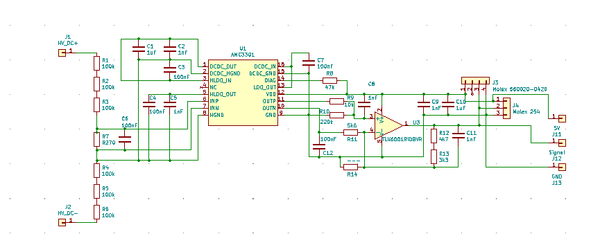

Hello. Is there an error in the voltage meter circuit? By connecting the polarity of the power supply TLV 6001 ?

Eltis wrote: Sun Nov 13, 2022 12:15 pmSensing.png
There are different types of TLV6001. With the "R" version, pin 5 = V-, pin 2 = V+. Without "R" it's the other way around. With the "U" version, the inputs and outputs are different.

Post by Eltis »
muehlpower wrote: Sun Nov 13, 2022 2:21 pm There are different types of TLV6001. With the "R" version, pin 5 = V-, pin 2 = V+. Without "R" it's the other way around. With the "U" version, the inputs and outputs are different.
Thank you.
is it possible to install id instead of rid? By changing the polarity of the power supply?

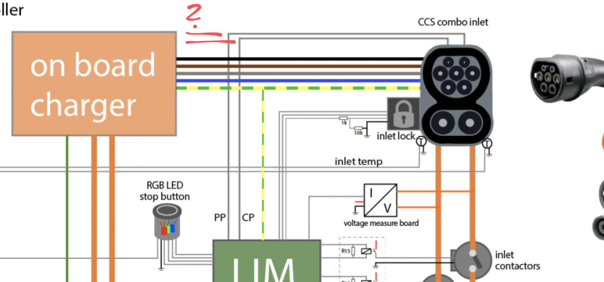

larsrengersen
Posts: 145
Has thanked: 10 times
Been thanked: 28 times
Post by larsrengersen »
Zapatero wrote: Fri Nov 25, 2022 11:56 am If I use an onboard AC charger that wants the CP and PP contacts, too, can i just connect them parallel to the LIM?
It's already in there
It is not possible to have two car-side charge controllers connected to the pilot line simultaneously. It is recommended to control the charger by CAN bus. If your charger needs the pilot signal, you will have to emulate it or switch the pilot connection wiring over to the active charger during AC charging.

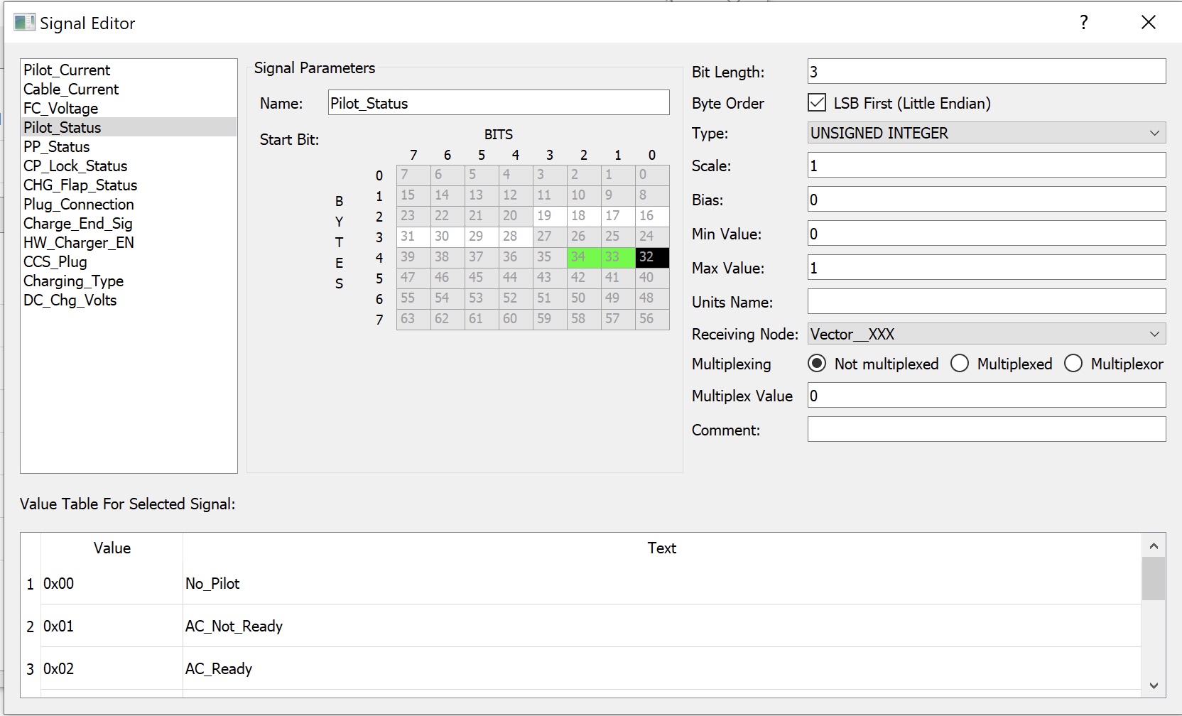

If I decide to switch CC and CP signal with a relay, what would be the indicator for the relay to know if it's open or closed. Which signal can i use to recognize if a Type2 or CCS plug is plugged in?
larsrengersen
Posts: 145
Perhaps there are other ways too, but I'd look at CAN message 0x3B4 from the LIM and within that at the Pilot_Status.
As soon as that becomes 0x01 AC not Ready or 0x02 AC Ready you know the LIM has detected a PWM signal at the CP line that corresponds with AC charging.
