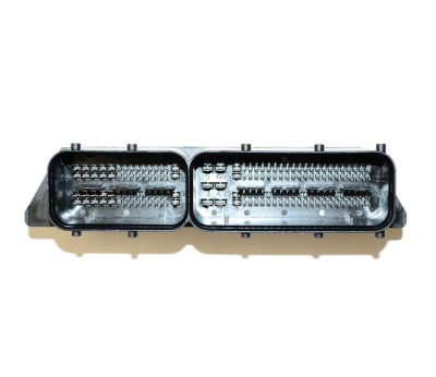

As my daily job I work on a lot of vw, Audis, this ecu connection is common on most vw/Audi/seat/Skoda stuff around 2004 onward mostly found on stuff with the Bosch edc17 family and Siemens vdo 5wp4 of ecu but I think there are some others that share the same connector, can’t think what from memory, but yes pin mapping does vary a lot
Re: Show your ECU connectors
Also used on some Korean cars, either the full plug, or just the smaller 60 pin, with the 94 pin left pin-less
The later Porsche sdi3+ ECUs use a similar plug, although slightly different layout (Still 154 pins, but large pins are in different places with a 58/96 pin plug layout)
That version is also used on the Ford Focus 2016+
I think porting ZombieVerter is worthwhile. I'm actually half done porting it to the 154 pin Porsche/Ford connector, using a ecu case from the Focus.

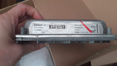

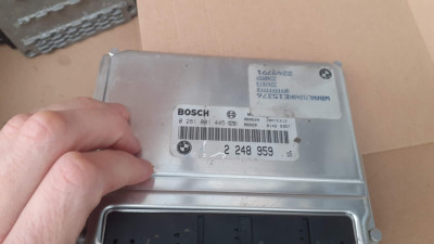

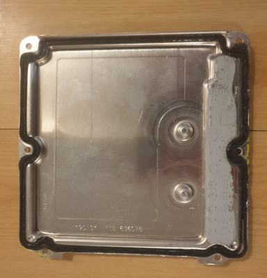

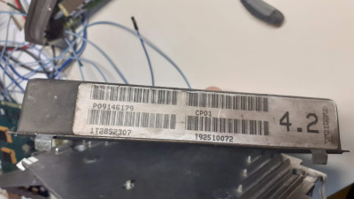

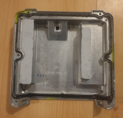

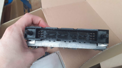

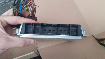

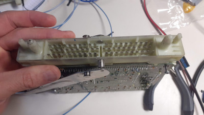

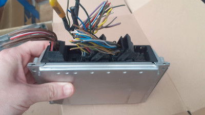

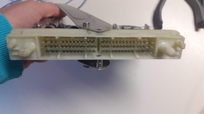

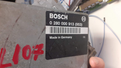

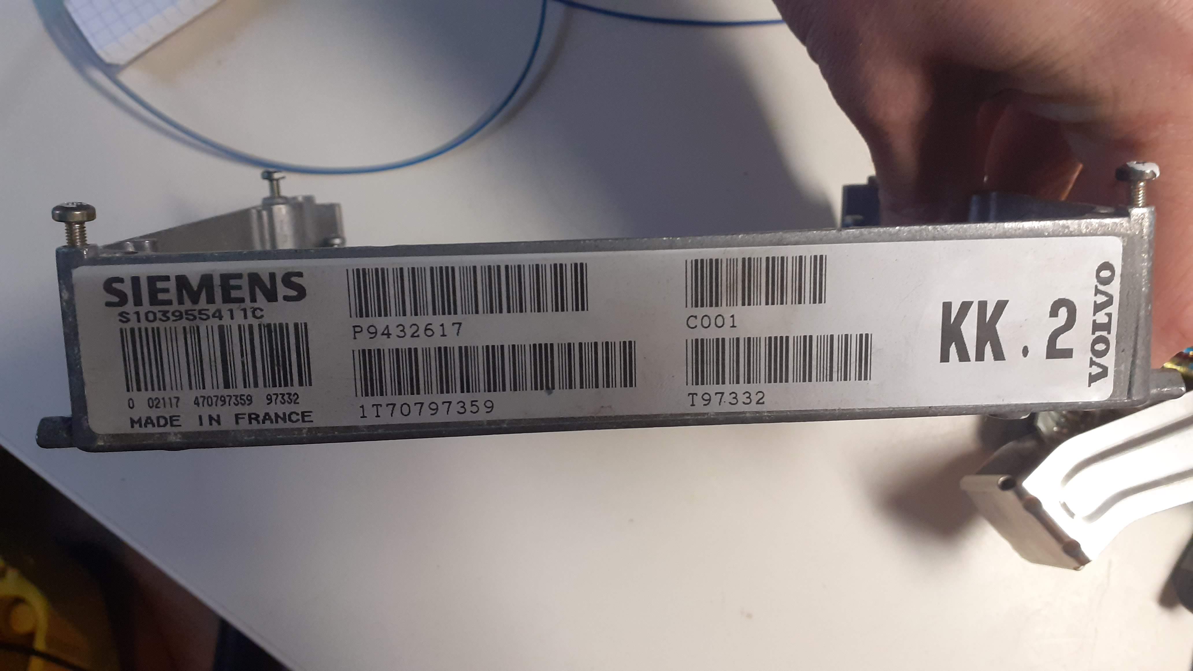

ECUs? Yeah I got me some of those...
Volvo XC70 I: BMW E46 320d (BMS46): Streber42 and I did some research on the BMW E46 ECUs and the pinout is wildly different, even though they come in similar (or identical) cases.
Volvo V70 I: Volvo 850 (Fenix 4.2):
