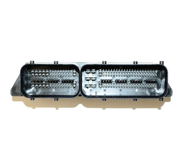

As you may know from my project threads I like to reuse the existing ECU enclosure, connector and wiring loom for VCU tasks.
I noticed that the Audi and Touran use the identical Bosch 154 way connector (https://www.tuningtechnology.net/ecu-he ... -connector). Pin mapping seems to be all over the place though, even between variants of the Audi A2: https://openinverter.org/wiki/Audi_A2_Conversion
Talked to Damien about this and we were wondering how common that Bosch connector is and whether it might be worthwhile porting ZombieVerter to it.
Can you post some pictures of your cars stock ECU, better still with pin mapping?

As my daily job I work on a lot of vw, Audis, this ecu connection is common on most vw/Audi/seat/Skoda stuff around 2004 onward mostly found on stuff with the Bosch edc17 family and Siemens vdo 5wp4 of ecu but I think there are some others that share the same connector, can’t think what from memory, but yes pin mapping does vary a lot

Also used on some Korean cars, either the full plug, or just the smaller 60 pin, with the 94 pin left pin-less
The later Porsche sdi3+ ECUs use a similar plug, although slightly different layout (Still 154 pins, but large pins are in different places with a 58/96 pin plug layout)
That version is also used on the Ford Focus 2016+
I think porting ZombieVerter is worthwhile. I'm actually half done porting it to the 154 pin Porsche/Ford connector, using a ecu case from the Focus.

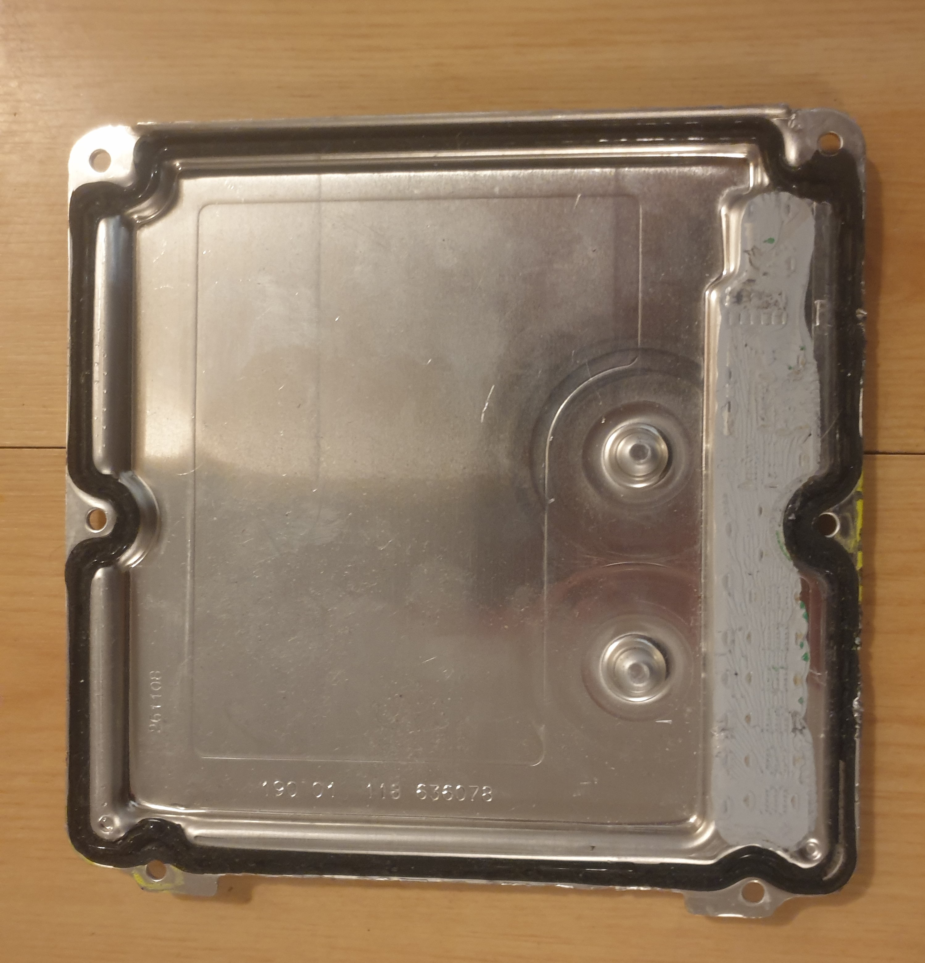

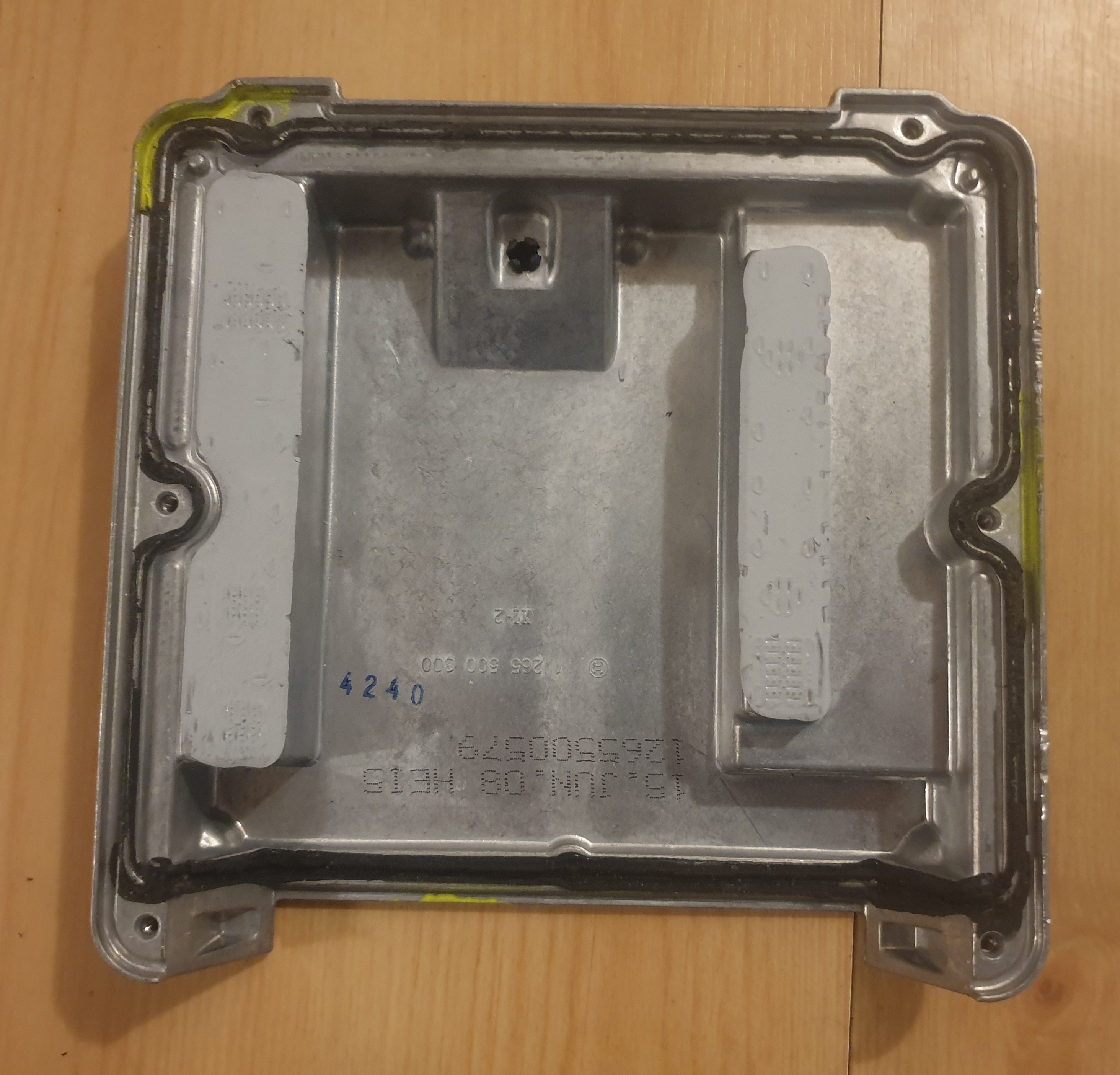

I intend to use the original housing from a second ECU I bought on ebay.

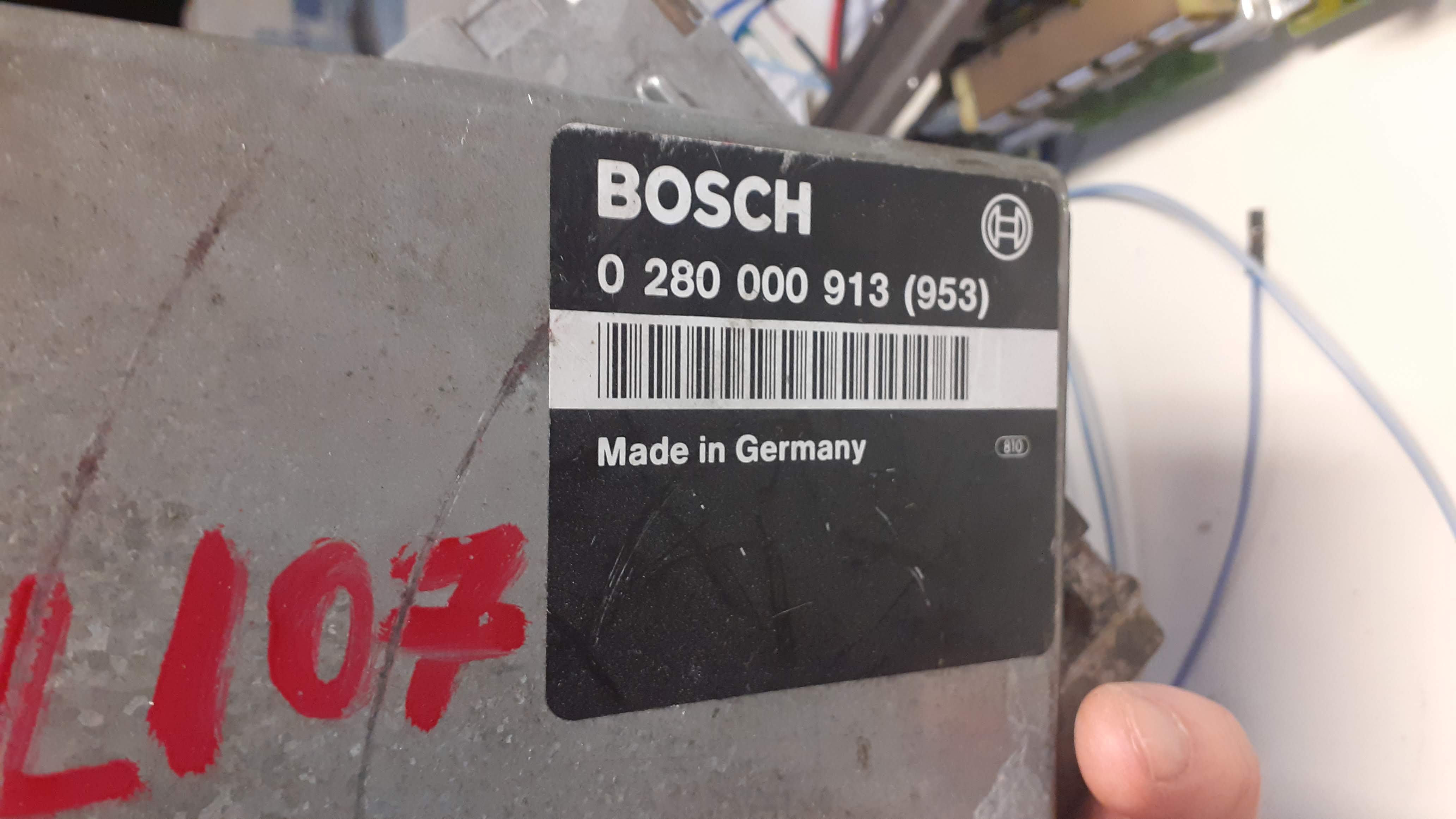

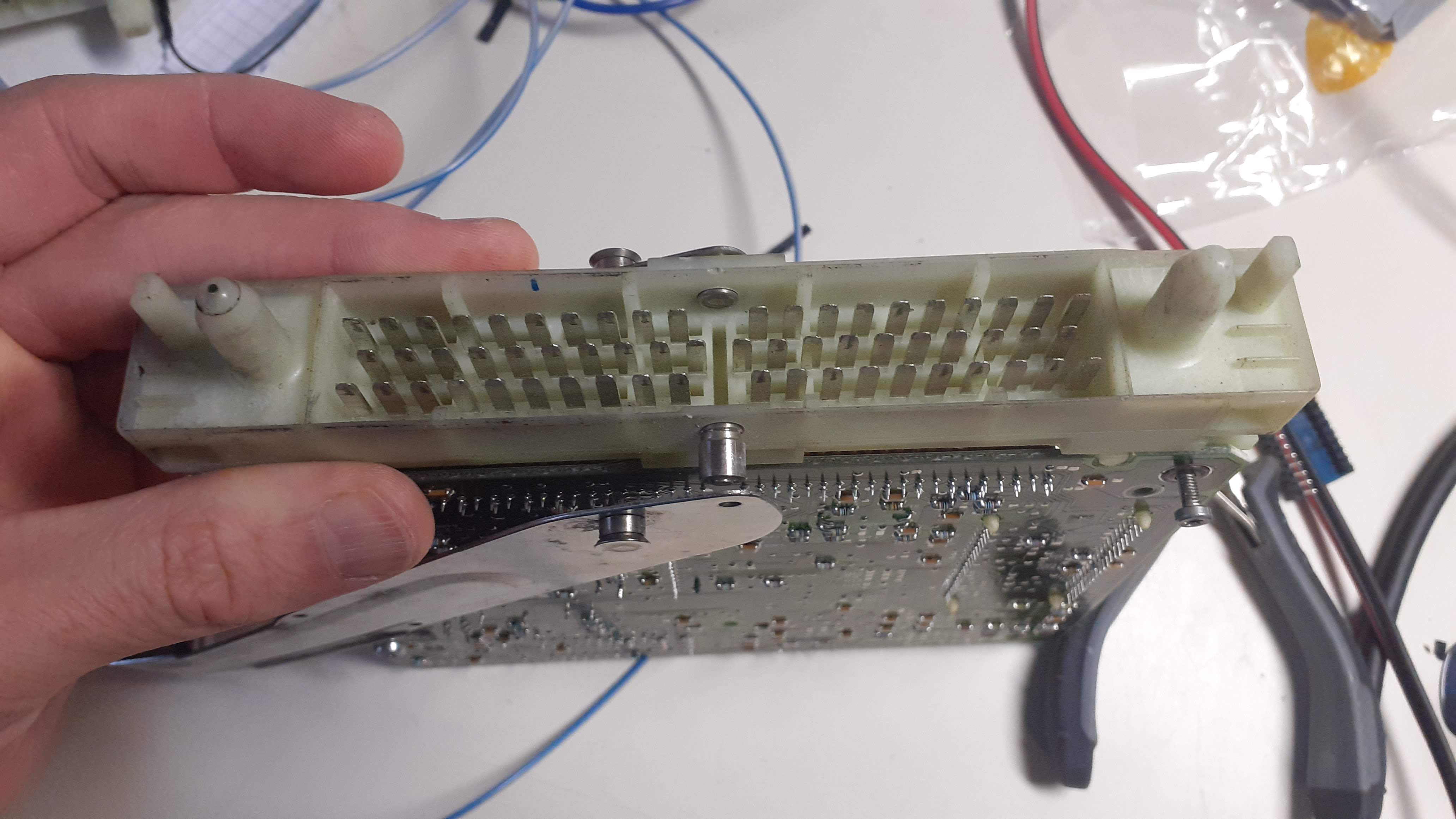

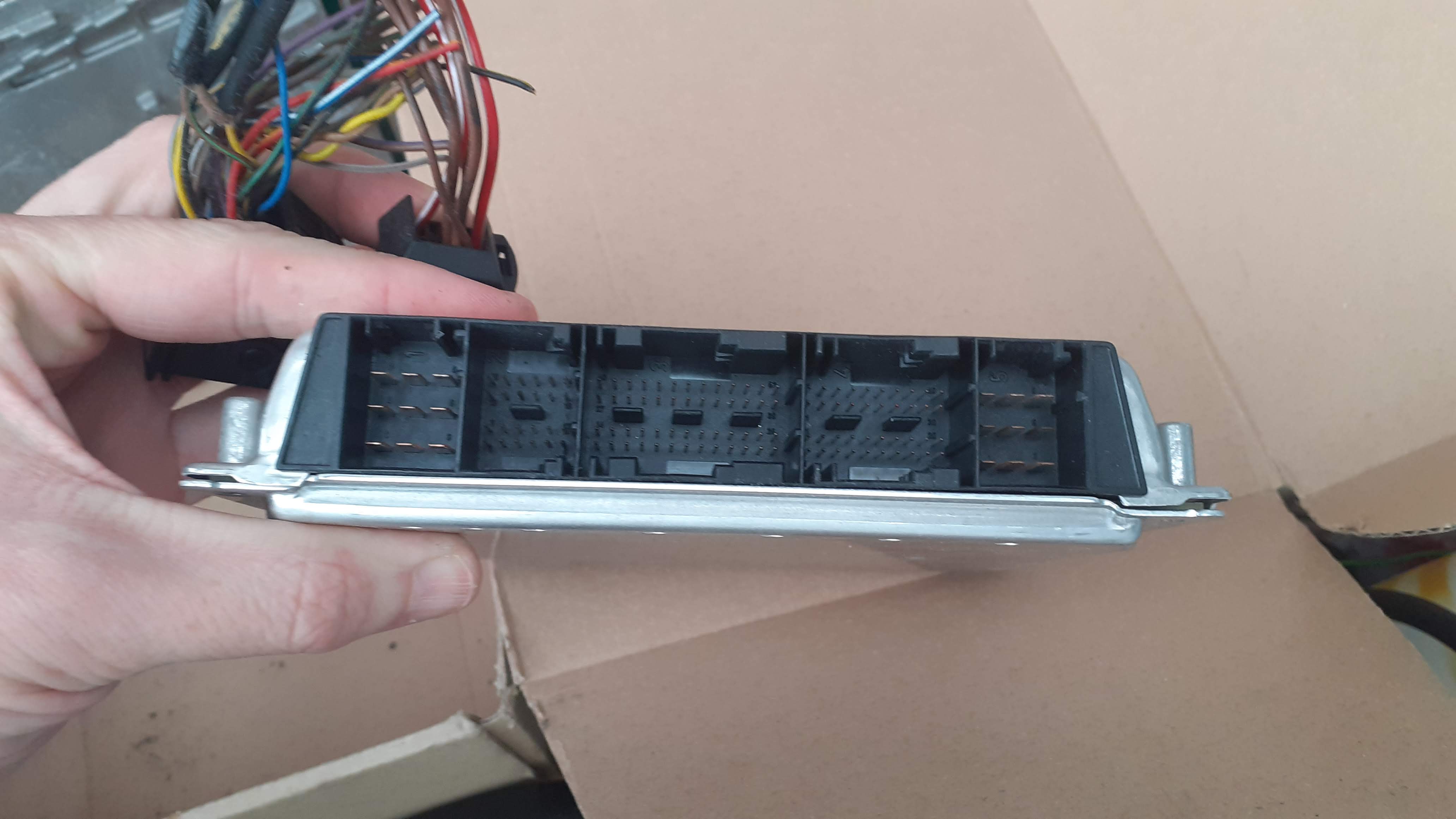

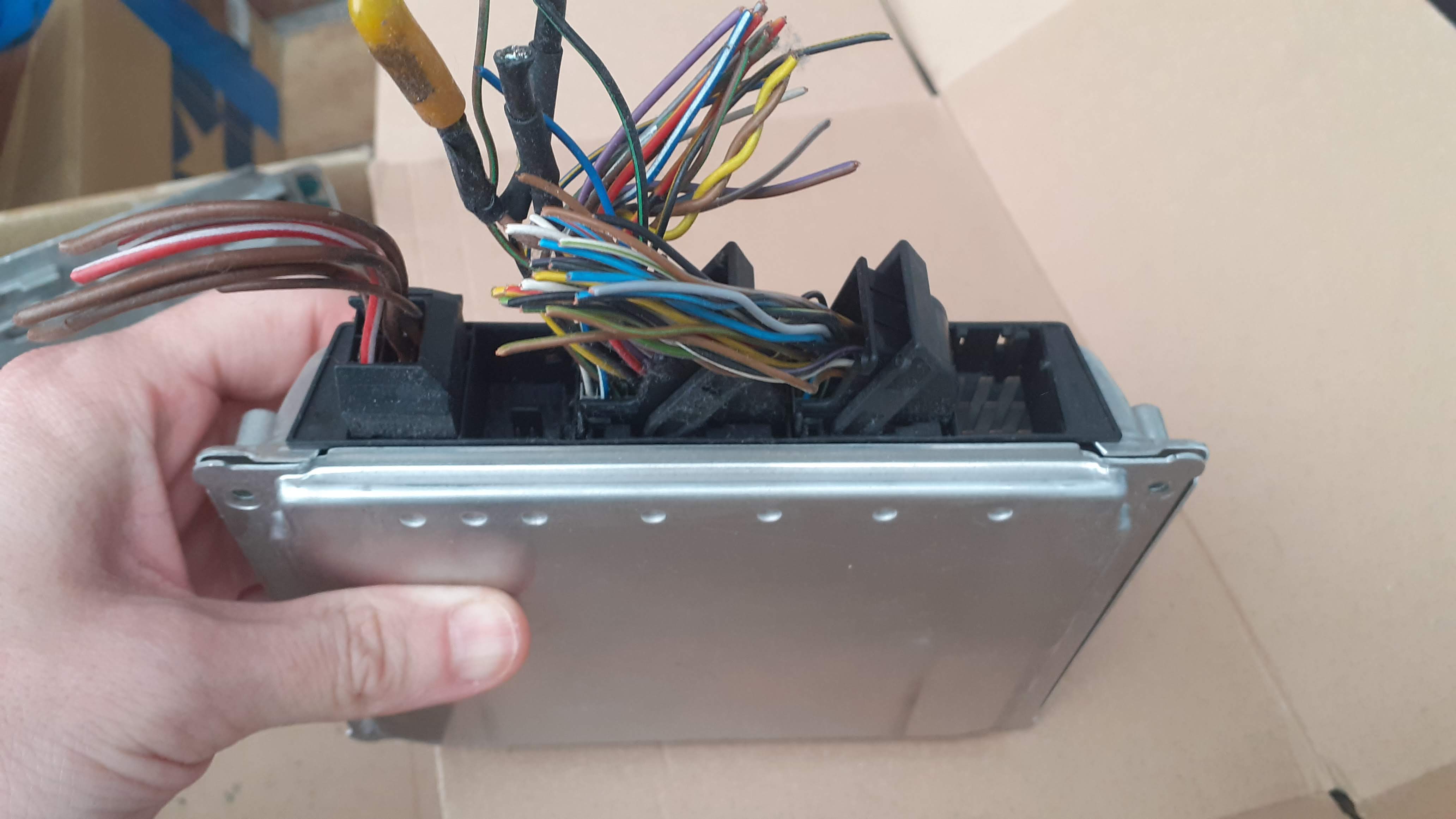

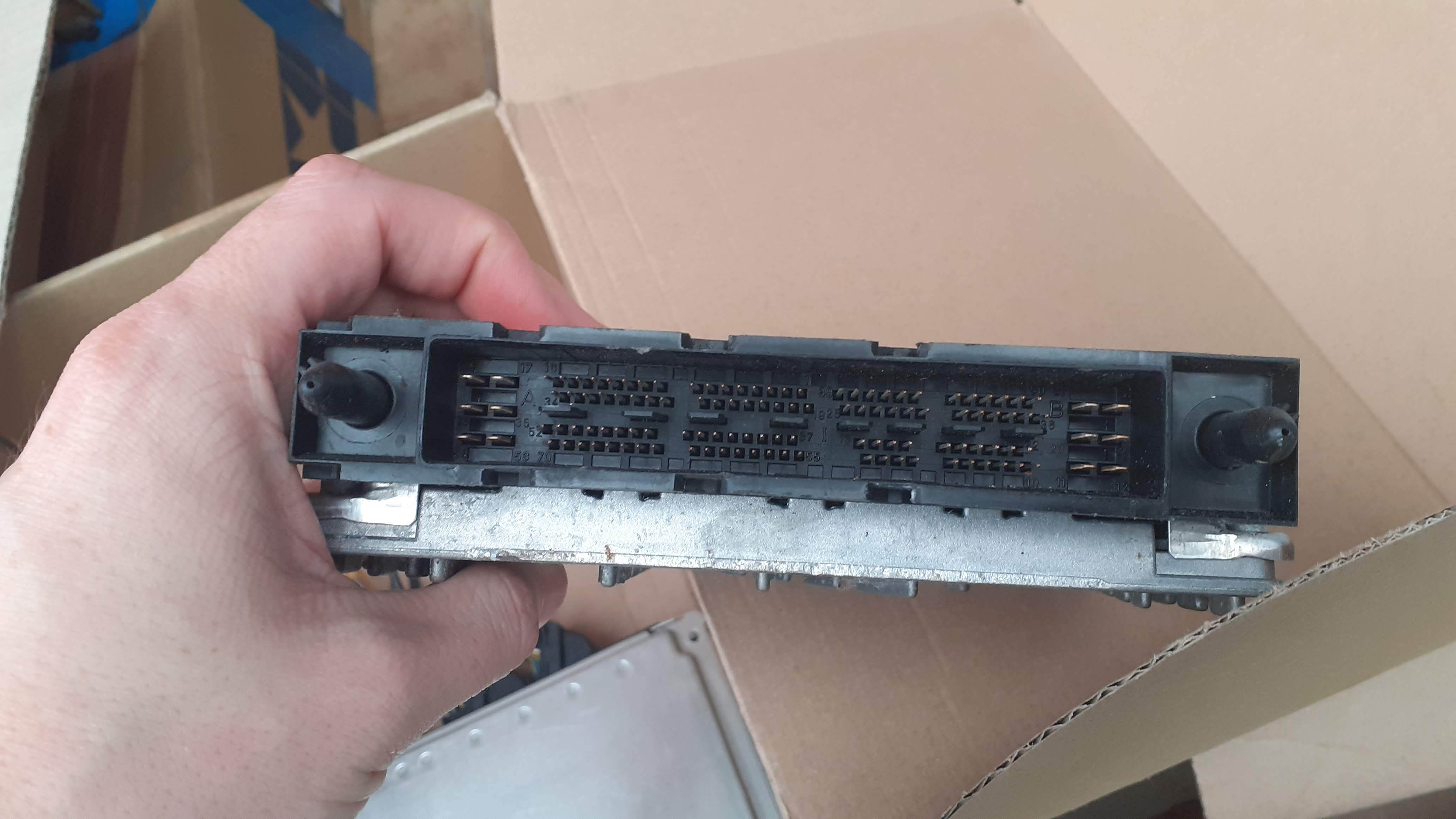

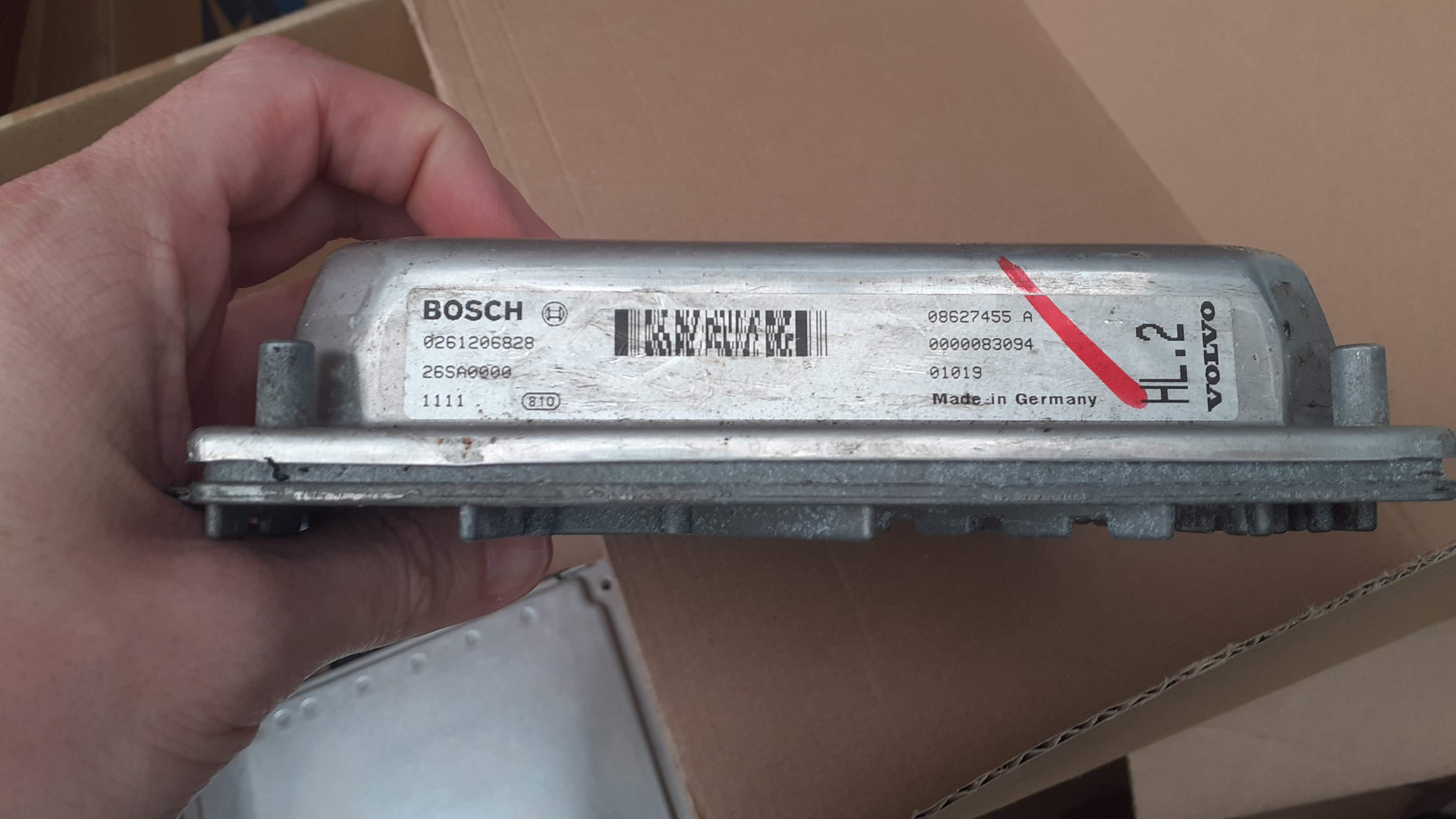

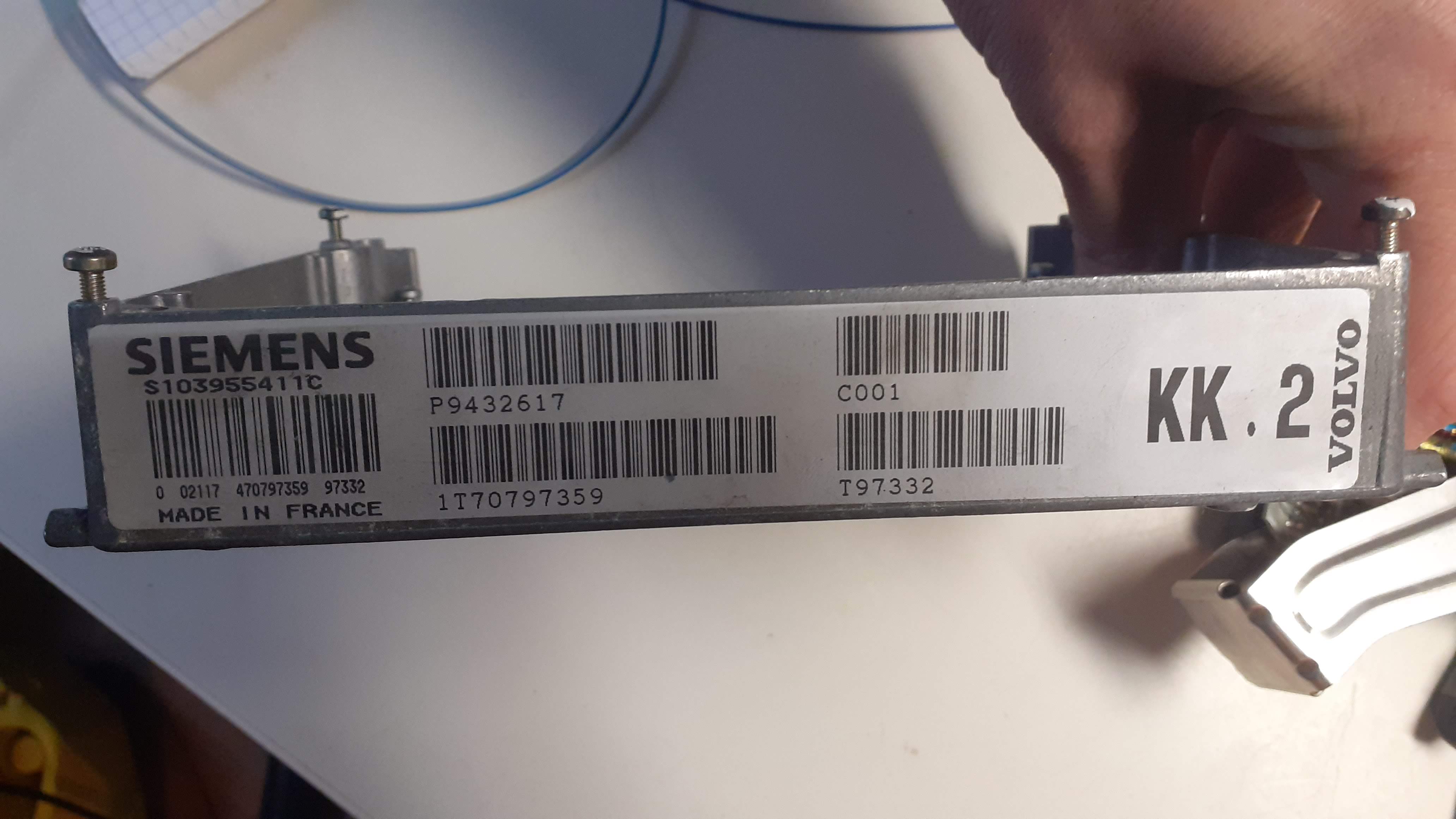

ECUs? Yeah I got me some of those...

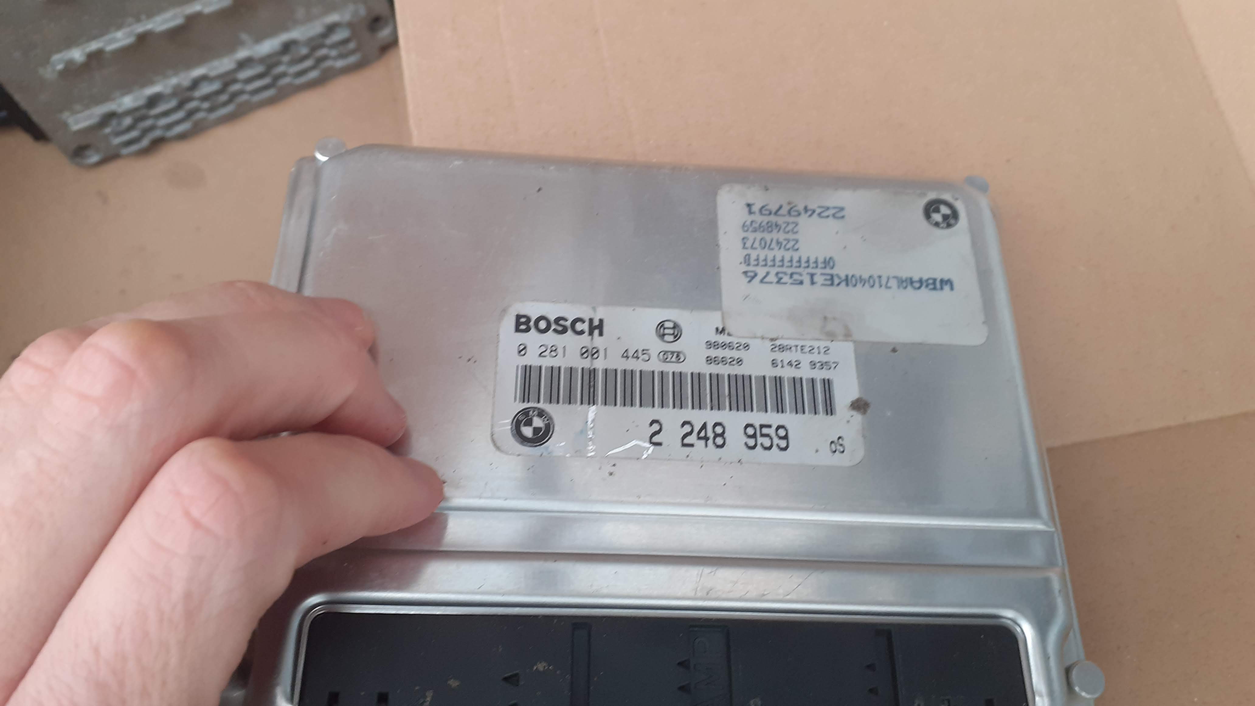

Volvo XC70 I: BMW E46 320d (BMS46): Streber42 and I did some research on the BMW E46 ECUs and the pinout is wildly different, even though they come in similar (or identical) cases.

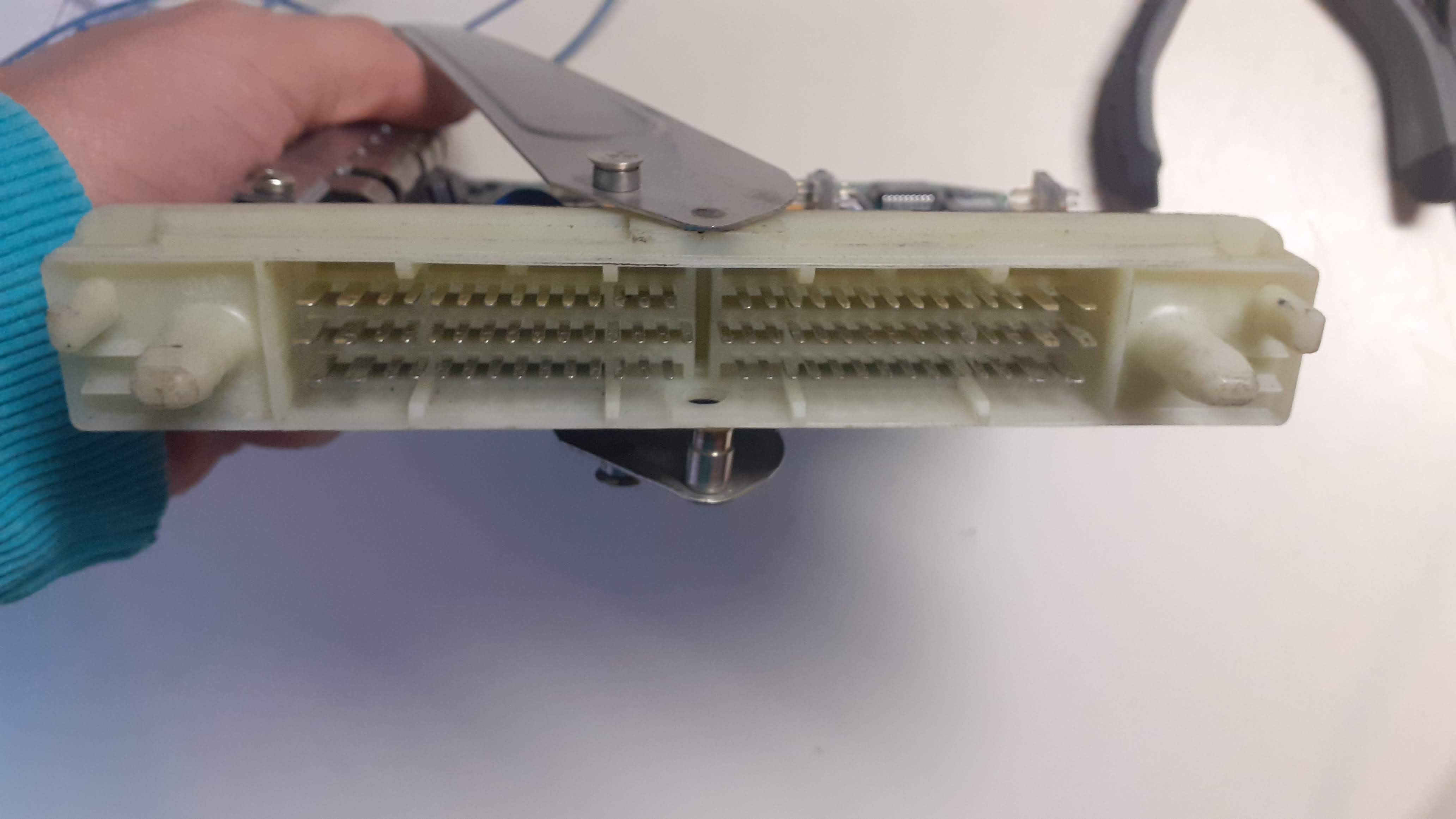

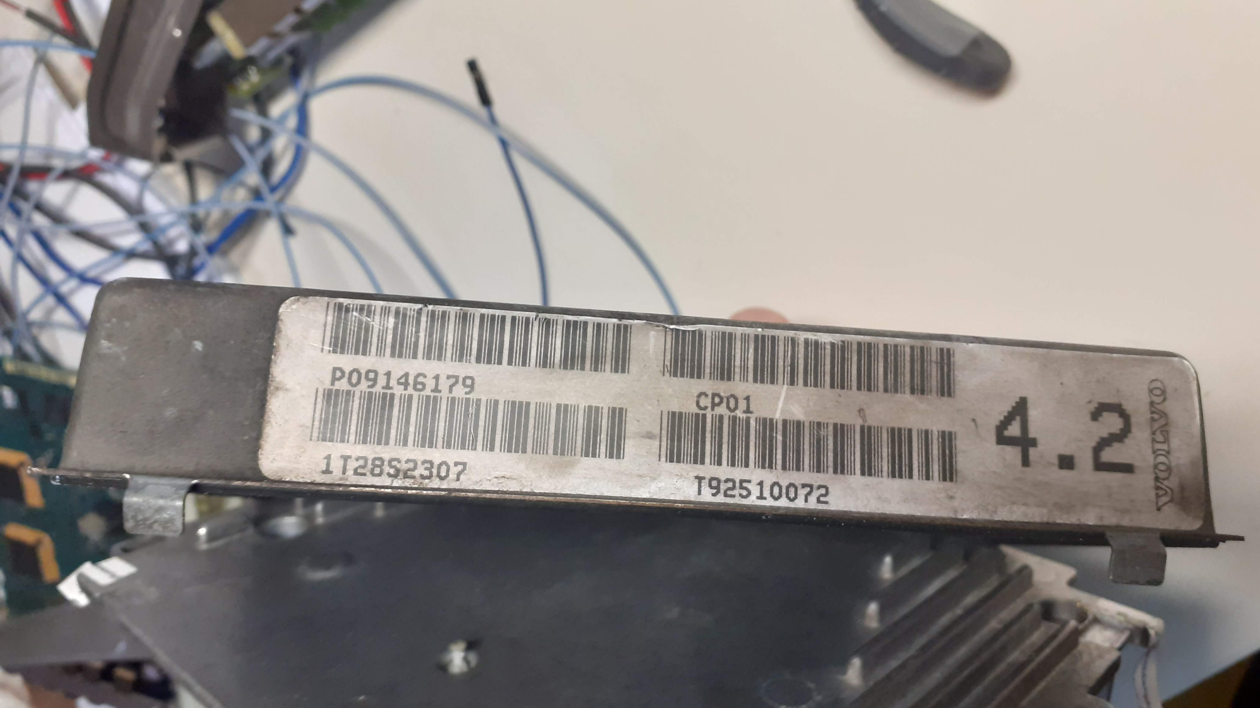

Volvo V70 I: Volvo 850 (Fenix 4.2):
