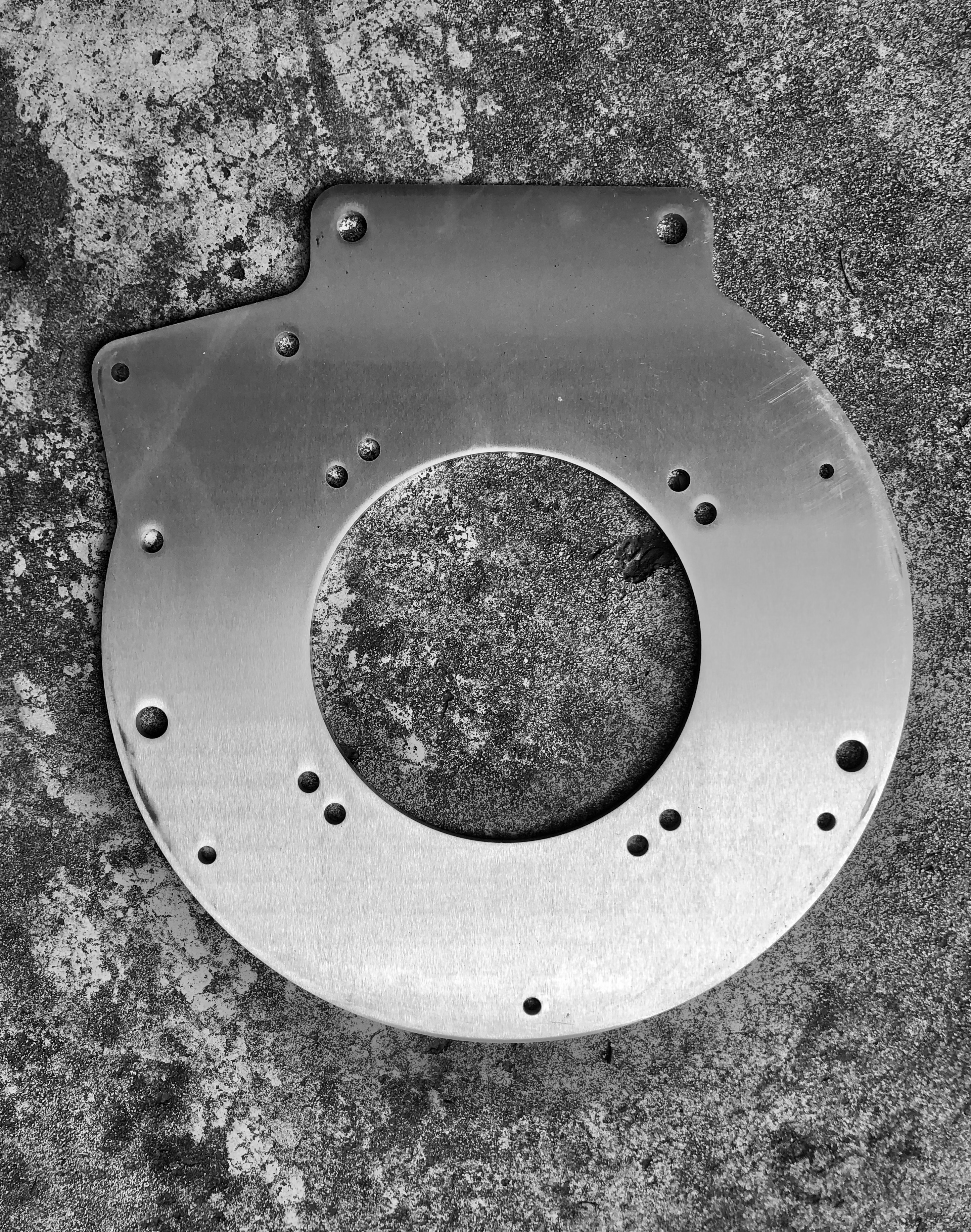

i received part of a bmw gearbox bellhousing bolt pattern. i did not measure it myself, so I can not vouch for accuracy, but i have this so far. files on github.
https://github.com/bratindustries/adapter-plates

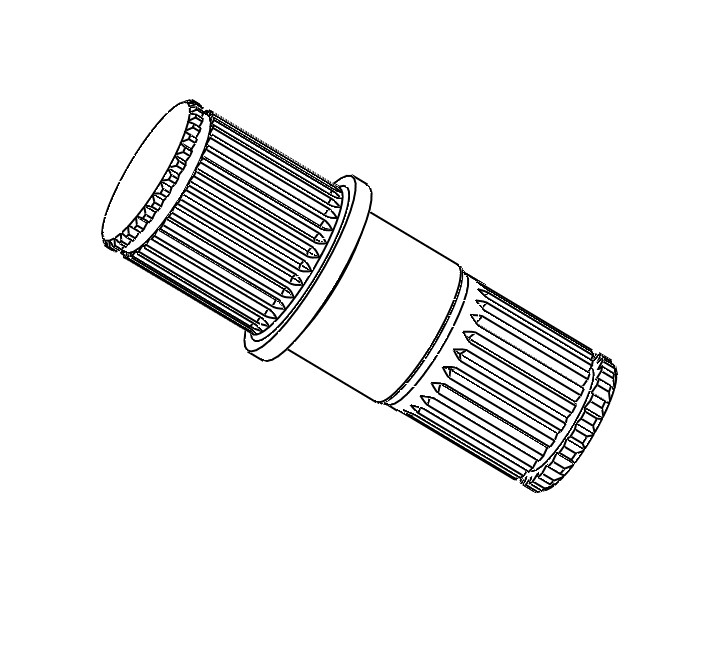

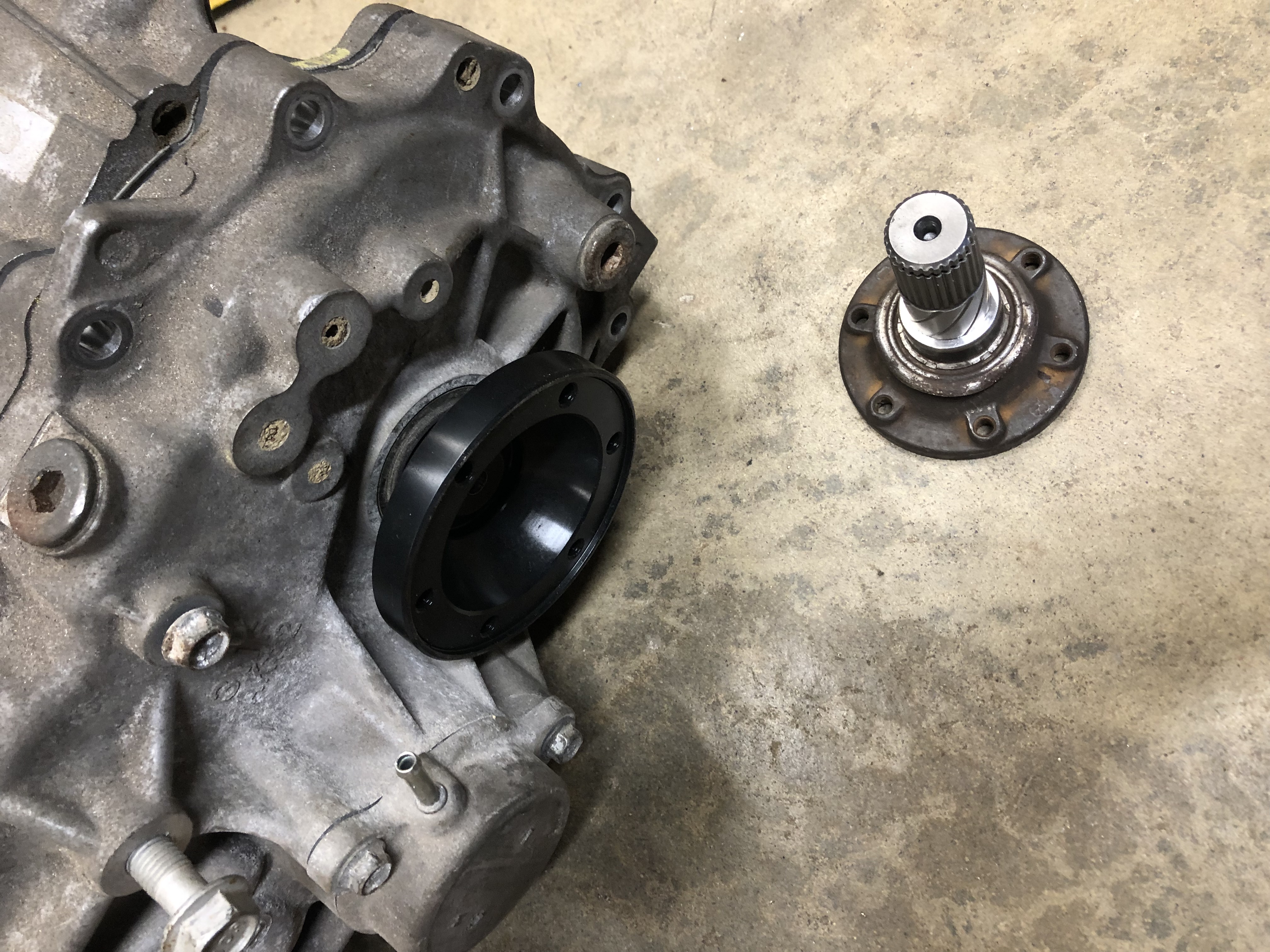

yew! finally the outlander rear motor drive shaft adapters are done!
33vw beetle spline on the outer end, so works with stock 90mm beetle flanges, as well as EMPI 100mm and 108mm(930) conversion flanges (some minor shaving of the motor case is required for the larger flanges to fit on the motor side)
cold rolled out of 4140 chromoly steel, so they are stronger than the stock outlander stubs.
available in the webshop https://bratindustries.net/product/outl ... -adapters/

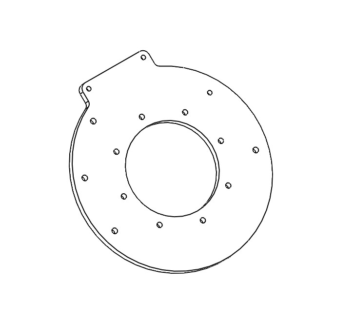

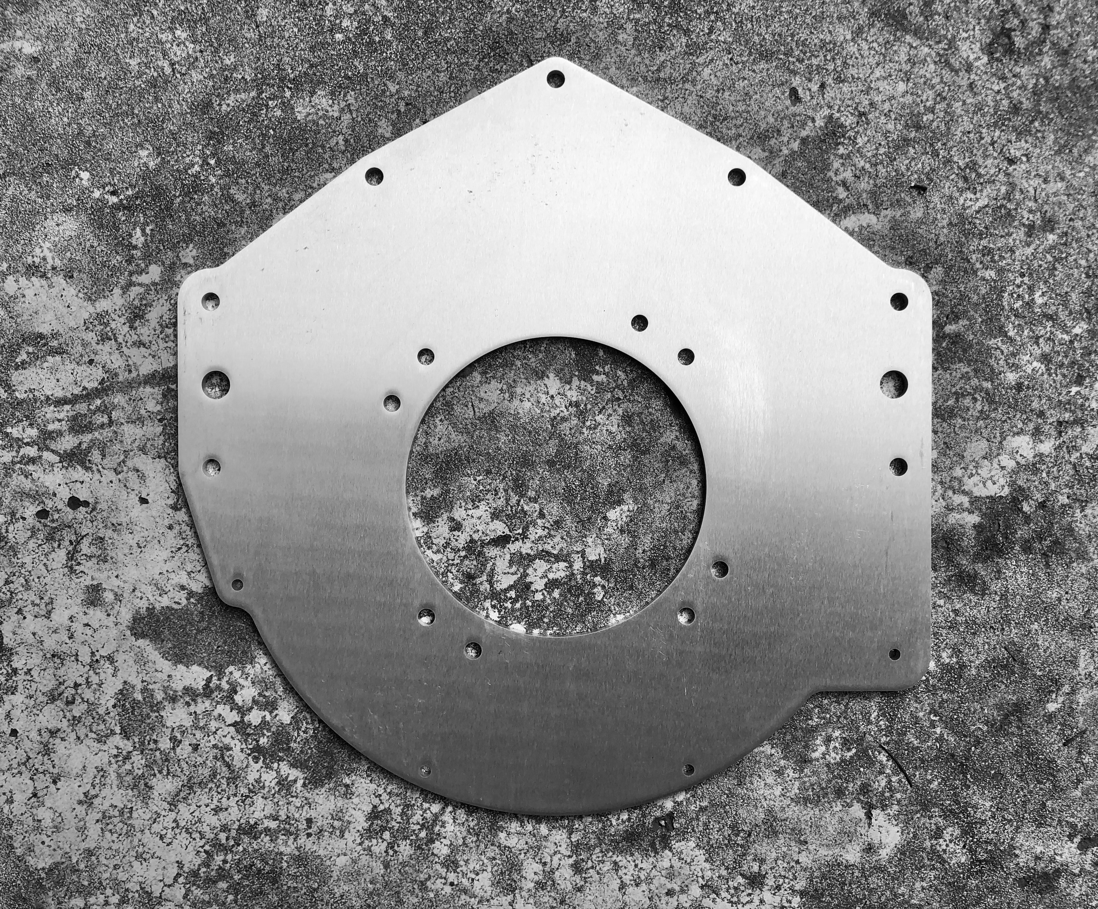

have subaru, toyota and datsun plates now !
toyota: 20/22r so the pickups, 4runners, hilux, celica, etc
datsun/nissan: 71b, 71c transmissions (and more) so 520, 620, 720, d21, hard body, frontier, etc datsun
i got this measured for free, so the design is on github
subaru: anything 1990+ impreza, forester, legcay, brz, etc
thanks to a few different people i used both mine and their measurements for the suabru to land on this adapter plate, shoot out to Zapatero, he helped confirm some of the numbers for the bolt holes. so its open for public use!
subaru_final.DXF
(27.53 KiB) Downloaded 710 times
subaru_final.PDF
(11.23 KiB) Downloaded 812 times

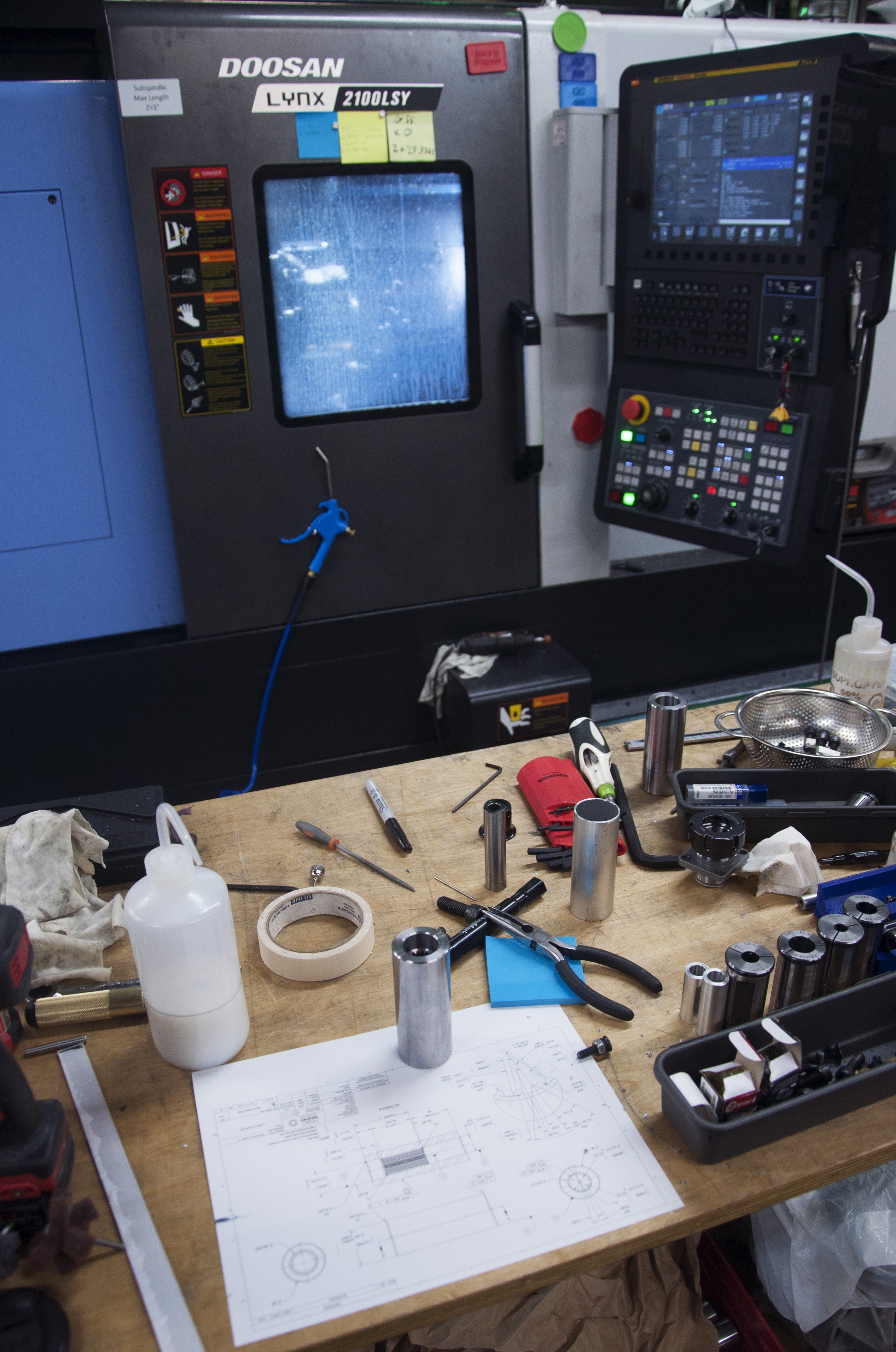

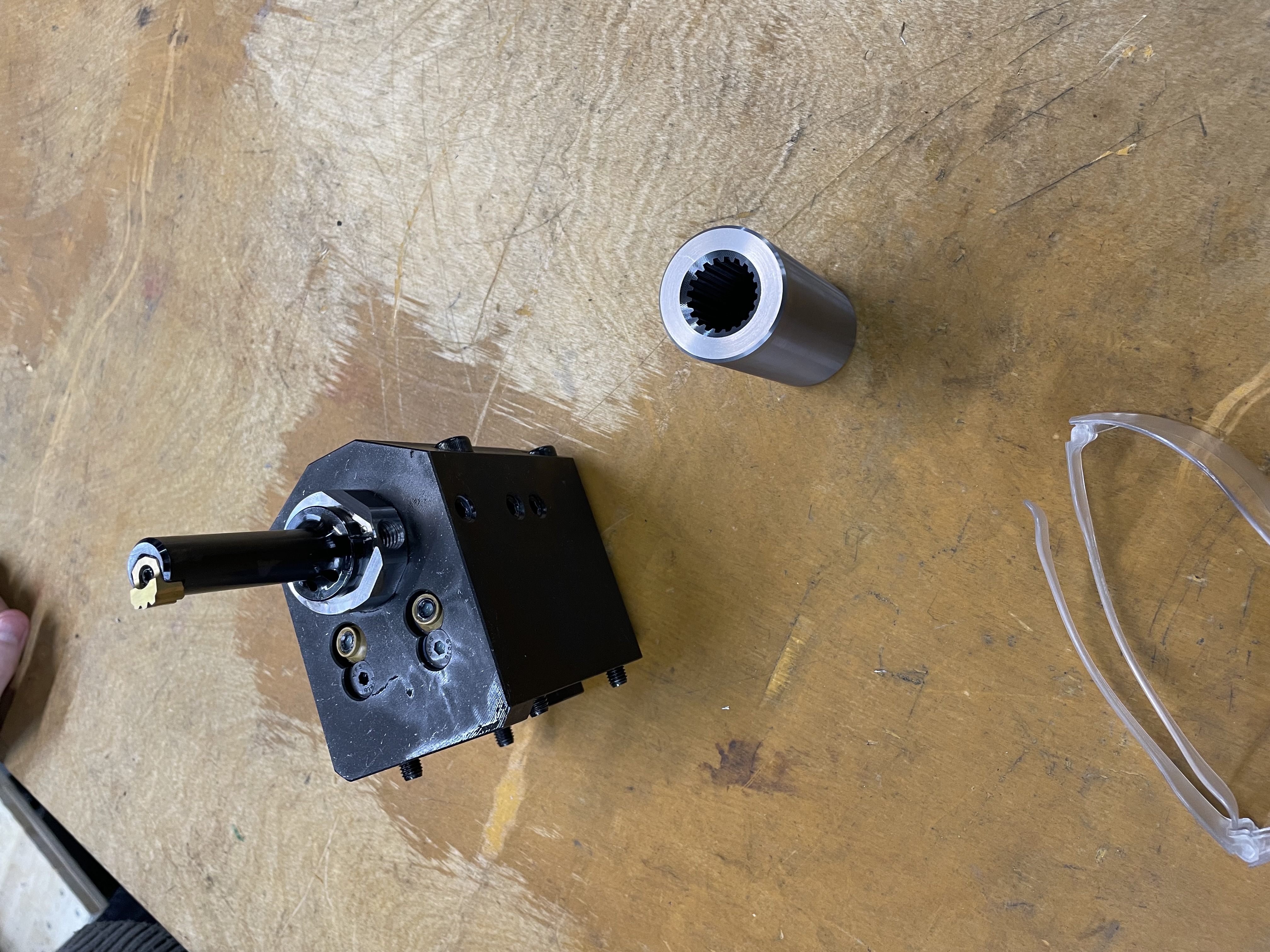

been working on bringing the leaf coupler production inhouse. as they where getting wire edm machined, didnt really have much control over the process.
invested in some custom tooling, its been a challenge as the material(4140 chromoly) is quite hard! but its well worth it as these are turning out to be the best couplers yet!
eventually this will enable custom shapes. and also broaching in the different transmission splines on the other side of the coupler!
the fit is really nice on these broached couplers!
first initial batch is in the webshop https://bratindustries.net/product/niss ... coupler-2/

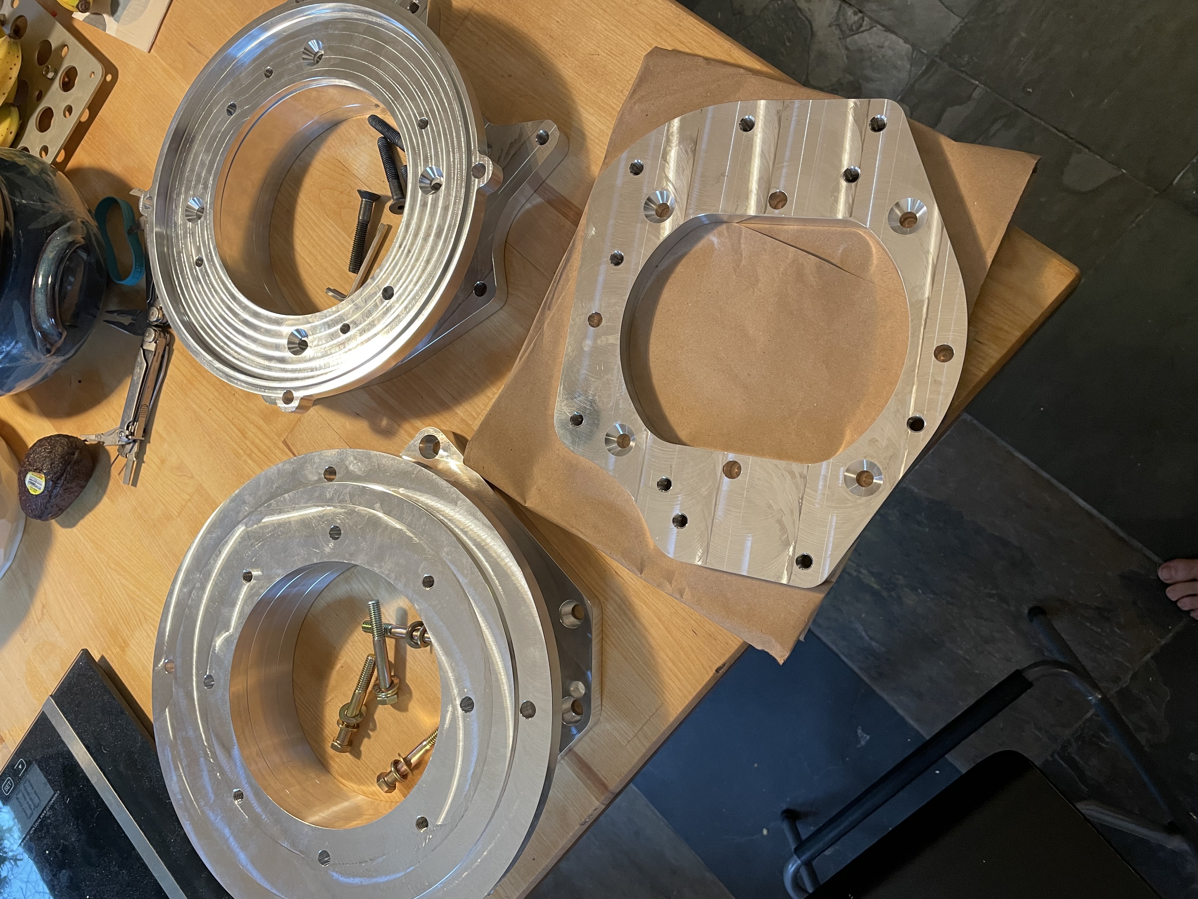

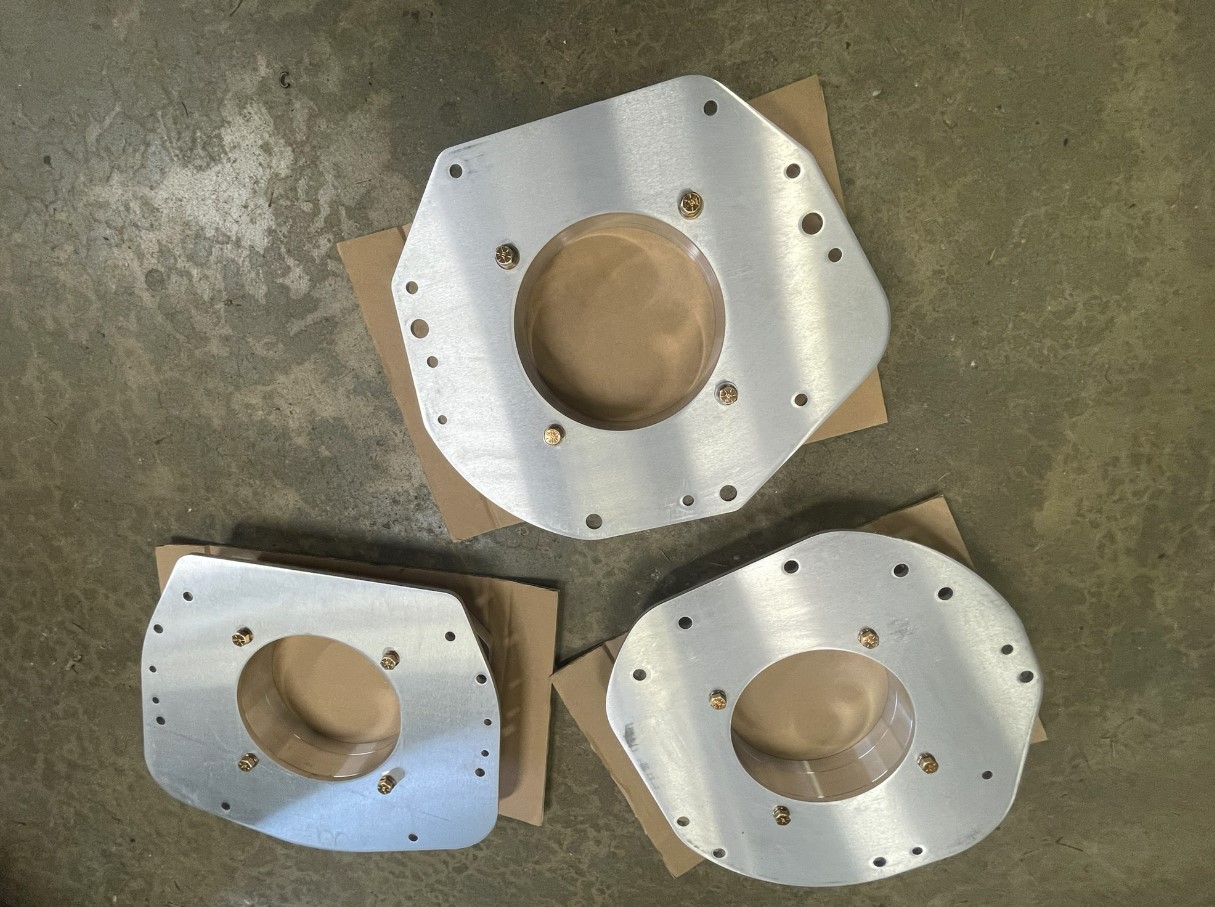

New in-house broached couplers:
New leaf adapter plates; lighter weight, additional locating holes, and tapped mount holes.
(Old vs new)
Landrover series 1, and 2-3 adapter plates, and lighter weight vw adapter plate:

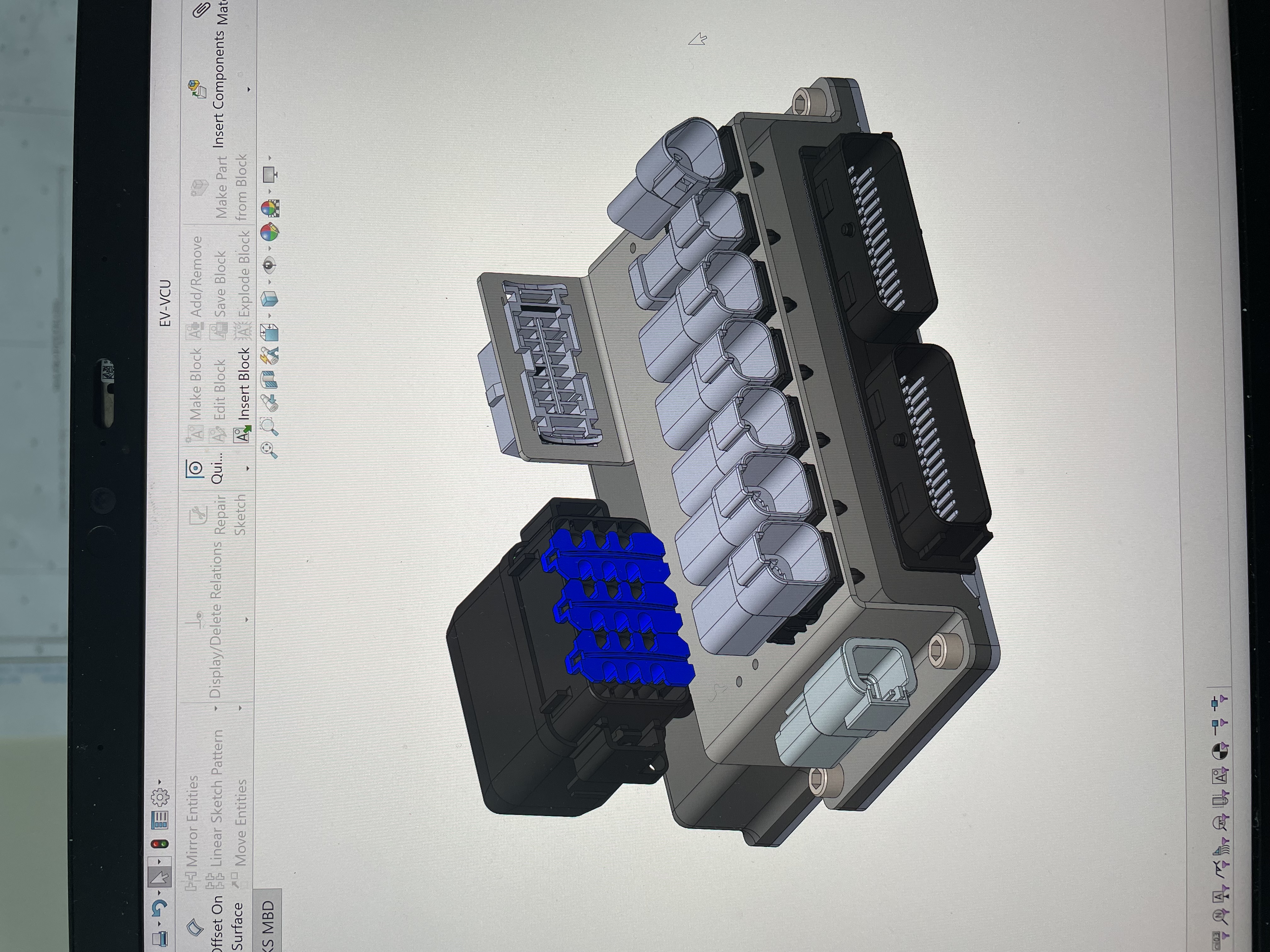

Now that all stuff is done and out of the way, next is Tesla stub shafts and pre-wired zombie harness:
Tesla stubs will have a vw type 2 spline, might just do a 100mm flange in the future.
The issue with the m3,my drive units is the interference of the 108mm(930) flange with the motor, 100mm should just fit. This really opens options up for these drive units.
and zombie-harness:
-pre wired fuse box
-obd port
-dedicated deutsch connectors, ei throttle, contactors, can, etc
-3d printed zombie case
Few steps closer to “plug-n-play”
