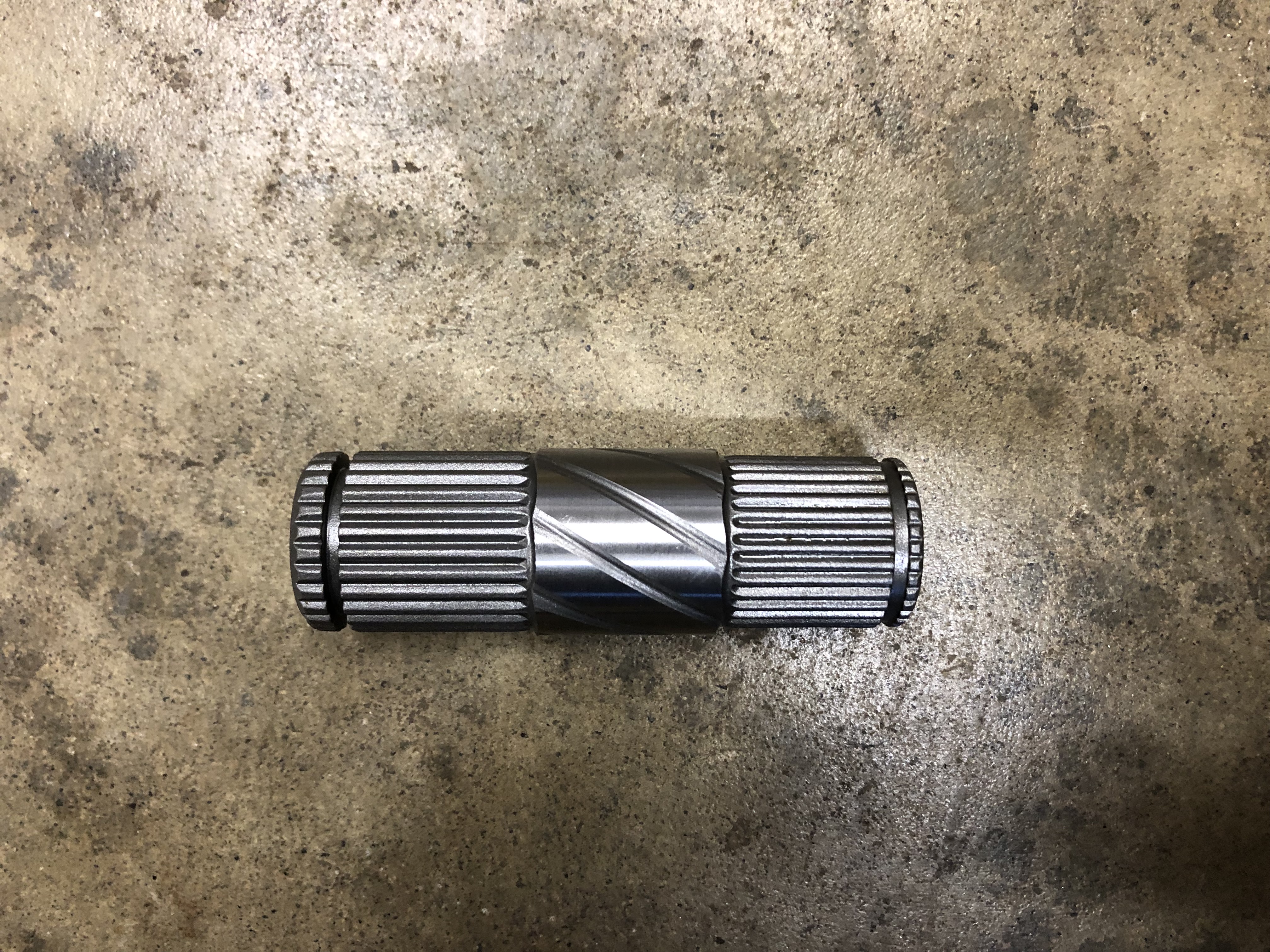

yew! finally the outlander rear motor drive shaft adapters are done!
33vw beetle spline on the outer end, so works with stock 90mm beetle flanges, as well as EMPI 100mm and 108mm(930) conversion flanges (some minor shaving of the motor case is required for the larger flanges to fit on the motor side)
cold rolled out of 4140 chromoly steel, so they are stronger than the stock outlander stubs.
available in the webshop https://bratindustries.net/product/outl ... -adapters/

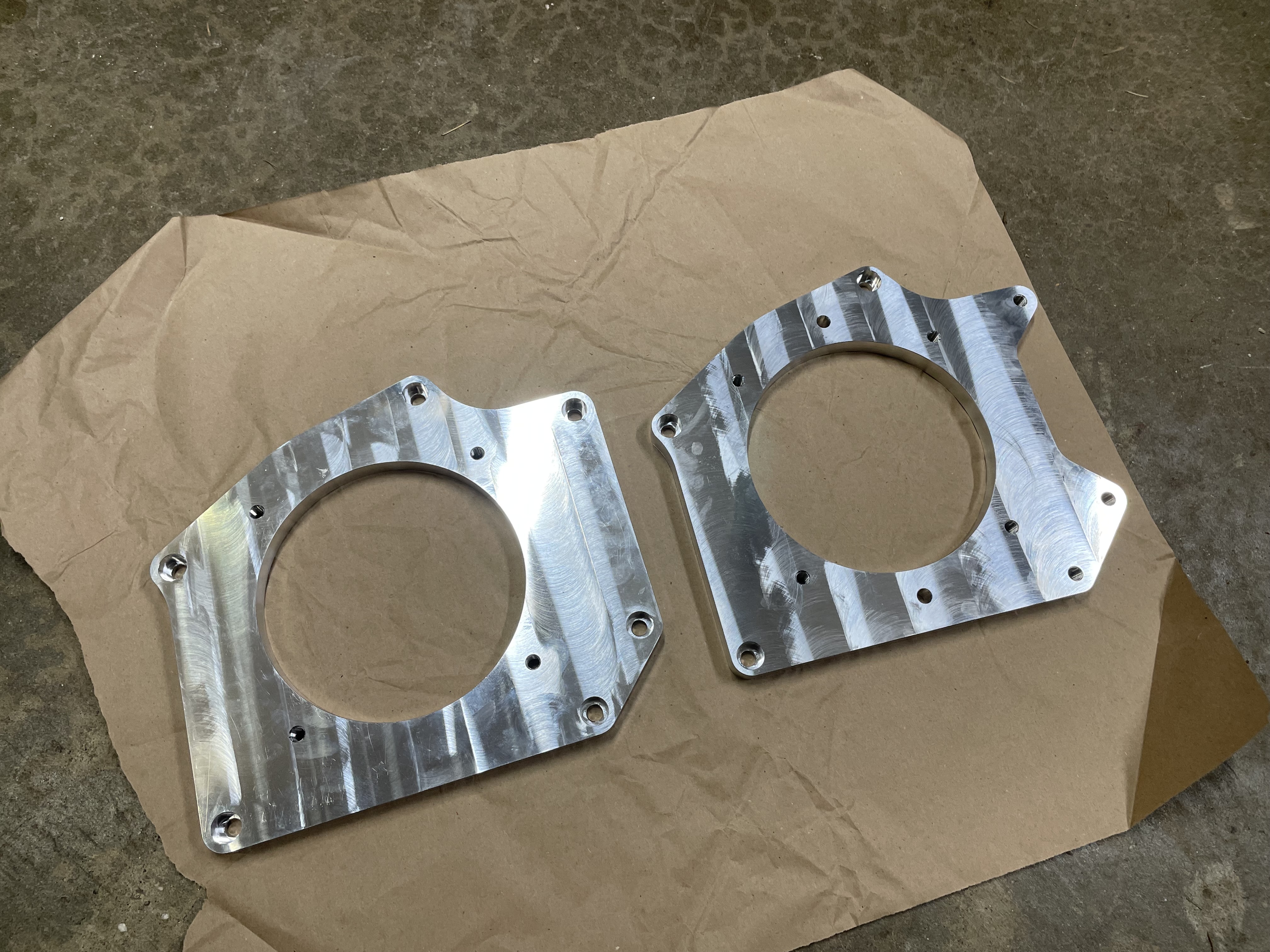

have subaru, toyota and datsun plates now !
datsun/nissan: 71b, 71c transmissions (and more) so 520, 620, 720, d21, hard body, frontier, etc datsun
i got this measured for free, so the design is on github
subaru: anything 1990+ impreza, forester, legcay, brz, etc
thanks to a few different people i used both mine and their measurements for the suabru to land on this adapter plate, shoot out to Zapatero, he helped confirm some of the numbers for the bolt holes. so its open for public use!
toyota: 20/22r so the pickups, 4runners, hilux, celica, etcdatsun/nissan: 71b, 71c transmissions (and more) so 520, 620, 720, d21, hard body, frontier, etc datsun

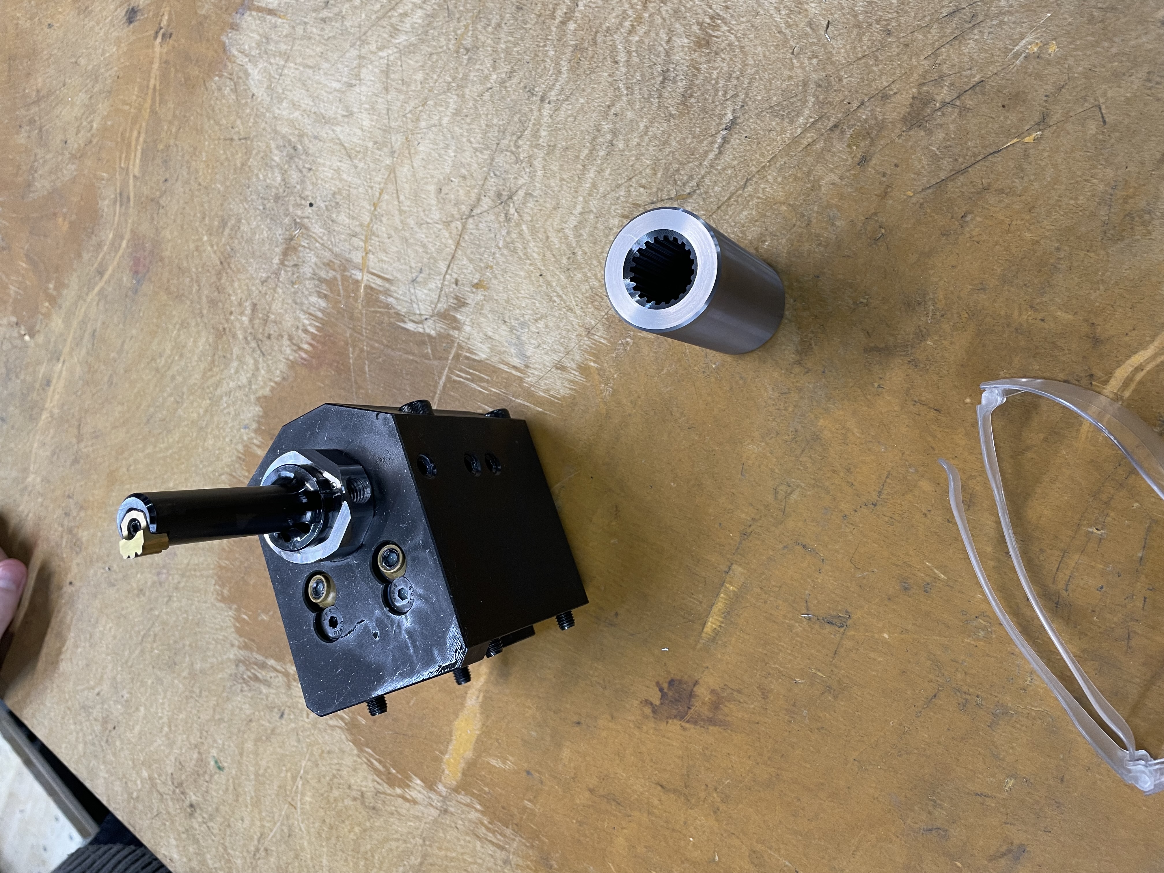

been working on bringing the leaf coupler production inhouse. as they where getting wire edm machined, didnt really have much control over the process.
invested in some custom tooling, its been a challenge as the material(4140 chromoly) is quite hard! but its well worth it as these are turning out to be the best couplers yet!
eventually this will enable custom shapes. and also broaching in the different transmission splines on the other side of the coupler!
the fit is really nice on these broached couplers!
first initial batch is in the webshop https://bratindustries.net/product/niss ... coupler-2/
