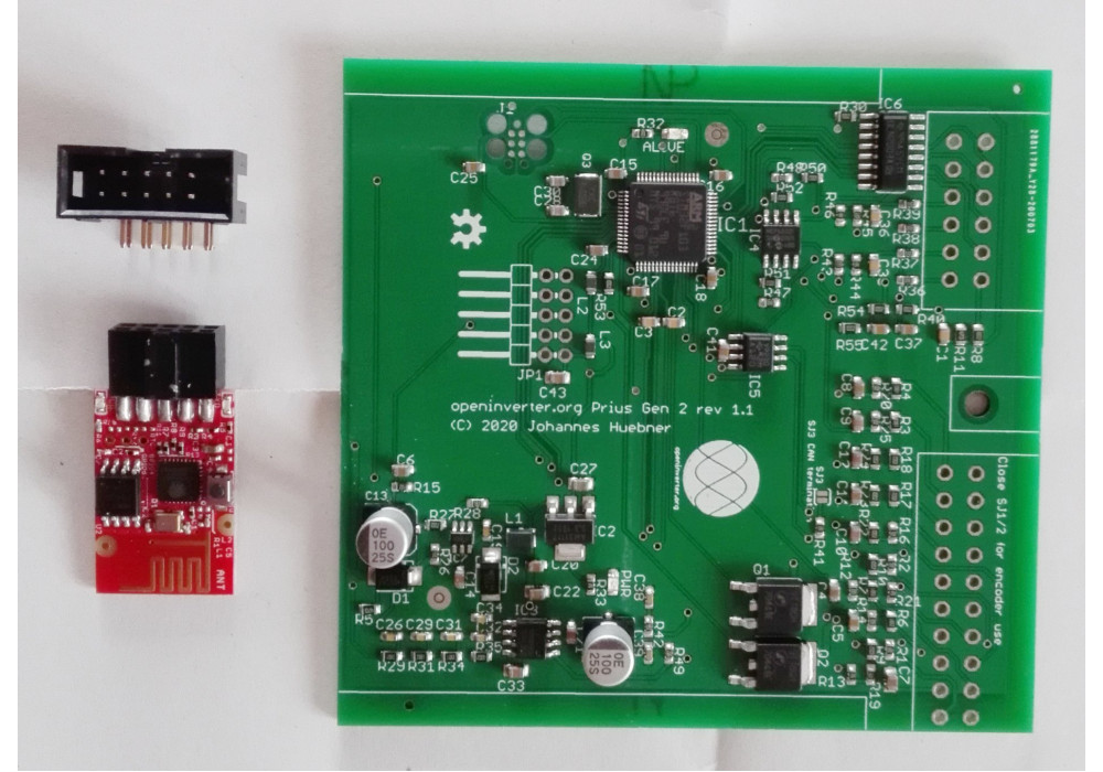

Hi there
is about Toyota Gen 2 inverter I find cheap invertors in Ebay and need a logic board to run the Toyota Prius Gen 2 Inverter. I found all files in https://github.com/damienmaguire/Prius-Gen-2-Inverter, but when i try to make order on https://jlcpcb.com/ told me that BOM file is not correct format and missing CPT file in folder. Also some files are missing in DC_controller folder. I will use it for my Peugeot 407 with Bosch SMG 180/120 PMSM motor.

The fact that there is no CPL file and the BOM is not in .xls format is becase this was not designed to be assembled at JLCPCB. At the time JLCPCB did not assemble leaded parts. You will either have to assemble it yourself or update the BOM with JLCPCB part numbers etc.
Alternatively buy this.
https://openinverter.org/shop/index.php ... duct_id=68

Alternatively way is better because i need it for DC motor - foc file on STM32 programer, thank you

Thank you for information, i will buy the logic board from openinverter shop for my Toyota gen2 inverter, i will use

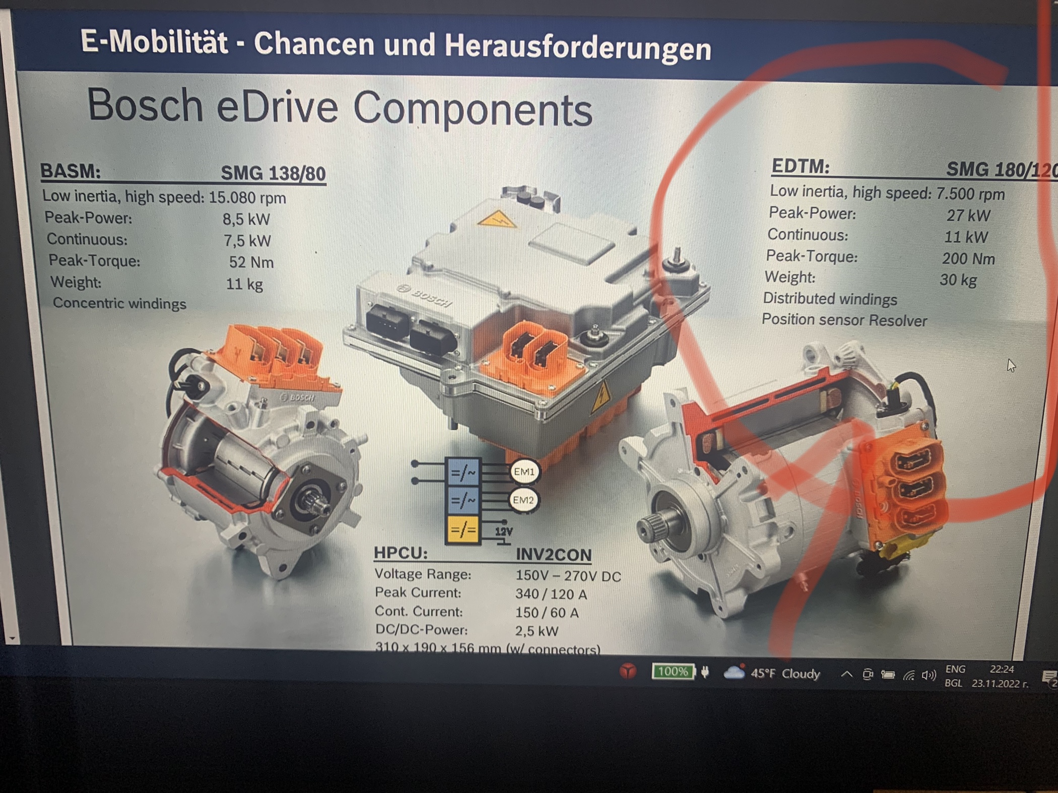

for Bosch SMG180/120 motor with MG1 -250A 200v battery is it possible to start the motor with toyota inverter gen2 and logic board from shop openinverter?

I'll let Johannes speak for his own product, but, no, I don't think so.bliznakavd wrote: ↑Sun Dec 18, 2022 10:43 amis it possible to start the motor with toyota inverter gen2 and logic board from shop openinverter?
Short answer is that nothing on EVBMW or OpenInverter is a DC motor speed controller.
The thing you can purchase from OpenInverter is to run the Gen2 Prius inverter as an inverter, for an AC motor.
Which, is pretty significant overkill for what it takes to run a DC motor. But if you wanted to spend the money... maybe Johannes know of, or would write a short bit of code that would spit out useful DC instead.

Please could you clarify?
Here:
Which type of motor is it, PMSM or DC?
Here:
and here:bliznakavd wrote: ↑Sat Dec 17, 2022 7:52 pm Hi there
You talk about the Bosch SMG 180/120 which I believe is a permanent magnet synchronous motor but here:bliznakavd wrote: ↑Tue Dec 13, 2022 8:23 pm Hi,
i want to make my peugeot 407 on electricity, i will use rear axle from peugeot 508 hybrid (they are the some). The rear axle from 508 is with Bosch SMG 180/120 motor with resolver. I can't find good controller on right price. I will use on 144V peak 200A (27kw), continues 80A (11 kw) that is original parameters from manufacture. I read many information but not find the correct one... I can use sensorless controller but not will be smooth machine. i need only 2500-2900 RMP. Can i use inverter from Toyota Prius Gen2 G9200 - 47121 2004-2009 and https://openinverter.org/shop/index.php ... duct_id=63 ? my battery pack is 144V not need more. Or can i install https://openinverter.org/wiki/images/d/ ... ncoder.jpg to use with normal controller?
Thank you
You talk about driving a DC motor.bliznakavd wrote: ↑Sat Dec 17, 2022 9:41 pm Alternatively way is better because i need it for DC motor - foc file on STM32 programer, thank you

Can't see any reason why an OpenInverter board couldn't drive that. Look like it's fairly high pole count so top speed may be limited but then you only want 2900rpm.
I reckon the Prius Gen3 can do up to 100kW with a 360V bus voltage so with you 144V you may only get 40kW peak? Might also be worth measuring the winding inductances, if they are more than a mH or so you may struggle to even get that.
Edit - Note that you need to be confident that the components you order will do the job. If you aren't then it's doubtful that you know enough to be able to get them to work together. Don't start ordering bits until it all makes sense to you!

i only need 26kw on a peak and 11kw continues for my project, because is on rear axle on peugeot 508. want to use Toyota Gen2 because is cheap invertor

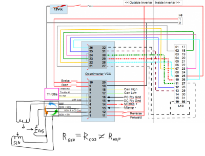

I just want to say thank you on Johansen(Johu), Pete9008 and MattsAwesomeStuff,
with their help we were able to find out what the engine is, my PMSM motor bosch SMG 180/120 i will use with inverter from Toyota GEN 2 with a logic board of openinverter.org at 144 volts, the motor is with The Resolver is from Tyco Electronics,
Multi Coil Resolver
Type: MCR605
Speed: 6-speed (so 6 pole-pairs)
Excitation_Voltage: 7Vrms
Excitation_Frequency: 10kHz
The MCR605 pin-layout (6-pin variant):
1 / green / reference
2 / brown / sine-
3 / blue / sine+
4 / white / cosine-
5 / red / cosine+
6 / yellow / supply
Multi Coil Resolver
Type: MCR605
2 / brown / sine-
3 / blue / sine+
4 / white / cosine-
5 / red / cosine+
6 / yellow / supply
- Been thanked: 1913 times
Re: Toyota Invertor Gen2 Problem
Cool you converted my name to Swedish it seems
"Johannes" would be the original
Yes just connect it up, if in doubt see what voltage comes from the sin or cos coil and that the amplitude is between 1V and 3V
So far 3.5Vrms and 4.4kHz seems to work for many resolvers out there.

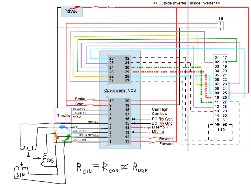

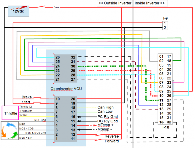

I have the same motor. Could you confirm guys that it's correct resolver output? On Damien's film plot was more repeatable and regular, but maybe number of poles makes difference.
Looks alright to me

Good news, so I can go further. It's my working pinout for resolver slot of Peugeot motor.
1 – Motor ground,
2 – EXC- → e.g. JP7 pin 16
3 – SIN- → JP2 pin 2
4 – SIN+ → JP2 pin 1
5 – COS- → JP2 pin 2
6 – COS+ → JP2 pin 3
7 – EXC → JP2 pin 4

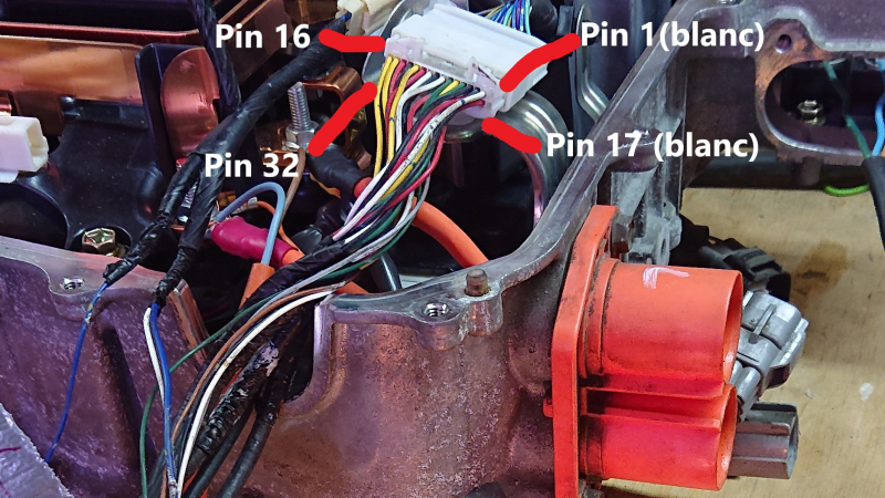

Do someone know what kind of temp sensor is used in this motor? There are 4 pin, in original wiring pins 1 and 4 are twisted pair (10k between them), pins 2 and 3 are shorted.

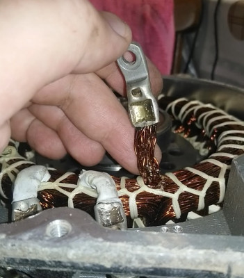

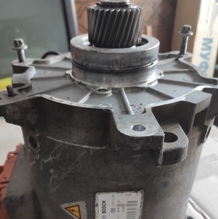

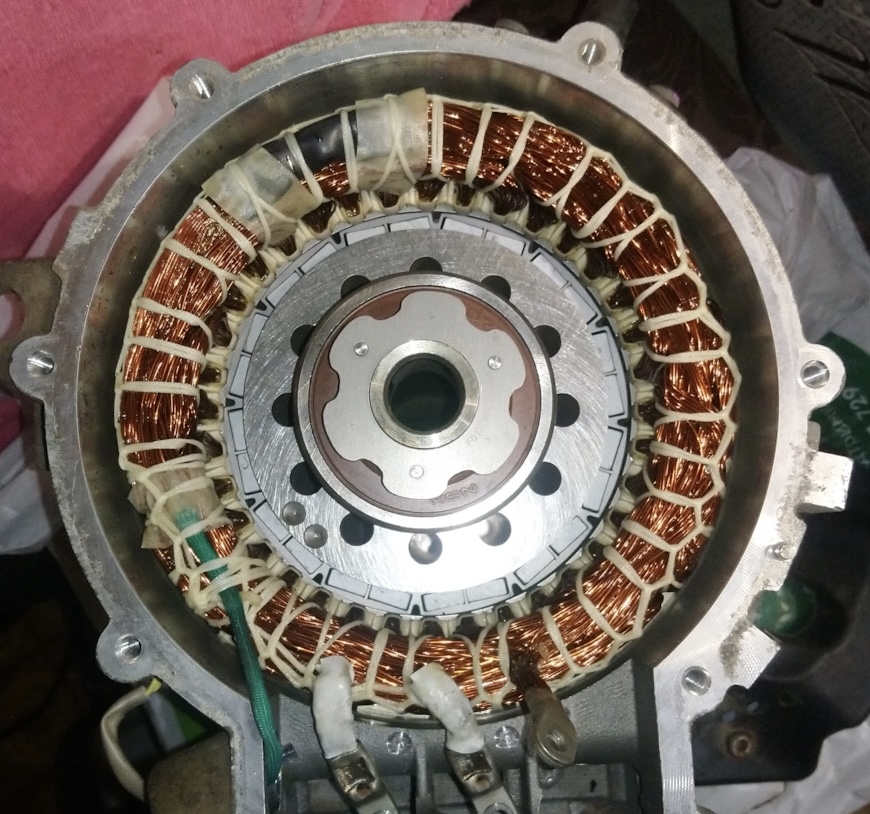

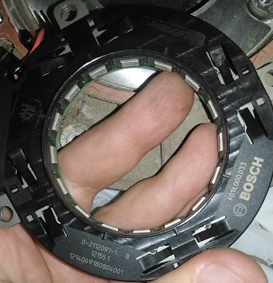

I suppose that 1 and 4 should be connected to TEMP and TEMP- (but what polarity?). One of 2 and 3 should be powered by 12v and other connected to IN_MPROT. There is still issue what type of temp sensor should be chosen in inverter settings.
In a fact I have got bigger trouble now, because I realised, that there is big backlash between rotor and front bearing. It's really bad news for me, because I planned use normal clutch, which is quite heavy. Even if I fix it or buy other motor, problem could quickly return.

It's really bad news, if you use normal clutch the problem will return quickly, may be if you use C3 new bearings, Would someone tell me is that correct wire diagram on my Gen2 inverter? which pins are need to use for resolver
