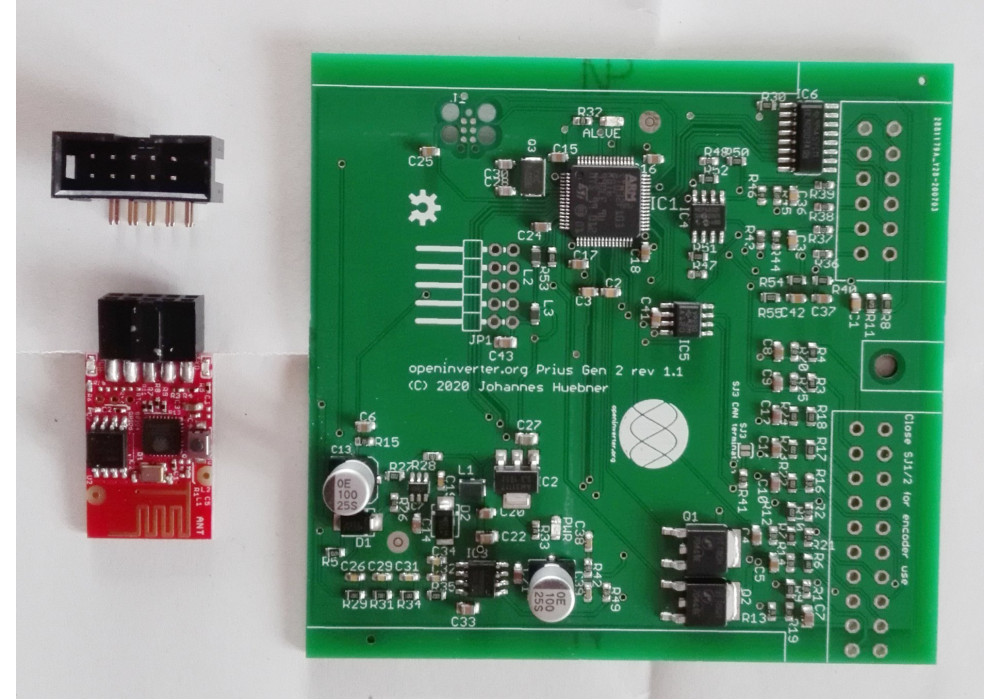

The fact that there is no CPL file and the BOM is not in .xls format is becase this was not designed to be assembled at JLCPCB. At the time JLCPCB did not assemble leaded parts. You will either have to assemble it yourself or update the BOM with JLCPCB part numbers etc.
Alternatively buy this.
https://openinverter.org/shop/index.php ... duct_id=68

Thank you for information, i will buy the logic board from openinverter shop for my Toyota gen2 inverter, i will use
for Bosch SMG180/120 motor with MG1 -250A 200v battery is it possible to start the motor with toyota inverter gen2 and logic board from shop openinverter?

I'll let Johannes speak for his own product, but, no, I don't think so.
Short answer is that nothing on EVBMW or OpenInverter is a DC motor speed controller.
The thing you can purchase from OpenInverter is to run the Gen2 Prius inverter as an inverter, for an AC motor.
Which, is pretty significant overkill for what it takes to run a DC motor. But if you wanted to spend the money... maybe Johannes know of, or would write a short bit of code that would spit out useful DC instead.
Been thanked: 1918 times
Re: Toyota Invertor Gen2 Problem
The hardware would certainly be capable of running as a DC controller. But as Matt says there is not software for it. Probably not hard to create "pwmgeneration-dc.cpp" file that replaces AC by DC control but I'm not really interested in doing that as DC motors are slowly fading away.

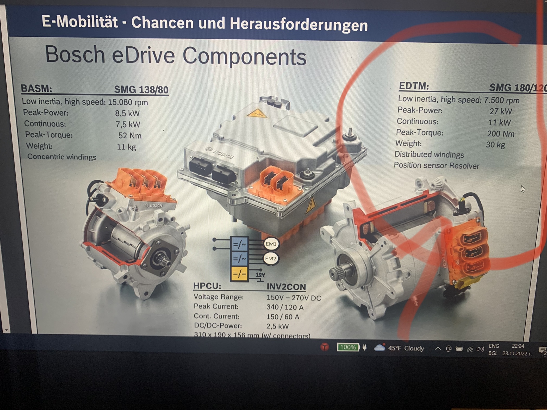

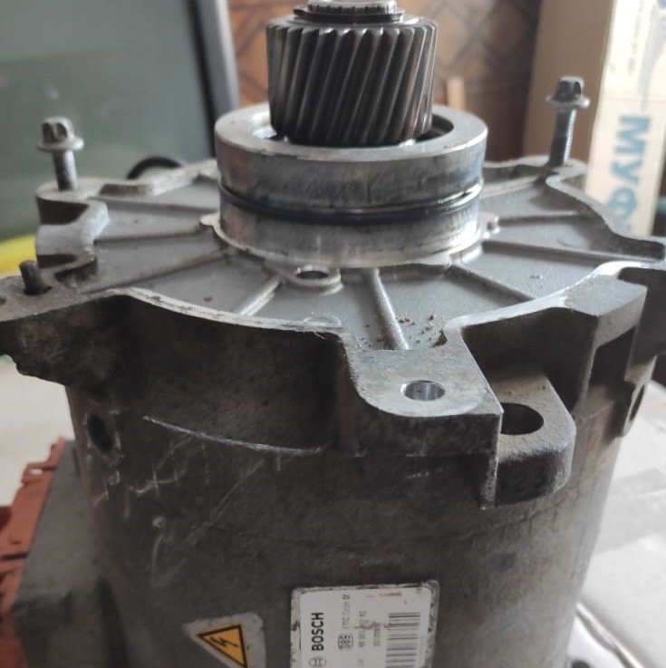

This is my motor PMSM Bosch SMG180/120
Pete9008
Posts: 1801
Has thanked: 102 times
Been thanked: 351 times
Post by Pete9008 »
Can't see any reason why an OpenInverter board couldn't drive that. Look like it's fairly high pole count so top speed may be limited but then you only want 2900rpm.
I reckon the Prius Gen3 can do up to 100kW with a 360V bus voltage so with you 144V you may only get 40kW peak? Might also be worth measuring the winding inductances, if they are more than a mH or so you may struggle to even get that.

i only need 26kw on a peak and 11kw continues for my project, because is on rear axle on peugeot 508. want to use Toyota Gen2 because is cheap invertor

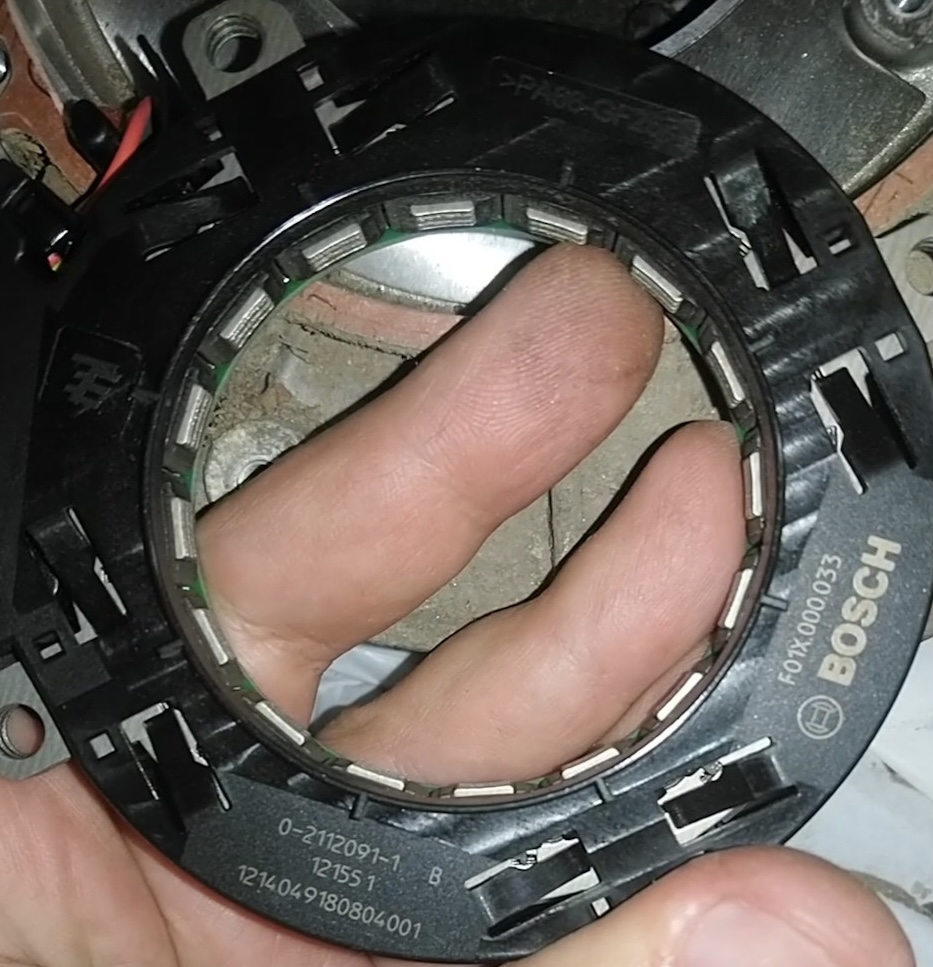

I have the same motor. Could you confirm guys that it's correct resolver output? On Damien's film plot was more repeatable and regular, but maybe number of poles makes difference.
Looks alright to me

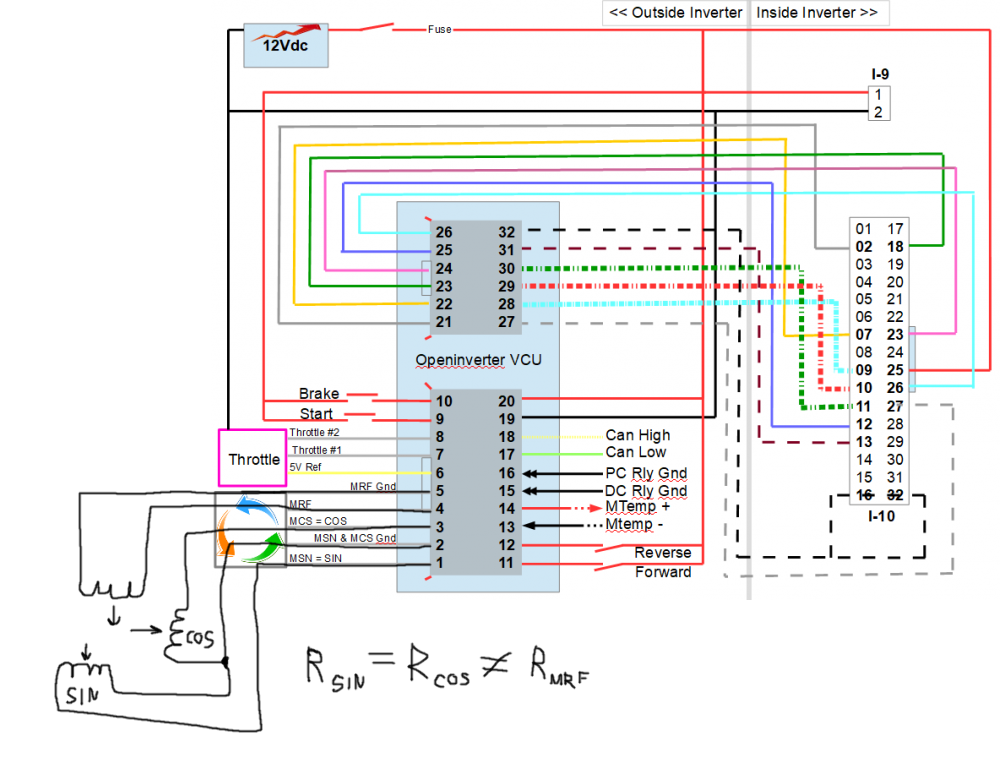

Good news, so I can go further. It's my working pinout for resolver slot of Peugeot motor.
1 – Motor ground,
2 – EXC- → e.g. JP7 pin 16
3 – SIN- → JP2 pin 2
4 – SIN+ → JP2 pin 1
5 – COS- → JP2 pin 2
6 – COS+ → JP2 pin 3
7 – EXC → JP2 pin 4

Do someone know what kind of temp sensor is used in this motor? There are 4 pin, in original wiring pins 1 and 4 are twisted pair (10k between them), pins 2 and 3 are shorted.
bliznakavd
Posts: 32
Joined: Tue Dec 13, 2022 8:13 pm
Has thanked: 12 times
Been thanked: 9 times
Post by bliznakavd »
i don’t know but may be use only pin 1 and 4
marucha79
Posts: 36
Joined: Wed Jul 20, 2022 6:28 am
Location: Poland
Post by marucha79 »

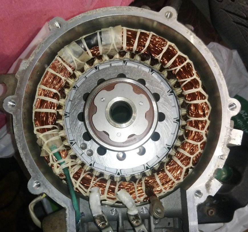

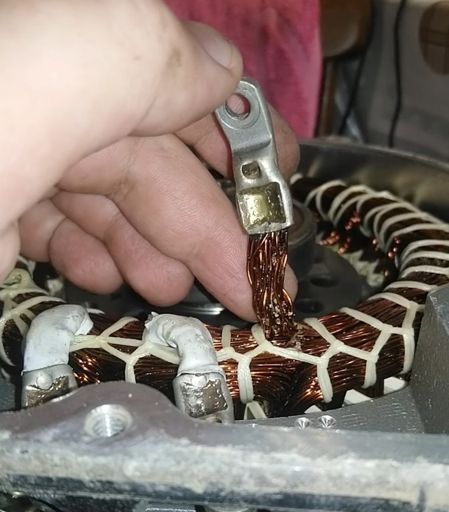

I suppose that 1 and 4 should be connected to TEMP and TEMP- (but what polarity?). One of 2 and 3 should be powered by 12v and other connected to IN_MPROT. There is still issue what type of temp sensor should be chosen in inverter settings.
In a fact I have got bigger trouble now, because I realised, that there is big backlash between rotor and front bearing. It's really bad news for me, because I planned use normal clutch, which is quite heavy. Even if I fix it or buy other motor, problem could quickly return.

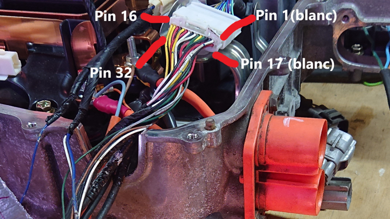

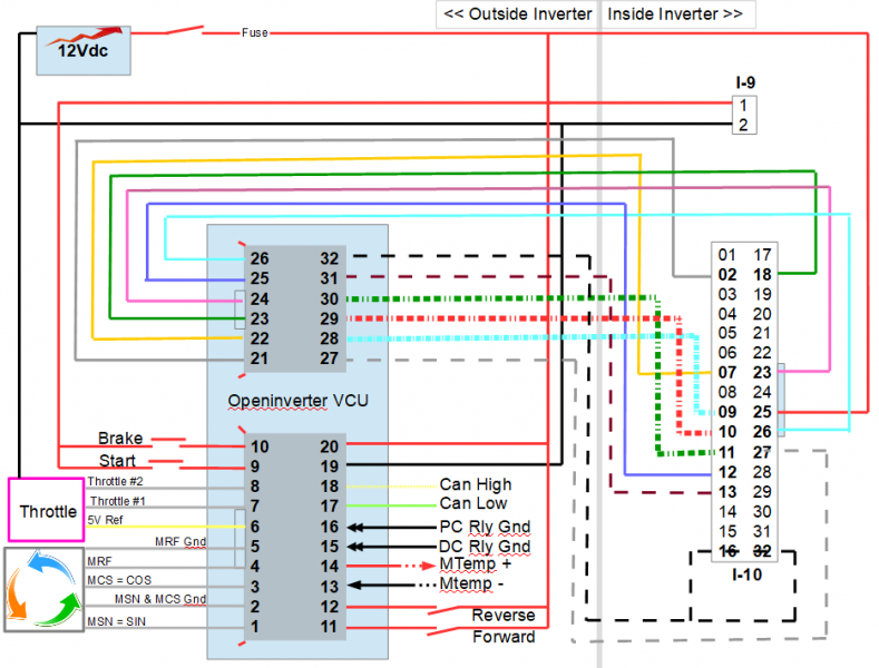

It's really bad news, if you use normal clutch the problem will return quickly, may be if you use C3 new bearings, Would someone tell me is that correct wire diagram on my Gen2 inverter? which pins are need to use for resolver
PRuslan
Posts: 10
Joined: Sun Jan 01, 2023 5:59 pm
Post by PRuslan »
pins 1-5
