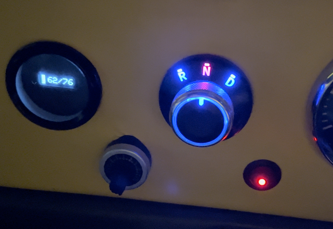

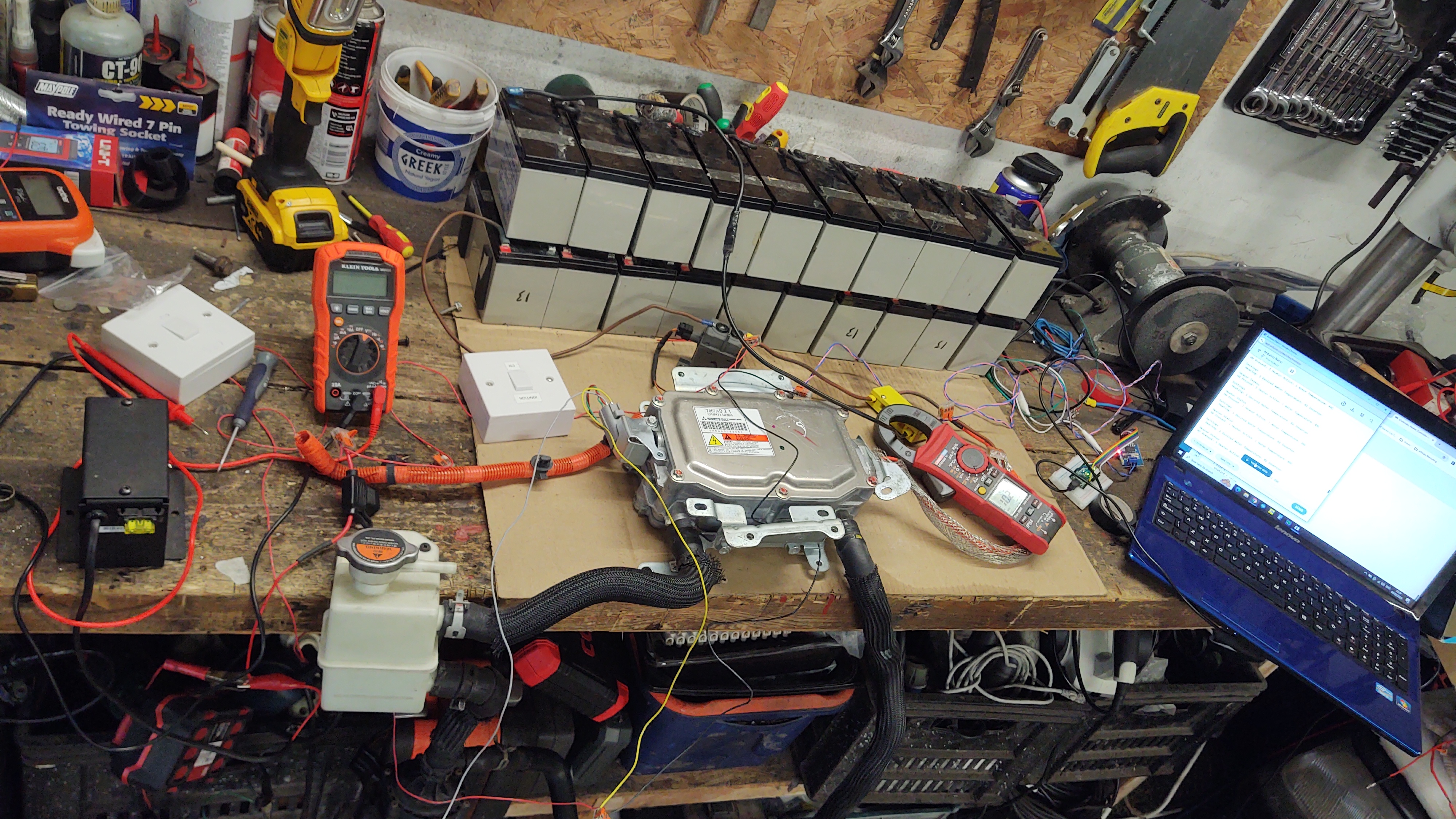

Got it working nicely now! Love the display output aswell - very useful!
Posts: 1787
Has thanked: 83 times
Been thanked: 431 times
Re: Mitsubishi Outlander PHEV heater
Nice :D I am pretty pleased with the display.

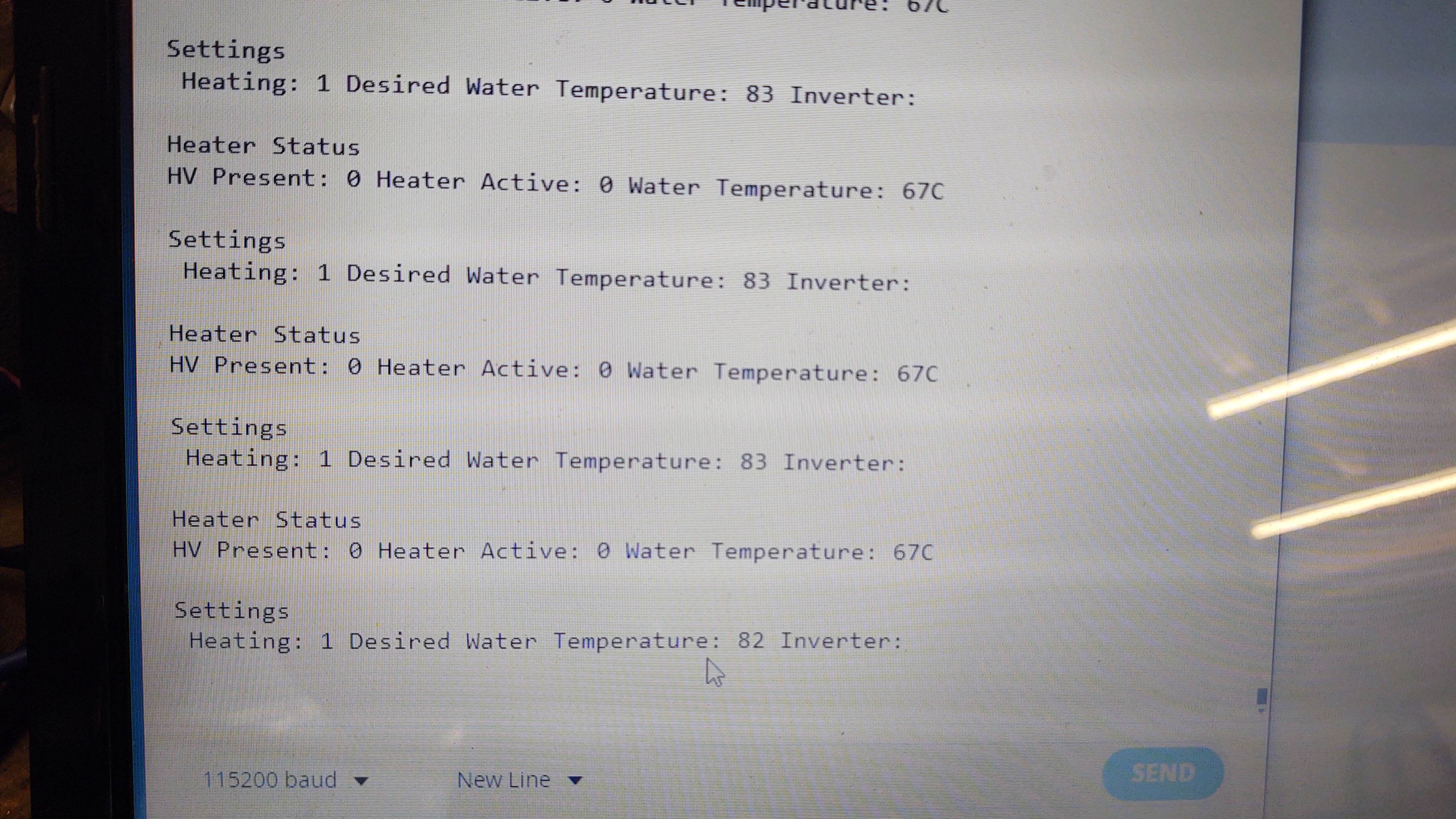

Interesting development today - the heater wouldnt start until the temperature got above -1 degrees C!

arber333 wrote: Thu Dec 29, 2022 9:52 pm Hm... you could readback the heater CAN temp byte4 and run the pump when temp is higher than X. It would require a transistor and a relay, but you would have a circulation system independant of heat source. I wanted to built similar heating myself. On one side Outlander heater run by a DUE uC and on the other Webasto fuel heater. I wanted to use Webasto pump to also run when Outlander heater would be ON.
I like this idea - it will be my next mini project i think!

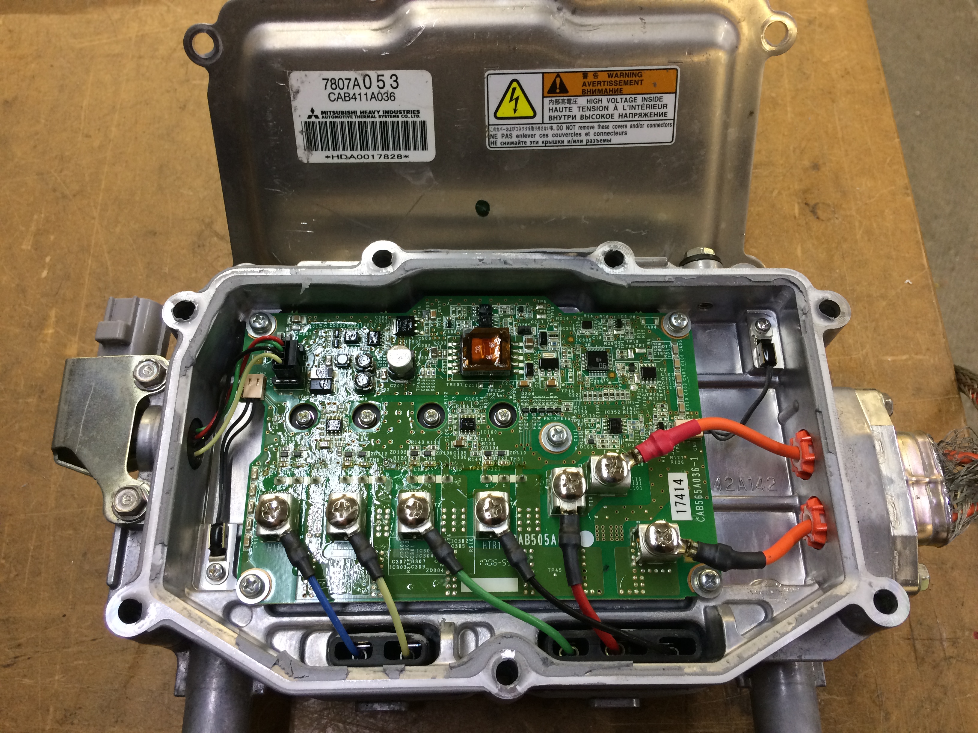

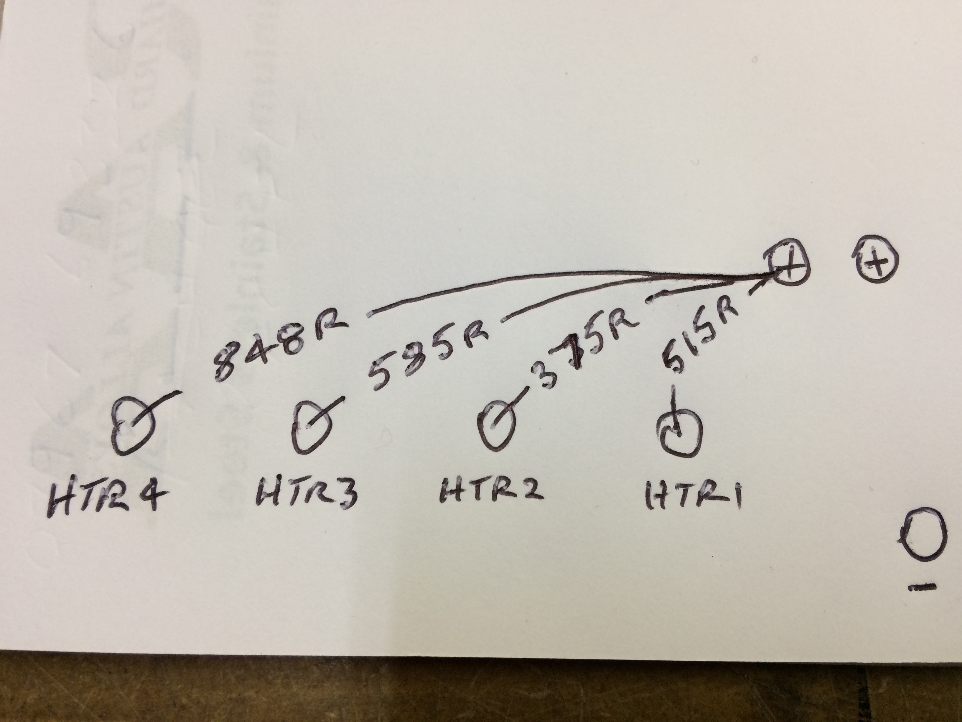

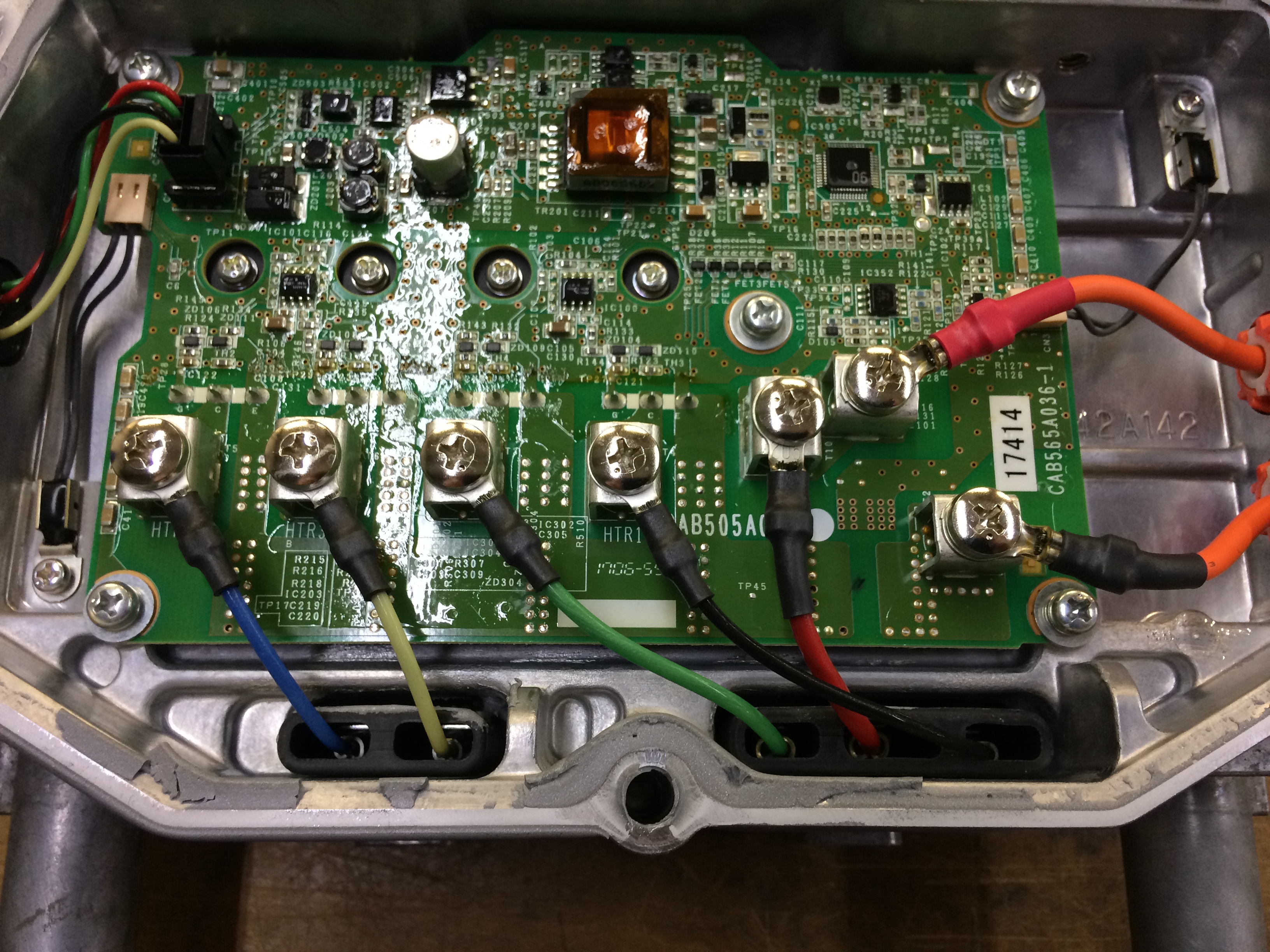

Hi Forum. For anyone interested I took the top off my PHEV heater.... cos I am nosey :-)
Pics reveal heater connections etc.

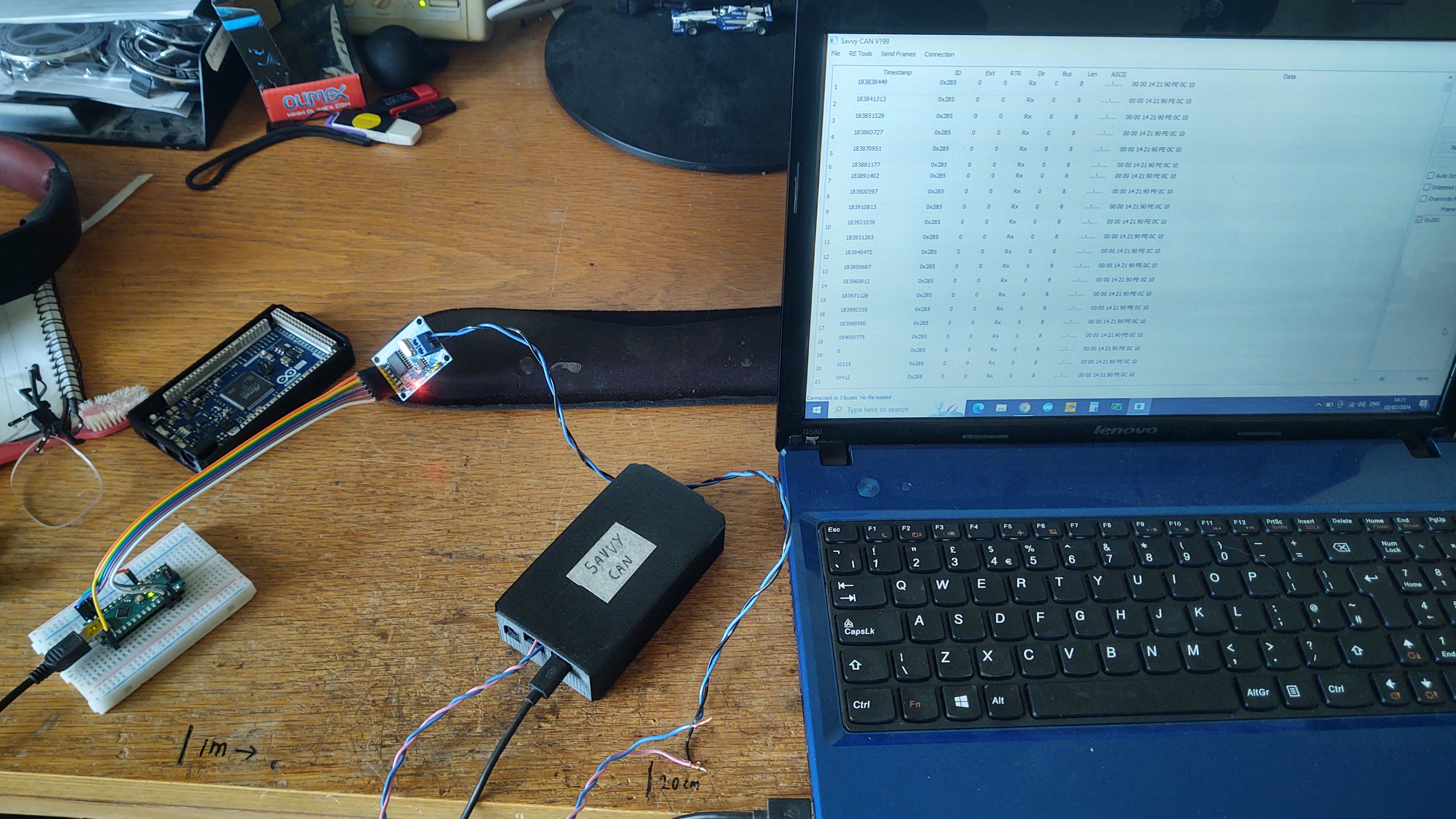

Hi guys
My heater has arrived and I'm setting up a test station to confirm I can control it before ripping the car apart.
But I need a little guidance with the Arduino side of things as I'm pretty clueless at programming. I have the sketch above from Turbopete on a nano and can see it sending 0285 message so hopefully that bit is OK.
This sketch seems to include control for a display but I cannot find any thread showing details of model or how it was connected.
Also can anyone please advise the resistance of the POT and how to connect it? It looks like the wiper of the POT is on A0 but where does the other side go? Is it just 5V?
EDIT: I did a search for Adafruit 128 x 32 OLED displays and found this. https://www.adafruit.com/product/4440
Is this the right one?
Thanks guys
Alibro
Posts: 997
Location: Northern Ireland
Has thanked: 378 times
Been thanked: 224 times
Post by Alibro »

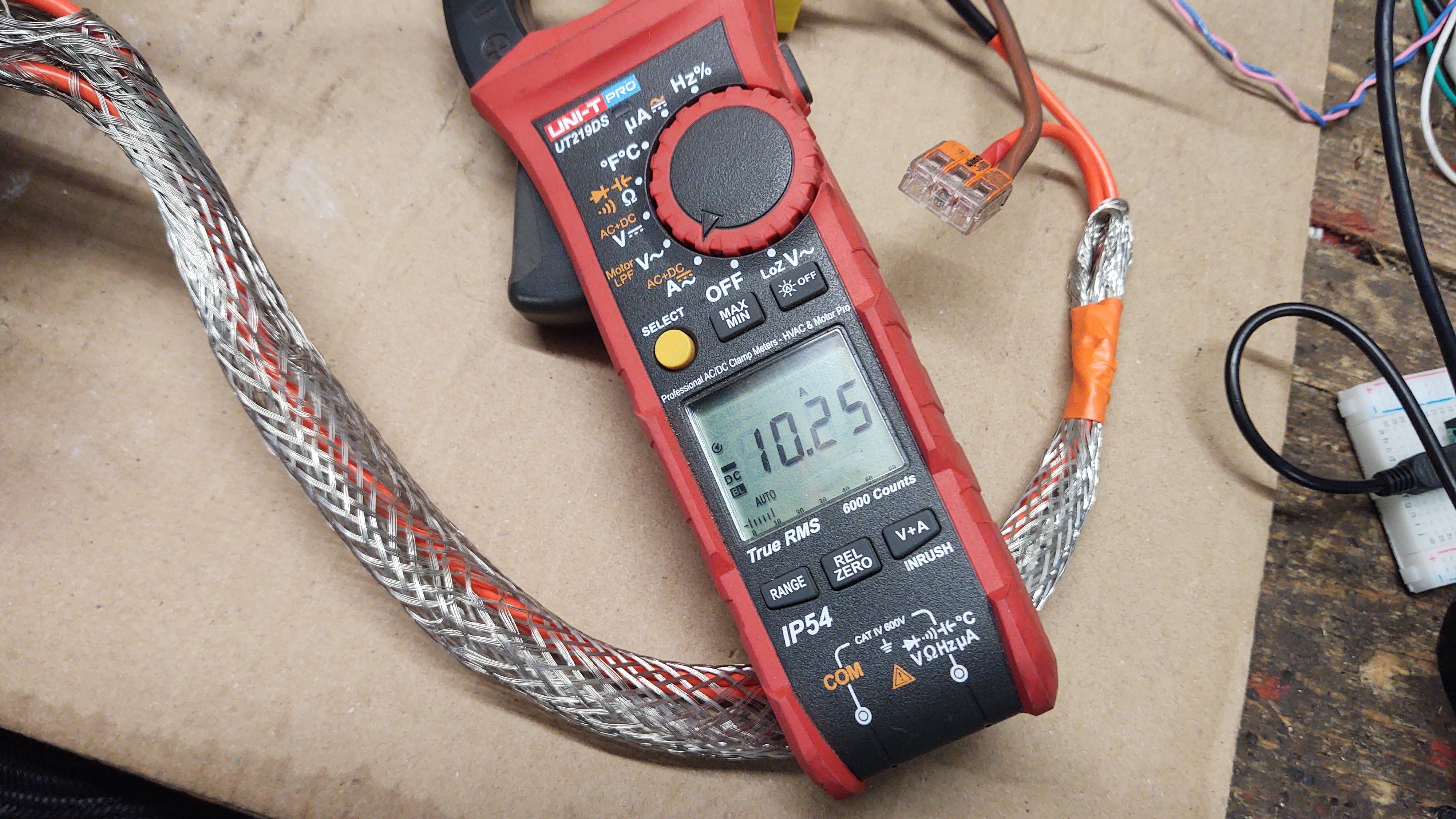

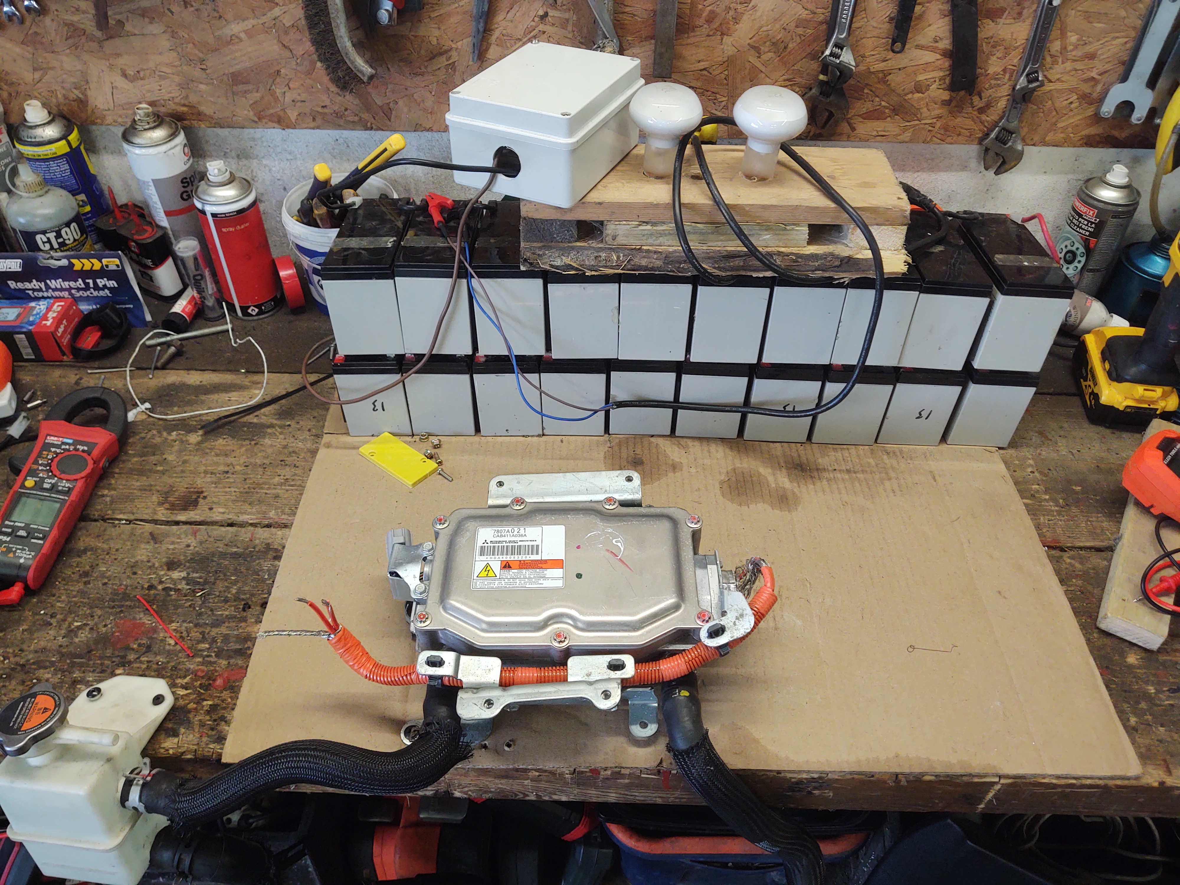

I only managed an hour or so at it today but managed to get hot water pumping. :)
I could see 10A at 250V
I only had a 4k7 pot connected between ground and A0 so not sure if that is suitable as I think the heat requested was around 85C and it wouldn't drop below that. I think I could see a 10k pot in a previous photo from Jamie so I'll dig one out and give it a go. Does this sound correct?
Posts: 1787
Pot size irrelevant, connect one side to gnd, other to vcc and wiper to A0
Posts: 3581
Has thanked: 134 times
Been thanked: 344 times
Alibro wrote: Sun Feb 04, 2024 5:07 pm I only had a 4k7 pot connected between ground and A0 so not sure if that is suitable as I think the heat requested was around 85C and it wouldn't drop below that. I think I could see a 10k pot in a previous photo from Jamie so I'll dig one out and give it a go. Does this sound correct?
I dont fuss with the pot. I simply use a digital input and internal CAN loop. I use this for the pump too. So when heater temp is lower than 50deg i request full power, when it is at 50deg i lower this to halfh and when heater reaches 55deg i terminate the request. This keeps heater output at 50deg in general which saves kWh acc to Q = m*c*dT. I may up the temp to 60deg if this will not be enough.
Alibro
Posts: 997
Post by Alibro »
Thanks guys,
Doing family stuff atm but will have another look later.
Alibro
Posts: 997
Post by Alibro »
It works a treat!!! :D
I connected the 4k7 pot as instructed and commented out the Openinverter precharge safety checks and it works perfectly with the water temp following the requested temp.
I already have a 12V circuit which only goes live after the main positive contactor kicks in so I'll use that to power the heater when it is installed.
I've also ordered a couple of OLED displays so I'll have a go at getting them to work.
Thanks again guys for your help with this as I'm very much standing on your shoulders here.
I was a little surprised at how hot the case of the heater got and couldn't help thinking it is a pity to loose all that heat but I suspect I'm too late trying to capture it as I would need to have custom designed some kind of enclosure with fans.
arber333 wrote: Sun Feb 04, 2024 5:31 pm I dont fuss with the pot. I simply use a digital input and internal CAN loop. I use this for the pump too. So when heater temp is lower than 50deg i request full power, when it is at 50deg i lower this to halfh and when heater reaches 55deg i terminate the request. This keeps heater output at 50deg in general which saves kWh acc to Q = m*c*dT. I may up the temp to 60deg if this will not be enough.
My coding skills are virtually zero so now I have it working I think I'll leave well alone. :P

  Serial.println("Heater Status");
  Serial.print("HV Present: ");
  Serial.print(hvPresent);
  Serial.print(" Heater Active: ");
  Serial.print(heating);
  Serial.print(" Water Temperature: ");
  Serial.print(Heatertemp);
  Serial.println("C");
  Serial.println("");
  Serial.println("Settings");
  Serial.print(" Heating: ");
  Serial.print(enabled);
  Serial.print(" Inverter: ");
  Serial.print(inverterStatus);
  Serial.println("");
  Serial.println("");
