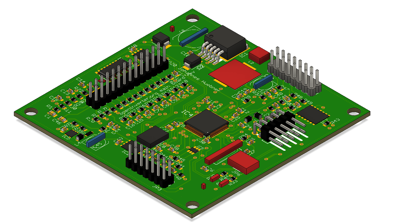

No need for KiCAD for 3D, Eagle and Fusion360 can do it. Some of the parts need models, but quite a lot is already there:

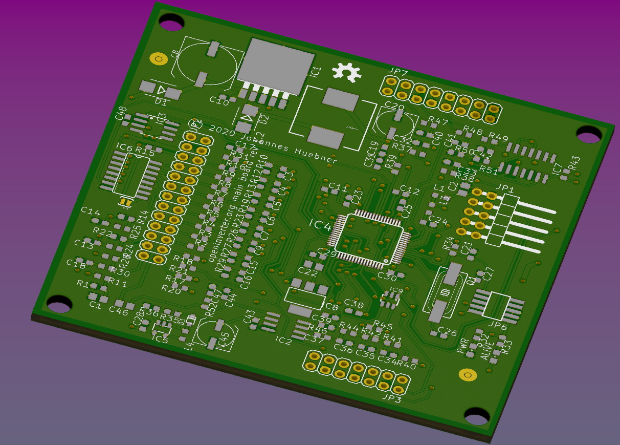

There's an Eagle to KiCAD converter: https://github.com/lachlanA/eagle-to-kicad just seeing how well it works...
doobedoobedo
Posts: 264
Location: UK
Re: Rev 3 main board now fully open source!
Post by doobedoobedo »
Doesn't look like it does too bad a job
Needs some cleanup and 3D goodness but overall I'm pretty impressed!

A little more cleanup to package it and I'll put it up on my github.
edit: render after fixing silkscreen for IC9 and mechanical holes.

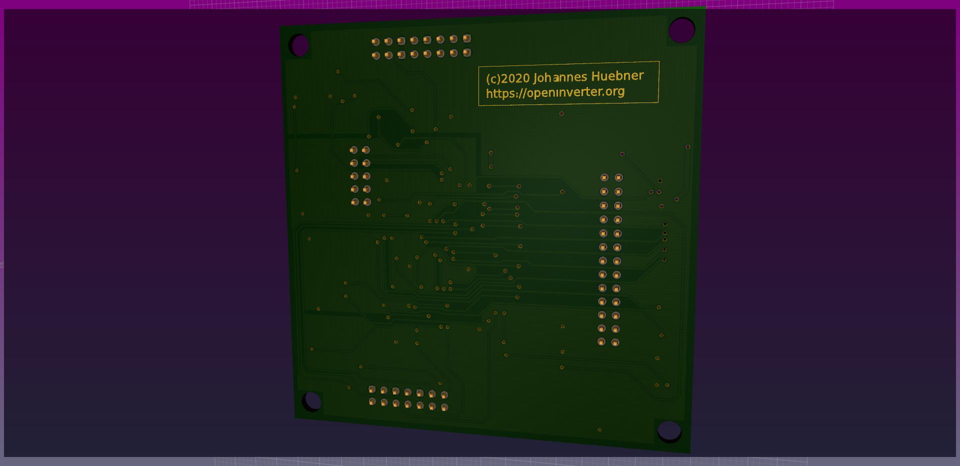

johu wrote: Fri Jan 03, 2020 10:46 amI want to point out that the design is licensed as "Attribution-ShareAlike 4.0". Among other things this means you must NOT touch any of the copyright info on the silk screen. Neither move it somewhere else, nor change size, nor make boards that have no silk screen in the first place. I am very proud of this design and it is a big motivation killer if I see boards without my name.
I always used to put these on copper layers as well as silk screen, so you can't eliminate them by just omitting the silks. A friend used to incorporate then into active tracks.

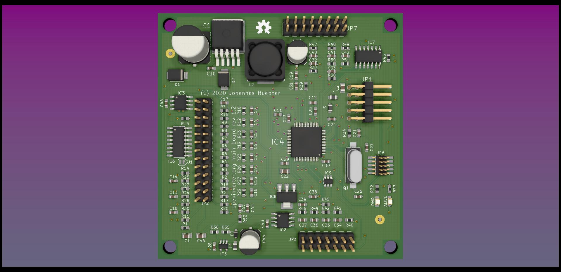

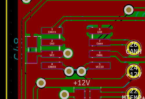

Just realized a tiny glitch: the decoupling cap C48 isn't connected to the CAN drivers GND pin directly. Otherwise it looks really great in 3D :)

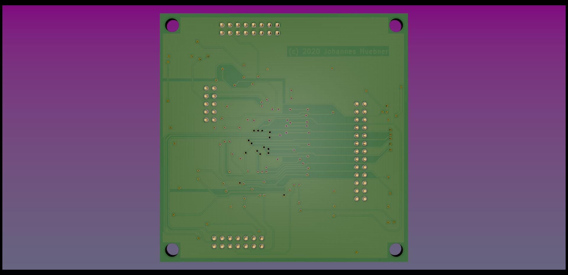

johu wrote: Sun Jan 05, 2020 10:43 pm Just realized a tiny glitch: the decoupling cap C48 isn't connected to the CAN drivers GND pin directly. Otherwise it looks really great in 3D :)
Good spot. I've tweaked the copper pour settings and it joins up now. The conversion scripts I linked to before helped with the port immensely.
As for the copper layer, how about this, could maybe also add "openinverter.org"

doobedoobedo wrote: Sun Jan 05, 2020 11:46 pm As for the copper layer, how about this, could maybe also add "openinverter.org"
Yes, I wasn't aware there was that much space on the bottom. I only always see the busy top side. Can you make it negative, I.e. leave out copper where the letters are?

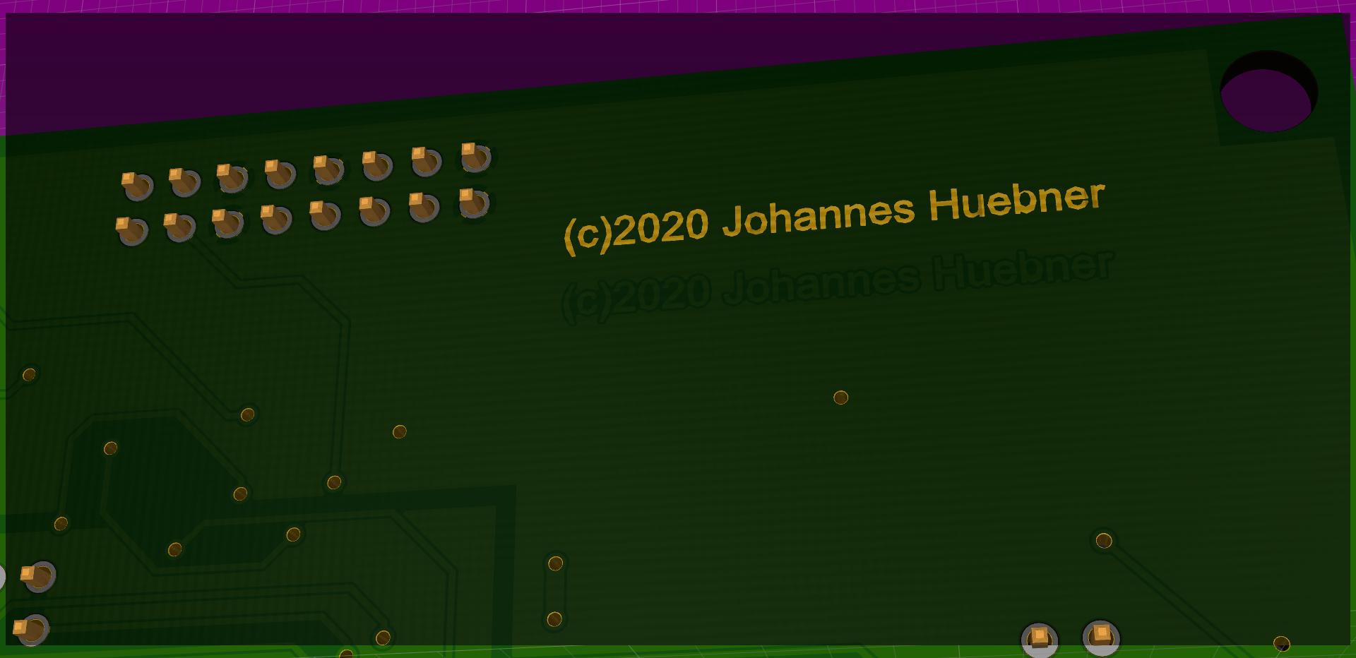

johu wrote: Mon Jan 06, 2020 10:27 am Yes, I wasn't aware there was that much space on the bottom. I only always see the busy top side. Can you make it negative, I.e. leave out copper where the letters are?
It looks like it's possible using a custom footprint, probably generated by https://github.com/mtl/svg2mod. It looks like you can just remove solder mask with that too and make your name all shiny ;).

After much fiddling in inkscape, two footprints, one mask removed, one etched in the copper.

Been thanked: 1914 times
Sorry, forgot to follow up. The solder mask negative looks good. Yes please add openinverter.org to it. Thanks :)
