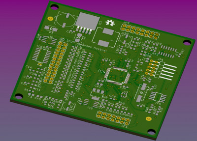

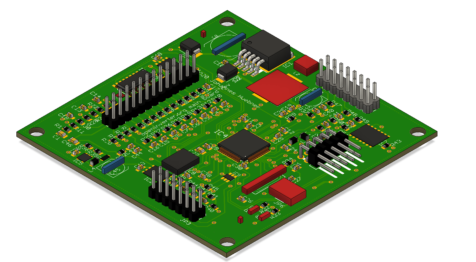

Hey Johannes,
No need for KiCAD for 3D, Eagle and Fusion360 can do it. Some of the parts need models, but quite a lot is already there:

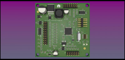

There's an Eagle to KiCAD converter: https://github.com/lachlanA/eagle-to-kicad just seeing how well it works...
doobedoobedo
Posts: 264
Location: UK
Re: Rev 3 main board now fully open source!
Post by doobedoobedo »

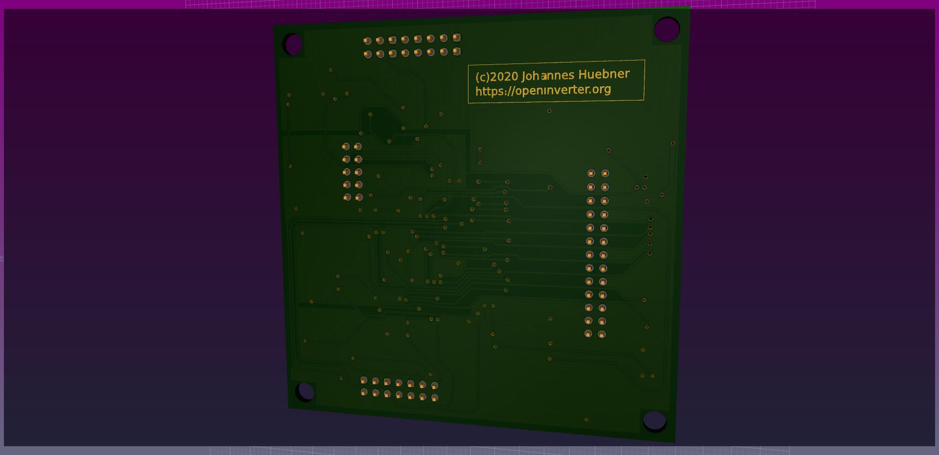

Doesn't look like it does too bad a job
Needs some cleanup and 3D goodness but overall I'm pretty impressed!

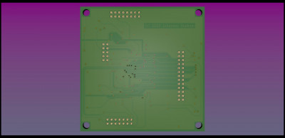

doobedoobedo
Posts: 264
Location: UK
A little more cleanup to package it and I'll put it up on my github.
edit: render after fixing silkscreen for IC9 and mechanical holes.

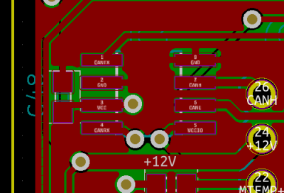

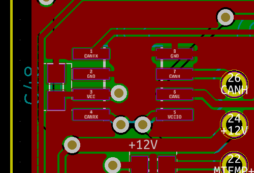

Just realized a tiny glitch: the decoupling cap C48 isn't connected to the CAN drivers GND pin directly. Otherwise it looks really great in 3D :)

johu wrote: Sun Jan 05, 2020 10:43 pm Just realized a tiny glitch: the decoupling cap C48 isn't connected to the CAN drivers GND pin directly. Otherwise it looks really great in 3D :)
Good spot. I've tweaked the copper pour settings and it joins up now. The conversion scripts I linked to before helped with the port immensely.

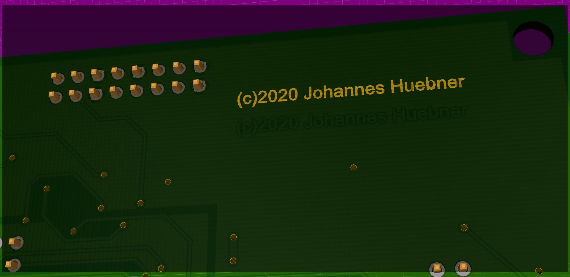

As for the copper layer, how about this, could maybe also add "openinverter.org"

doobedoobedo wrote: Sun Jan 05, 2020 11:46 pm As for the copper layer, how about this, could maybe also add "openinverter.org"
Yes, I wasn't aware there was that much space on the bottom. I only always see the busy top side. Can you make it negative, I.e. leave out copper where the letters are?

johu wrote: Mon Jan 06, 2020 10:27 am Yes, I wasn't aware there was that much space on the bottom. I only always see the busy top side. Can you make it negative, I.e. leave out copper where the letters are?
It looks like it's possible using a custom footprint, probably generated by https://github.com/mtl/svg2mod. It looks like you can just remove solder mask with that too and make your name all shiny ;).

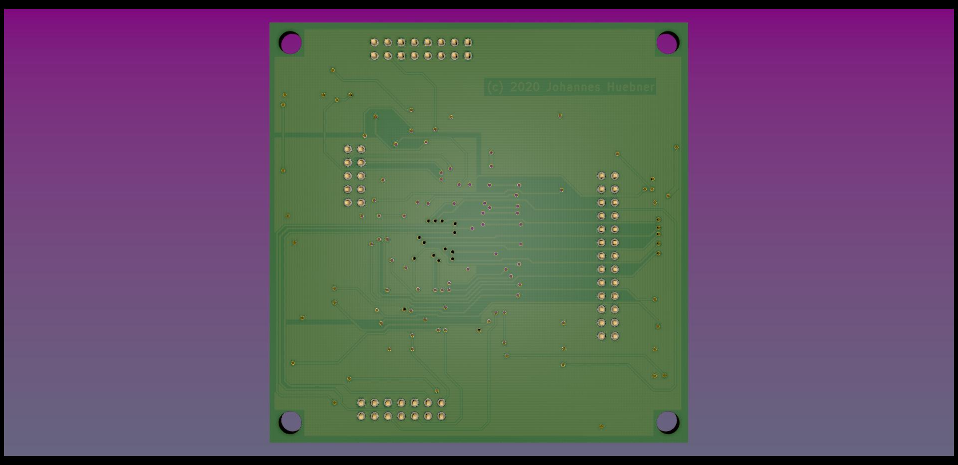

doobedoobedo
Posts: 264
Location: UK
After much fiddling in inkscape, two footprints, one mask removed, one etched in the copper.

Might want to include a link, OpenInverter.org, so people know where to find out more rather than googling his name.

MattsAwesomeStuff wrote: Tue Jan 07, 2020 12:51 am Might want to include a link, OpenInverter.org, so people know where to find out more rather than googling his name.
I suggested that in an earlier post.
I've not made any changes to github yet, but now I have the process for creating the footprints I can add pretty much anything in KiCad. Some fonts/characters don't turn out well from the script though :(. eg. © just comes out as an empty circle.
If Johannes wants either the mask or copper layer footprints added, with or without the URL then happy to do either.

Sorry, forgot to follow up. The solder mask negative looks good. Yes please add openinverter.org to it. Thanks :)

Will be updated on github in a bit. The footprint is completely reusable.
Footprint creation steps:
In inkscape rename the layer 'Mask' (if you want the copper version name the layer 'Cu') and create your text on it.
Create another layer below and draw a box around the text in it.
Select the text and choose the menu item Path|Object to path.
Select both the text and the box behind it and choose the menu item Path|Difference.
Save as file type Inkscape SVG.
In a terminal run 'python svg2mod.py -i /path/to/your.svg' this will create a file named your.kicad_mod - copy this file into a kicad .pretty library folder and use it from there.
I used the DejaVu Sans font as it seemed to turn out quite well. Some fonts work better than others...
