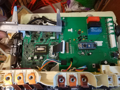

Re: Prius Gen3 Inverter Hacking
Hey Damien, I am building a Prius Gen 3 V1 board. This is the most challenging board I have attempted to populate myself, but I was pleasantly surprised how well it turned out (so far). I got boards made and a stencil for solder paste, put the paste on the board, and placed the surface mount parts by hand. Put it in a reflow oven at work. The result looks great
, and not as hard as I feared. Next is the through hole parts...

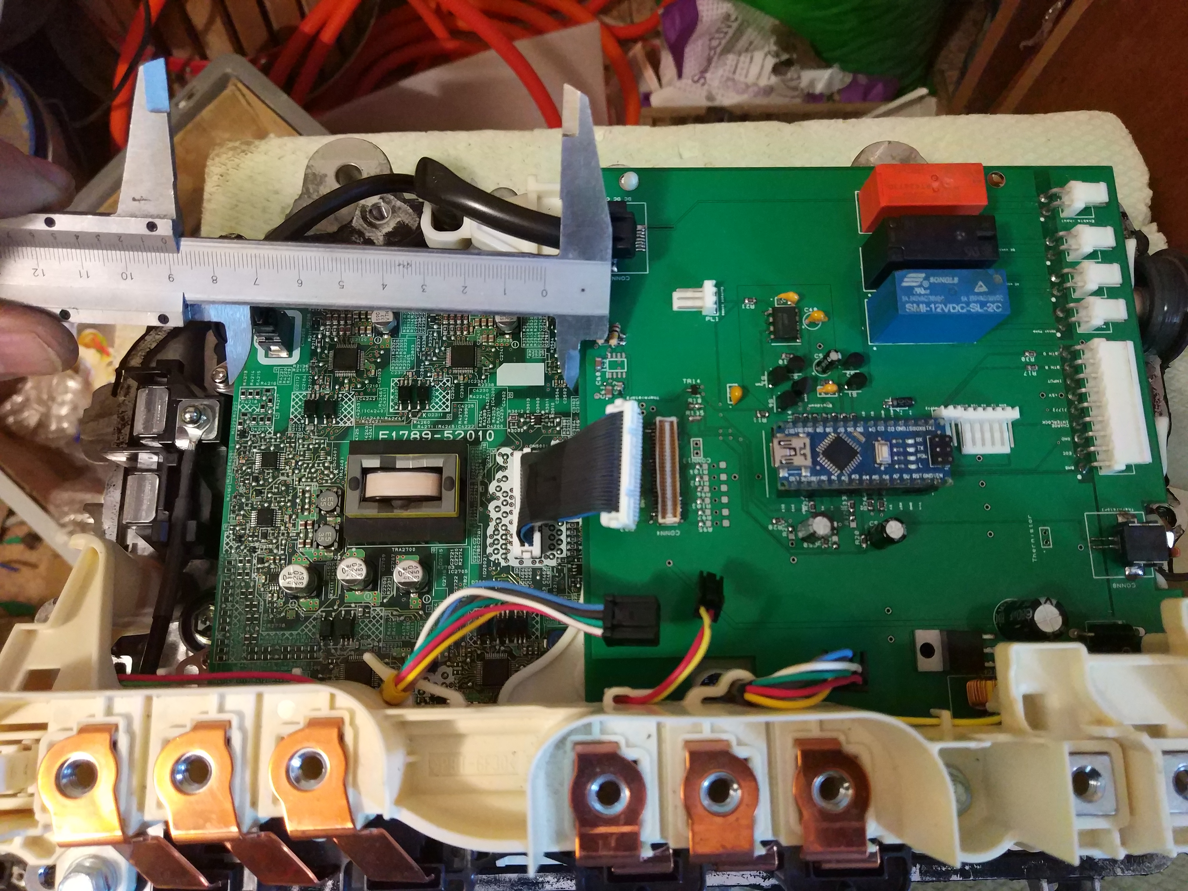

- Posts: 3795
- Has thanked: 166 times
- Been thanked: 411 times
Hi Damien
I am looking at my charger board and the space inverter has left above driver board. I see it is possible to stretch the board quite a bit if we design a hole for the small cable to get through. There is plenty of space left inside. So then using simpler Blue pill chips instead those pesky Q44s would be possible then.

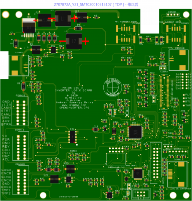

- Posts: 4003
- Been thanked: 1125 times
- Posts: 4003
I'd like to give everyone a much overdue update on the Prius logic board situation. In short, we have a new board and new supply coming on stream. Boards will be available soon (including to those who have been waiting a long time!). The video here gives a full explanation and I expect to be using JLCPCB for all my builds if things go to plan. So, more boards, faster and cheaper:)

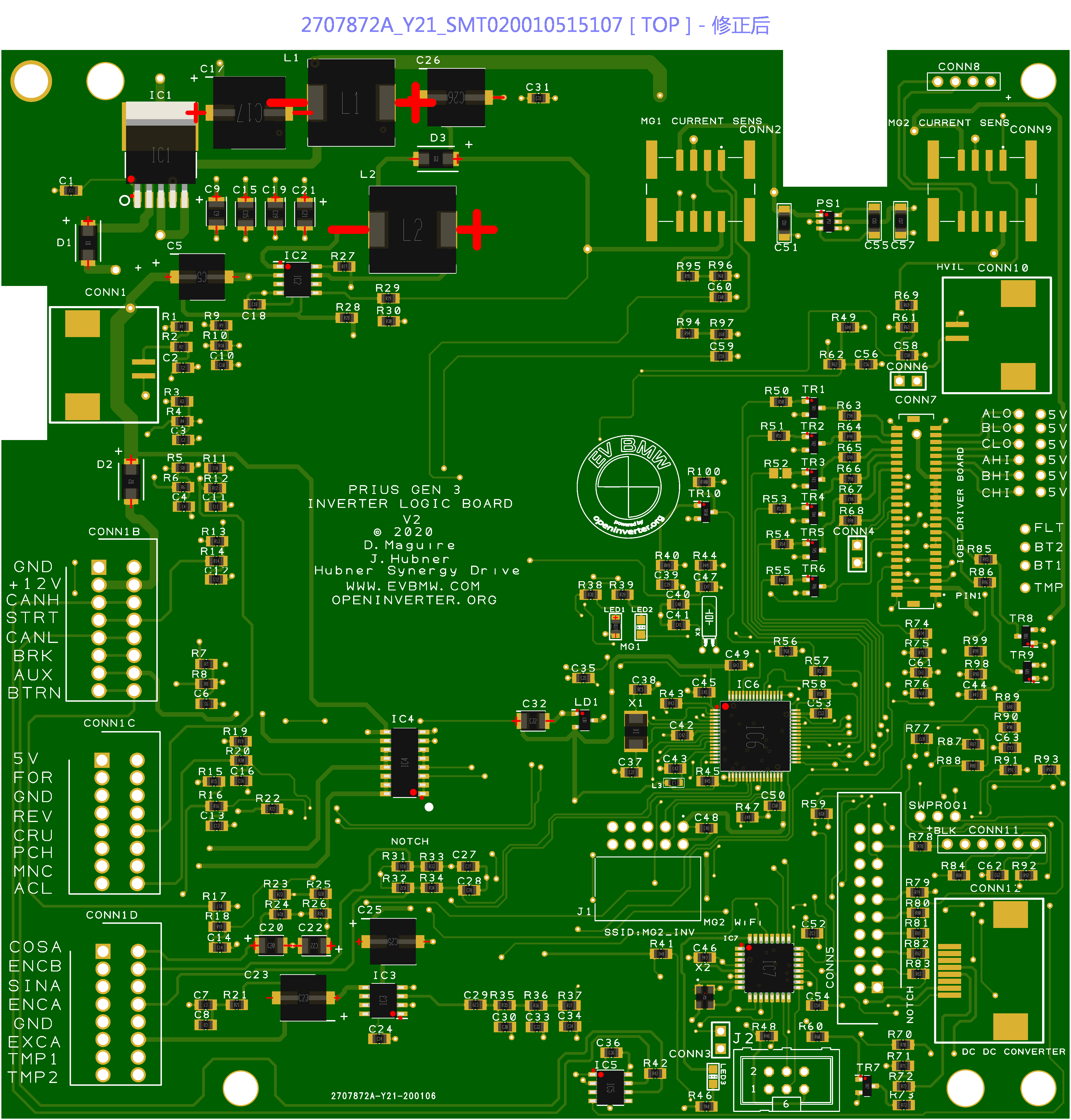

- Posts: 4003
New Gen 3 prius board in production at JLC:)
Looks like this one has so less components - I'm using JLC for at least a year now - they've been great so far. Good choice.
It doesn't look like matching PriusG3_V2 schematic you published earlier - no STM32 (Blue Pill) modules, and just one motor control?
