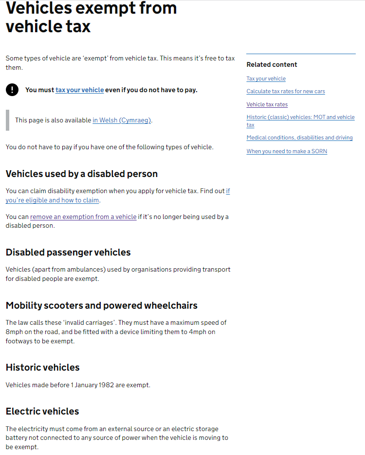

Re: Registering and changing tax class of an EV conversion in the UK
Nice to see the conversation on recycling fuel cars to EV's on a national newspaper, well done Jamie - presume that's you Bigpie
Just a thought - from here:
https://www.gov.uk/vehicle-exempt-from-vehicle-tax
DVLA are 'misguided' in their interpretation of the actual law I wonder if they are also misguided on other tax changes for post 1st March 2001 vehicles for example vehicles used by a disabled person?
Vehicles exempt from tax:
