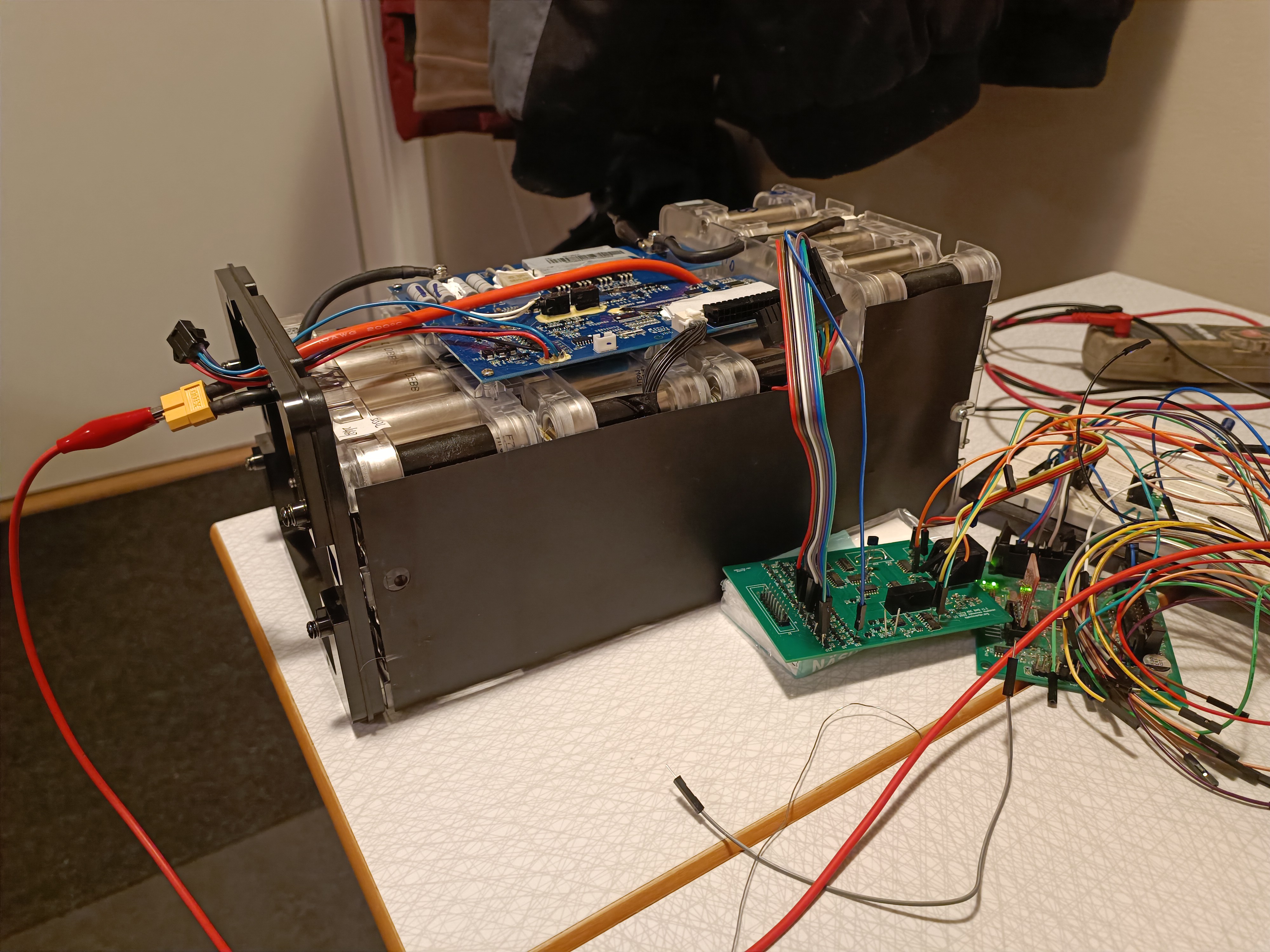

Starting tests with real cells now, courtesy of pm_dawn in Östersund. He borrowed a scooter battery to me which, conveniently is unbalanced and one module is even below 2V. So now I can do some testing of the balancing :)
Accuracy looks very good. Calibrated one channel to the multimeter reading and all others match that as well. You can see a small 0.5mV jitter when voltage is between two digits. Otherwise it is rock stable.
The sinusoidal form comes from the power supply during charging.

Left it running all night in balancing mode. So it measures cell voltage in one cycle, then if it's below average it diverts current from the DC/DC converter otherwise it bleeds current.
As you can see it has brought down the delta from 16.5 mV to 13 mV but bumping up low cells didn't really happen.
It does make the effort as you can see on cursor 1 and 2 where it brings the voltage up from 3548 to 3570 mV (22 mV delta). In contrast dissipative balancing bring the voltage down from 3585 to 3.515 mV (70 mV delta). Keep in mind this is behind the multiplexer so a lot of that will be mosfet turn on resistance.
Right now balancing resistors are 2x47R, I will bring them down to 2x22 on the next rev for bleeding and 1x22 for bumping up. I could also try shorting one or both, what could possibly go wrong ;)

Good news: I have reduced the total balancing resistance to 22 Ohms and that makes balancing more effective. Can bump up cells with 60 mA now and discharge with... well would have to do the arber method ;) (actually have done so before to measure bleed off current)
More good news: I have tested with all 16 channels and it works a treat :)
Bad news: One module, like said was sitting very low and I bumped it up with my lab supply. I was wiggling the banana plugs a bit and suddenly the Analog Discovery was on fire (what's that, the 5th?) and my laptop shut off. Aftermath: laptop right hand side USB connectors dead but laptop alive. Analog Discovery: dead. BMS board: Alive :)
Cause: the negative cable inside the power supply had wiggled loose and made contact with PE. Laptop is also on PE, Analog Discovery on PE and said negative cable was on cell 16 or about 60V and now suddenly on PE.
I have a spare right hand side sub board for the laptop back in Germany (hmm, how come?) so that's an easy fix. The AD will set me back 375€ at digikey. The inevitable cost of HW development...

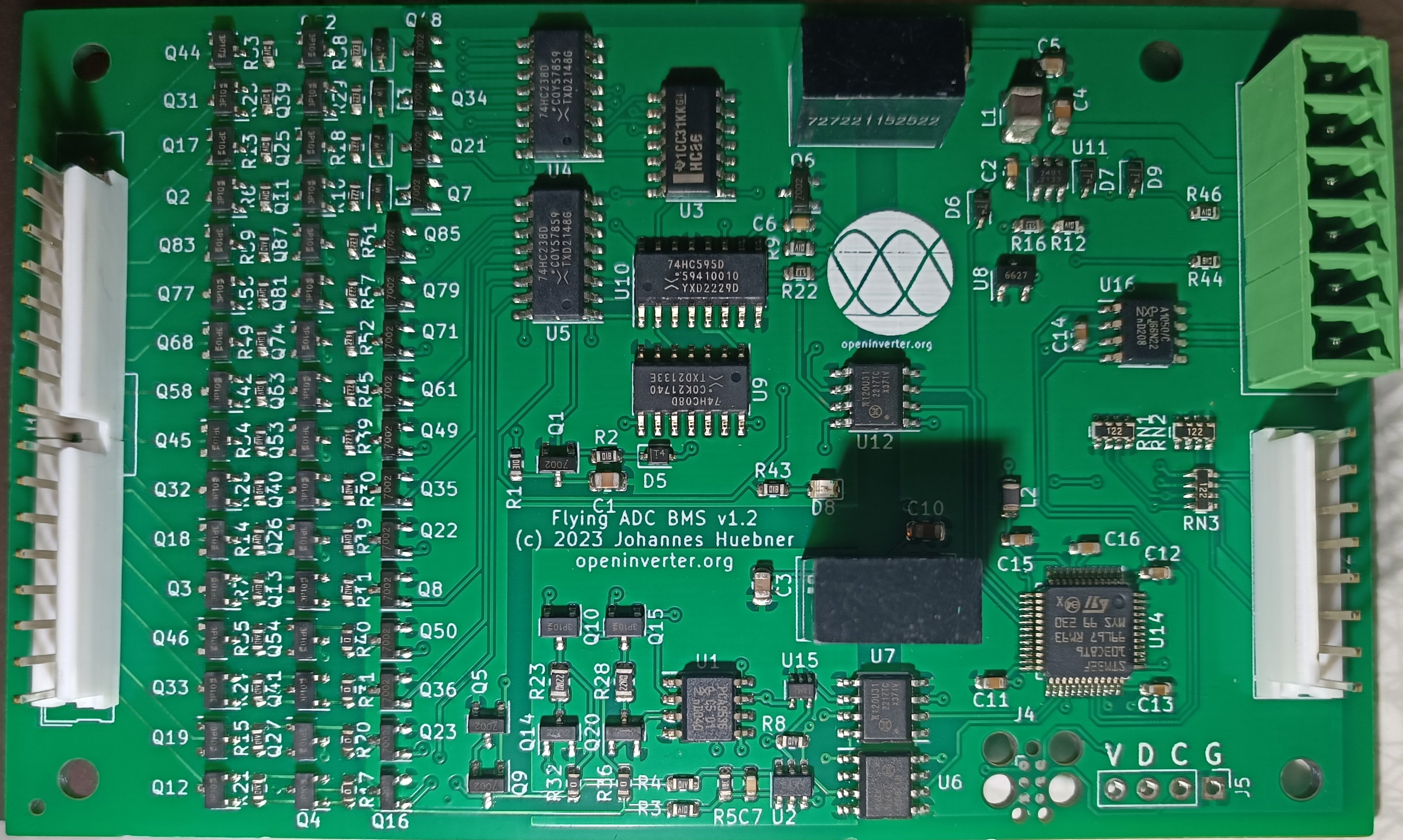

New revision, more mistakes made :(
The most annoying one: I specified the wrong part number for all 10k resistors and now they are all 1 Ohm! Quite a few of them used. With that fixed everything powers up but the mux has glitchs. My little reset circuitry needs adjustment. With that fixed the mux works as before. I2C comms also works.
I think I should break out a the serial port to get the console back, doing it all via CAN is clumsy right now. But maybe it speeds up CAN development, most of all the boot loader.
Will now change all the pull-up resistors in the mux and then connect the battery back up.

Hooked up Dave tool:

Currently doing a balance run to see how the delta develops.
Found a hardware issue: if you falsely connect two or more cells across one channel the excess voltage will conduct through the limiting resistors and diodes of the balancing bridge into the poor components of the 5V rail, destroying them. As long as the mux doesn't switch you can hook up anything you want (below the FET breakdown voltage).
So a) I need a TVS across the 5V rail and b) the software needs to check for excess voltage in the fastest ADC mode where it only briefly connects all channels to the mux

Having some new ideas about input protection. So TVS for limiting voltage on the ADC power rail to about 6V and then a TL431 reference triggering at around 5.5V via the remaining free channel of the digital isolator. That then triggers a pin change interrupt which turns off the multiplexer and signals an error. Turning off the multiplexer takes around 100 us, I hope the TVS and transistors will hold up that long. The maximum voltage supported is about 70V, if that rushes in via the 22 Ohm limiting resistor + FET losses we are looking at 3A for 100 us. Anyone savvy enough to calculate heat dissipation?
Also thinking about supplying the mux control with a high voltage linear reg, would result in a continuous draw of about 1 mA from the cells. Maybe not the greatest idea but deploying a 200 mA DC/DC converter for delivering 1 mA seems wasteful as well.

And after 72h we're done, down to 3mV delta.
uavg                :    4048.41 [mV]
umin                :    4046.44 [mV]
umax                :    4049.94 [mV]
udelta              :        3.5 [mV]
utotal              :    64774.7 [mV]
u0                  :       4047 [mV]
u1                  :    4048.19 [mV]
u2                  :    4048.19 [mV]
u3                  :    4048.19 [mV]
u4                  :       4047 [mV]
u5                  :    4046.44 [mV]
u6                  :    4046.44 [mV]
u7                  :    4047.59 [mV]
u8                  :    4049.34 [mV]
u9                  :    4048.78 [mV]
u10                 :    4049.34 [mV]
u11                 :    4049.34 [mV]
u12                 :    4049.94 [mV]
u13                 :    4049.34 [mV]
u14                 :    4049.34 [mV]
u15                 :    4049.34 [mV]
So over all 0.7 mV/h now. I think there is still some optimization possible with the resistors, e.g. 10 instead of 22 Ohm. Bleeding runs through two of them, 44 Ohm, charging runs through just one.

To round off the little science project, here's some diagrams.
Individual cell voltages:
Obviously one was way out, the others already close
The essence of that:
Lowest cell started out at 4041 mV, highest at 4097 mV. Final average cell voltage is 4049 mV. So instead of dissipating 15 cells down to 4041 mV we just needed to dissipate 7 cells down to 4049 mV while the others were taken up to 4049 mV. Also we see the balance target drop from 4051 mV to 4049 mV because we took the highest cell down quite far. That why towards the end the min voltage drops again. The strategy of first taking high cells down to the average, then bumping low cells up would prevent that.
