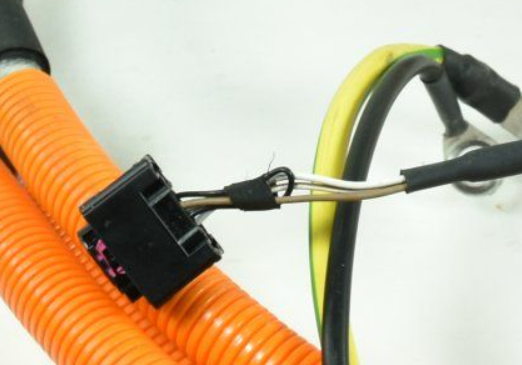

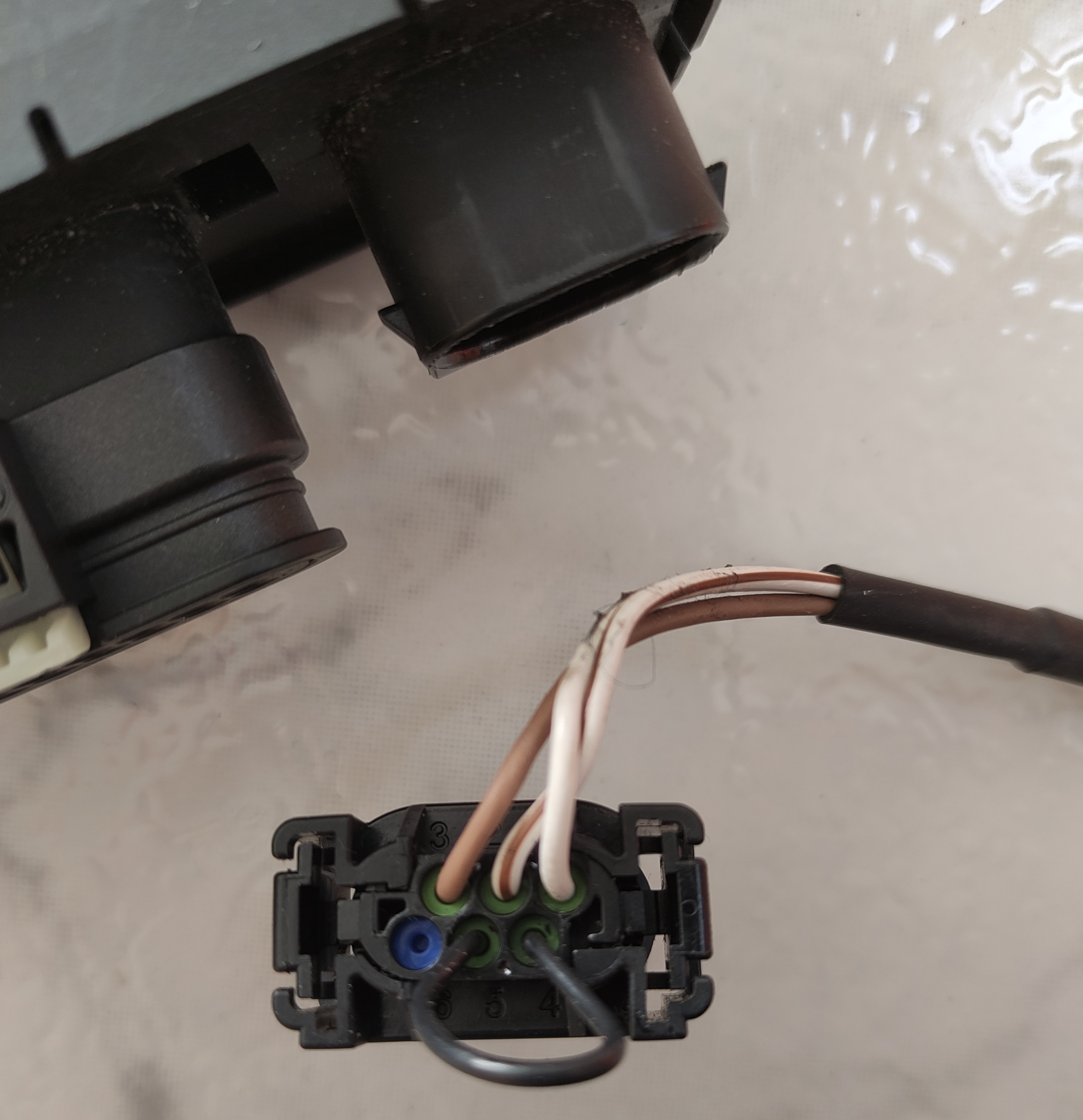

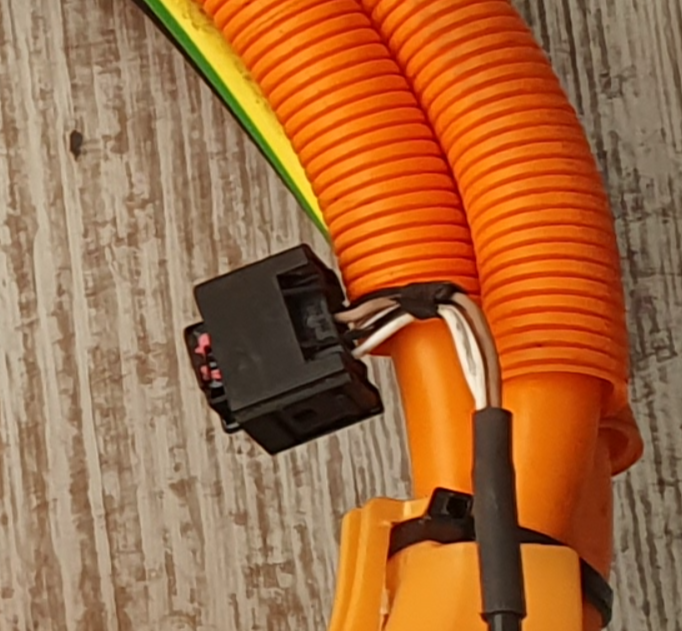

Folks,
The LIM 2B connector pinout assigment as described on the Wiki seems a bit weird to me:
2B Pinout:
2B-1 CP Pilot (charge port) ~620 ohms to GND is needed if no original i3 charge port is used!
2B-2 PP Proximity (charge port)
2B-3 Jumper Connected to Pin 4
2B-4 Jumper Connected to Pin 3
2B-5 GND Ground (charge port)
2B-6 US CCS1 version connected to 2B-2

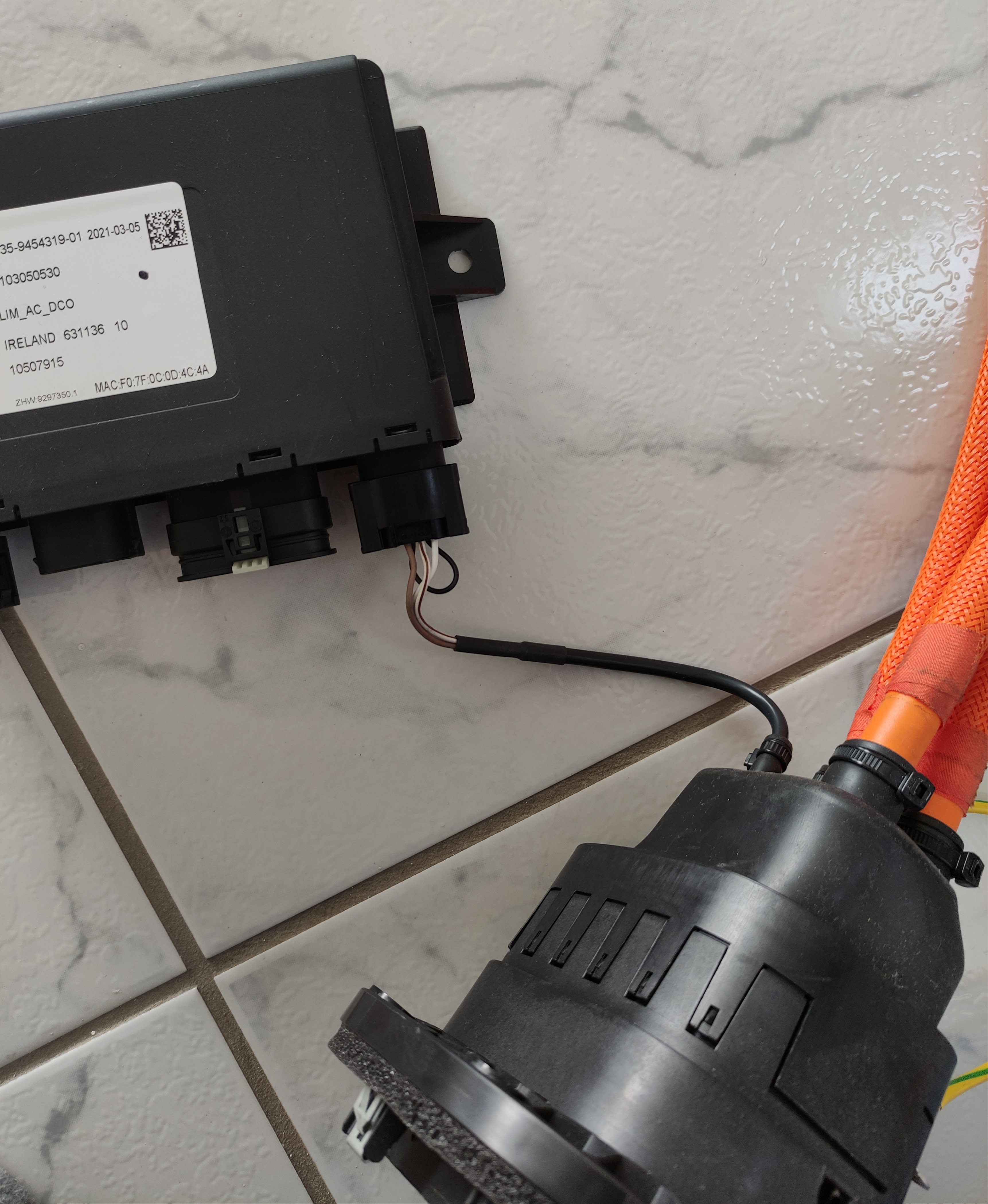

I have a EU SPEC BMW LIM from a Mini Cooper SE 2021 with its CCS cable loom and from what I see on the original 6pin 2B plug going to the LIM is that the jumper is between 2B-4 and 2B-5:
2B Pinout:
2B-1 CP
2B-2 PP
2B-3 Ground
2B-4 Jumper to 2B-5
2B-5 Jumper to 2B-4
2B-6 N/C
if someone can confirm this typo on the WiKi I will be glad to correct it.
See the picture below for reference:
Jeff - FRANCE & GERMANY

muehlpower
Posts: 807
Has thanked: 18 times
Been thanked: 186 times
Post by muehlpower »
I have a 2016 and a 2020 LIM. Both have ground on 1B/3+10+14, 2B/4+5, 4B/9+10. So a bridge from 2B/4 to 2B/5 would be useless

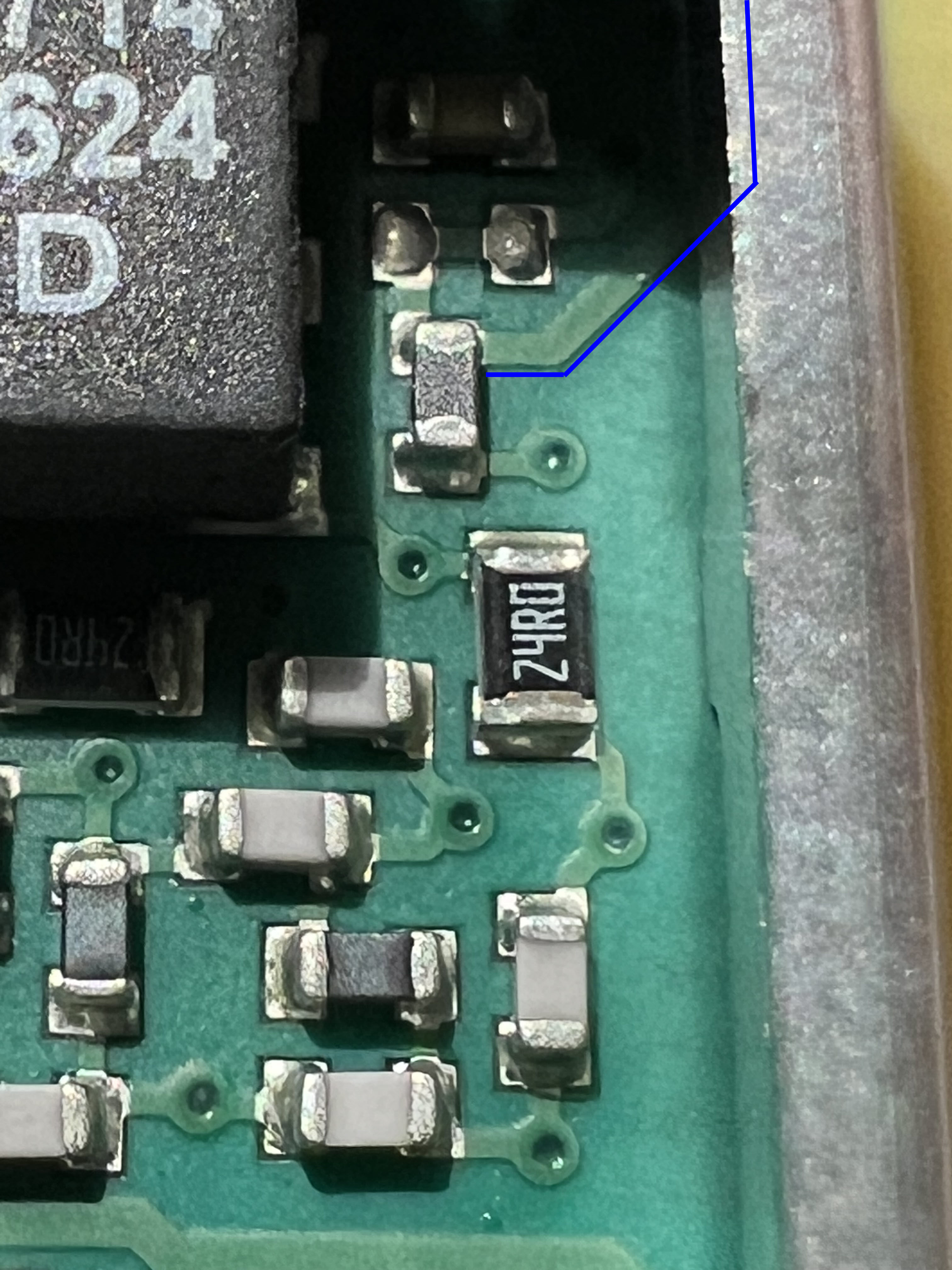

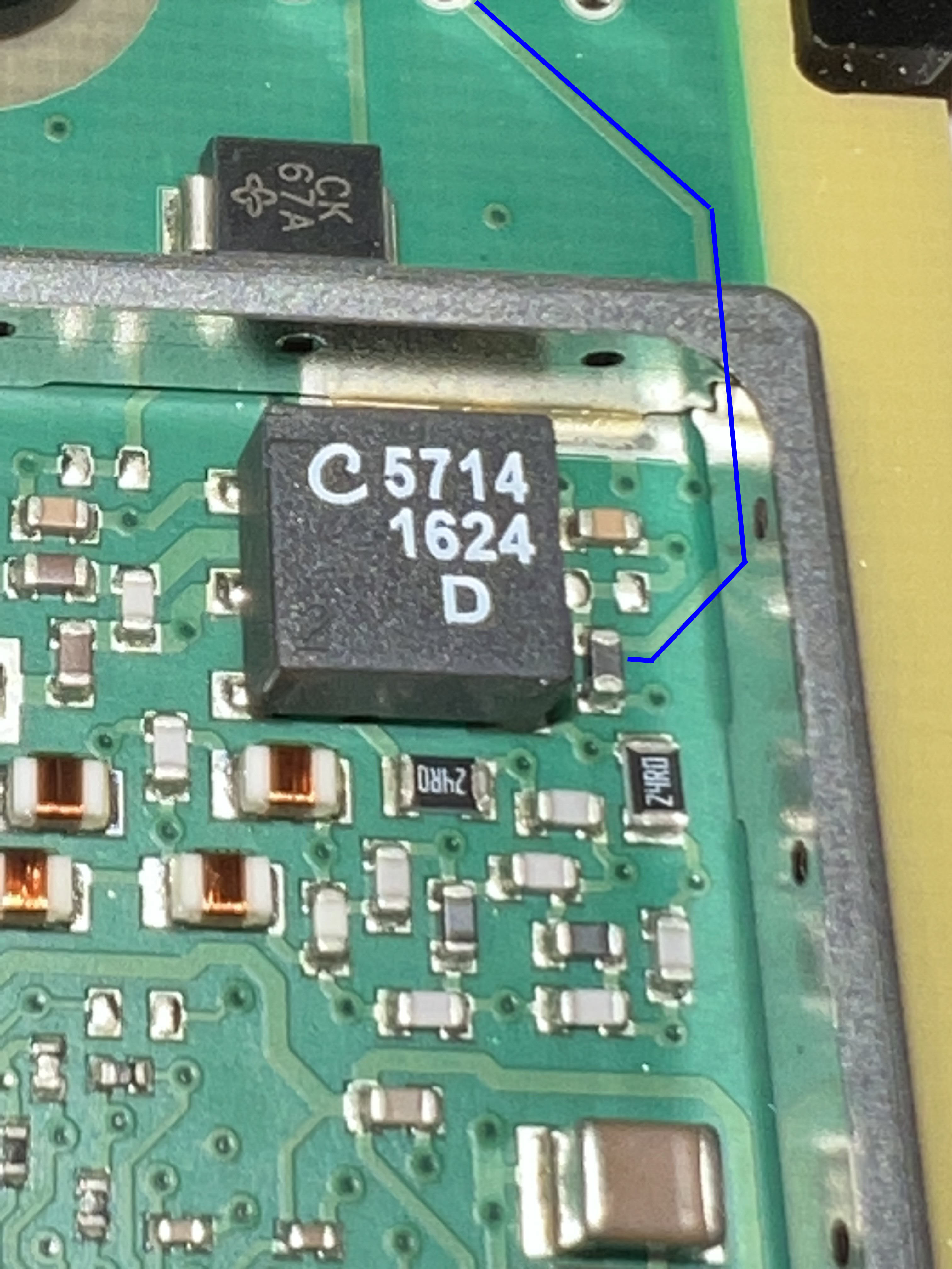

2B-4 & 2B-5 measure at Ground potential when the LIM is unpowered, but looking at the PCB of my ...052 (2016) LIM, those pins do not appear to route to the same place, so I'd be wary of assuming they're internally connected to Ground just because they appear to have zero resistance with respect to Ground (at least, when unpowered).

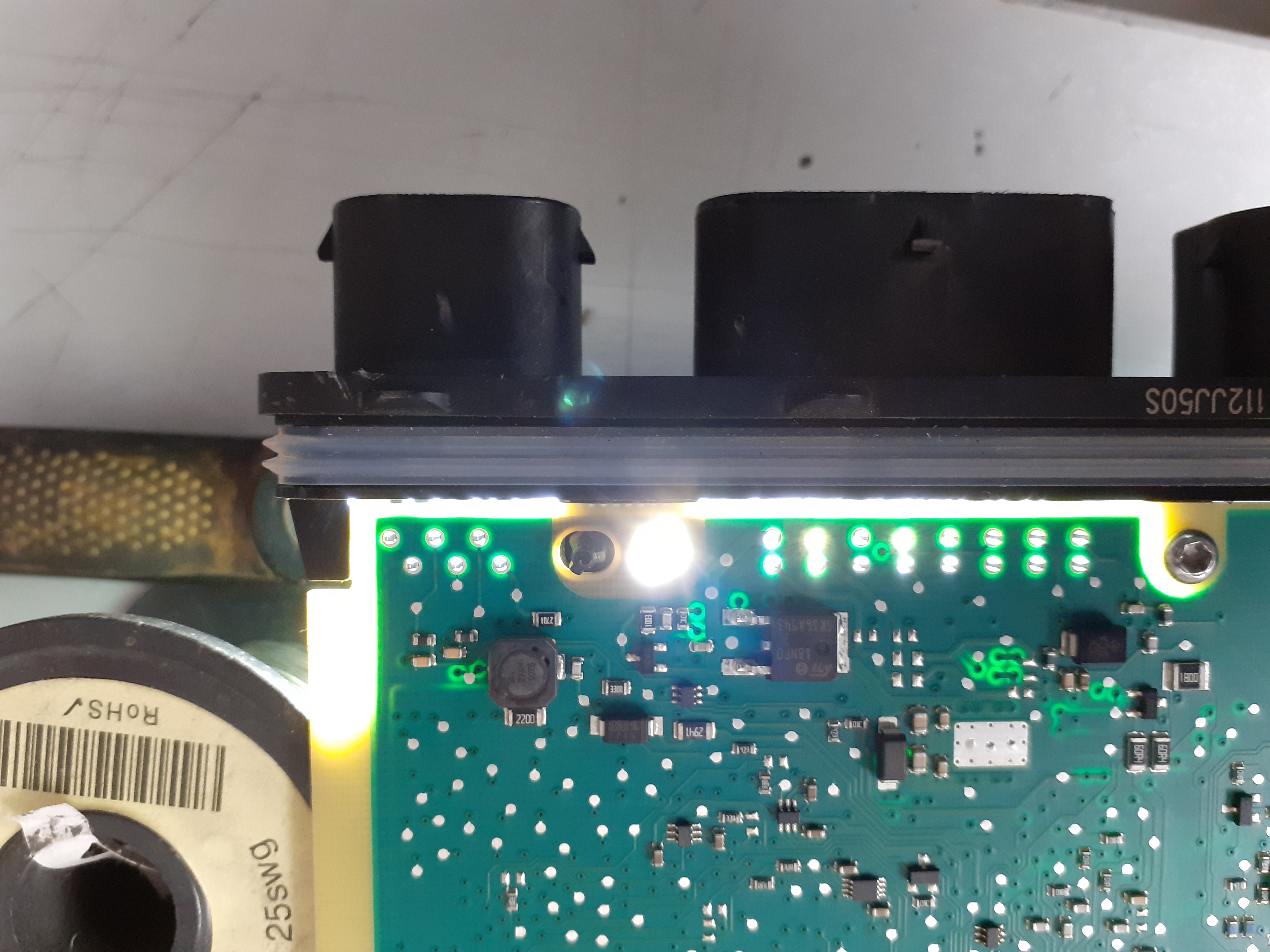

I checked the schematics again and looked at the board of my LIM. On the BMW I3, 2B/5 is connected to a ground point via the shield. 2B/4 has no visible connection, probably leads to the ground layer. This means that in both cases 2B/3 and 2B/5 are connected to GND

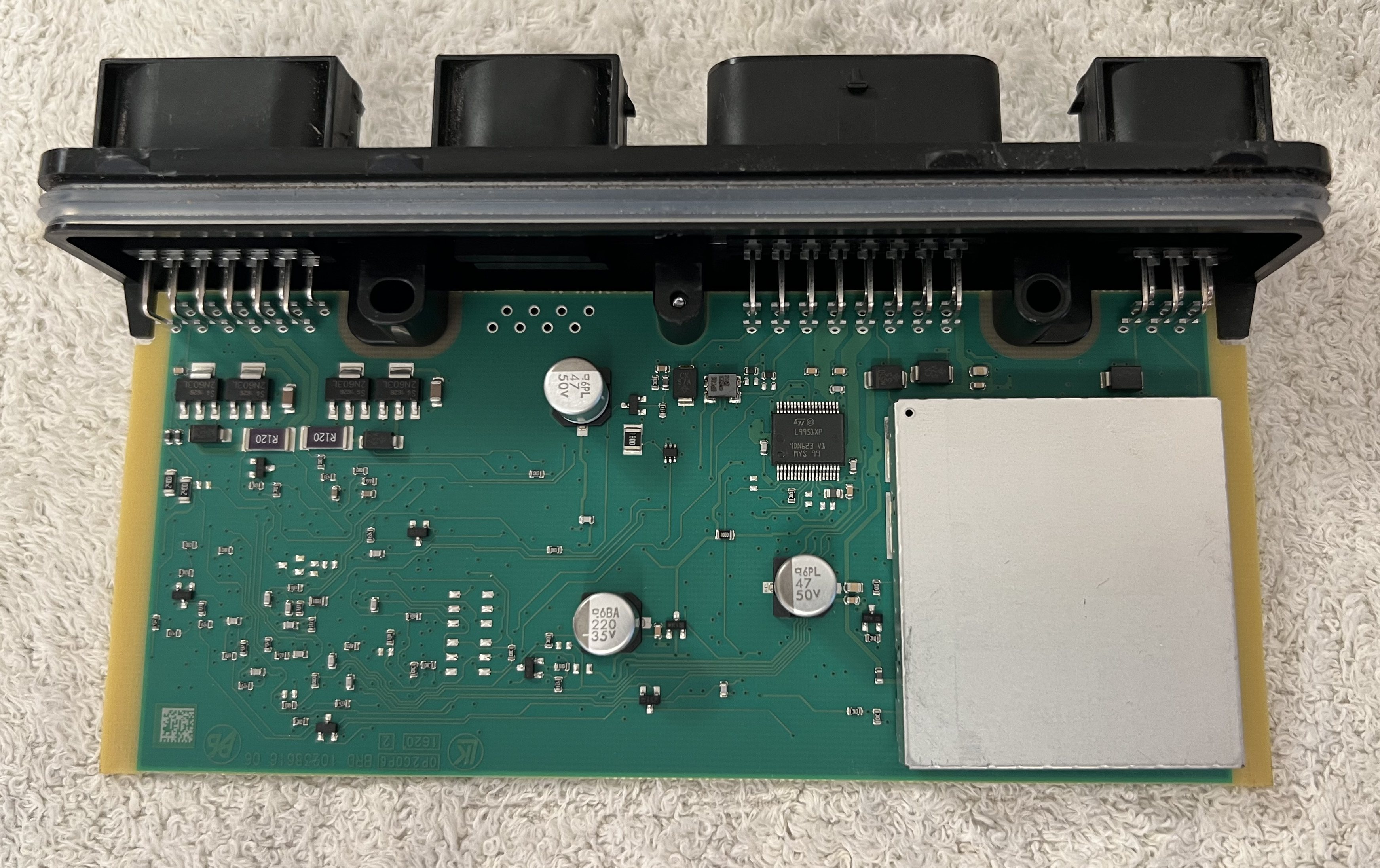

BMW i3 LIM ...052 (2016)
Seems an odd, round-about way to ground a pin, when the ground plane is straight down ;)
I can't ID this SMD, but I don't think we can assume that 2B-5 is explicitly grounded itself, and Sidemips' OEM harness does has an explicit jumper to the grounded 2B-4 for some reason, I assume.
It looks to me to be some external way to configure an option.

Sidemips
Posts: 8
Joined: Tue Jul 26, 2022 5:33 pm
Location: FRANCE+GERMANY
Post by Sidemips »

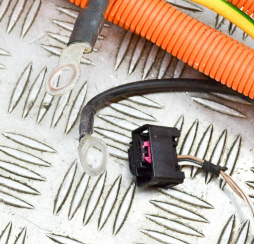

...No such jumper to be seen on OEM harnesses for the i3 (even for MY2021) ... only on the MINI !
I was wrong I found better pictures on the Internet, there IS a jumper on the I3 OEM harness... between 2B-3 and 2B-4
and the charge socket ground pin is on 2B-5... my apologies !

muehlpower
Posts: 807
i think it makes no difference. On the BMW, pin 2B/5 is connected to GND via the shield, on the Mini via 2B/4. 2B/3 is connected to GND via 2B/4 on the BMW and externally on the Mini.
In the end, GND is on 2B/3 and 2B/5, regardless of whether 2B/5 is connected to GND in the LIM.

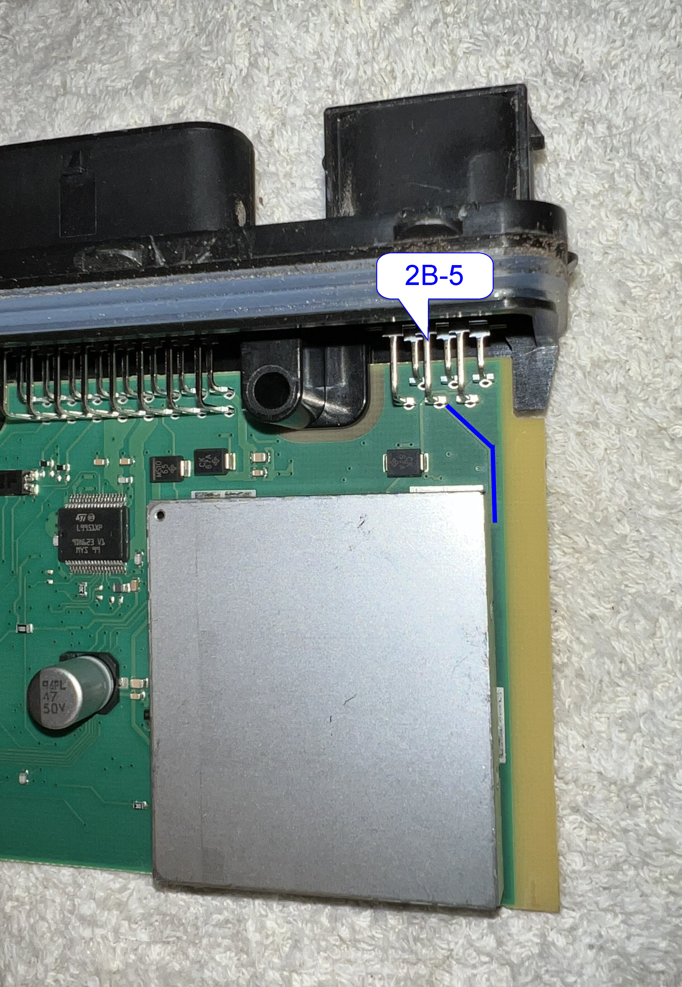

That may not be the case. Here's a close-up of 2B-5's trace termination:
BMW i3 LIM ...052 (2016), 2B-5 trace termination
Most DMMs are notoriously inaccurate when measuring very low resistance values (below 1 ohm), so I don't trust my Fluke 23 when it reports zero ohms between shield and 2B-5; it's possible that's eg a 0R1 SMD, and my test equipment wouldn't necessarily report that value.
muehlpower wrote: Sat Jan 21, 2023 12:46 pm 2B/3 is connected to GND via 2B/4 on the BMW and externally on the Mini.
I'm confused. Unconnected to a harness, 2B-3 is not connected to GND on my ...052 (2016) LIM; in testing, it's a capacitive circuit connection with respect to the shield, and also to 2B-4. Are you saying that on both the BMW and on the Mini, the vehicle harness (externally) connects 2B-3 to 2B-4? I don't have access to BMW wiring documentation, so I'm relying upon the Wiki.

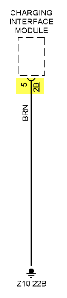

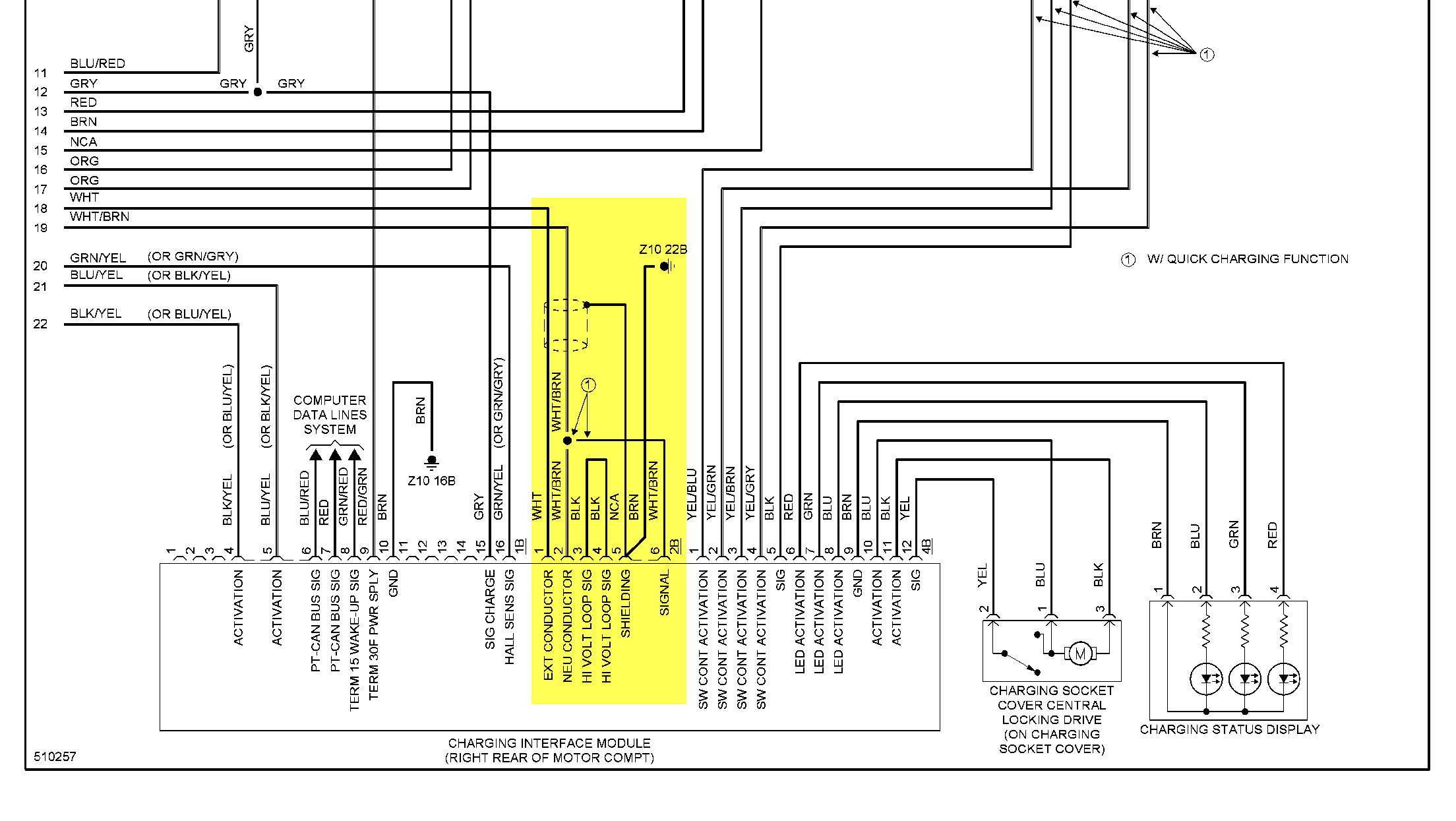

I splurged and "bought" some fairly poor documentation for 2016 BMW i3 (USD$27 for download) . . . and it agrees -- in at least two different wiring locations -- that 2B-5 is grounded at the chassis:
(fragment from pg. 2554 of the manual, help yourself)
BMW i3 (2016) LIM wiring misc.
Further on (pg. 2574)
BMW i3 (2016) LIM 2B-5 ground
That fragment does agree with the current Wiki pinout, and does not agree with the 2B-4 <-> 2B-5 harness loopback on Sidemips' OEM harness for the 2021 MINI, so rather than changing the Wiki LIM pinout, perhaps it should be noted there that that LIM apparently has a different pinout function.

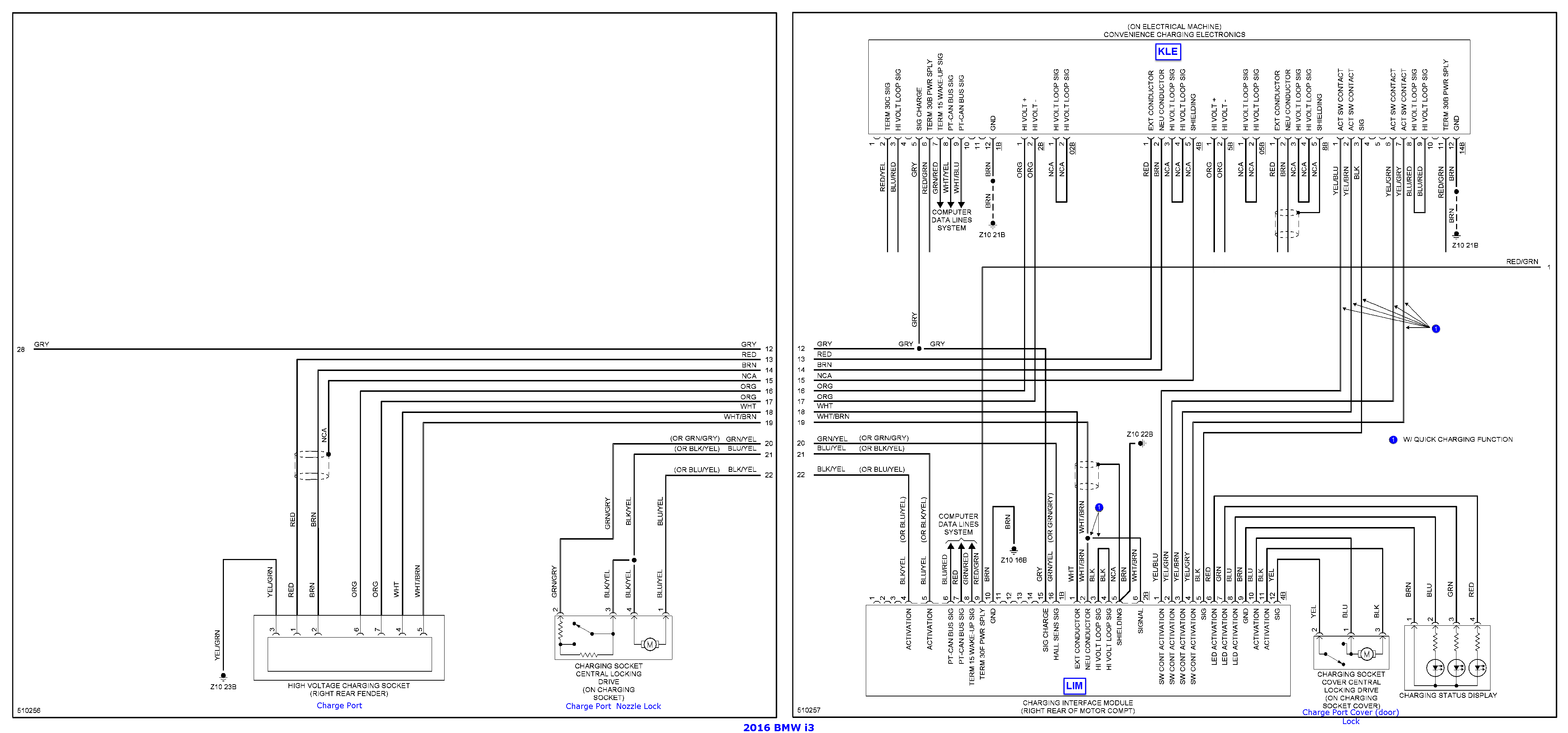

I've simplified (removed extraneous wiring to other modules) the DCFC CCS wiring diagram I've "purchased" and added it to the Wiki.
BMW i3 (2016) DCFC CCS wiring diagram (simplified)
