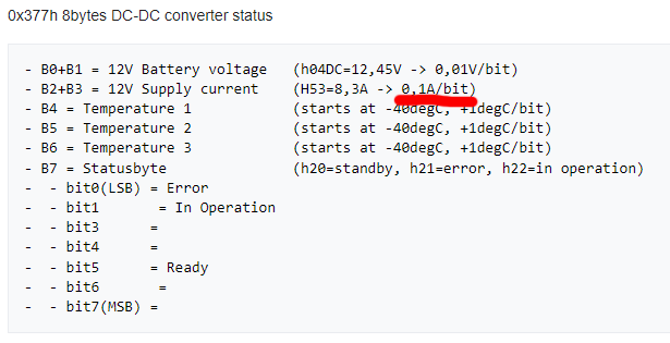

OK, I have a question........
In the code the message 377 is decoded
void canRX_377(const CAN_message_t &msg)
  charger12vbattryVolts = float(((msg.buf[0] * 256) + msg.buf[1]) * 0.01);
  charger12vCurrent = float(((msg.buf[2] * 256) + msg.buf[3]) * 0.01);
  chargerTemp1 = msg.buf[4] - 40;
  chargerTemp2 = msg.buf[5] - 40;
  chargerTemp3 = msg.buf[6] - 40;
  chargerStatus = msg.buf[7];
  avgChargerTemp = (chargerTemp1 + chargerTemp2 + chargerTemp3 + chargerTemp4) / 4;
but in the wiki 377 is defined as
Is there a scaling issue? It seems sensible to me as the charging current is only showing as 0.5A with a dead dead battery......

Post by EV_Builder »
What does your current clamp say?
If it says 5 it's an copy paste error.
If it says 0.5 the wiki is wrong.
