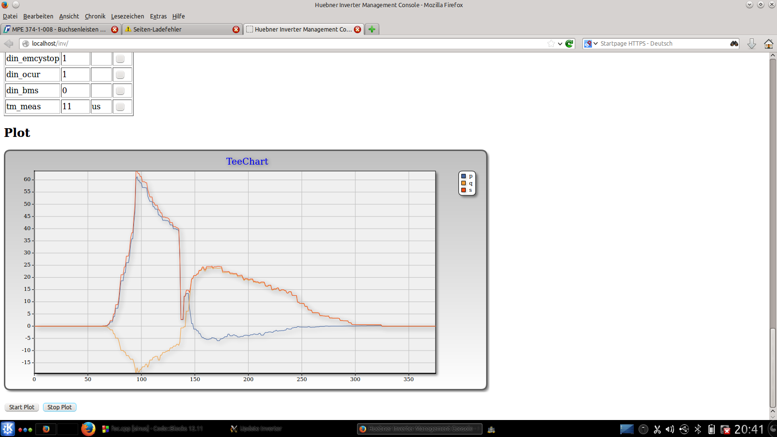

Probably a bit late to the party but I remember way back I had applied Park/Clark in my Polo to calculate active, reactive and apparent power. It seems I was successful in doing so as this plot denotes:
The file is dated 13/3/2014
I remember I just used motor angle + slip angle for the transforms.
I can't find the source code at the point in time. It must be somewhere here: https://github.com/tumanako/tumanako-in ... 2_sine.cpp (back then the control code still resided in the main file). Will keep looking, maybe it somehow helps.
EDIT: found it, it was done in the 1Ms task :)

johu wrote: Sat Feb 11, 2023 5:23 pm Probably a bit late to the party but I remember way back I had applied Park/Clark in my Polo to calculate active, reactive and apparent power. It seems I was successful in doing so as this plot denotes:
https://github.com/tumanako/tumanako-in ... e.cpp#L301
Good results there, looks a lot like some of my plots of transient states.
The code is basically the same as mine (though your library has improved and made it easier for me): https://github.com/catphish/stm32-sine/ ... L188..L192
Also worth noting - you knew how to calculate Is (ilmax) all along, although I guess doing it this way is a bit expensive compared to my hypot3 method.
