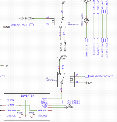

I am not sure if this came up before or on different thread...
Can you advise how to connect ignition signal for inverter. I see that we need to activate a precharge relay and contactor at some point in start. But would we have to activate the internal inverter logic before or after precharge? Can you confirm my assumptions?
1. We have a permanent 12V/GND connection to inverter.
2. We use IGCT signal to activate inverter on precharge by a latching relay triggered by "start" key position which will keep it alive
3. If we need to use emergency off signal we can wire IGCT through normaly closed NC contacts of notaus. That will disable inverter while rest of the car will still function.
I need to setup the succession logic for my inverter.

Here is a wiring diagram of my setup that help:
The logic being the inverter gets +12v via my ignition change over over relay, this relay is NC to the ignition switch and NO to the type 2 socket PP pin.
Inverter RSDN is connected to BMS main contactor out via relay so the BMS can safely shut down the inverter if needed.
The inverter starts up very quickly so there is no need for any delays.

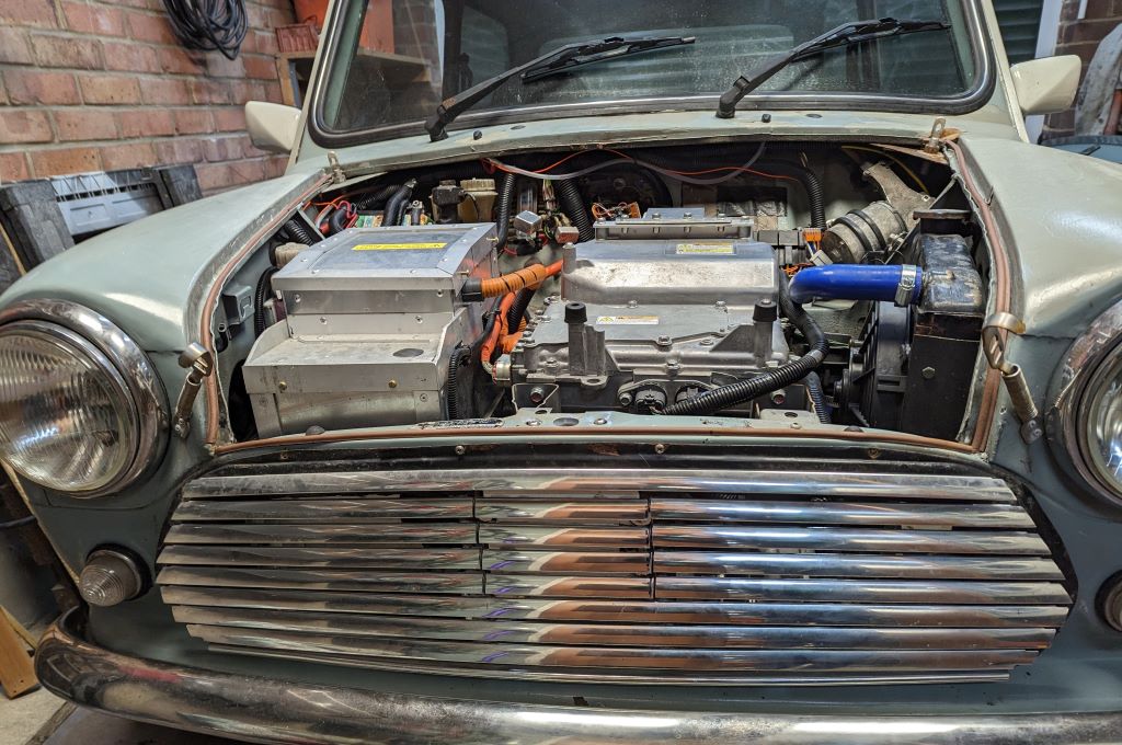

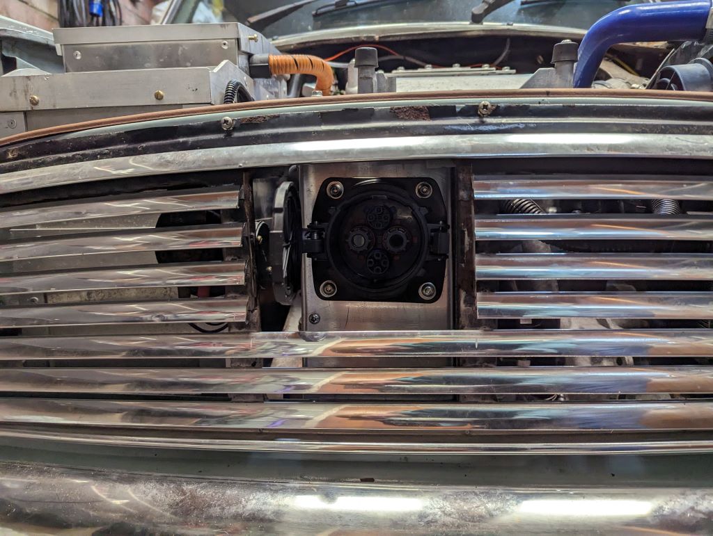

Some progress, new boards built and socket contactors and other bits installed some wiring left and of course a lot of code and de-bugging to done!JamesWLG wrote: ↑Wed Mar 01, 2023 10:21 am Hope the garage is warming up, I'm keen to use Chademo myself.

Well that was unexpected. I didnt know RSDN pin is effective when connected to 12V. So i tried a simple code from Damien first and it worked. Damn that motor is responsive.aot93 wrote: ↑Wed Mar 01, 2023 7:02 pm Here is a wiring diagram of my setup that help:

Ok another question @aot93;
Can you let us know how you inhibit inverter when charging? By which function? I would like to add a physical signal sensing and charging to this main VCU. I would like to use PP signal to detect charge phase. I dont use teensy BMS module and i will make my own interface...any day now
I see there is a constant int preparead but i dont see it leading anywhere.
So i will need to replace PP pin sensing and integrate charger command message 0x286 which is important for running motors as well.
Looking through the main VCU code i cant seem to find easy wasy to use a pullup with PP pin. Every input seems to be opto isolated and positive trigger signal. This means i would need to use another VCU in that stead? Do you have a suggestion to transform that particular signal to pullup gnd sensing signal?

Good job spinning the motor it's nice to have confirmation we can use inverters and motors from different cars
Inverter inhibit is in two ways
1, RSDN is pulled high via the BMS
2, message 0x287 byte 6 is set to 0x00 the inverter will not run if this byte is not 0x03
AS for PP detect i used an AT tiny for this job because at the time the teensy deep sleep was not working so well, the ATtiny is always on in deep sleep waiting for the PP to pull a pin low, this can then switch a relay and power everything else up so no need to turn anything on manually for charging.
I put provision in the code to have PP in there but ended up not using it as my thinking was the BMS should be in control of the state of the VCU, so only allowing drive modes when battery status is good and not charging.
Having said that it would be possible to bypass the opto isolator on an input by adding a jumper wire to the board, of course there would then be no protection to the teensy's fragile inputs!
Removing the BMS dependencies is possible (i have test version with these removed if want) but you will need add the checks in else where.

Recently i had a lot of back and forth with aot93 because of my ignorance of his VCU system process. I have decided it would benefit all if i write here how the code should work and my experience. Aot93 let me know if i missed something.
I assume the use of only VCU, not BMS or other support boards.
VCU connects to inverter and receives reports about votlage and current, so CAN2 lines are connected to inverter.
Main process streamline is as follows:
1. We provide ignition 12V supply to VCU from the key
2. VCU must be in Drive Neutral or Charging State for contactors to go on
- Negative Contactor OFF
- Negative Contactor goes ON
- 500ms Wait > Precharge and Positive are OFF
- Prechage turns ON
- 1000ms Wait
- Inverter reports Voltage for VCU > BMS_PackVoltage -5v
- Main contactor ON
- Wait 500ms and Check all contactor are ON
- Turn Precharge OFF
4. Provide Forward signal to roll out
To enable neutral mode:
- Start and Brake must be ON
- direction FWD and direction REV must both be OFF
- Start and brake can be relesed as VCU changes to state 3
I might change this so VCU will be allways powered as PP signal will have to be a simple pulldown
DC contactor will be latching so when precharge is done this will be locked and the only way to remove HV will be to turn off 12V from the key.
- Prechage turns ON
- 1000ms Wait
- Main contactor ON
- aot93

Thanks all looks good.
I open the pre-charge as I burnt a few resistors and wanted to try and stop it, turns out it was just super poor quality resistors breaking on their own!
