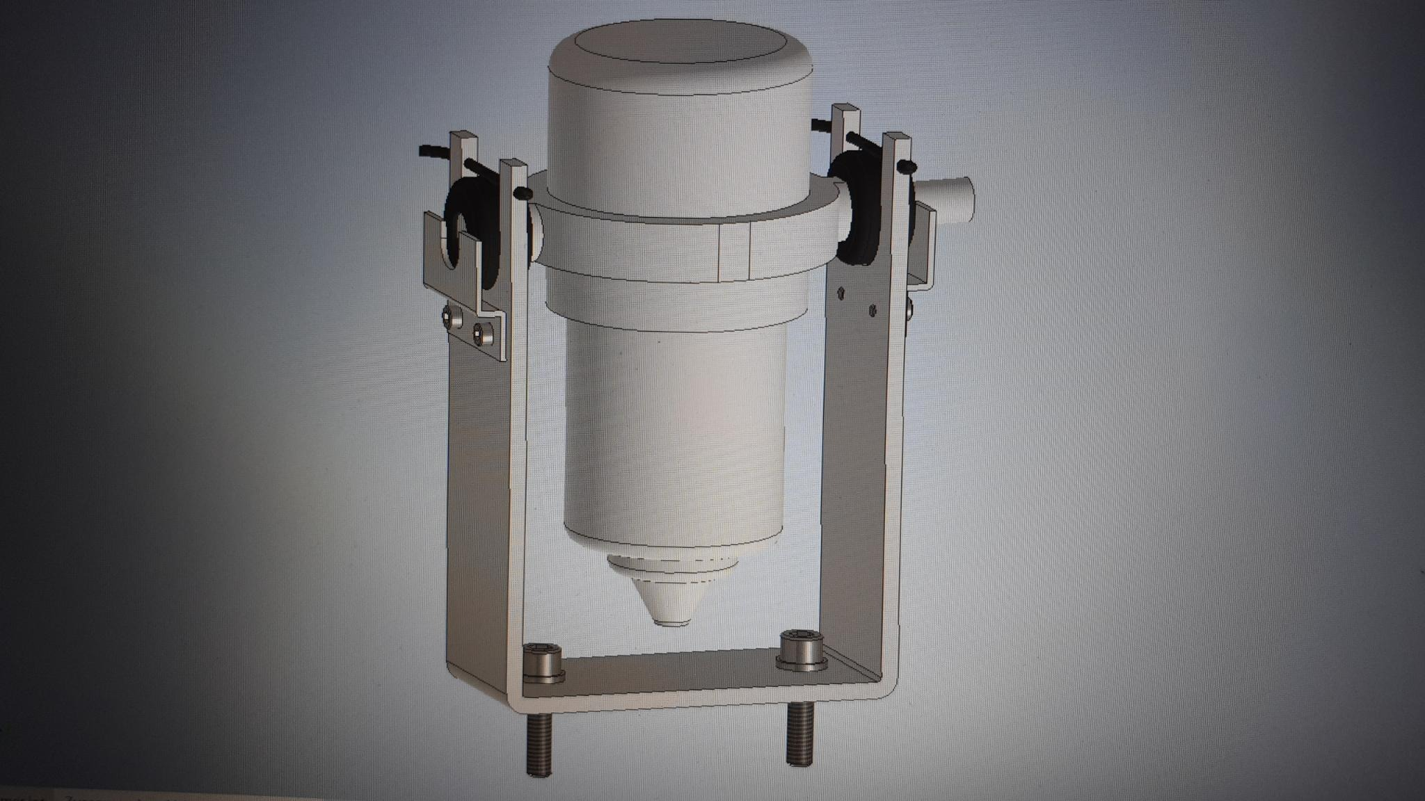

Some more Audi progress today
Thomas designed a holder for the vacuum pump: And I installed it He also made some pole covers for the 12V battery and a bracket to connect the cross member to all 3 bolt holes of the motor mount (just visible under the battery) Now just need to cover the +12V connector and then take the car to Göttingen TÜV again next Monday.
