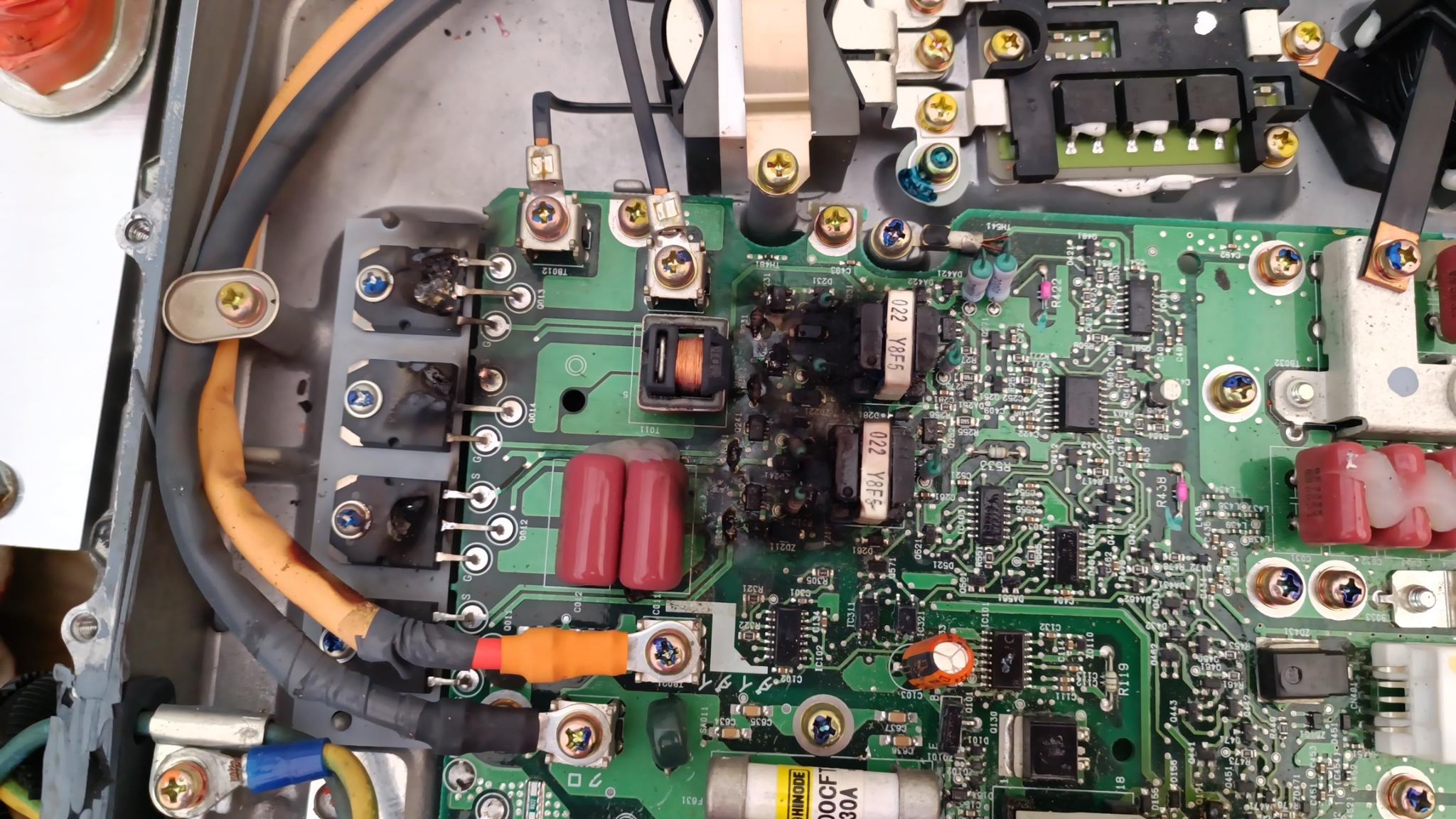

I tested the new firmware in Touran today all while the Audi was charging. Both inverters have SSID "inverter". And some point I must have logged into Audis wifi und updated that. I found the breaker tripped and charging stopped.
When done with Touran I did the same in Audi, even drove around a bit all seemed fine. Only the windows wound down remarkably fast but I thought I'm just imagining it. I think at that point I had more than 14V on tap...
After some turning off and on suddenly something in the front went up like a fire cracker. I just wouldn't stop! Until I turned the ignition off. I then stopped the buck converter that supplies the DC/DC converter and found I can still drive. So inverter ok.
Disconnected the DC/DC and no more fire crackers. Buck converter outputted a steady 200V.
Ok, lets disconnect everything, drain the coolant and take the assembly out and open it: Oops. I think when I resetted the inverter while charging the DC/DC must have put full pack voltage (380V) on the DC/DC and apparently it doesn't like that. The damage then showed later.
Still had a DC/DC board handy and dropped it in and all seems to work fine again. Full reassembly tomorrow.

Now put everything together, started, DC/DC works but can't go in forward. Inverter fault signal trips, can't see why. Of course coolant already refilled after testing the DC/DC. I need a break.

The Prius controller was in charging mode and I accidentally updated (or tried to update it). I think resetting mid charge put the buck module in full-on (because PWM stops) mode and dumped too much voltage onto the DC/DC converter. Something along those lines. All I know for sure is that the house breaker tripped.
I have now swapped in the guts of another Prius inverter. It was easier than swapping the entire assembly. Now we have a new problem. I can go into drive and give it a tiny bit of throttle and it will pull forward. Give it a bit more and it stops with the non-existant "OVERCURRENT" error (Prius board has no overcurrent comparator). Also I can't see the desat signal go low, so no idea what triggers it.
On the other hand if I give it full throttle right away it pulls forward strongly and doesn't trip. WTF??
Same software and controller that worked fine yesterday
UPDATE: put the failed inverter module on the table and indeed high side of phase 2 is shorted! Wow, I killed a Prius inverter!

Did you swap everything from the new inverter? Capacitor, main inverter brick? Or just the damaged dc-dc side?
Re: Audi A2 /w Prius Gen2 Transaxle & Inverter
Just read update, welcome to the I killed a Prius inverter club, if you were local I’d have another couple for you to try
Still wondering about the Main cap though they are hard to see they are damaged

Actually main cap and buck/boost converter are the only thing left I didn't swap (apart from the enclosure...).
Good news is: back on the road. I simply chose to ignore the fault signal MFIV. Just trusting the inverter will protect itself even if I don't stop PWM. Drives completely fine now.
Have 3 inverters and 4 DC/DC modules, so still 2/3 to go
