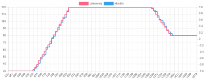

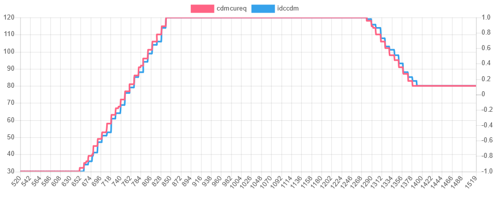

I actually posted the log from Delta EVSE with Nissan Leaf somewhere here. Might help you.
Some details from ABB charger
viewtopic.php?p=40999#p40999
Also some details from Delta
viewtopic.php?p=44983#p44983
- chademo test_0001_0000.csv
- (24.65 KiB) Downloaded 321 times

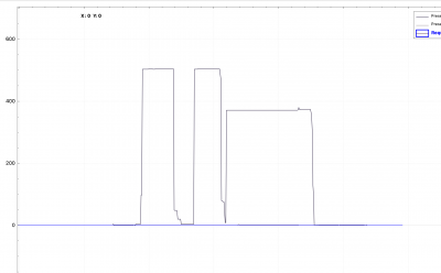

Ok I did a full multi-station test today, still failed at all. Logs are attached. EVGO stations are Delta, Nissan is ABB, EA is Electrify America.
I have an idea what may be wrong. A few stations have said "Make sure your car is in park". The code still includes a variable/definition for not parked. But the V3 board does not include any input from the drive system to know that the car IS parked. Can we just cut this from the code?

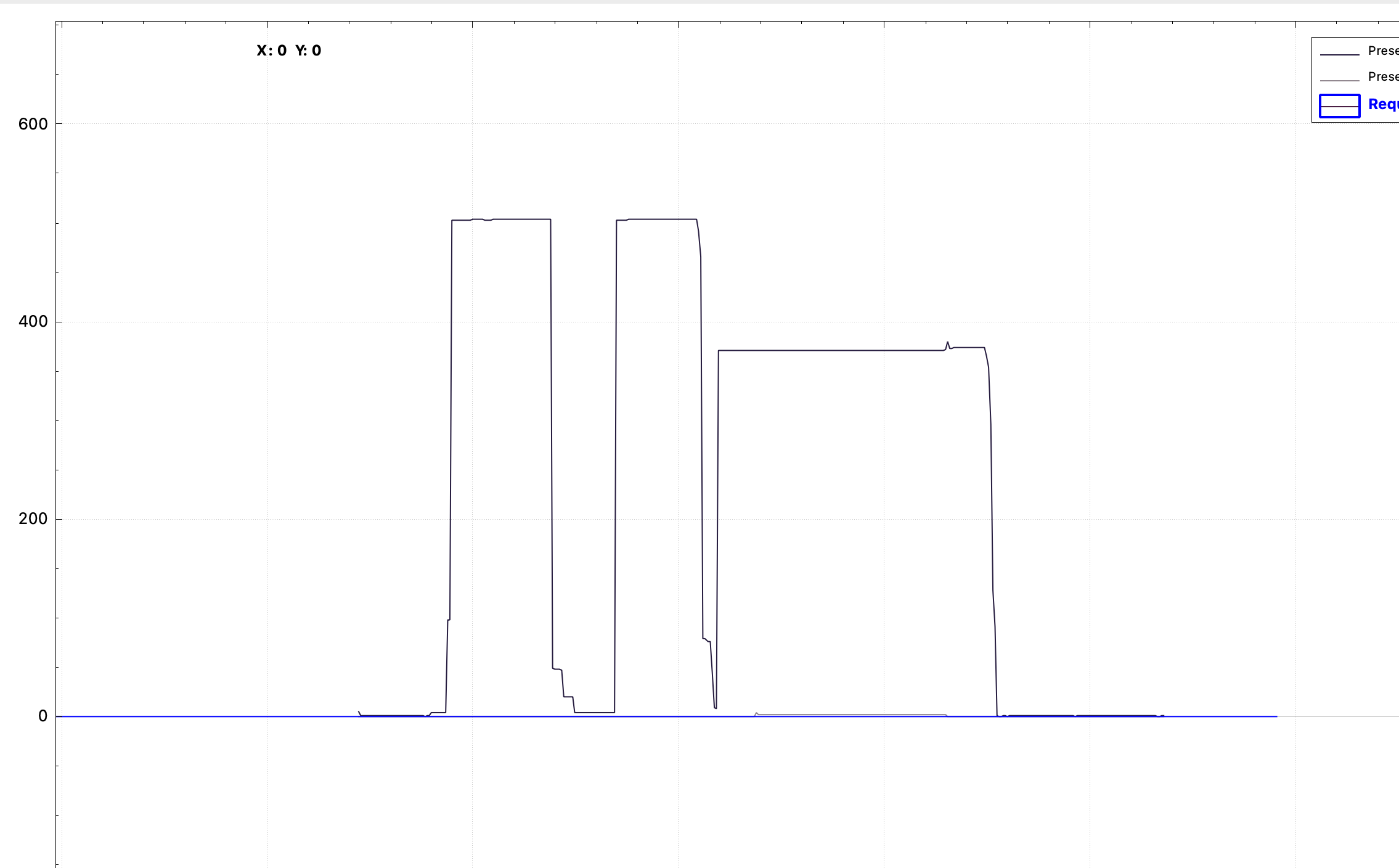

Had a quick look at your log, your requested current never raises above 0.
Plotting the voltage the EVSE is reporting looks a little strange, it raises to 500v and falls again as normal, but then it does so again, then we see your battery voltage as reported, the requested current never raises above 0 and after a short time the station sets the malfunction flag

I think its clear that my issue is the car not asking for amps. Clearly it gets all the way to that point in the process, so communication is occuring and the car and station are in agreement up to that point.
Is there possibly a second voltage setting that I'm not seeing in the web interface? I only have udctresh, but it looks like the code has both max pack voltage and target voltage. Perhaps its not asking for amps because the pack is over one of the voltages?

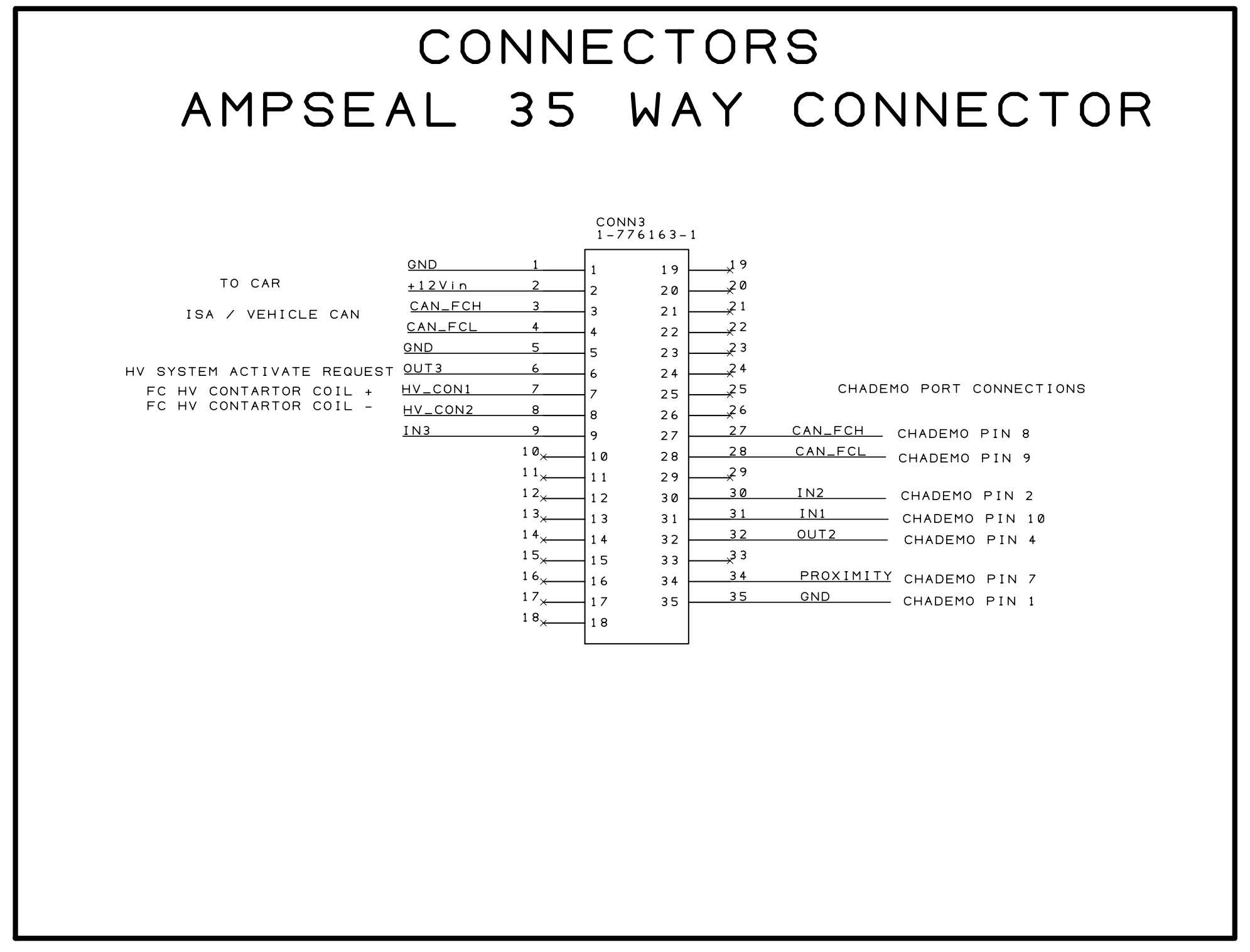

At risk of being a choosing beggar, can we go back to 1.01 and just fix the pins 2 and 10 being swapped? Maybe its just the grumpy engineer in me, but I prefer changing one thing at a time, and 1.01 got a lot further in the charge process than 1.02 and 1.03.
Alternatively, royhen99 can you post the code for 1.01 to github or share via PM so I can try to make the change?
royhen99
- Posts: 262
- Location: N. Wiltshire. UK
- Has thanked: 22 times
- Been thanked: 133 times
Although swapping pins 2 and 10 is necessary it is not all that is required to get it to work. Version 1.01 should not have got as far as it did as it was not enabling the relay to close the contactors, so you may also have a wiring problem ( worth checking to eliminate as posibilty ). I have started again from version 1.0 and added in the changes I think are needed. The problem with v1.03 and the one I am working on now is that I can not get the CAN BUS to remap to the correct pins. Both function without the remap.
I did not save version 1.01 and the closest version I can retrive from backup-up did not work.
After hours of trying to find a neat solution I have just added in the code to force a remap after the intial CAN set-up.
v1.04 attached, I will send you files.

My contactors are wired to the correct pins, V3 of the board has the relays on the board, and has pins for contactor + and - (see board pinout below)

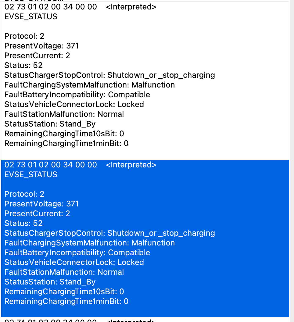

Alright we're not there yet but back to having communication.
Attached are logs from two tests (EVGO and Electrify America) and below is a screen record of an attempt at an EVGO charger.
I couldn't screen record at the EA station because it had complimentary charges and started attempting as soon as I plugged in, so I couldn't connect to the webinterface in time.
