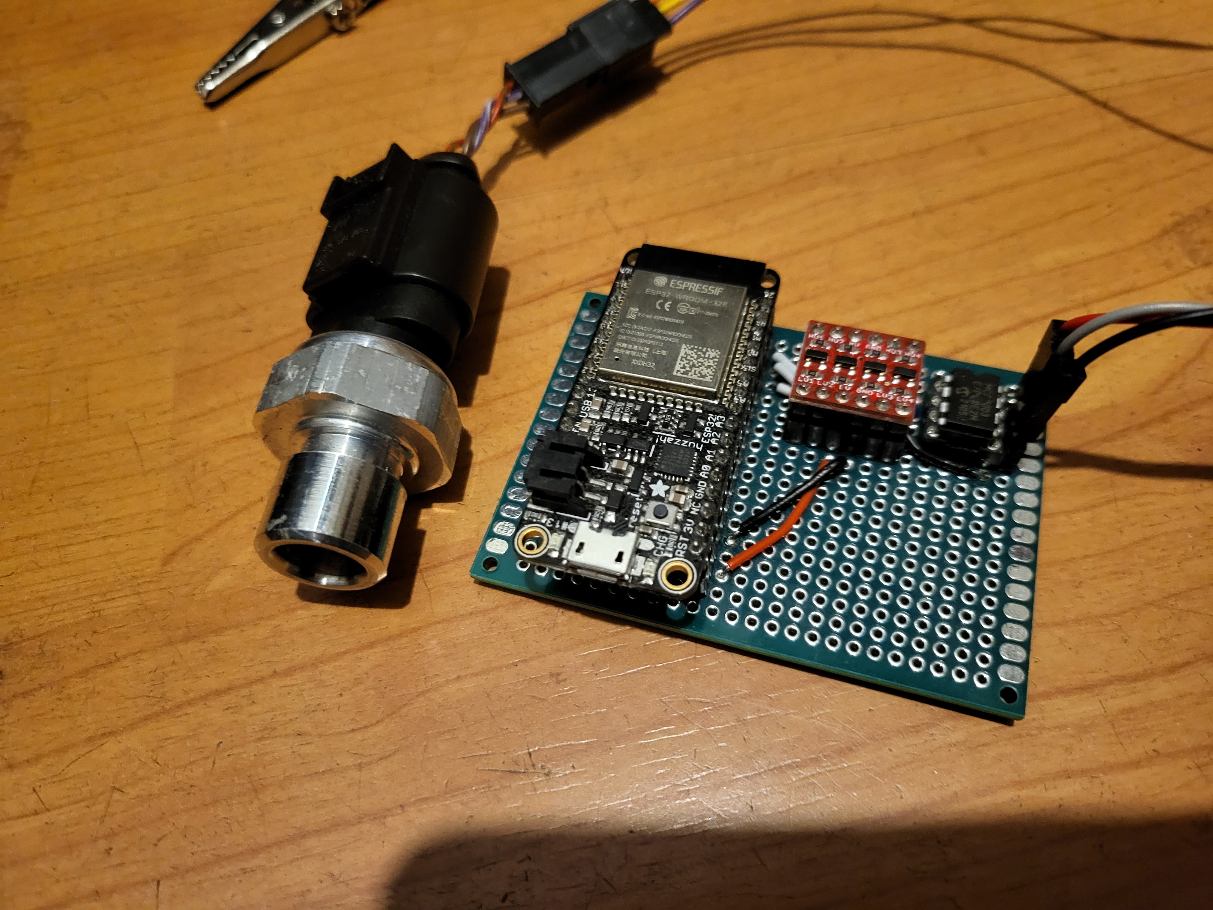

Great plot @pete9008
the data should be very accurate as i emulated the pressure sensor and read the values of a factory climate control module via diagnostic.
its a shame i don't know what byte 3 and 4 do as i couldn't see any values on diagnostic change.
I was trying to do the same with sending the compressor data but the climate control wasnt happy with that one.
i will get round to the humidity and temp sensor next.

its possible that the the other 2 bytes are fine value. Like 0-4bar representation. and that the other 2 bytes are course.
So to get the total pressure you calculate the 0-4bar values and the course value and sum them up.
I came across a current sensor who did this with 2 analog outputs.

i will give it a try tomorrow but when i applied pressure the the sensor (in a previous attemp to get some readings) i didnt see those values changeEV_Builder wrote: ↑Mon Sep 19, 2022 10:08 pm its possible that the the other 2 bytes are fine value. Like 0-4bar representation. and that the other 2 bytes are course.

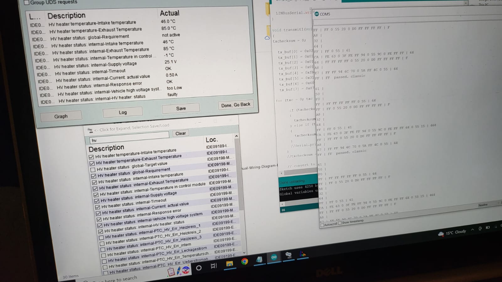

I just simulated the AC pump to the climate control and got some values. They seem very different from muehlpower results but these are from VCDS so i trust them. i didnt not go thru all the error and status options but i will in the future.
byte 1 errors
to do later
byte 2 status inverter temp
01 overheat pre warm stage
02 overheat shutdown active
03 error temo sensor
04 ok
80 inverter status active
byte 3 status
01 compressor off
20 compressor on
40 rpm limitation active
80 self protect shutdown stage 3 active
aa self protect shutdown stage 2
byte 4 rpm
01 50rpm
02 100rpm
30 2400rpm
60 4800rpm
aa 8500rpm
bb err
cc err
ee err
fe err
ff err

i just done the HV heater this was my results.
byte 1 current (n*0.25)
01 0.25a
02 0.50a
30 12.00a
byte 2 high voltage status
01 hv too low
02 hv too high
04 hv ok
byte 3 status
01 ptc degraded by sw
02 malfunction
08 ok
byte 4 ?
byte 5 supply voltage (n*0.1)
01 0.1v
02 0.2v
99 15.3
fb 25.1
fe initialzation
byte 6 temp control module (n-50)
10 -34c
11 -33c
30 -2
31 -1
60 46
88 86
87 85
99 103
byte 7 inlet temp (n-50)
10 -34c
11 -33c
30 -2
31 -1
60 46c
88 86
87 85
99 103
byte 8 exh heat (n-50)
10 -34c
11 -33c
30 -2
31 -1
60 46c
88 86
87 85
99 103c

Re: VW A/C Compressor
Does anyone have a working code for heater control they are willing to share? still trying to get my head around lin bus and would love to see how others have implemented it, Thanks

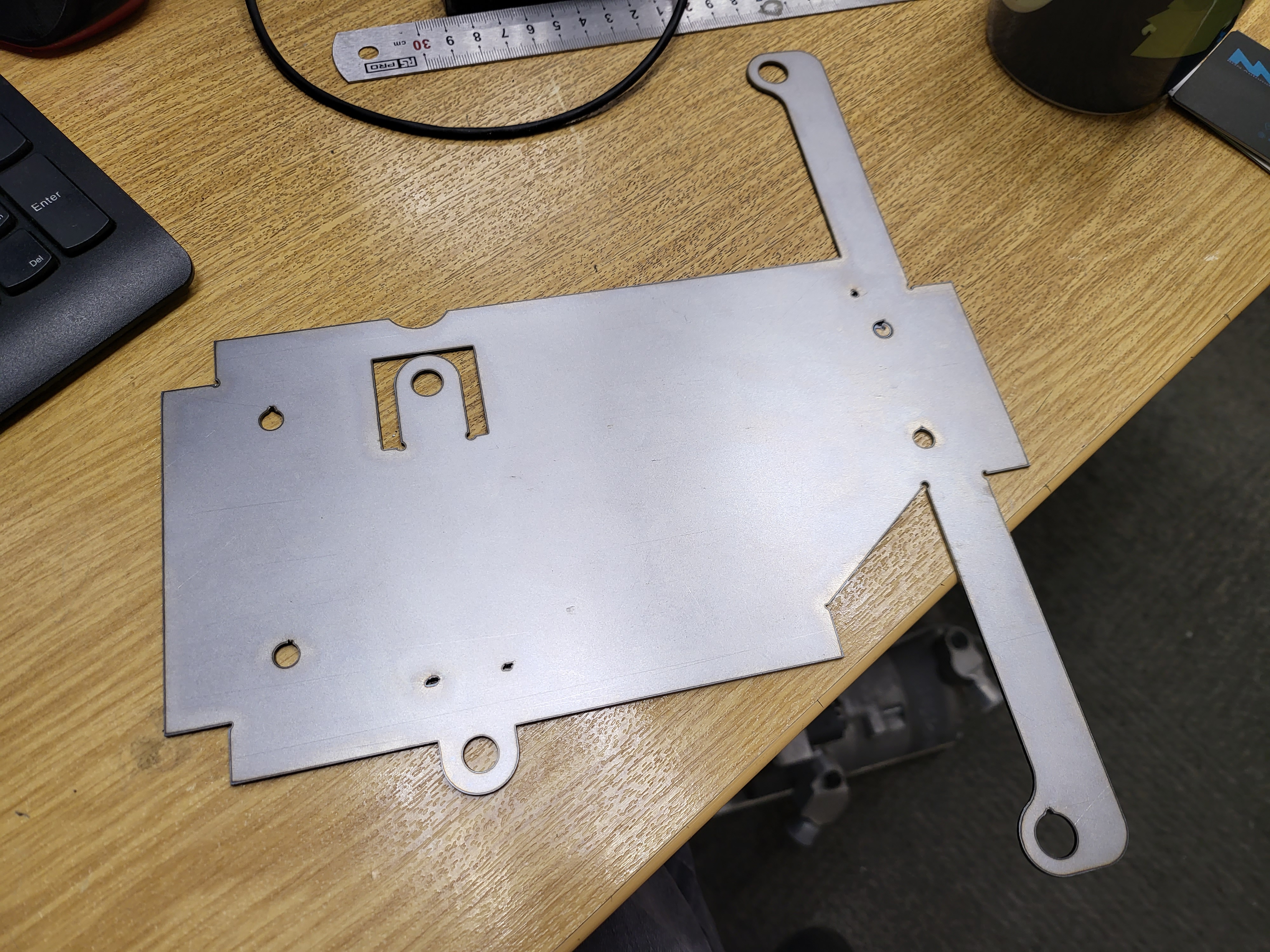

After making lots of adaptors and brackets im ready to start testing my AC setup. I decided to use a watercooled condenser and evaporator.
ESP32 for commutation. once i know its reliable and wont try to blow up anything I will put the code on my GitHub.
I have also found the actual datasheet for the pressure sensor will add it shortly needless to say the error i had from my data was 0.0001
