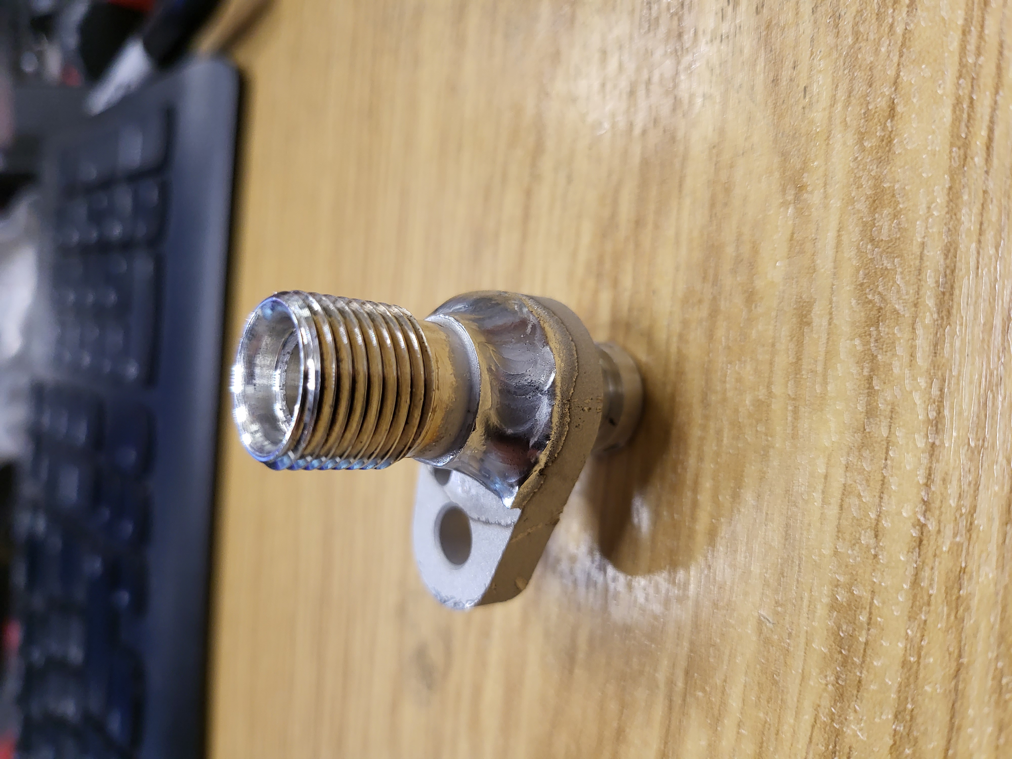

After making lots of adaptors and brackets im ready to start testing my AC setup. I decided to use a watercooled condenser and evaporator.
ESP32 for commutation. once i know its reliable and wont try to blow up anything I will put the code on my GitHub.
I have also found the actual datasheet for the pressure sensor will add it shortly needless to say the error i had from my data was 0.0001
