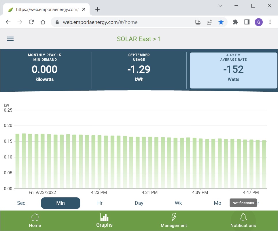

and the second problem is the Smart Plugs display our hard earned solar production as usage aka consumption

Re: The Greg's Grid Tie Solar Project
green as in solar production "saving the planet and such"
note the graph in You do not have the required permissions to view the files attached to this post.
