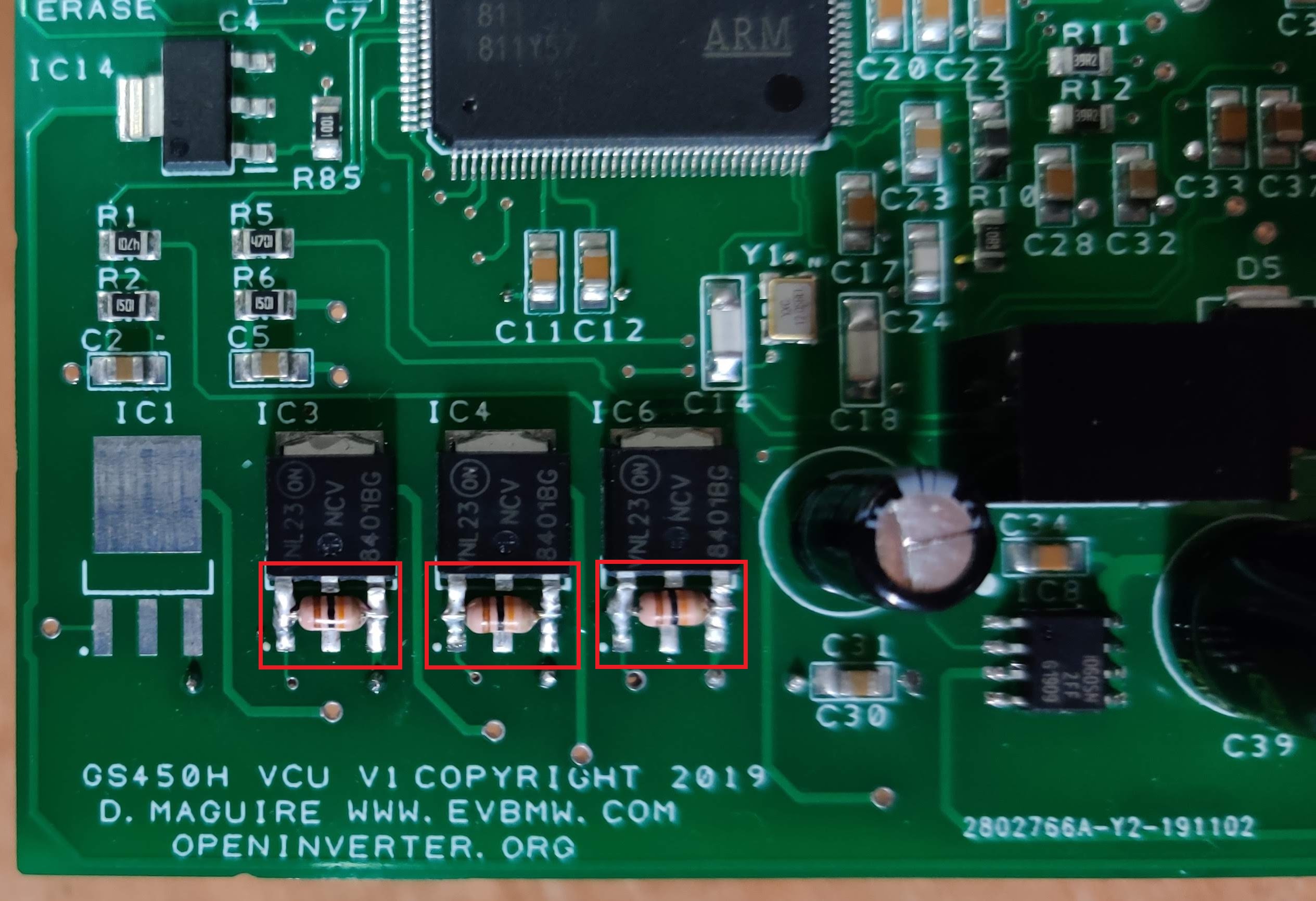

When testing VCU I have noticed that state of the "Digital Drivers" (D33, D34, D44, D47, D50) is little unstable when powering on controller.
This was an issue specially in case of Pre-Charge relays I control by general "OUT1" output.
Essentially once power was applied to the controller relays would immediately get engaged which can have catastrophic effect.
Through quick research I have discovered that digital pins on Due "float" until set to "OUTPUT" mode by the code.
The easy fix for this is to use "pull-down" resistors.
I have soldered small "through-hole" 10k ohm resistors to solve the problem (pictured).
This will make controller more stable and reliable.
Posts: 4005
Been thanked: 1130 times
Excellent feedback. Thank you:)

Are you going to share design files on GitHub?
Looks like you may have forgotten pull-down resistors on digital drivers.

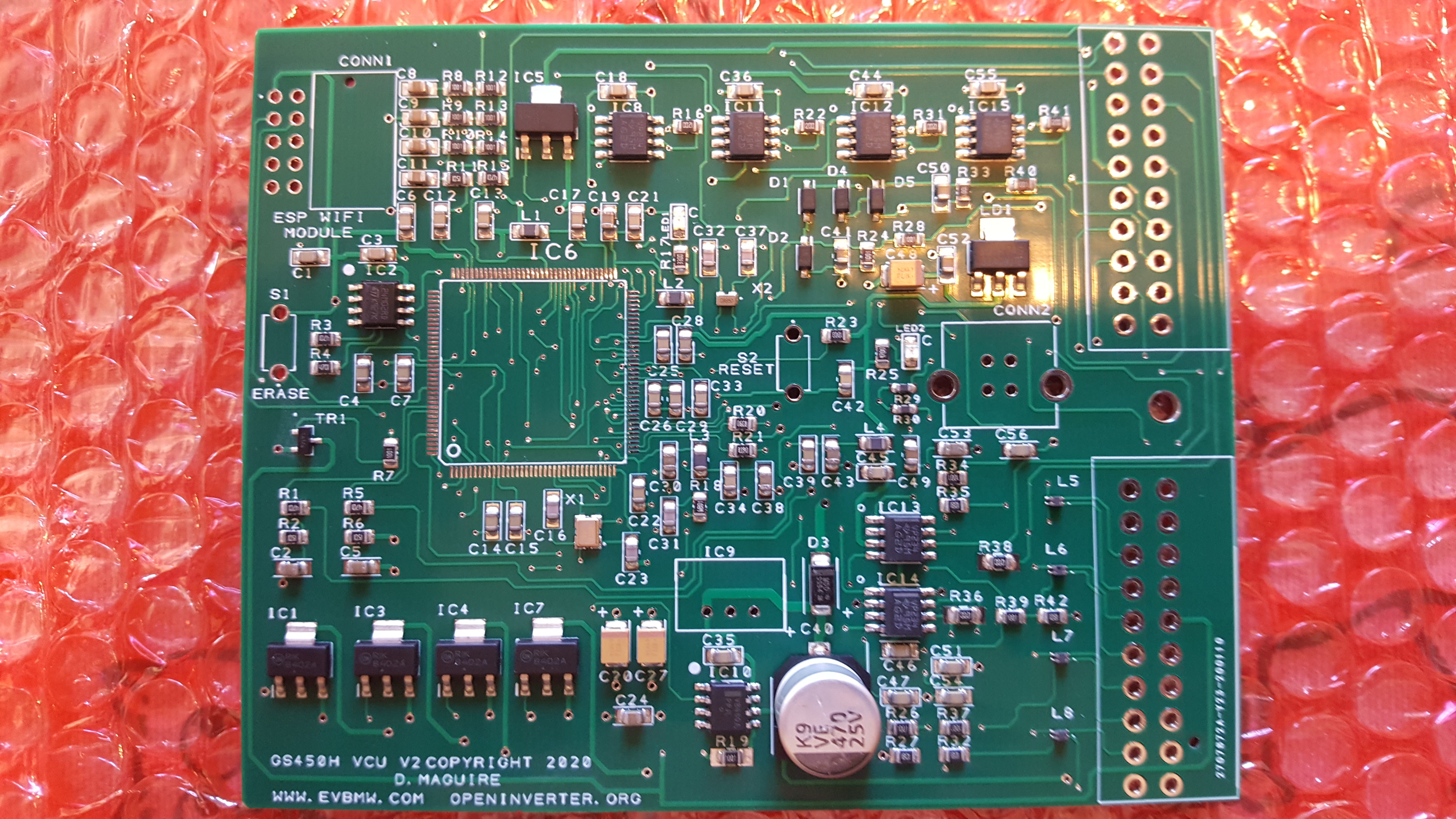

Posts: 4005
The new V2 boards have arrived from JLC:)

Does this support gearshifting ?
Posts: 4005
The hardware is on the board for shifting the high/ low solenoids but not as yet supported in firmware.
