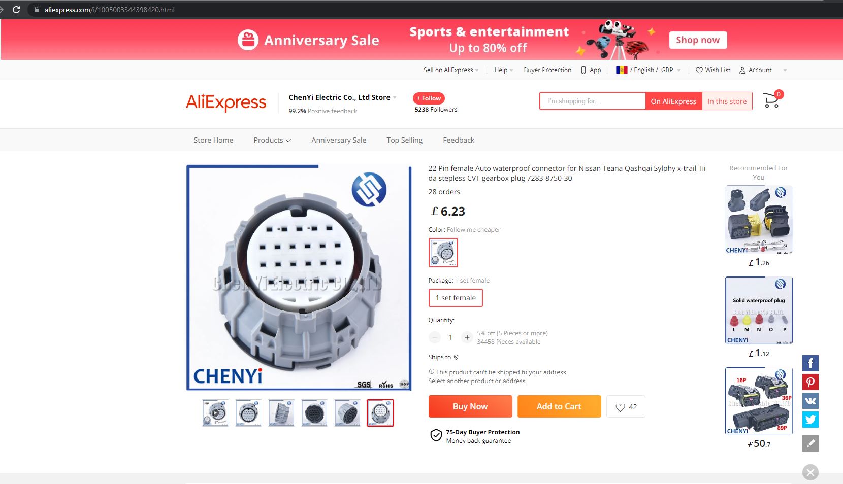

Round 22 pin inverter connectors can be purchased on AliExpress, they are used for CVT transmissions on many Nissan vehicles.
Search for Yazaki part number 7283-8750-30 or just search for "Nissan stepless CVT connector"...
The one I bought in UK was £11 shipped from China via AliExpress and came with full set of wires already installed all the same colour as it happens but I can work with that.

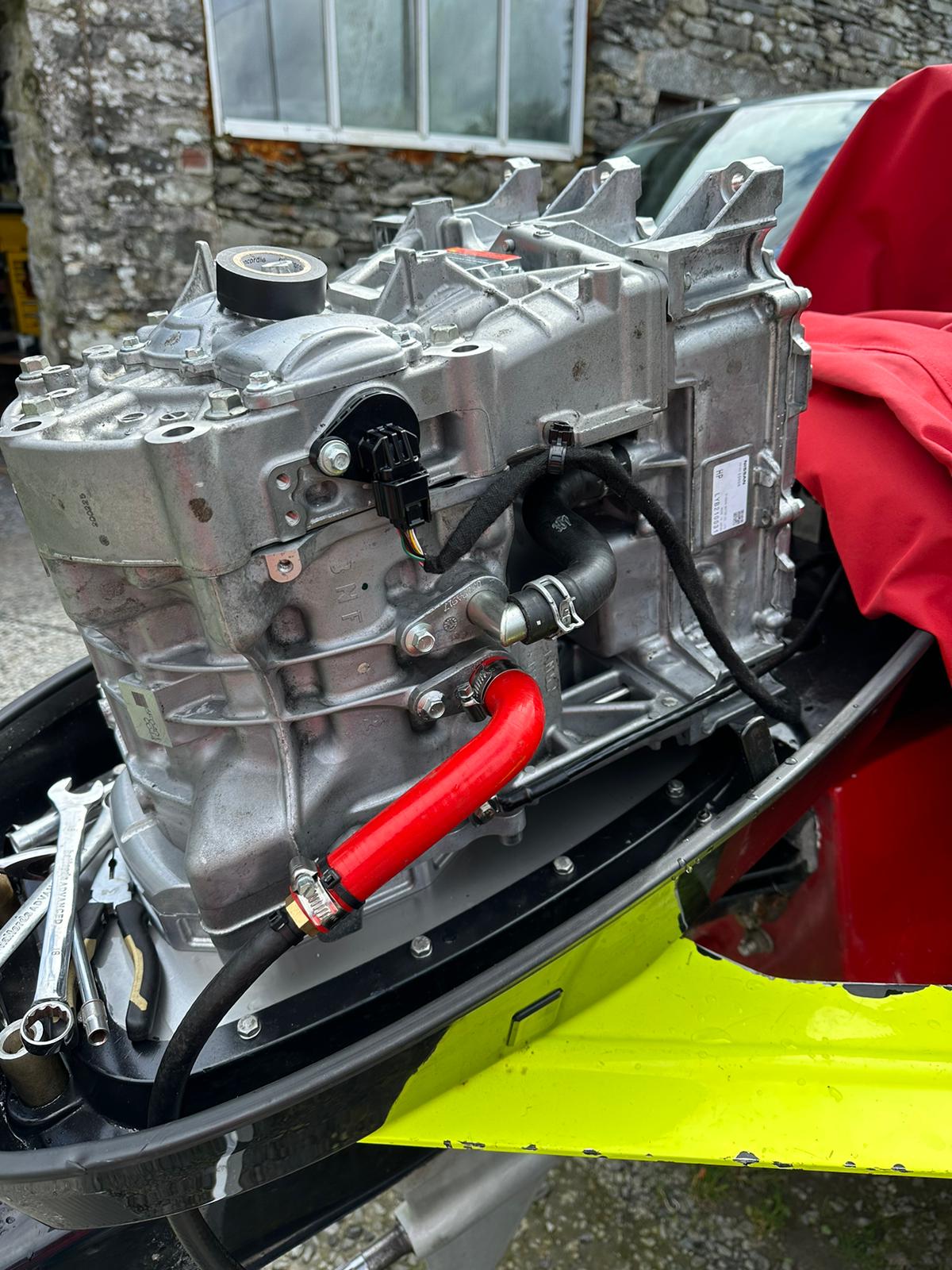

No, I havnt done any logging yet but an hoping get some can and zombie logs at our next race day which is about the only time I can test things properly with it being fitted to a boat.
I hear the comment about cooling but the stack is being fed from the stock race raw water pump that pumps water out of the lake , round the inverter, the motor then over the side. the coolant isn't 12deg so I'm sorta struggling with the idea it could overheat.
does anyone know if the inverter is 'expecting' a temp rise after a certain time? the problem its certainly very predictable in its execution.

Strange things happen. From looking at your pictures it's oriented 90° to how it would normally be, right?
What are the chances that an air pocket ends up stuck up top?
I'd be surprised if cool temps threw a limp mode.

Yes, I have pondered that as well. putting in an air bleed at the now 'top' of the IGBT chamber, only a small pipe would be needed: the thing being there's quite a lot of water getting forced through the chamber, its not that itll be 'dry' at any point, mebbe an odd large bubble if I skip out or something but still cold coolant running over the vanes on the back of the IGBTs...
