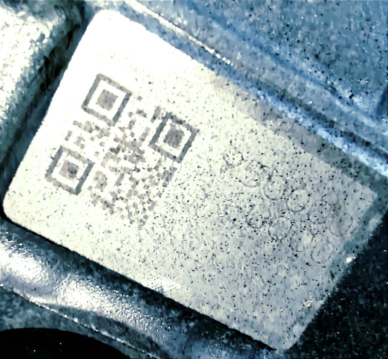

This is my motor. When testing it today with Johannes he found out that its alignment was way more out than on his own motor.
7E001B005A

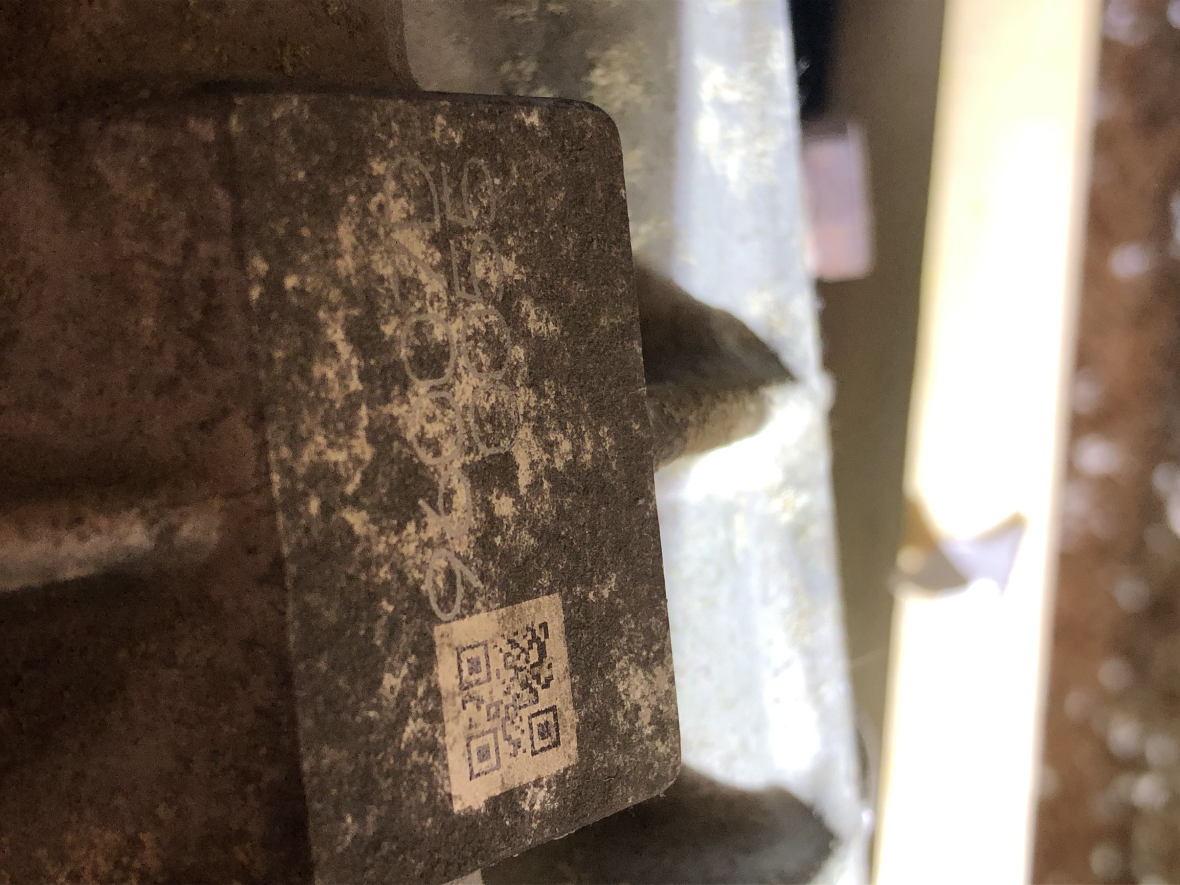

Another data point, EM57 (Gen2 Leaf), year unknown: 96007D0055
Gen2 Leaf resolver ID
