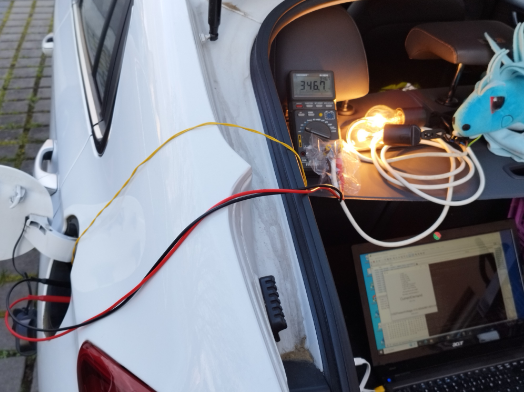

- Which car model was tested? -> Hyundai Ioniq model year 2016, built 2018.
- Does the car close the contactors to provide voltage on the CCS inlet pins? -> Yes.
- What is necessary to achive this? -> EVSE with simulated precharging, from github.com/uhi22/pyPlc
- (Edit) How long does the car keep the contactors closed? -> For ten minutes.
- How does the car react when current is flowing out of the CCS inlet? -> (Edit) 50W for 10 Minutes works fine.

I have let it run for some minutes, there was no timeout. Will run longer tests hopefully soon.
The "simulated precharging" means: THe charger sends EVSEPresentVoltage with the same value which the car wants as target voltage. This makes the car thinking, that precharging is successfully finished. I did not provide any voltage to the DC pins. Only the EVSE pretends in the communication that there is a voltage.

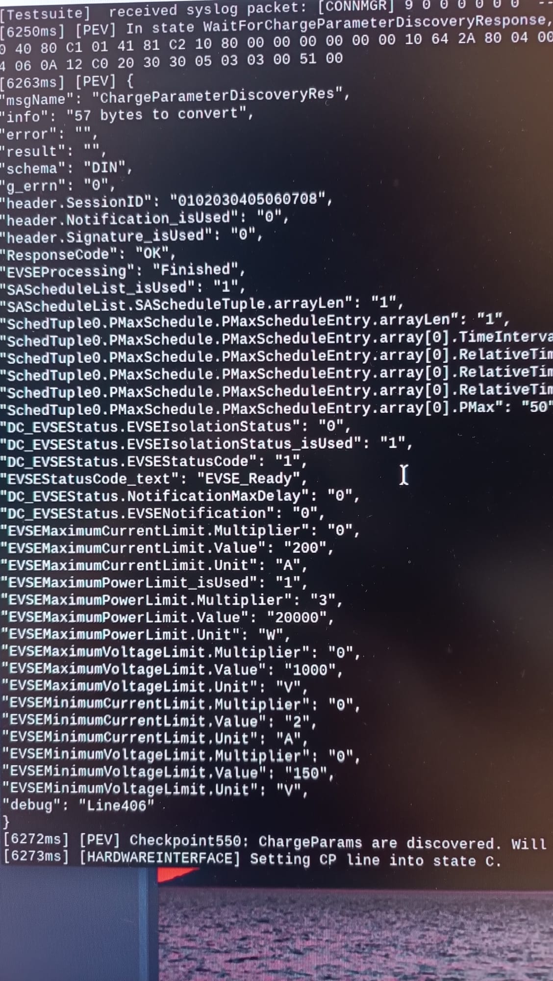

2023-04-24T14:12:46,126 INFO EXIficientCodec: PreChargeReq
<ns6:V2G_Message xmlns:ns6="urn:din:70121:2012:MsgDef" xmlns:ns5="http://www.w3.org/2000/09/xmldsig#" xmlns:ns7="urn:din:70121:2012:MsgBody" xmlns:ns2="urn:iso:15118:2:2010:AppProtocol" xmlns:ns4="urn:din:70121:2012:MsgDataTypes" xmlns:ns3="urn:din:70121:2012:MsgHeader">
<ns6:Header>
<ns3:SessionID>B7BF4D5939E29500</ns3:SessionID>
</ns6:Header>
<ns6:Body>
<ns7:PreChargeReq>
<ns7:DC_EVStatus>
<ns4:EVReady>true</ns4:EVReady>
<ns4:EVErrorCode>NO_ERROR</ns4:EVErrorCode>
<ns4:EVRESSSOC>81</ns4:EVRESSSOC>
</ns7:DC_EVStatus>
<ns7:EVTargetVoltage>
<ns4:Multiplier>-1</ns4:Multiplier>
<ns4:Unit>V</ns4:Unit>
<ns4:Value>3890</ns4:Value>
</ns7:EVTargetVoltage>
<ns7:EVTargetCurrent>
<ns4:Unit>A</ns4:Unit>
<ns4:Value>0</ns4:Value>
</ns7:EVTargetCurrent>
</ns7:PreChargeReq>
</ns6:Body>
</ns6:V2G_Message>
2023-04-24T14:12:46,143 INFO EXIficientCodec: PreChargeRes
<ns6:Header>
</ns6:Header>
<ns6:Body>
<ns7:PreChargeRes>
<ns7:ResponseCode>OK</ns7:ResponseCode>
<ns7:DC_EVSEStatus>
<ns4:EVSEIsolationStatus>Valid</ns4:EVSEIsolationStatus>
<ns4:EVSEStatusCode>EVSE_Ready</ns4:EVSEStatusCode>
<ns4:NotificationMaxDelay>0</ns4:NotificationMaxDelay>
<ns4:EVSENotification>None</ns4:EVSENotification>
</ns7:DC_EVSEStatus>
<ns7:EVSEPresentVoltage>
</ns7:EVSEPresentVoltage>
</ns7:PreChargeRes>
</ns6:Body>
</ns6:V2G_Message>
2023-04-24T14:12:46,174 INFO DIN-SECC: ----- Loop -----
2023-04-24T14:12:46,205 INFO SECC: State: C2 (4,182), charging in progress.
2023-04-24T14:12:58,121 INFO EXIficientCodec: SessionStopReq
<ns6:Header>
</ns6:Header>
<ns6:Body>
<ns7:SessionStopReq/>
</ns6:Body>
</ns6:V2G_Message>

Luckily, the Ioniq does not timeout such fast. Latest results: Without drawing energy from the port, it keeps the contactors on for 10 minutes. Then it turns off, but a new session can be established after disconnecting and re-connecting the plug.
Did a session where I connected two bulbs with 230V/60W in series, and also here, the car shuts down after 10 minutes. Edit: After the 10 minutes, the car reports
CurrentDemandReq DC_EVStatus.EVErrorCode 5, which is FAILED_ChargingCurrentdifferential.
Maybe it helps to better simulate; at the moment my EVSE mode reports too much voltage and too much current in the CurrentDemandResponse.

Today I have a chance to revisit this again, this time with MG4 electric (2023). The set up same as before, CCS2 with only communication protocol runing. The car stay connected in the charging session, with no power transfer and without any complaint. II run the test for 15 miniutes, before stop it.uhi22 wrote: ↑Mon Apr 24, 2023 6:13 pm Luckily, the Ioniq does not timeout such fast. Latest results: Without drawing energy from the port, it keeps the contactors on for 10 minutes. Then it turns off, but a new session can be established after disconnecting and re-connecting the plug.
Set up:
Session screen, show with no power:
Next step is to draw some heavy current out of this car and see if it trigger any alrm or HV fault,
EDIT 1: Latest test, I run the session for 2 hours without any complaint, DC pin voltage 355 v (without load)
EDIT 2: Tested with 2 ligh bulb in series (60+60w), run the session run for 2 hours no complaint, the MG4 seem to be OK with the fact that SoC reduced rom 43% to 42% in 2 hours while fast charging.
EDIT 3: Confirmed with 5kW heater, test only for 5 minutes. SoC reduced about 4% during discharged. I can observe a lots of energy has been transfer out from MG4 battery during this 5 minute. No error reported, the car operate as normal.
Edit 4: Tesla & BYD Atto3 also OK now
Edit 5: 5kw V2L with MG4
Edit 6: 5kW V2L with Tesla-Y

Hi, I also face the problem of timeout on two different cars. VW ID.4 times out after exactly one minute and the BMW IX4 times out after 5 minutes. Is there any way to reset the timeout so that the car keeps the switches closed? PS - I'm responing with the exact voltage on the DC pins and zero amps as reply to the currentDemandReq, and both cars stop the simulated charging session without an error on the powerDeliveryReq followed by the sessionStopRequest
- Communication_PCAP.zip
- (88.4 KiB) Downloaded 1104 times

Hi - I am repeating some part of my message - but i'm trying to connect using pyPLC and my contraption supporting CCS1/CCS2 electrical (which is also similar in the NACS std) on a 2018 Tesla model S that's updated to the CCS protocol. But after connecting on the electrical side and the pin etc gets locked with the handle - I apply a 5% PWM duty cycle to let the EV know I'm interested in performing DC charging. But on the wireshark of my PLC GreenPHY modem I don't see any messaging from the PEV side (I've this comm working for 2 other cars - Chevy Bolt and Kia EV6). I saw your post above related to Tesla model Y. If you could share some details also is your Model Y outside of US and has a CCS1/CCS2 type charger? or is it per the new NACS spec in US (which is using ISO15118/DIN spec underneath it)? My relevant posts are at:peternooy wrote: ↑Mon Apr 24, 2023 9:03 am I did a similar experiment on Tesla model Y, BYD-ATTO3, MG-EP they seem to measurement actual voltage at the charging port and send SessionStopReq, if the require pre-charge voltage of the chare port does not meet what have been requested for pre-charge. (In the experiment, I set the EVSEPresentVoltage in the PreChargeRes to be equal to EVTargetVoltage of the PreChargeReq message, but left the DC pin of the charge port unconnected). This is what is look like for Tesla model Y:On BYD-ATTO3 it send SessionStopReq immediately upon receieve a very first PreChargeRes with EVSEPresentVoltage with some value and zero voltage measured. On MG-EP, the PrechargeReq loop time out after 7 sec and Tesla moel Y after 12 sec. After that the car send SessionStopReq.Code: Select all
2023-04-24T14:12:46,126 INFO EXIficientCodec: PreChargeReq <ns6:V2G_Message xmlns:ns6="urn:din:70121:2012:MsgDef" xmlns:ns5="http://www.w3.org/2000/09/xmldsig#" xmlns:ns7="urn:din:70121:2012:MsgBody" xmlns:ns2="urn:iso:15118:2:2010:AppProtocol" xmlns:ns4="urn:din:70121:2012:MsgDataTypes" xmlns:ns3="urn:din:70121:2012:MsgHeader"> <ns6:Header> <ns3:SessionID>B7BF4D5939E29500</ns3:SessionID> </ns6:Header> <ns6:Body> <ns7:PreChargeReq> <ns7:DC_EVStatus> <ns4:EVReady>true</ns4:EVReady> <ns4:EVErrorCode>NO_ERROR</ns4:EVErrorCode> <ns4:EVRESSSOC>81</ns4:EVRESSSOC> </ns7:DC_EVStatus> <ns7:EVTargetVoltage> <ns4:Multiplier>-1</ns4:Multiplier> <ns4:Unit>V</ns4:Unit> <ns4:Value>3890</ns4:Value> </ns7:EVTargetVoltage> <ns7:EVTargetCurrent> <ns4:Multiplier>-1</ns4:Multiplier> <ns4:Unit>A</ns4:Unit> <ns4:Value>0</ns4:Value> </ns7:EVTargetCurrent> </ns7:PreChargeReq> </ns6:Body> </ns6:V2G_Message> 2023-04-24T14:12:46,143 INFO EXIficientCodec: PreChargeRes <ns6:V2G_Message xmlns:ns6="urn:din:70121:2012:MsgDef" xmlns:ns5="http://www.w3.org/2000/09/xmldsig#" xmlns:ns7="urn:din:70121:2012:MsgBody" xmlns:ns2="urn:iso:15118:2:2010:AppProtocol" xmlns:ns4="urn:din:70121:2012:MsgDataTypes" xmlns:ns3="urn:din:70121:2012:MsgHeader"> <ns6:Header> <ns3:SessionID>B7BF4D5939E29500</ns3:SessionID> </ns6:Header> <ns6:Body> <ns7:PreChargeRes> <ns7:ResponseCode>OK</ns7:ResponseCode> <ns7:DC_EVSEStatus> <ns4:EVSEIsolationStatus>Valid</ns4:EVSEIsolationStatus> <ns4:EVSEStatusCode>EVSE_Ready</ns4:EVSEStatusCode> <ns4:NotificationMaxDelay>0</ns4:NotificationMaxDelay> <ns4:EVSENotification>None</ns4:EVSENotification> </ns7:DC_EVSEStatus> <ns7:EVSEPresentVoltage> <ns4:Multiplier>-1</ns4:Multiplier> <ns4:Unit>V</ns4:Unit> <ns4:Value>3890</ns4:Value> </ns7:EVSEPresentVoltage> </ns7:PreChargeRes> </ns6:Body> </ns6:V2G_Message> 2023-04-24T14:12:46,174 INFO DIN-SECC: ----- Loop ----- 2023-04-24T14:12:46,205 INFO SECC: State: C2 (4,182), charging in progress. 2023-04-24T14:12:58,121 INFO EXIficientCodec: SessionStopReq <ns6:V2G_Message xmlns:ns6="urn:din:70121:2012:MsgDef" xmlns:ns5="http://www.w3.org/2000/09/xmldsig#" xmlns:ns7="urn:din:70121:2012:MsgBody" xmlns:ns2="urn:iso:15118:2:2010:AppProtocol" xmlns:ns4="urn:din:70121:2012:MsgDataTypes" xmlns:ns3="urn:din:70121:2012:MsgHeader"> <ns6:Header> <ns3:SessionID>B7BF4D5939E29500</ns3:SessionID> </ns6:Header> <ns6:Body> <ns7:SessionStopReq/> </ns6:Body> </ns6:V2G_Message>

Hello, I have a problem with my friends mercedes eqa300. It seems that the vehicle does not accept my ChargeParameterDiscoveryRes message. It just does not answer anymore. Does anyone have some suggestions what the problem might be? The PCAP is in the appendix.
- MERCEDES_EQA300_FAIL.zip
- (21.45 KiB) Downloaded 748 times
- CCSknowitall
- Posts: 106
- Been thanked: 29 times
Re: Drawing power out of CCS port (V2x, inverse charging, bidirectional CCS)
In your charge parameter discovery response I see the following issues:
Your minimum current limit is 20A - check your multiplier, you probably meant 2A.
Your peak current ripple is 40A, probably meant 4A.
Your PMax is 0 in SAScheduleList. Most EVs ignore this though.
