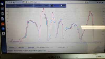

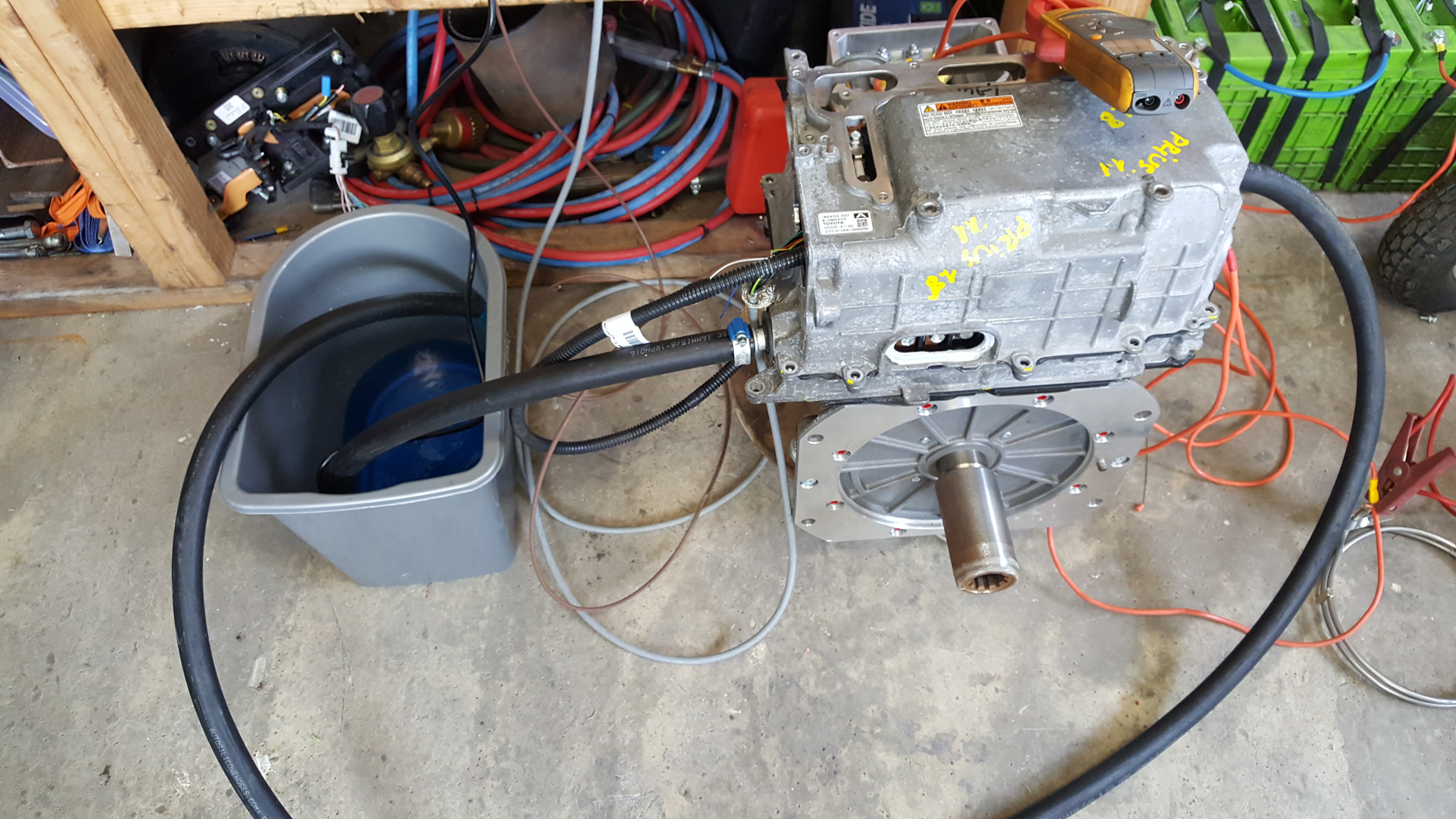

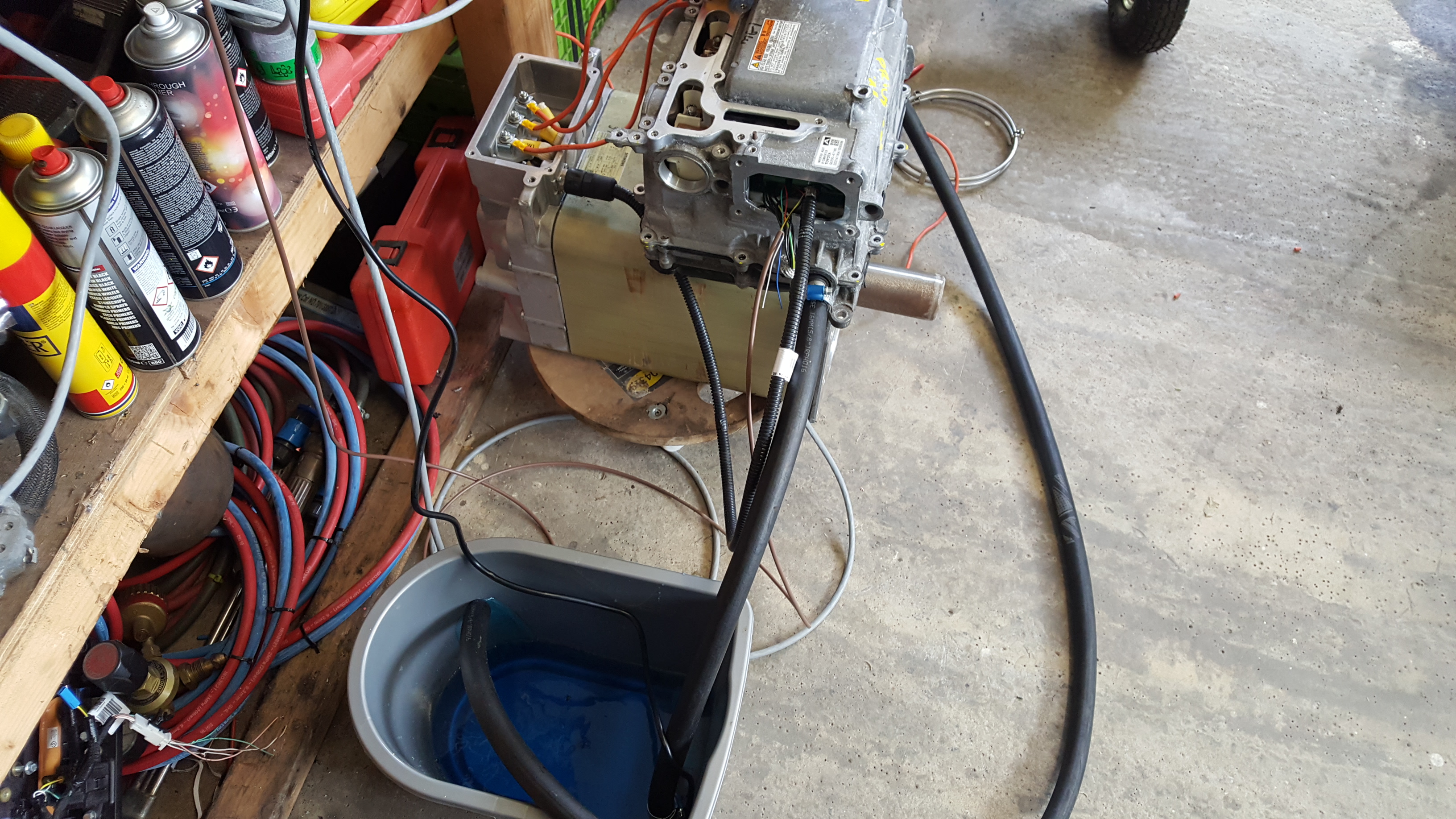

Gen 3 inverter running a Siemens 1pv5135 induction motor.

AwesomeJack Bauer wrote: ↑Tue Apr 07, 2020 1:32 pm Gen 3 inverter running a Siemens 1pv5135 induction motor.
Edit: What is plotted there aside from time on the X axis?
