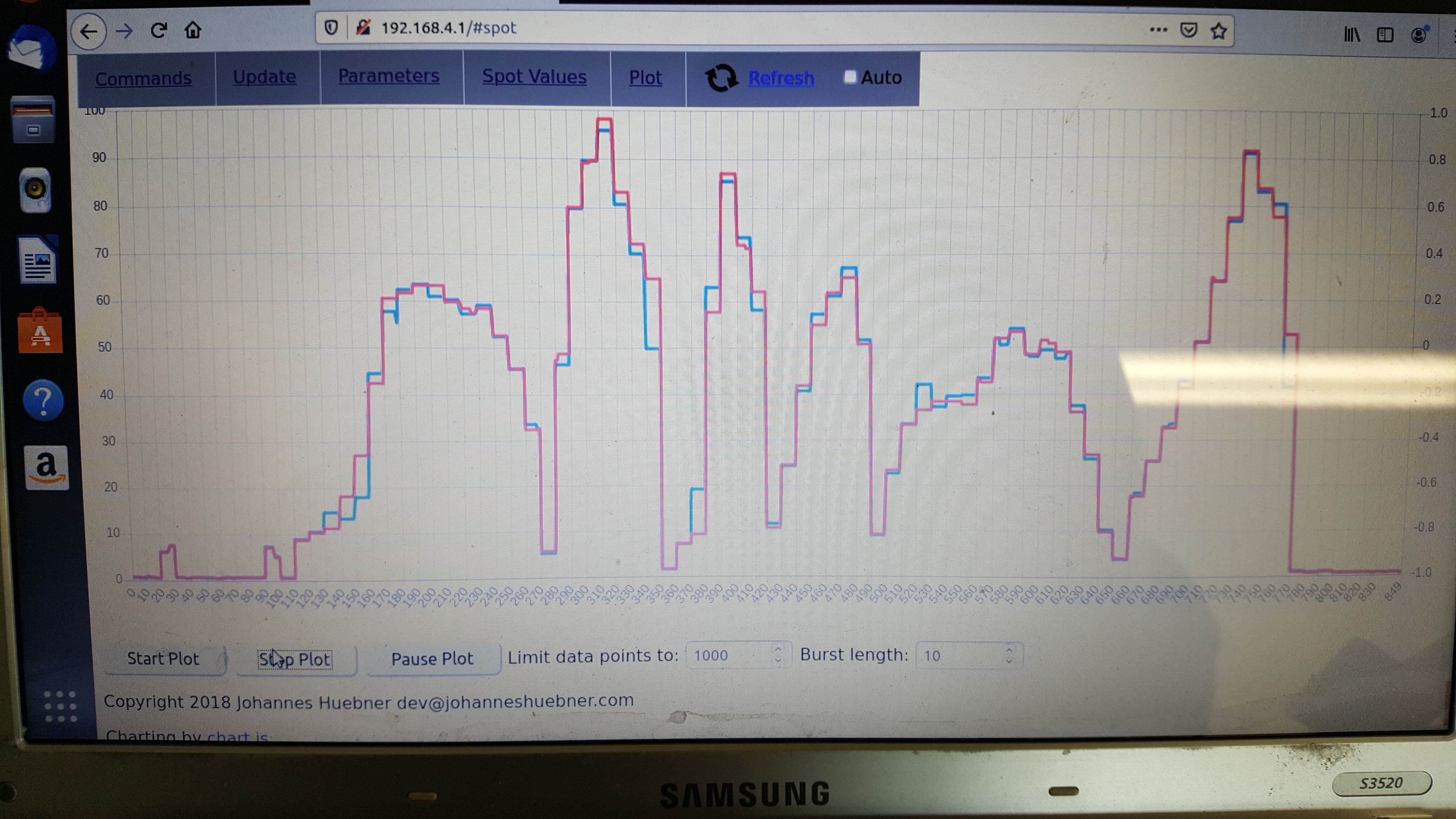

Gen 3 inverter running a Siemens 1pv5135 induction motor.
mdrobnak
Posts: 692
Post by mdrobnak »
Jack Bauer wrote: Tue Apr 07, 2020 1:32 pm Gen 3 inverter running a Siemens 1pv5135 induction motor.
Awesome :) Looking at this combo too instead of the leaf motor.
Edit: What is plotted there aside from time on the X axis?
