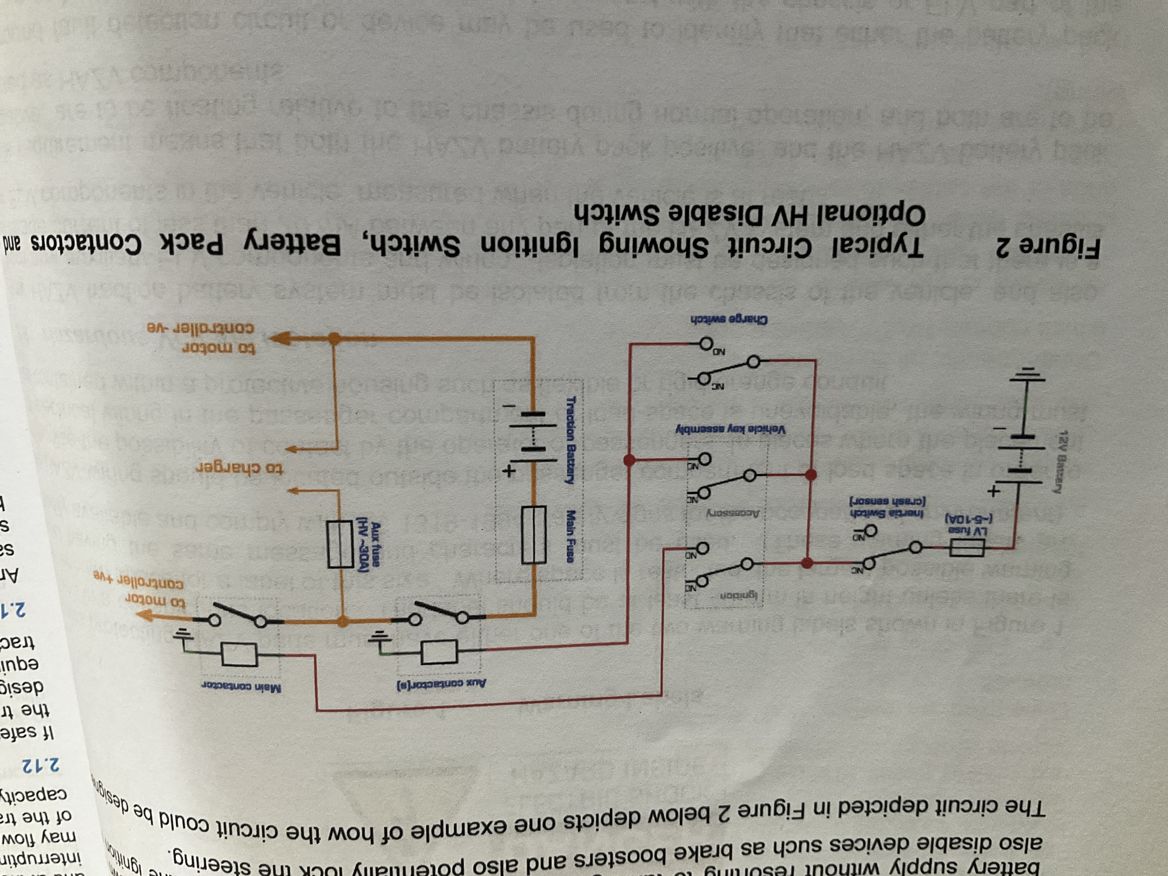

Hello Everyone!
I have been searching around but cant find anything so I will ask.
As per law here in Sweden you have to have a emergency stop button inside of the car. As I know you can blow the inverter if pulling the contactors while driving. So that is a big "NO". My other thought was to put it so it turns of the forward and reverse inputs so it basically just put the car in neutral and you cant drive until you reset the emergency stop. But that feels like cheating, I would like to switch off the contactors without anything breaking.
So, what if I put the ignition thru the emergency stop so if I push the emergency stop the ignition shuts of. Is that safe? Does the controller has some kind of safe "turn off"?
What would you do?

Hi Joachim, I’m in the same situation and in the absence of a more enlightened contribution, and after reading responses from Arber and Johu to a similar question, I plan to put the “Oh crap” button in the 12v feed to the DNR switch where I believe it will effectively put the car into neutral. Whereas the “inertia switch” (recommended by the Australia code of practice) will cut the power supply to the ignition circuit with the potential of damage to some inverters.
The attachment is from the Australian National Code Of Practice 14.
I’m no authority and welcome more informed responses.

Would putting it in neutral stop you if you find yourself in an unintended acceleration situation? We've seen that happen before, be it from unintended regen or who knows what else.
In the industrial world, an emergency stop priotitises human safety over machine safety, and in certain cases an e-stop will damage equipment. With that philosophy in mind, I do plan to use my e-stop to kill both contactors. Only for use in a true "OH SHIT" situation - but I'd rather blow my inverter than launch into traffic or something.

In sine firmware yes, in FOC firmware, no. Guess which variant has higher probability of run-away
If available the emcystop input of the logic board is a good choice as it instantly kills PWM.
I've never dared turning the ignition off in a run-away condition but it is potentially nicer to hardware as it stops PWM and contactors.

Tom, in his latest VCU, puts the inertia switch in the HVIL loop but I don’t know how the VCU handles that input.

Well if you consider what effect you want to achieve with the mechanism...Joxson wrote: ↑Mon Apr 24, 2023 9:17 pm Hello Everyone!
What would you do?
1. EMGC button (Notaus) is meant to secure equipment OFF from operating with presumption that you can reengage the equipment ON after the causing event passed.
2. "Fuel cut switch" or overturning switch is meant to cut the energy (fuel) supply in event of accident where you dont particulary think of reusing the car but rather limit the damage already done by accident so as not to spread more fuel into the localised fire or cut the power so as not to cause short somewhere where there is no fuse safety i.e. the metal chassis path.
I actually did talk to inspector and reason with them in the similar way at TUV for my Pug. Tell them you have two safeties in effect; one to be able to stop the car effectively and the other in the case of damage.
Another argument is: Two safeties increase robustness as there is no expected single failure to cross both safties.

Well to elaborate a bit on this. In situ one it's not about "off".
It's about a "safe state". For example weights should still be kept in the air and movements should be actively decelerated.
Also certain parts of the machine should be moveable seperately still in order to be able to unlock doors and gain access for example.
So my point it's not simple off but a strategy can/should be behind it.

Well i suggest you carefully read the requirement and then you can make an argument on the case of this.EV_Builder wrote: ↑Tue Apr 25, 2023 10:10 am Well to elaborate a bit on this. In situ one it's not about "off".
The way i understand Notaus requirement is to prevent the machine/vehicle from operating/driving. Then you can argue that simple neutral switch already achieves that requirement. I dont see any OEM car with red button built in. That is the function of Neutral gear.
There is additional point that THAT particular action should not allow for simple switch toggle to get it back in operation. It requires a determined separate action. This is why Notaus switches have to be rotated for release.
But 12V system will continue to operate lights and brakes will still have servo function and steering will work... failsafe operation is not (should not be) dependent on a single system. This is why you still have 12V battery and DCDC on top of that.
Of course there probably is additional safety requirement for a case of accident and other for EMC etc...
The point is those are separate requirements and shouldnt be mixed together for fear of defeating the robustness of your solution(s). I.e. failsafe method of operation etc...

I have read it. It's about a "safe state" not about shutting "off".
I'm not saying that a safe state doesn't mean you shut something off what i try to preach is that it could be more sophisticated sequence.
That why there exist safety controllers etc.
If i was the builder i would give the safety button multiple break contacts. One which indeed switches drive to neutral and the second activates delay timer. After x seconds relais of main battery are opened.
In that way you safe state the vehicle "controlled" with KISS components and you have dual independent layer.

In my opinion the *best* solution here is a two stage circuit. The first thing to do is always to hit the emcystop input of the inverter. This will *instantly* shut down all IGBTs. It has the same effect as going into neutral, but totally overriding the software, and not waiting for the next PWM cycle.
Once this has been done, there will be a short period where unwanted regen is occurring. This is the danger zone where opening the contactors will fly the inverter. In an induction motor, this may be in the order of hundreds of milliseconds. Then, if required, after some delay managed by a small delay circuit, you could open the contactors.
With that said, I would likely not do any of that. On a more practical front, you may not have access to the emcystop pin. The SDU certainly doesn't have this externally exposed. In this case, I would simply have the emergency stop button but the inverter into neutral. The way the code is written, this is also a very direct way to stop the inverter (PWM output is totally stopped in neutral).
I wouldn't want to risk such a switch being accidentally activated and blowing up my inverter, so most likely I wouldn't link it to the contactors at all, as long as shutting down the inverter meets the legal requirement, I think wiring it in parallel with the gear selector is sufficient for the huge majority of requirements.
Of course if you do need to shut off the HV in an emergency, you should be able to use the ignition switch.
This information applies to the Tesla drive units. Other inverters and motors may behave very unpleasantly if you drop them into neutral at speed, so always consult your manual before following my advice!

The way I would think about it is, you don't want the button to have a chance of breaking equipment because then you won't press it when you have to. You won't really even be able to test whether it works in a realistic situation.
If an uninformed driver presses it, they surely don't think they'll have to have the entire HV system replaced for thousands of €.
Also note that by shutting down PWM in a permanent magnet motor, if you're in the field weakening zone (above base frequency) you may partially lock the drive wheels until speed decreases to base frequency. Regardless, if you have the chance do this, it's probably the best solution.
As said, it's possible on many openinverter boards. It's also possible with e.g. the stop input of the GS450H inverter which is generally connected to the P gear selection. Not sure if it directly shuts down PWM but being OEM I'm sure it will do what it needs to even if it's just software inside.
Probably what I'd do is immediately put the gear selector in neutral and with an abundant delay open the contactors.
I'd connect the inertia switch to do something similar.
Personally in my cars I'm planning to add an inertia switch, but with no hardwired function. It will stop the throttle command and after a delay open the contactors, in software, possibly even checking that the car has actually stopped before doing that. The goal IMO is to have the contactors open by the time someone comes to dig yourself out of the car after an accident.

The only solution I can come up with is to use a fuel pump inertia switch wired into the positive (after fuse) side of the contactors.
Or if your using a relay to trigger your 12v which includes the contactors then the input to the coil would be a good place.
The current rating seems to be ok at 10 amps that should be ok for a contactor. OBS you still run risk of loose connection causing contactors to open but just need to make extra sure the connections are good.
https://www.carbuilder.com/uk/inertia-safety-switch
Inertia sensors for fuel pumps are designed to that they will go off in a crash but not before (see accn plot in link).
Tbh I don't really care what happens to my inverter once I have crashed as that will most likely be the least of my worries.
As both johu and celeron have stated there are no perfect options ... Just pick one your happiest with.

Well a crash sensor to disconnect mains from a EV is a surely a good idea!rstevens81 wrote: ↑Sat Apr 29, 2023 9:47 pm The only solution I can come up with is to use a fuel pump inertia switch wired into the positive (after fuse) side of the contactors.
We don't want the car tobe come HV- or HV+ or generating a short between the two.

If I was you I would try to bring the HVIL signal external. That signal is designed tobe Estopish behaviour. And still I advise to study it's working tobe sure you aren't safe by feeling instead of by design.
- Been thanked: 1914 times
Re: Emergency Stop Wiring
Yes, that would be the only external signal that kills PWM on SDU boards. Be aware you need to pull it to ground to disable PWM. Simply dropping 5V won't turn it off. Oh and yes, it's a 5V signal, not 12V
