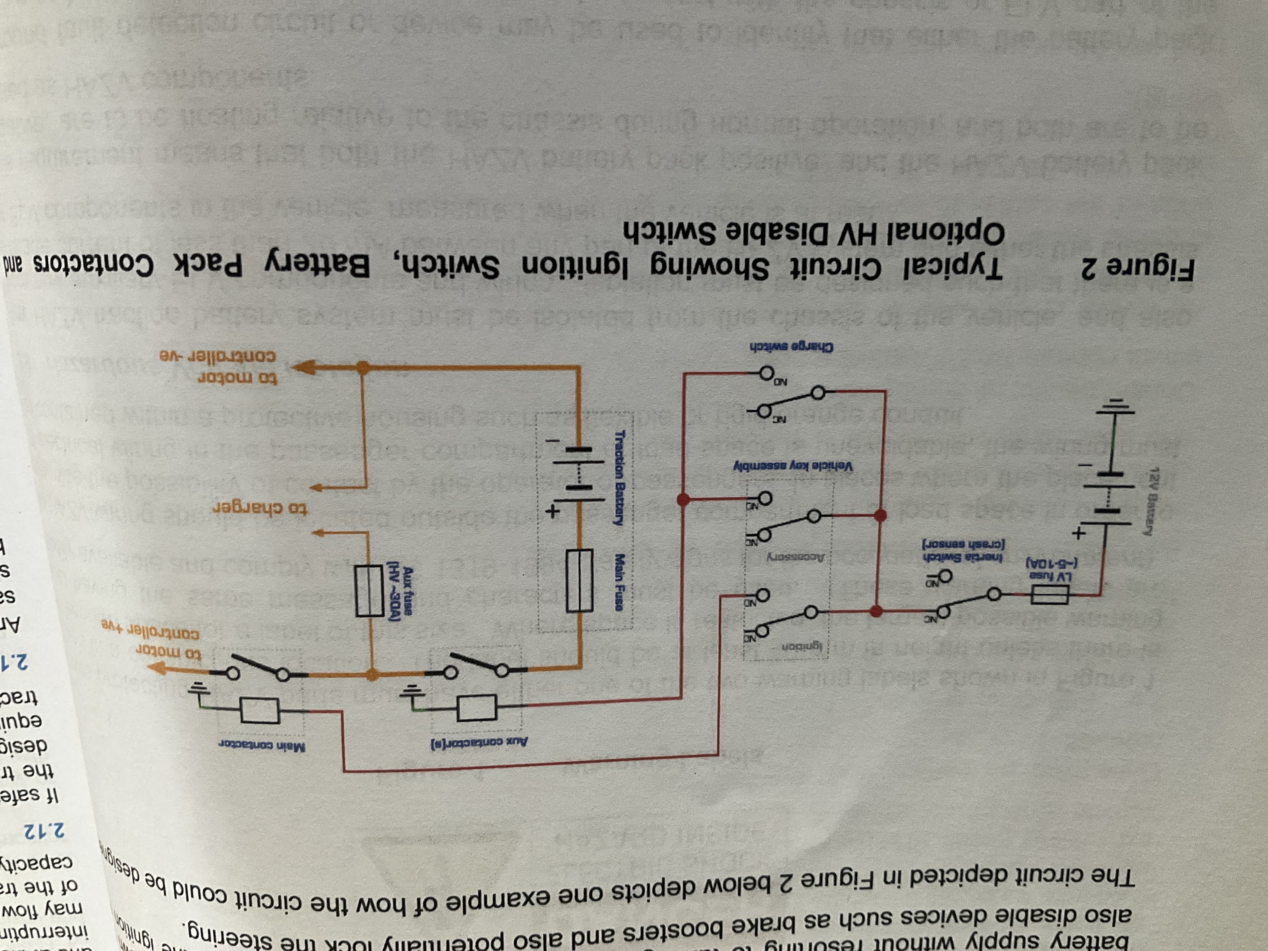

Hi Joachim, I’m in the same situation and in the absence of a more enlightened contribution, and after reading responses from Arber and Johu to a similar question, I plan to put the “Oh crap” button in the 12v feed to the DNR switch where I believe it will effectively put the car into neutral. Whereas the “inertia switch” (recommended by the Australia code of practice) will cut the power supply to the ignition circuit with the potential of damage to some inverters.
The attachment is from the Australian National Code Of Practice 14.
I’m no authority and welcome more informed responses.
Chris
Chris

Tom, in his latest VCU, puts the inertia switch in the HVIL loop but I don’t know how the VCU handles that input.

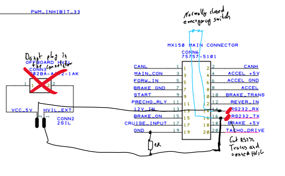

In my opinion the *best* solution here is a two stage circuit. The first thing to do is always to hit the emcystop input of the inverter. This will *instantly* shut down all IGBTs. It has the same effect as going into neutral, but totally overriding the software, and not waiting for the next PWM cycle.
Once this has been done, there will be a short period where unwanted regen is occurring. This is the danger zone where opening the contactors will fly the inverter. In an induction motor, this may be in the order of hundreds of milliseconds. Then, if required, after some delay managed by a small delay circuit, you could open the contactors.
With that said, I would likely not do any of that. On a more practical front, you may not have access to the emcystop pin. The SDU certainly doesn't have this externally exposed. In this case, I would simply have the emergency stop button but the inverter into neutral. The way the code is written, this is also a very direct way to stop the inverter (PWM output is totally stopped in neutral).
I wouldn't want to risk such a switch being accidentally activated and blowing up my inverter, so most likely I wouldn't link it to the contactors at all, as long as shutting down the inverter meets the legal requirement, I think wiring it in parallel with the gear selector is sufficient for the huge majority of requirements.
Of course if you do need to shut off the HV in an emergency, you should be able to use the ignition switch.
This information applies to the Tesla drive units. Other inverters and motors may behave very unpleasantly if you drop them into neutral at speed, so always consult your manual before following my advice!

The way I would think about it is, you don't want the button to have a chance of breaking equipment because then you won't press it when you have to. You won't really even be able to test whether it works in a realistic situation.
If an uninformed driver presses it, they surely don't think they'll have to have the entire HV system replaced for thousands of €.
Also note that by shutting down PWM in a permanent magnet motor, if you're in the field weakening zone (above base frequency) you may partially lock the drive wheels until speed decreases to base frequency. Regardless, if you have the chance do this, it's probably the best solution.
As said, it's possible on many openinverter boards. It's also possible with e.g. the stop input of the GS450H inverter which is generally connected to the P gear selection. Not sure if it directly shuts down PWM but being OEM I'm sure it will do what it needs to even if it's just software inside.
Probably what I'd do is immediately put the gear selector in neutral and with an abundant delay open the contactors.
I'd connect the inertia switch to do something similar.
Personally in my cars I'm planning to add an inertia switch, but with no hardwired function. It will stop the throttle command and after a delay open the contactors, in software, possibly even checking that the car has actually stopped before doing that. The goal IMO is to have the contactors open by the time someone comes to dig yourself out of the car after an accident.

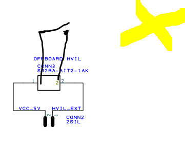

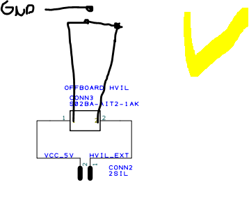

Re: Emergency Stop Wiring
If I was you I would try to bring the HVIL signal external. That signal is designed tobe Estopish behaviour. And still I advise to study it's working tobe sure you aren't safe by feeling instead of by design.
- Posts: 6738
- Has thanked: 380 times
- Been thanked: 1562 times
Yes, that would be the only external signal that kills PWM on SDU boards. Be aware you need to pull it to ground to disable PWM. Simply dropping 5V won't turn it off. Oh and yes, it's a 5V signal, not 12V
Is it an hardware signal or a software one?
Does it go to a logic gate for example or is it read as an input?
@OP:
So keep 12Volt high, but drop an relais which pulls this line to ground (on the correct place, in the correct way pull down?!?).. etc.
@OP:
- Posts: 6738
It's a hardware signal, one of the nand trees inputs
