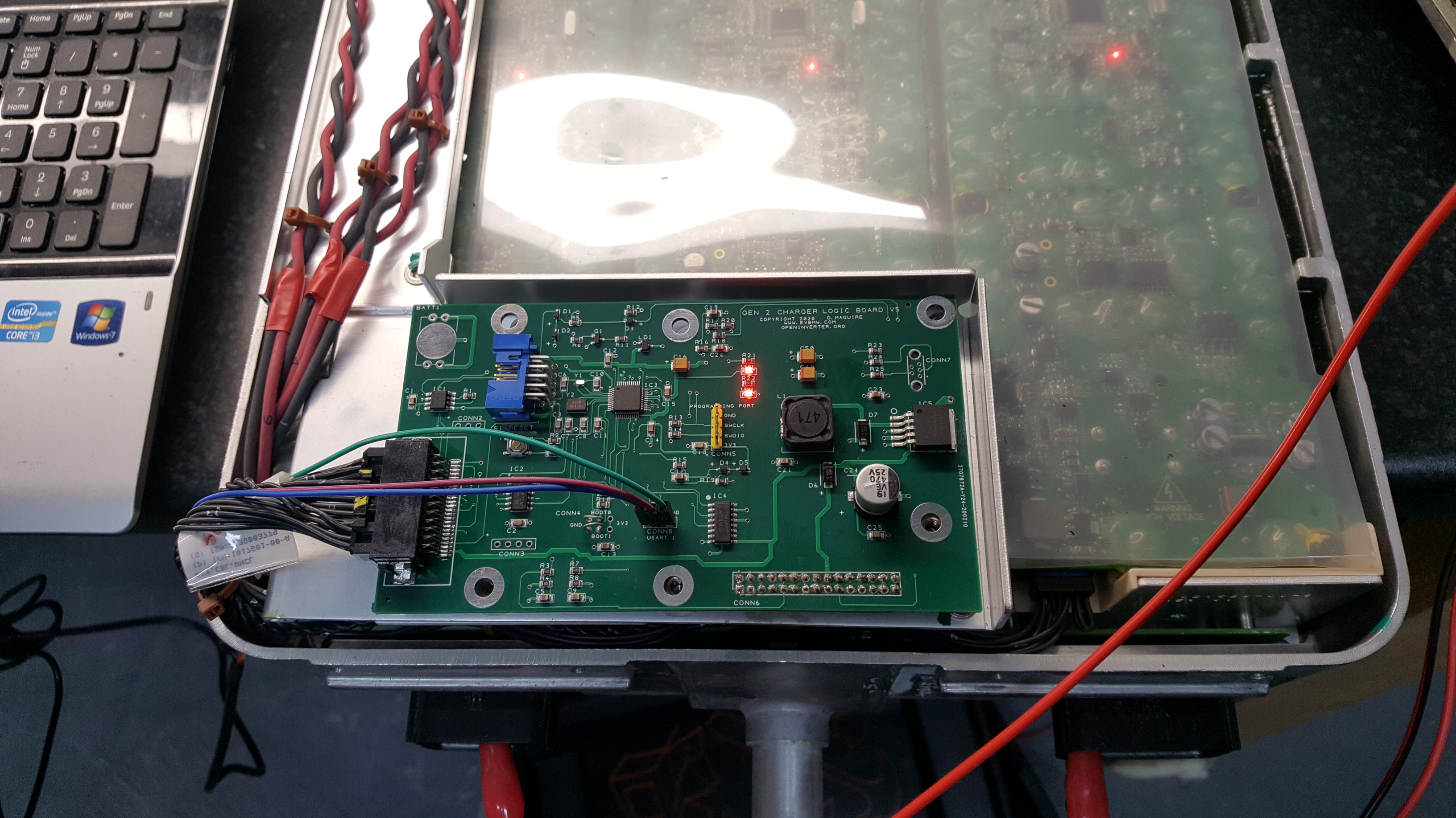

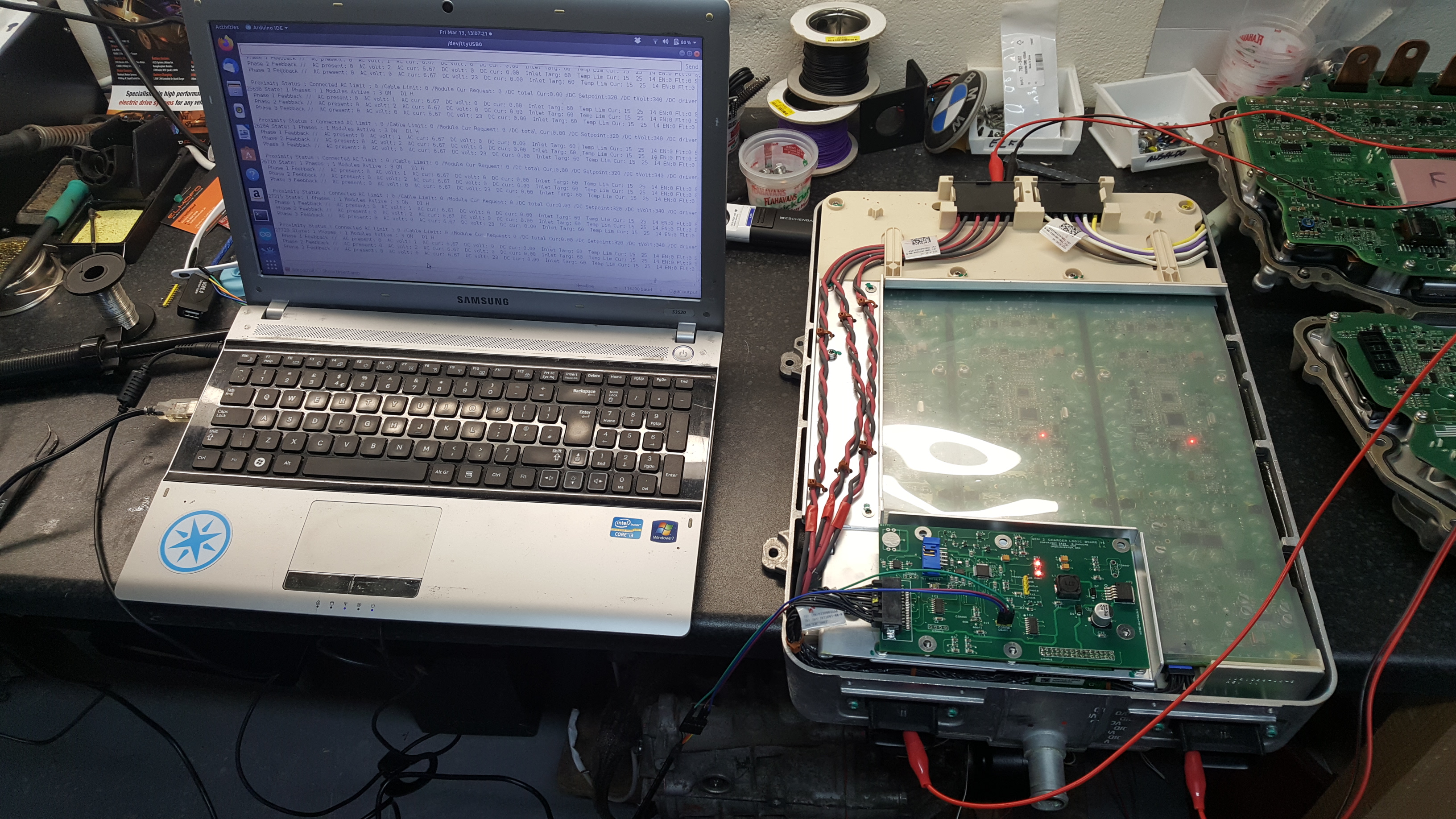

Re: Gen 2 Charger V5 Software Development Thread
Pleased to announce the new charger boards are working well on the bench. Next up testing under actual charge conditions in the Panzer. I'll make boards available in the shop soon for beta testers.

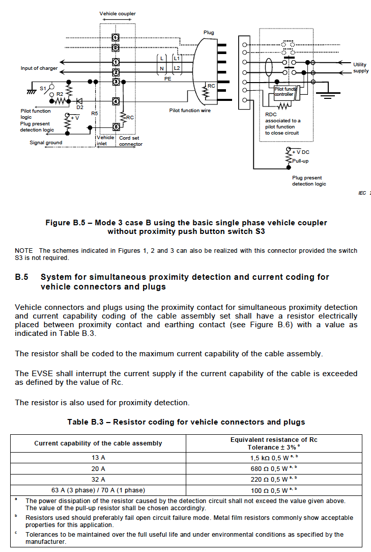

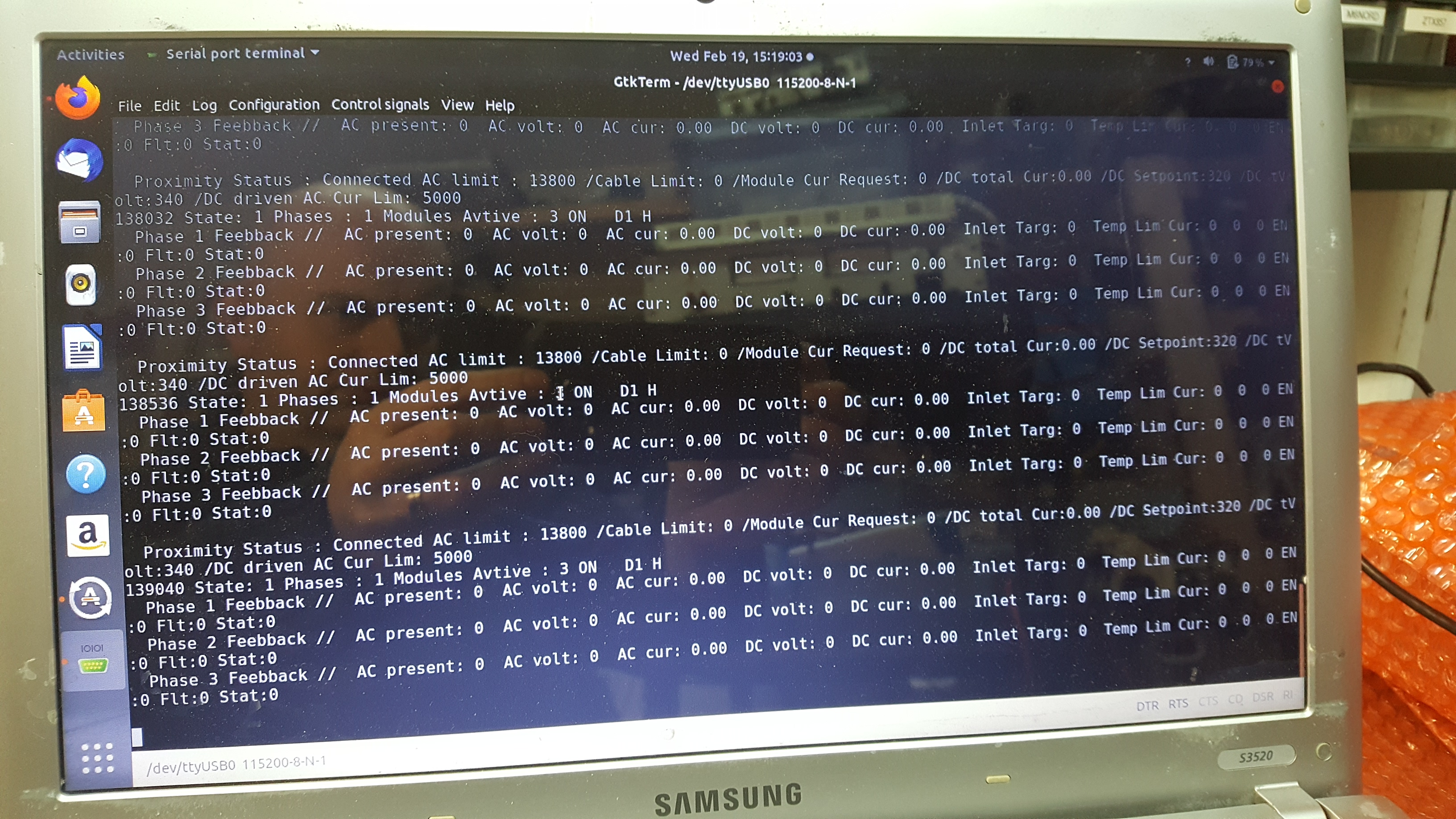

So we have our first bug. The proximity pin is used to detect the presence of the charge plug and also to determine the current carrying capability of the cable by means of a resistor divider. In the original arduino code it looks like this :
if ( parameters.type == 2)
if ( val > 950)
Proximity = Unconnected;
else
Proximity = Connected;
if ( val < 950 && val > 800)
cablelim = 13000;
if ( val < 800 && val > 700)
cablelim = 20000;
if ( val < 600 && val > 450)
cablelim = 32000;
if ( val < 400 && val > 250)
cablelim = 63000;
the arduino uses 10bit adc but I'm guessing the stm32 uses a higher resolution as it reports connected even with 3.3v on the adc pin.

Yes. Still no luck with this bug. Have confirmed no hardware problems.

It's a long time since I played with this but iirc it's the EVSE that does the cable current measurement and limits its Pilot PWM accordingly. The car only uses Proximity to see whether a cable is connected. In this post you can see more details when using a J1772 connector;Jack Bauer wrote: ↑Fri Mar 13, 2020 1:46 pm The proximity pin is used to detect the presence of the charge plug and also to determine the current carrying capability of the cable by means of a resistor divider.
viewtopic.php?f=10&t=78&start=290#p8424
Edit: I've attached the diagram from the 61851 standard. Note the resistors defining the cable current capacity, "RC".
Edit2: I've had a chat with one of my colleagues and they reminded me that it was only in later versions of the standard that resistor "RC" was included in connectors at *both* ends of the cable (in early versions of the standard it was at the EVSE end only). When we get access to the workshop i'll check some cables and see whether we can safely assume "RC" is installed in both connectors.
Edit3: I'll open a bug report on GitHub just to capture the potential issue.
