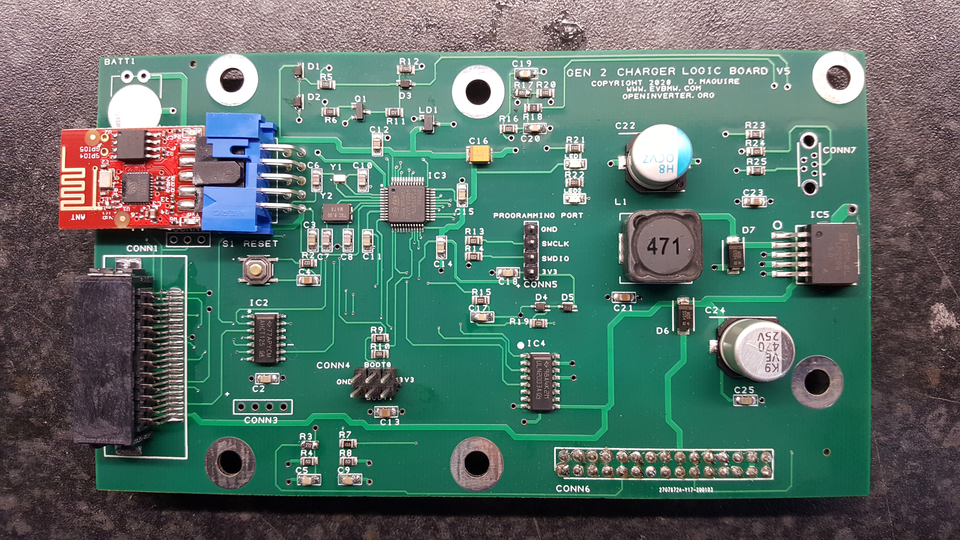

Setting up a new thread for development of software for the new STM32F103C8T6 based logic board for the Tesla Gen 2 10kw charger.
Design files (with my screwups fixed) for the boards released on Github :
https://github.com/damienmaguire/Tesla- ... /master/V5
New boards ordered from JLC and will start proper work once they arrive.
Here is my pathetic attempt to flash an LED and pump out some CAN messages.
https://github.com/damienmaguire/Tesla- ... 5/Software

Beta firmware for the V5 :
https://github.com/damienmaguire/Tesla- ... er_Gen2_V5
Note this is untested as delays at JLC due to corona virus. Will see if I can cobble something together with a bluepill.

Pleased to announce the new charger boards are working well on the bench. Next up testing under actual charge conditions in the Panzer. I'll make boards available in the shop soon for beta testers.
