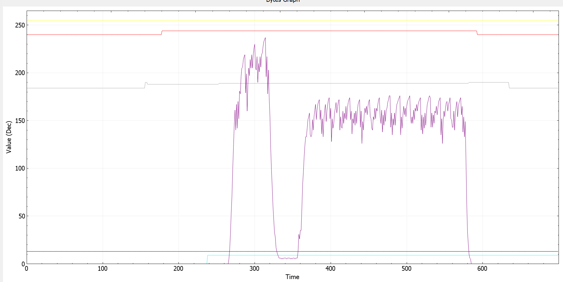

I studied messages: 0х112 d0 - d1 and 0х3Е9 d0- d1 from the log in the link below.muehlpower wrote: ↑Fri Apr 28, 2023 8:27 am I'm not sure that byte 0 + 1 is evaluated by the LIM. In my documentation for the I3 from 2013-2017 it is shown in black and that means:
google translated:
"Positions in the frame occupied by signals included in the current configuration context but not in the current selection"
It turns out that the values in the messages 0х112 d0 -d1 and 0х3Е9 d0- d1 are only for LIM from the BMS, and the control of the charge power from the car is carried out by the message 0х3Е9 d3 - d4

I do not believe that. The amps are specified with 3E9 byte 5, and that controls the charging process. 7D = 125A.
If this log is from an original BMW I3, then here in two messages we have the following indicators:muehlpower wrote: ↑Fri Apr 28, 2023 5:17 pm I do not believe that. The amps are specified with 3E9 byte 5, and that controls the charging process. 7D = 125A.
112 E0,24,0C,0E,AB,71,75,5A
Soc 112 (D5 D4) 42.7%
Amps 112 (D1 D0) 94.4 A
Volts 112(D3 D2) 359.6 V
Volts 112 (D7) 360 V
3E9 5C,8F,21,A1,7C,7D,20,4B
Ampere request 3E9(D5 125 A
Watts request 3E9 (D4 D3) 48825 Watts
Watts 3E9 (D1 D0) 36700 Watts
Why does the car choose 36700 watts and 94.4 amps, maybe through 360 volts?
Maybe 125 amperes is 50,000 watts at 400 volts, but at 360 volts there should still be 94 amperes and 36,700 watts, respectively?
I could be wrong, but most likely this algorithm is needed when displaying in messages?

24E0 = 9440, 9440-8192= 1248 -> 124,8A (Not 94,4A),
7CA = 1994, 1994*25= 49850 -> 49850W forecast_power_charging
36700 are Wh!!, the battery capacity.

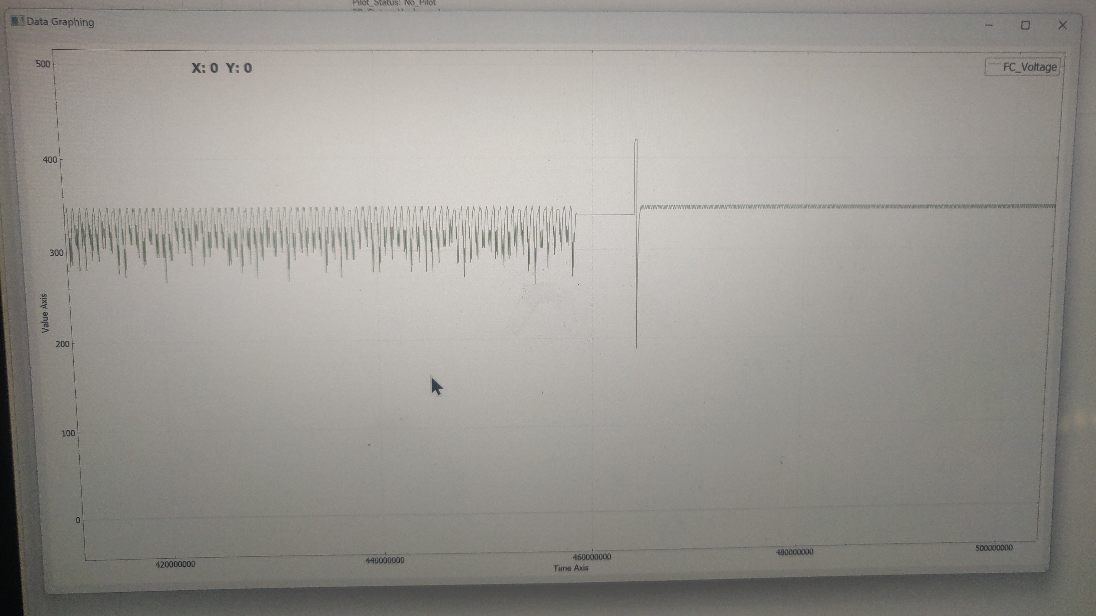

I have been helped a number of times on the forum in the journey to my own conversion project. and now I have arrived at the last part, CCS.
my setup is: Zombieverter VCU(only for the LIM), BMW LIM 61 35 6 828 052, 96 cell 24kw BMS hybride pack.
with the AC charging the lock works and i can do contctor test successfully. the DC inlet voltage sensor also works properly, when I apply the various voltages I read them back correctly (on a few volts, I don't know if that's good enough) via 0x3B4.
I went to a shell recharge station to test, I've come a long way but the chance that everything would go well in 1x is of course quite small. the charging station starts and I see a screen with the SOC at 50% (comes from the VCU), I hear pumps and fans come on in the station. but then it stops. no error messages on screen or VCU. in the VCU the last CCS_State is 4. at that moment I also hear the CCS slot open, it seems as if the session is just being stopped. when I go through the CANlog I see the charger in Pre_charge state trying to match the inlet voltage and then it seems to stop. I think this is the time for the relays in the car to switch on? i couldn't hear any relays switching because there was too much noise in the area. so I'm not sure if they work, what I also noticed is that I don't hear them switching during the weld test. I actually assumed that this would happen, but the weld test is apparently completed successfully. the relays work just fine when I put 12 volts on them.
the relays come from the BMW s box and have a coil resistance of 30 ohms so I put a 30 ohm resistor in parallel with the coils to get the 15 ohms.

I think I have already found a hint, when I look in the code of the VCU it is checked in state 4 whether the inlet voltage is < 20 volts of the charger. when I then look at the log the value I get back appears to be very unstable, so I have to make that stable first before continuing to the next step.
I will give an update when I have solved this, if any of you have another insight, I would like to hear it.Re: BMW i3 CCS/charge port controller

Some progress, fixt the unstable init port measurement and now I come to stage 6 but fails after that. I have a log but I want to look at this first. But I don't hear the relays closing and they should be at that stage, so I think there is something there.
During the weld test I also don't hear them closing, assuming this would be the case. Can anybody confirm that?
Screenshot from the signal before and after, the problem was clear
