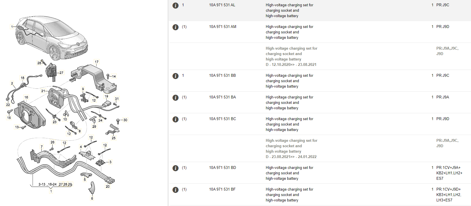

Someone knows the schematic / wiring colours meanings of this part?
Anyone an idea how to obtain the schematic?

VAG have an online portal for service information: I think for around 10€ per hour to download info required.
https://erwin.volkswagen.de/erwin/showDSP.do
Parts schematic - seems lots of part number versions for different PR codes. Number 1 includes 19, 20 & 21.
