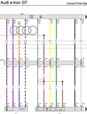

Someone knows the schematic / wiring colours meanings of this part?
Anyone an idea how to obtain the schematic?

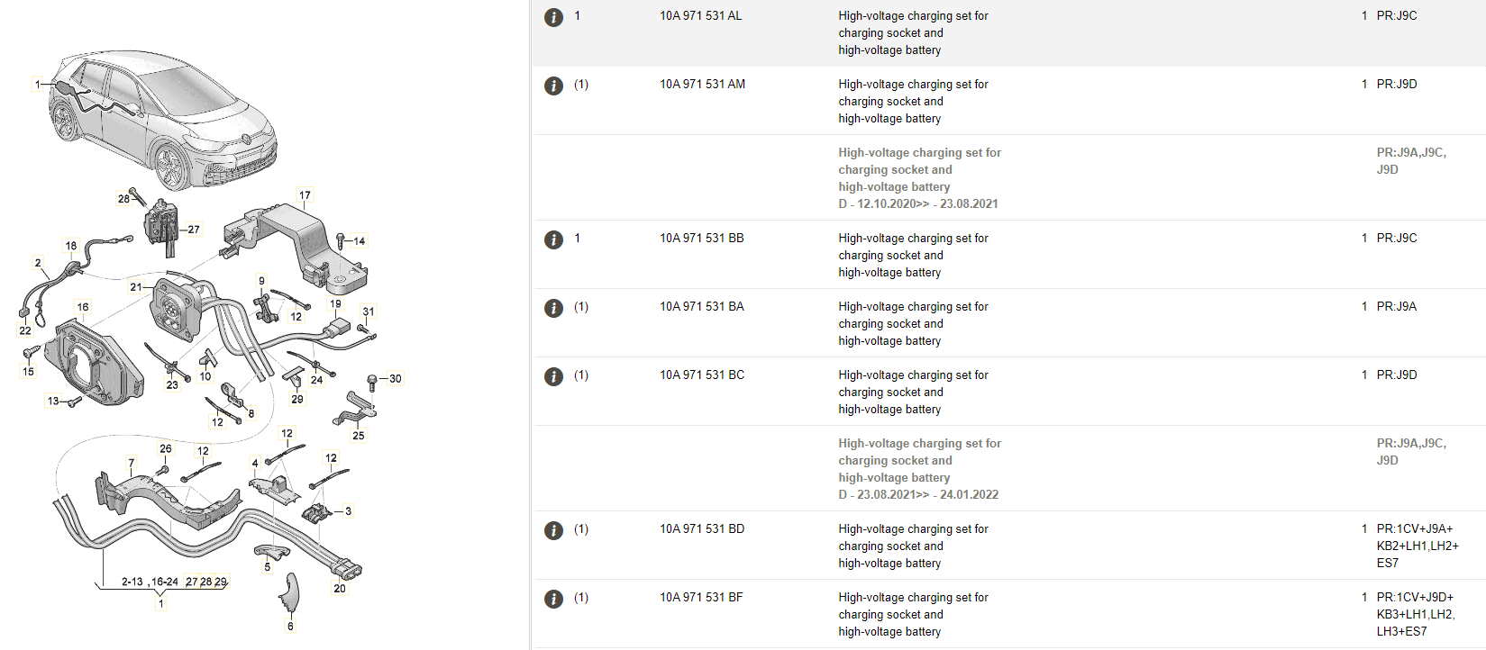

VAG have an online portal for service information: I think for around 10€ per hour to download info required.
https://erwin.volkswagen.de/erwin/showDSP.do
Parts schematic - seems lots of part number versions for different PR codes. Number 1 includes 19, 20 & 21.

Re: CCS2 Chargeport from ID3/ID4
If it’s like the taycan or etron chargers. The DC line plugs are made by rosenberger
https://products.rosenberger.com/power/ ... ngle-jack#
You can also get the STL file of the port from Phoenix Contact
Phoenix Contact use the same base wire colors out of all their ports
White - CP
Black - CS
Gray - AC plug temp +
Brown - analog ground (two wires, one for the AC temp sensor, the other for the DC temp sensors)
Yellow- DC+ temp
Green - DC- temp
Plug lock:
Brown/Blue - Lock motor -
Blue/Red - Lock motor +
Blue/Yellow - Lock Sense

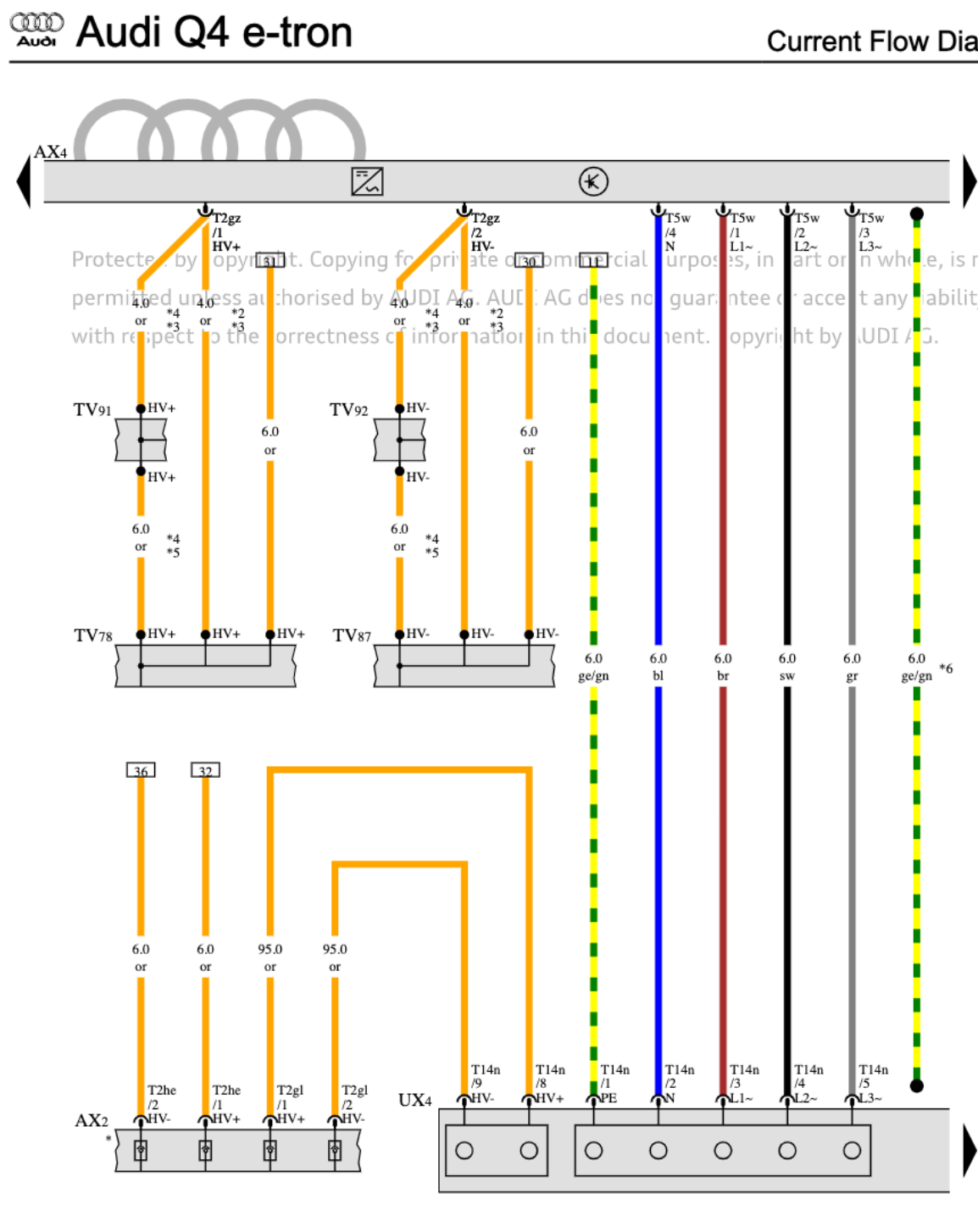

Blue/Green - Lock Sense (Gnd) If it's like the newer ID4/Q4 E-Tron, the wire colors are slightly different:
