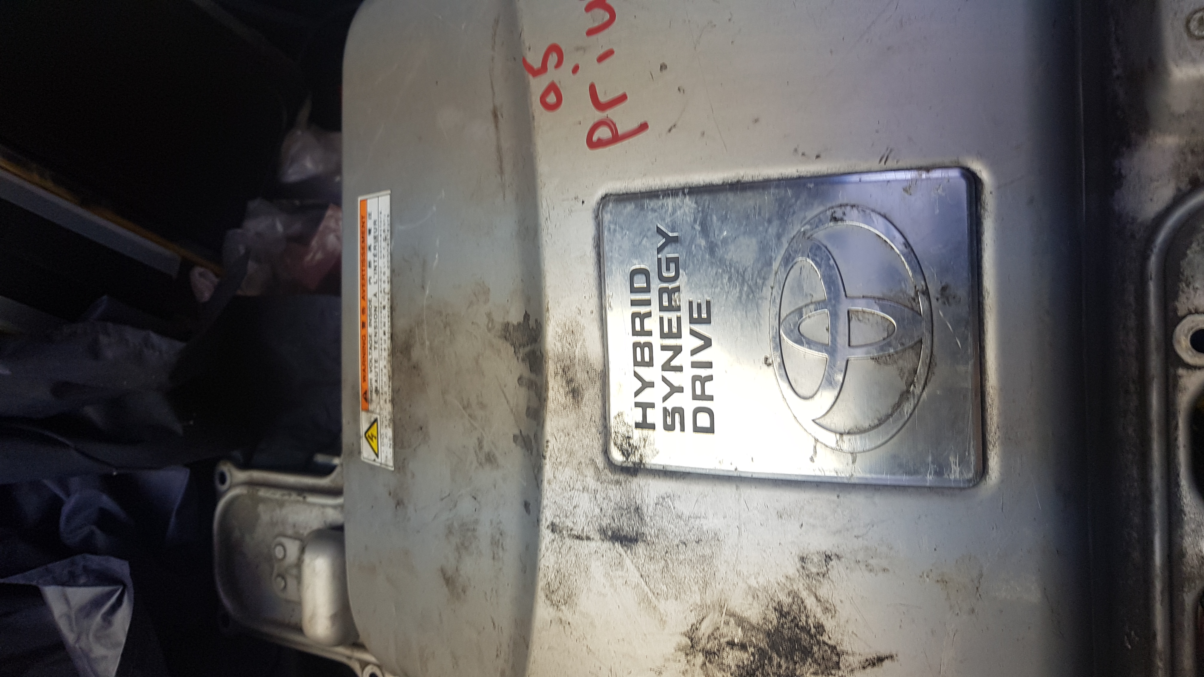

Finding this thread very informative and interesting, so much on friday was passing a scrappy I frequent and called in. Foe some reason I see these places as most people see libraries. Yes, you guessed it. He had a Gen2 not in the least pricey. Will check to see if there are any pcbs on evbmw.
Should this work out, and I see no reason why not, it will be the cheapest of all set ups.
I just gave myself another project.
Apart from increasing my knowledge what can possibly go wrong ?

Posts: 28
Joined: Mon Jan 13, 2020 1:53 pm
Location: Russia
Re: Toyota Prius Gen 2 Inverter Controller
Post by Alexstarex »
in the picture is 1st generation. Need an inverter 2 generation
SciroccoEV
Posts: 370
Location: Luton UK
Been thanked: 15 times
Post by SciroccoEV »
I was under the impression that anything bearing the 'Hybrid Synergy Drive' badge was Gen-2.
