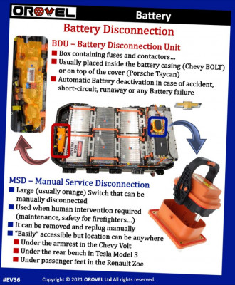

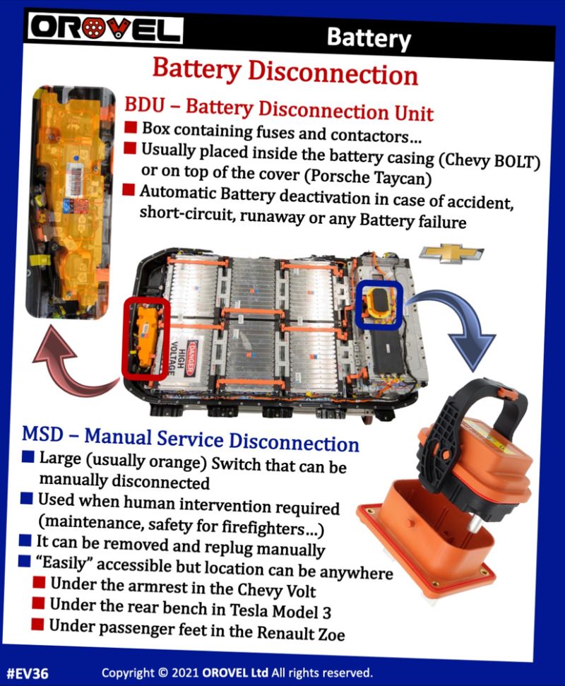

Does anyone know what type of device this is ?

I am looking for a quick way to disconnect HV wiring from the battery to the main contactor box. I have been told NOT to use an Anderson Connectors due to the high currents involved under normal operation. I was looking at 600V welding cable connectors capable of handling up to 400 Amps. Any comments/suggestions?
