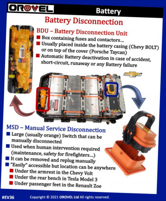

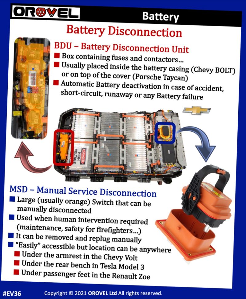

Post by zippy500 »
SciroccoEV wrote: Sun May 28, 2023 9:17 pm Stuck contactor detection is something you should really have anyway.
Thanks for the replies
Does anyone know what type of device this is ?

One thing to note that boxterev pointed out is the amount of times your going to open up the battery box (especially if you have a hvjb in it) will be alot so an easy method to break the hv circuit is a must! This doesn't necessarily mean an expensive fuse thing it can be as simple as some AliExpress hv conectors and an unplugable wire e.g.
