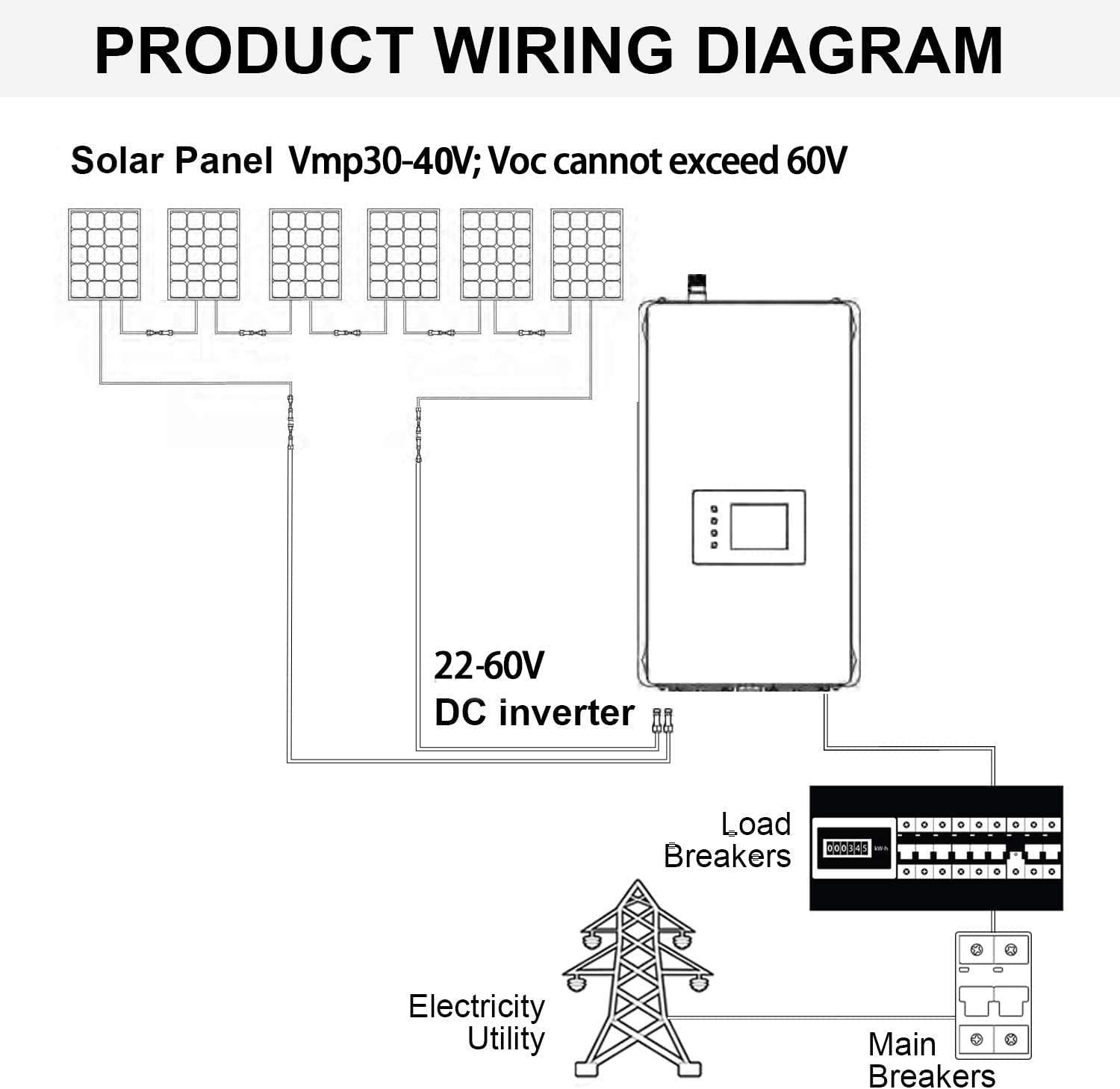

Any chance you've looked at how to limit the PV production based on your house consumption needs?
I've spoken to PG&E (my grid company) and they said it's not allowed to send energy back to them without permit-ing system and signing up for their NET metering program. I've read somewhere that some folks received letters of warning from PG&E, that they will get disconnected from the grid if they continue sending back energy.
I have now successfully installed 200w panel with a 1000w inverter which produce max. 155w. My house consumes under 250w in idle (green house grow lights, ambient lights, internet, other small things, etc.). But then once in a while a fridge kicks in, washing machine, dryer, etc. Needless to say, I'm in the market to get more panels. However with that brings a question of how to not send the excess energy back to grid at all. As I understood, these inverters do not natively support current limiting function.

alexbeatle wrote: Fri Jun 02, 2023 6:48 pm Any chance you've looked at how to limit the PV production based on your house consumption needs?
Excellent question and yes. These cheap Grid Tie inverters do not have a current limiting function, however that does not mean none of the Grid Tie inverters don't have it. My other inverter which I was going to bring up later (might as well do it now) does have this feature.
Wow they really went up in price since I purchased mine.
this is a much more efficient inverter as well, it only has 10% losses, I am not using the current limiting function but I might set it up, I also bought the remote Wifi dongle for it but I could not get it to work.
