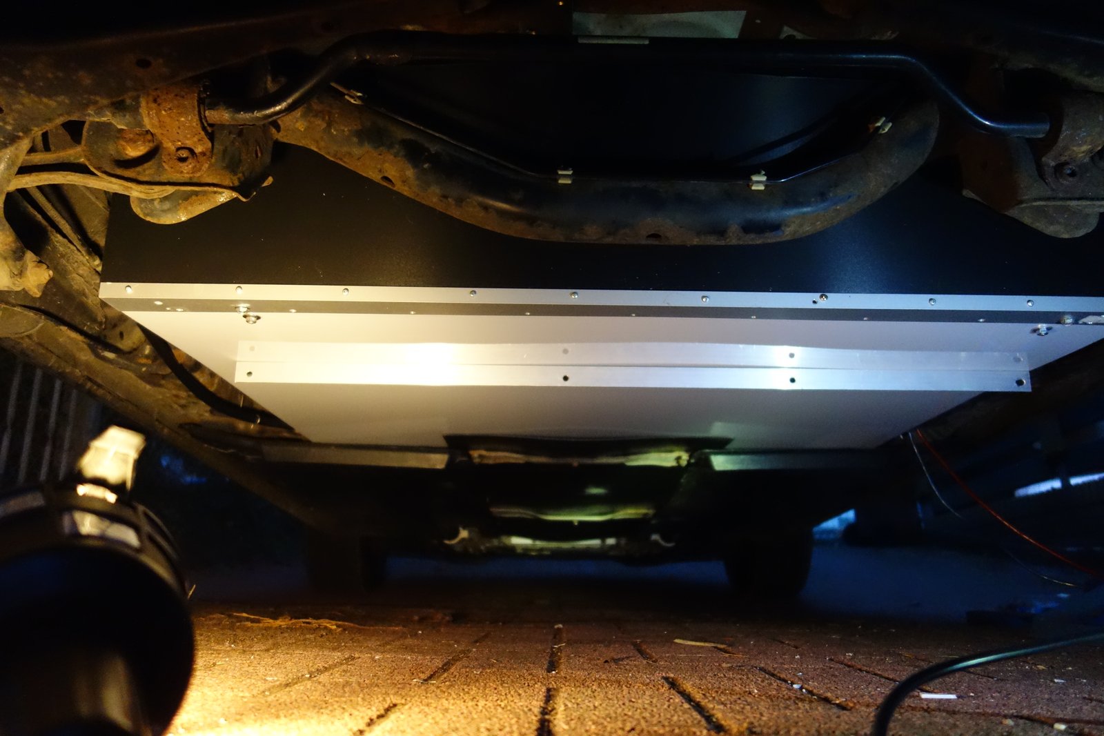

I've closed off the exhaust tunnel and battery pack last Saturday, look really slick :) Pictures later.

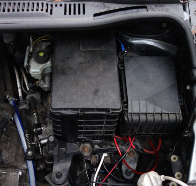

Some good progress today.

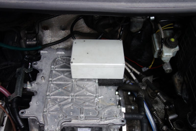

I permanently fitted the Meanwell into the original battery box together with 4 40Ah LFP cells and a chunky 200A 12V relay. The latter is needed to interrupt the connection when the car is off, as the Meanwells output will sink 200mA from the battery. Since the relay sinks 400mA I used a P-MOSFET whose gate is pulled low (i.e. on) by the DC switch OD signal.
Also boxed the DC connection to the Nissan inverter. The original DC cable is held onto the inverter with a bracket that also grounds the shield.

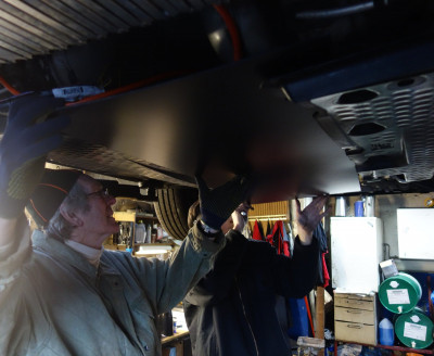

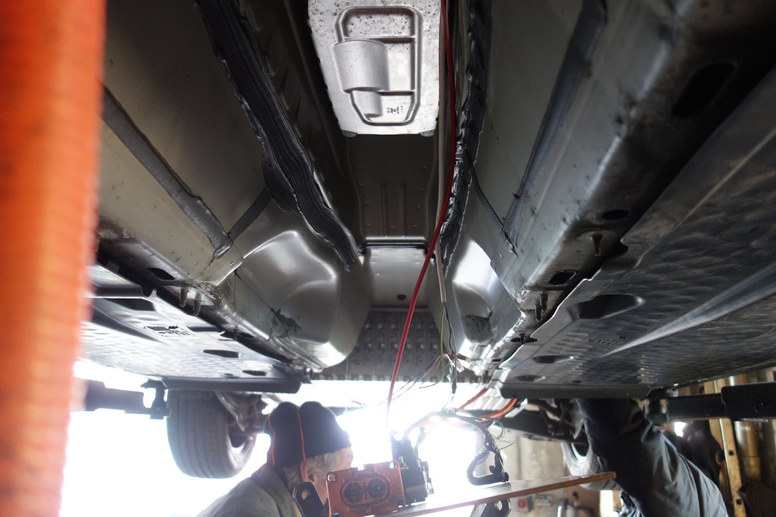

And finally here are some pictures from the workshop when we installed the underfloor cover.

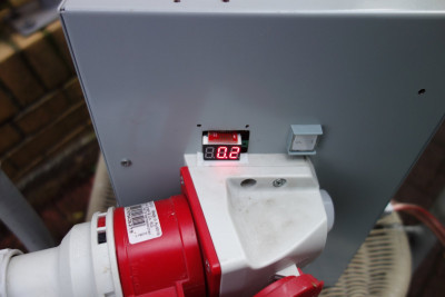

Did some semi-fast charging today :) It's the remainders of the EMW charger but sporting an inverter mainboard for control. It has a nice 3-phase rectifier and the inductor is good enough for 30A. So about 11kW at 380V.
As there is no charge control I have to put the car in drive mode. Of course one time I forgot an fried the precharge resistor :(
But then it worked. Basically it logs into the car wifi and reads the Nissan BMS charge current limit from there. Since it's quite cold the limit was 9kW and it dropped to 3kW as the battery filled up.

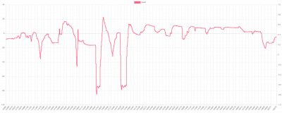

Did a bit of test driving today in 3rd gear. While I was at it I created a power plot as reported by the BMS. Reached the original Leaf power now, running 450A motor current :) Still improvements needed in the higher rev range, the car becomes sluggish. I could however record the positive influence from the second field-weakening controller. It increases -id if iq becomes too low (unwanted regen). It certainly dampens the effect. Without it I got 100A of unwanted regen above 7000rpm (setpoint 0A). With it set to -70 that is dimished to 20A.
Also fixed cruise control. All throttle action is now governed by the ramp. that way cruise control can't accelerate so hard that the current limit is hit.

Nice! Is 450A what the Leaf pulls stock? I always thought it was 200A due to battery limitations. There's at least a 200A fuse in the disconnect, but I'm not too familiar with the behavior of fuses at this size.
Posts: 6769
Has thanked: 384 times
Been thanked: 1589 times
I'm assuming they pull something around this (or more) till 3000 rpm and then start limiting. 450A is AC, only a fraction governed by the sine amplitude shows up on the DC side.

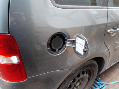

So I decided to put the ChaDeMo port where the fuel filler used to be. Decided against putting it in the front because:
  • Wasn't really wheather proof
  • Looked strange
  • Would have needed to turn the main contactors on for charging
So now it's in the back. I had to make some sacrifices. It's twisted 90° because it wouldn't fit otherwise and the lid doesn't fully open.
Is the twisted socket a problem at the charging stations? And do I need to work on the lid to make it open fully? Would it be a problem if I remove the lid?

Sideways socket, I think no problems. A part from stress to connector.
The cables are usually long enough.
But also quite heavy/stiff.
But the plastic chademo port lid must open near 90degree for the chademo connectors to fit.
Could you fit it in 45° angle?

johu wrote: Sun Feb 09, 2020 12:54 pm Is the twisted socket a problem at the charging stations?
The CHAdeMO cable is very heavy, i'd be surprised if this survives especially is someone knocks it.
johu wrote: Sun Feb 09, 2020 12:54 pm And do I need to work on the lid to make it open fully?
Yes, some of the connectors are huge.
johu wrote: Sun Feb 09, 2020 12:54 pm Would it be a problem if I remove the lid?
You'll need to keep the connector pins dry... the charger isolation test is quite sensitive to moisture.

Thanks for the quick reply :)
Yes I can imagine that these handles are heavy, just looked it up:
So I guess I'll need to suspend it with with a string... No way to turn that socket the right way.
Concerning the lid I should be able to chop away some plastic

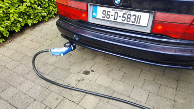

Der Panzer has a Chademo port at a right angle. No problem using it at public charge points. What about a Chademo "exhaust" ? There is usually alot of free space under the rear where the back silencer lives.

I like that "exhaust" idea. If we can provide weather protection it may become standard.
I would rather put a L2 Mennekes socket in place of the fuel lid. Pretty much all fuel filler necks are similar size.
https://leafdriveblog.wordpress.com/201 ... onnection/

Just worked on the battery cover a bit more. That middle rail will be replaced by a smaller one.
