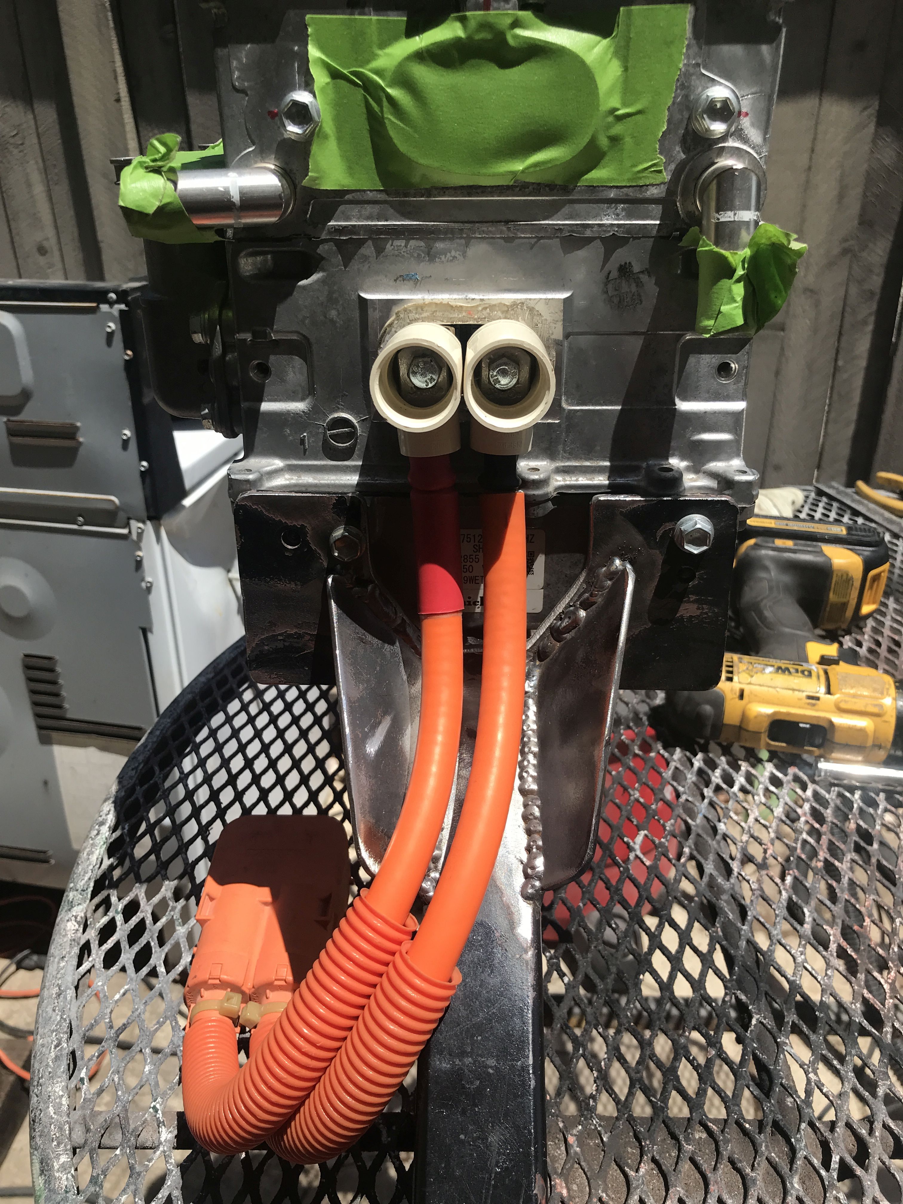

in order to get the 360 high voltage wires as close to the inverter as possible we have to modify the inverter bracket

so this is what I'm going for I call it the Winged Hussars design

at this point I've reached the I don't give a shit any more phase of the gentle trimming and I just went for it, and whalla a perfect fit every time !

alright, these cables better reach
this is just a trial fit, the black plastic cable bracket is just loosely dangling on there (I didn't have the energy to deal with it that day)

I appreciate your comment but this is now turning into a three ring circus, I originally wanted to go with copper but could not find any so I wanted to do aluminum, but someone said that they may snap off, so I ordered steel stand offs and I got this message on DIY Electric Car, please check it out for funsies, this should take you directly therecrasbe wrote: ↑Sat Jun 24, 2023 9:54 am Compared to aluminium and copper, stainless steel is a terrible conductor: https://de.wikipedia.org/wiki/Spezifischer_Widerstand (the English wikipedia uses different units..)
We have a specific resistivity of ~0.017 (Ohm * mm²) / m for copper, 0.1-0.2 (Ohm * mm²) / m for steel and 0.72 (Ohm * mm²) / m for V2A stainless steel.
Keep in mind: less is better, which means copper conducts 40x better than stainless steel.

Well now, that's something we can calculate, can't we?
With a thermal expansion coefficent of 23.0e-6 1/K for Aluminium and 13.0e-6 1/K for Steel, and an assumed length of 1 banana (25.4mm) for your spacer and a whooping 100K temperature difference, we arrive at an elongation of 58nm for the Aluminium spacer or 33nm for the Steel spacer.
(For copper it would be 42nm and for brass it would be 44nm).
For completeness we would have to calculate the stresses introduced by the elongation of the spacer, but for that we would have to know the precise torque of the bolt etc etc. There is just no sense to calculate that.
I would say that the difference will not cause your bolts becoming lose. Especially if you use loctite
Conclusion: Just use brass like everyone else. Or use copper, the internal busbars of the inverter are bare copper as well and it doesn't cause any problems.
Or you could use tinning paste (like solder paste) to coat the copper spacer in tin.
=> Use whatever except steel or stainless steel

maybe this will work, I would love to ignore I mean hear your thoughts
that may be a 20 amp fuse I may shove something lesser in there or morer I don't know, whatever you recommend
I am also entertaining the idea of just shoving this entire black BMW Safety Box into one of them electrical plastic boxes and not even putting it's flimzy OEM lid back on just using the lid from the bigger electrical box, bonus if I can find an orange one

Think you might have your decimal point in the wrong place, I make it 58um (or around 2.36thou) for the above materials and sizes.crasbe wrote: ↑Thu Jun 29, 2023 10:28 am Well now, that's something we can calculate, can't we?
=> Use whatever except steel or stainless steel![]()
Couldn't understand how it could be nm as then thermal shrink fits of shafts and bearings wouldn't work!
Agree completely though - make it out of copper or brass and it will be fine.
