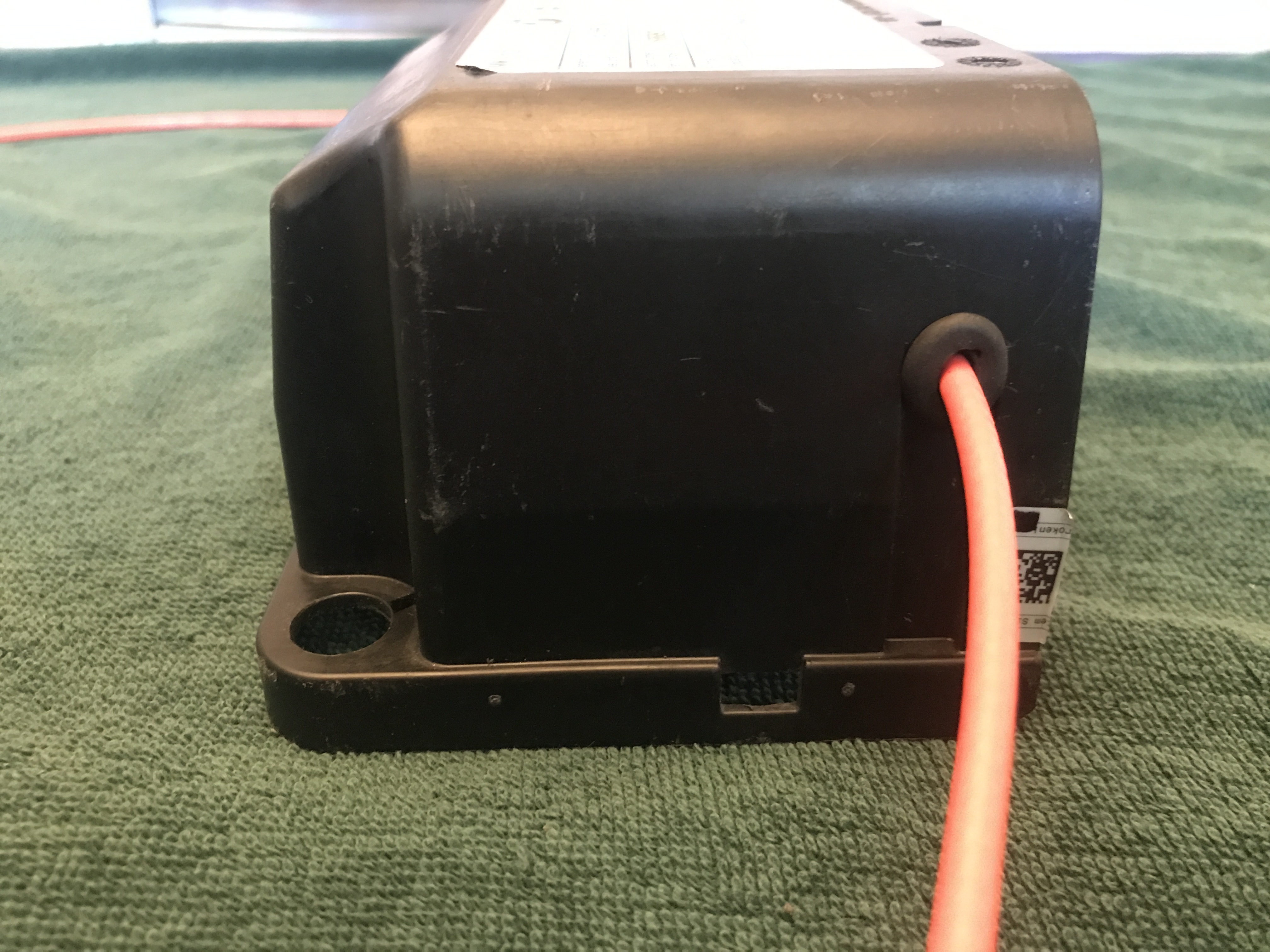

Post by Gregski »
Take Cover !!!
I only work with the finest of metals from my scrap pile.
this is just a trial fit, she will get a coat of paint and maybe even some sort of a rubberized gasket

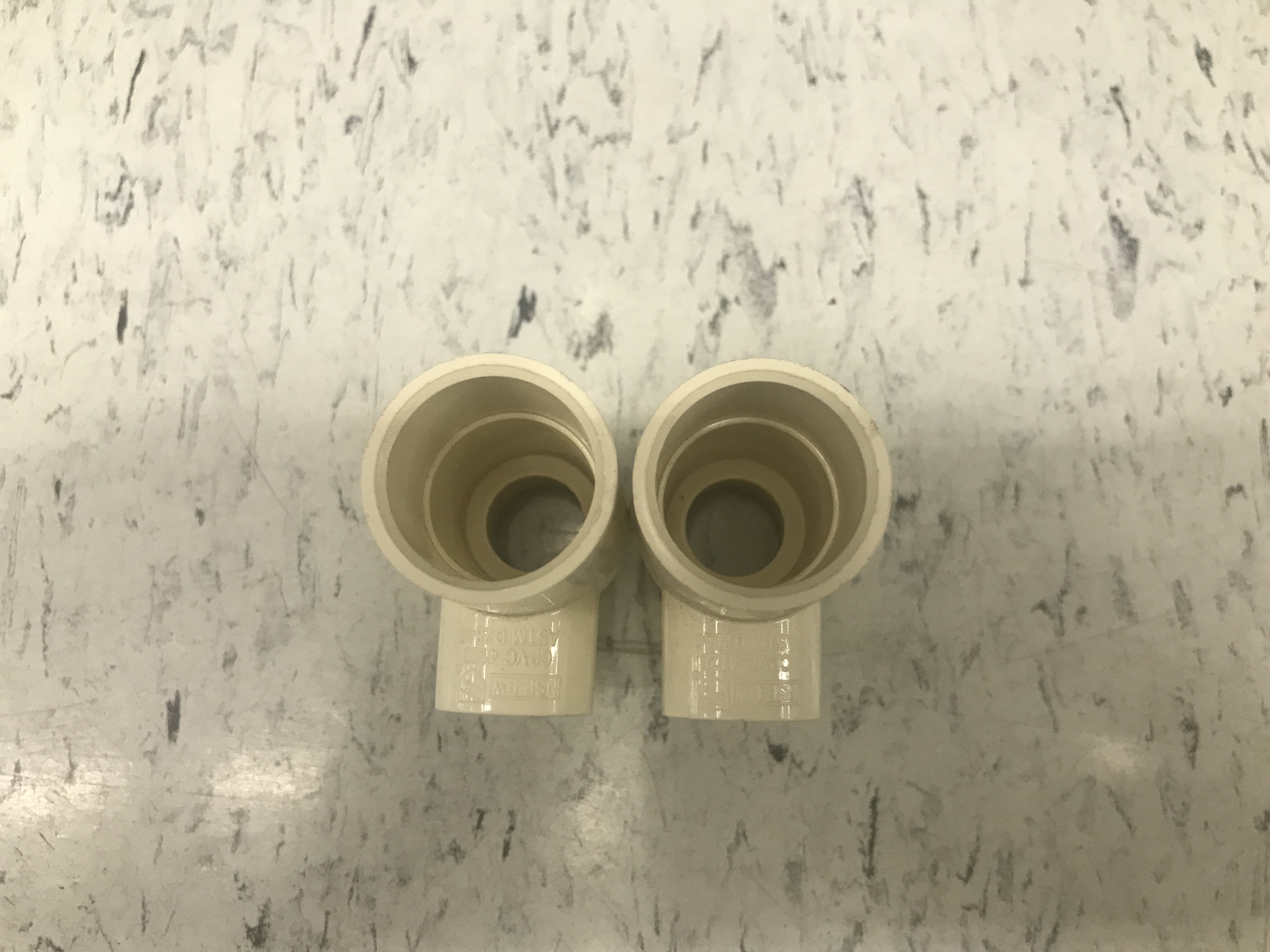

let's spit ball here
Charlotte Pipe FlowGuard 3/4 in. Slip X 1/2 in. D Slip CPVC Tee
Item #41952
Mfr #CTS024002000
What, are we plumbers now?

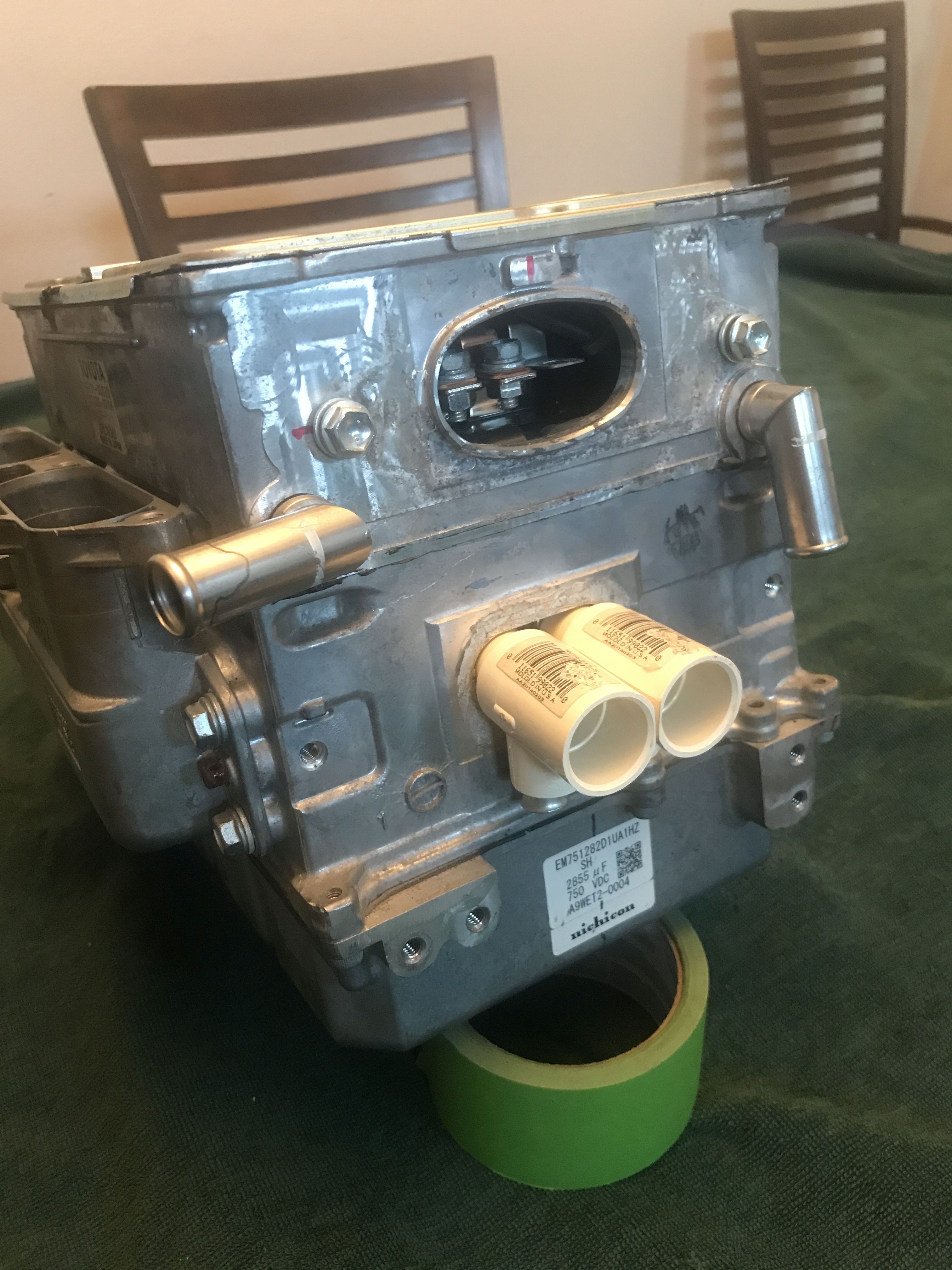

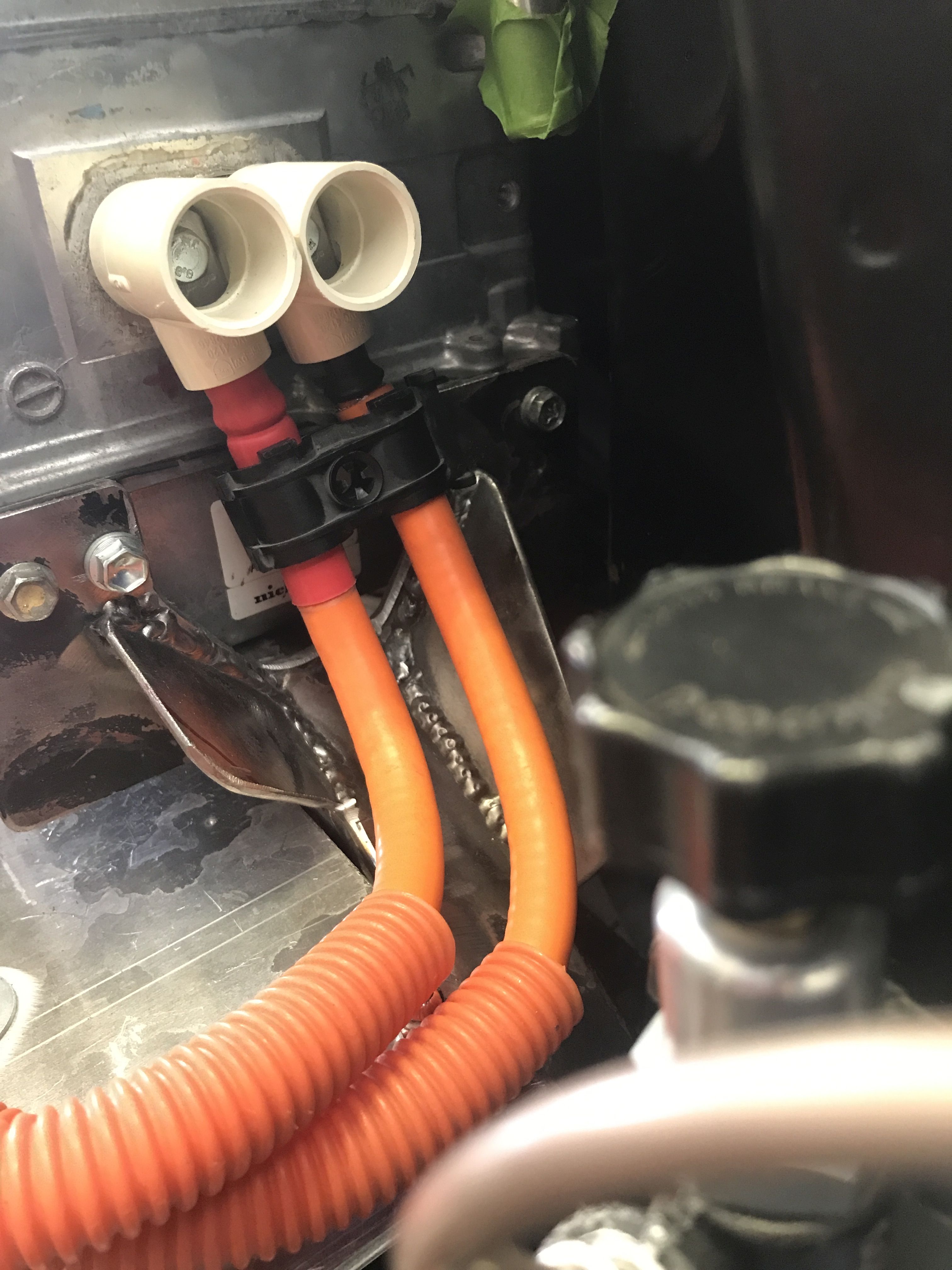

Where are we going with this? OK, 1" spacer
Gregski
Posts: 3163
Has thanked: 633 times
Been thanked: 1609 times
Post by Gregski »

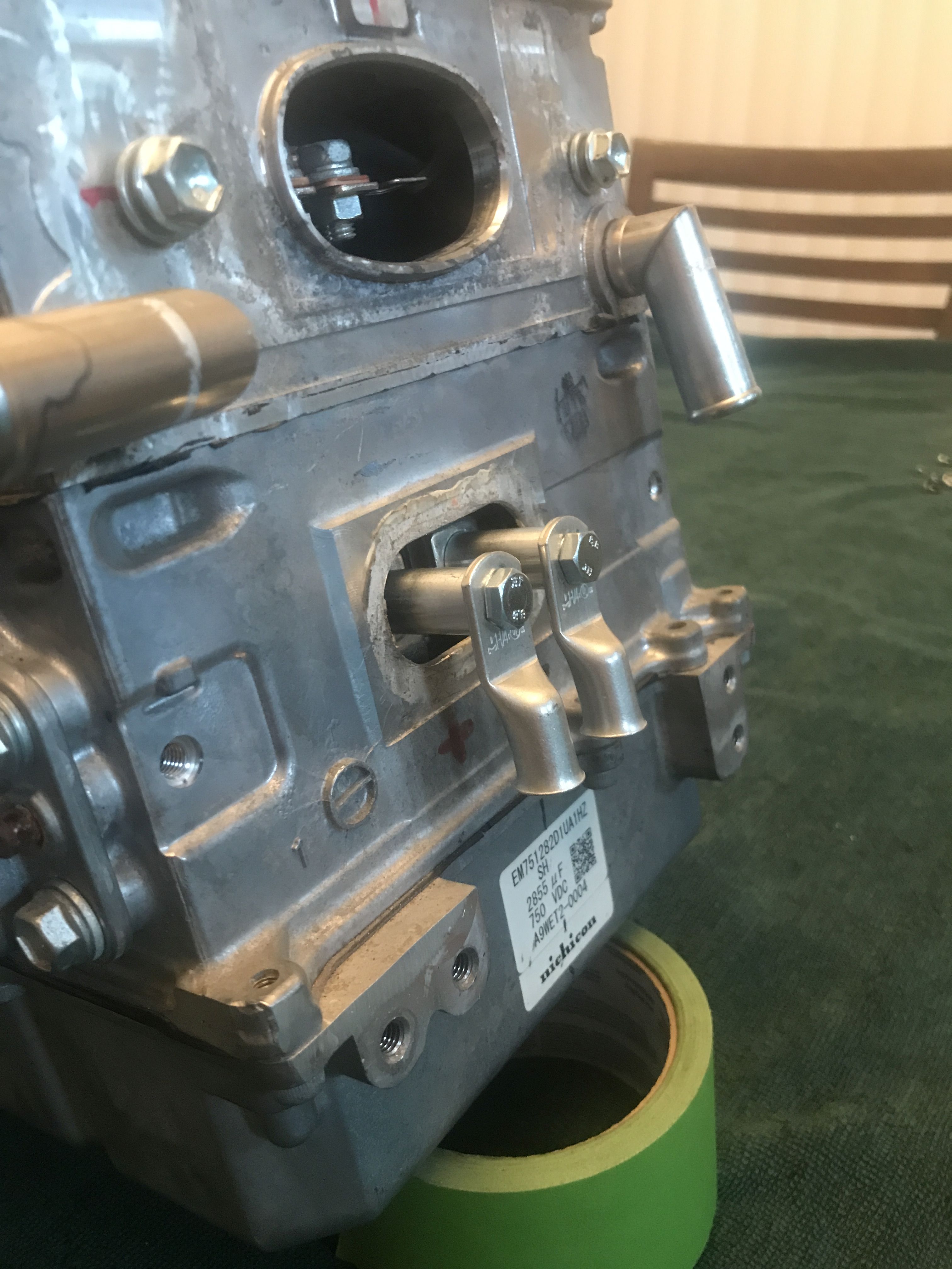

the Double Barrel Shotgun design TM
Note: some filing and grinding required to make that cable lug fit in the 1/2" hole

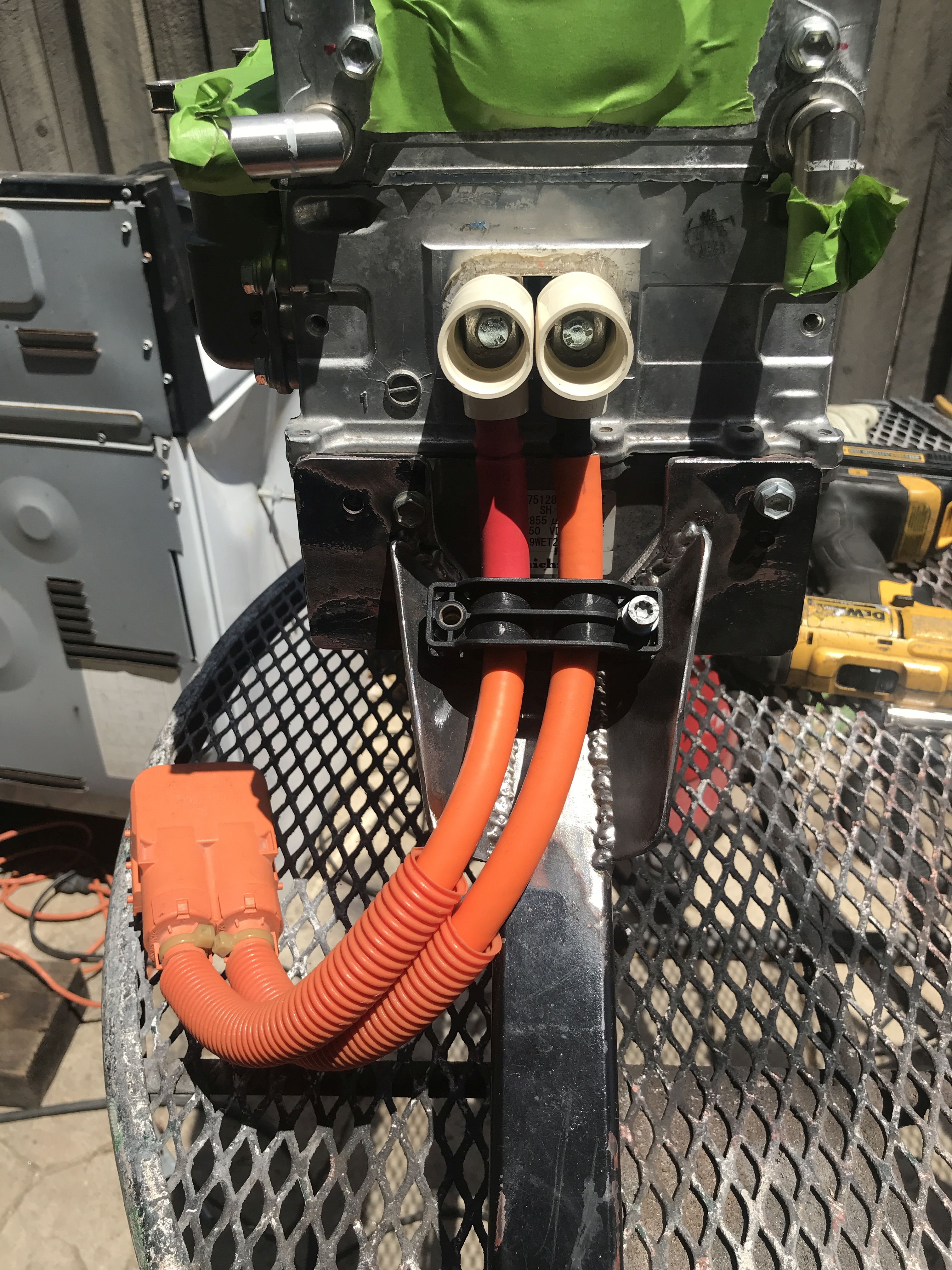

I like this a lot

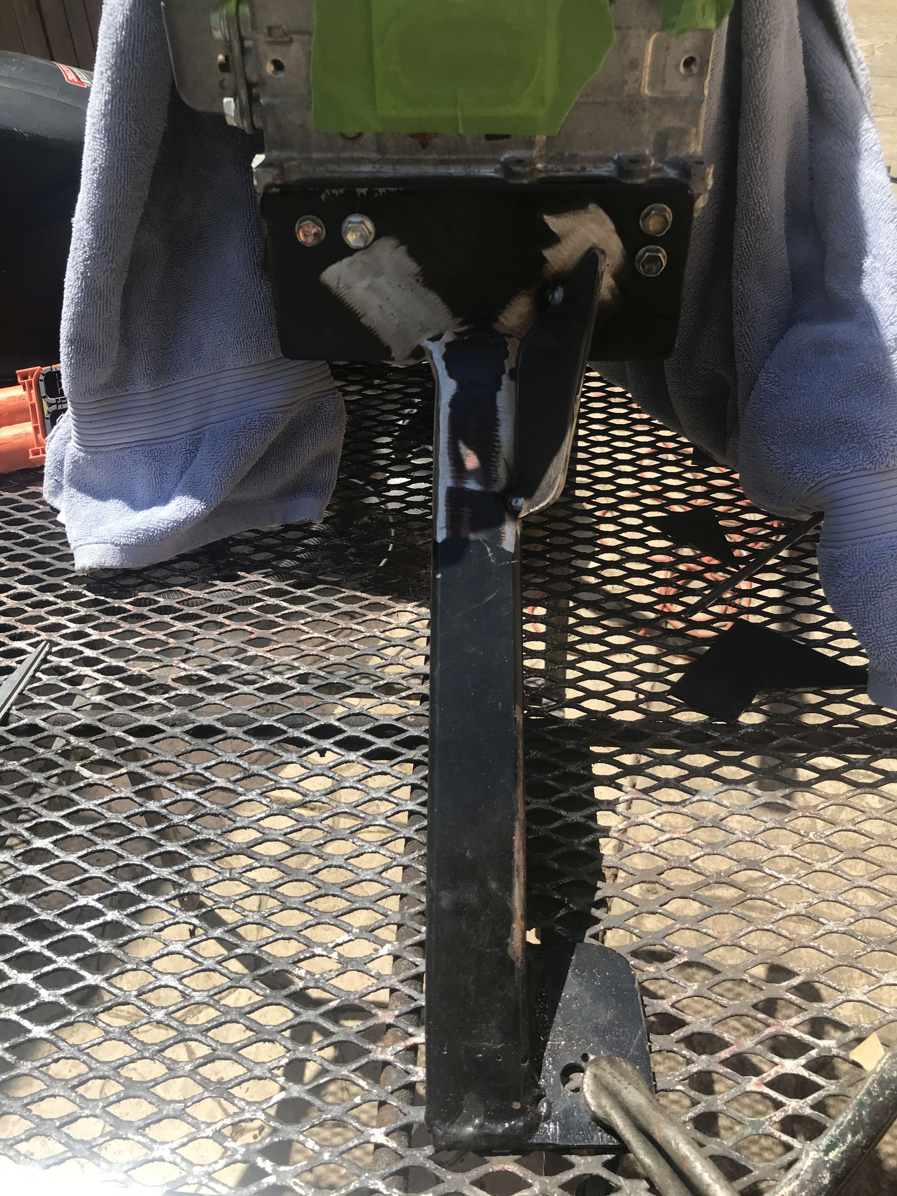

Post by Gregski »
in order to get the 360 high voltage wires as close to the inverter as possible we have to modify the inverter bracket
Gregski
Posts: 3163
Post by Gregski »

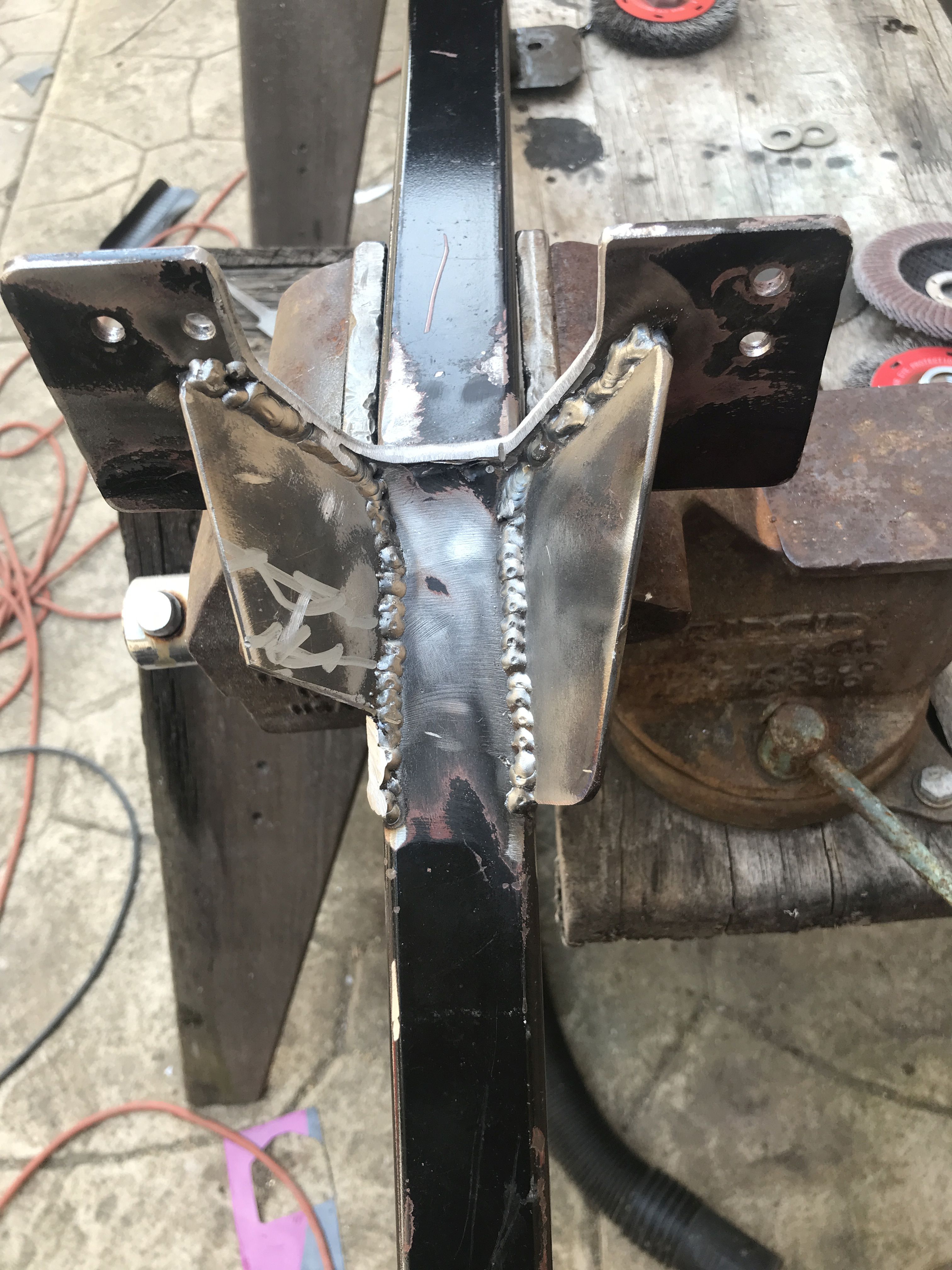

but first we must reinforce what's already there and what will remain after the debauchery that is about to ensue
Gregski
Posts: 3163
Post by Gregski »
for this we will need some metal, so off to the Shed of Stuff where it appears we are running a little bit low on stock

this piece seems large enuff
Gregski
Posts: 3163
Post by Gregski »

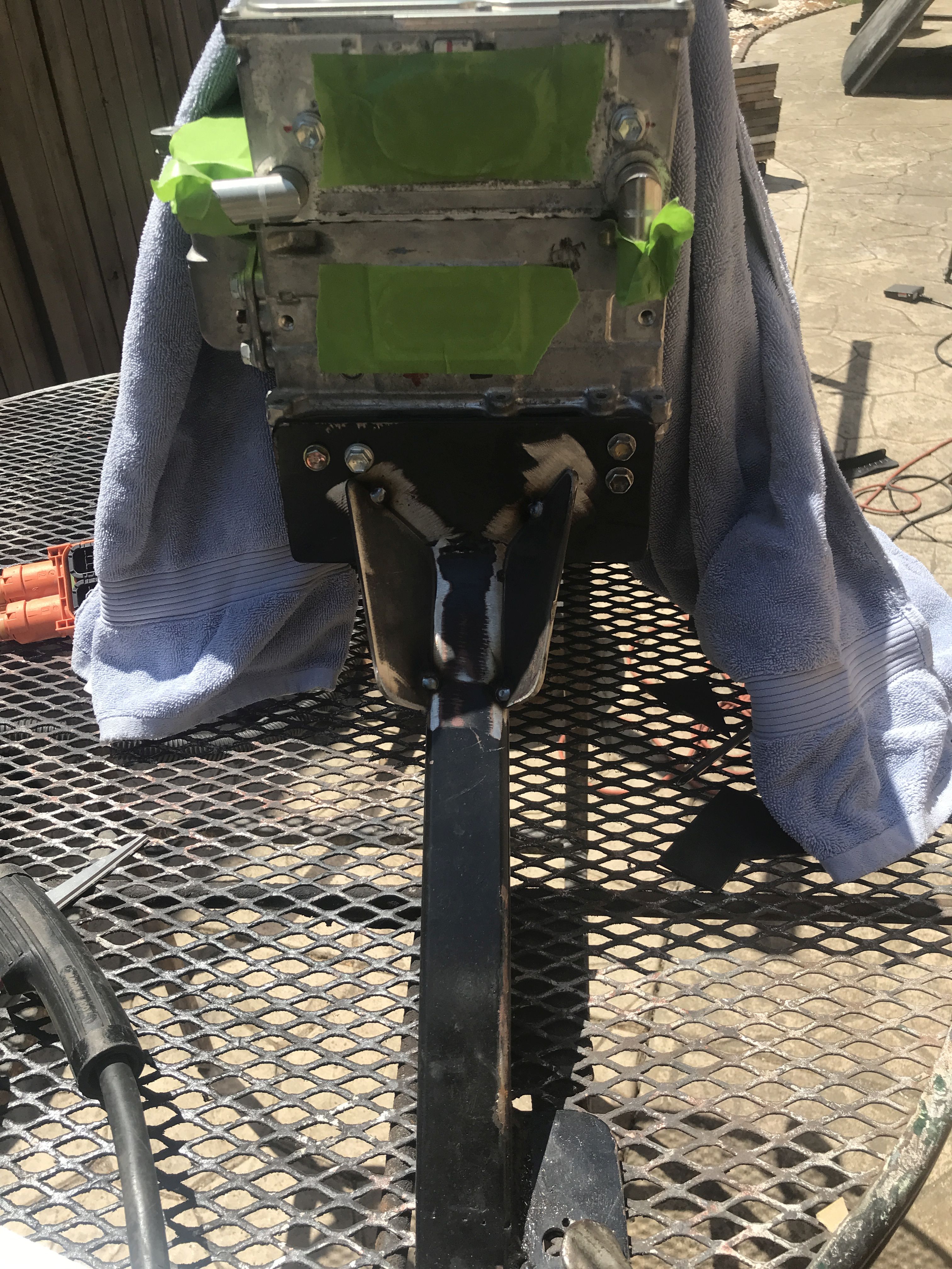

so this is what I'm going for I call it the Winged Hussars design

I like to prime, paint, and clear coat all my custom made brackets first before cutting them up... (can any of you relate?)
I'm still working on my Welding Game and here I tried the tac tac tac method (dumb I know)
first attempt at the proper cut out

so that first cut out wasn't wide enuff to clear a plastic cable bracket I wanted to mount right below the lug connection, so I had to make a bigger cut out
and here I am trying a totally different plastic cable bracket, just spit ballin' ideas on the fly

you've heard of death by a thousand cuts, well this ended up being design by a thousand cuts
after attempting to trial fit this newly augmented inverter bracket I of course realized it would now not clear the battery lid tray thingy, so I lopped a section of the left wing off (that hurt, cause I am all about symmetry)

Post by Gregski »
alright, these cables better reach
this is just a trial fit, the black plastic cable bracket is just loosely dangling on there (I didn't have the energy to deal with it that day)
