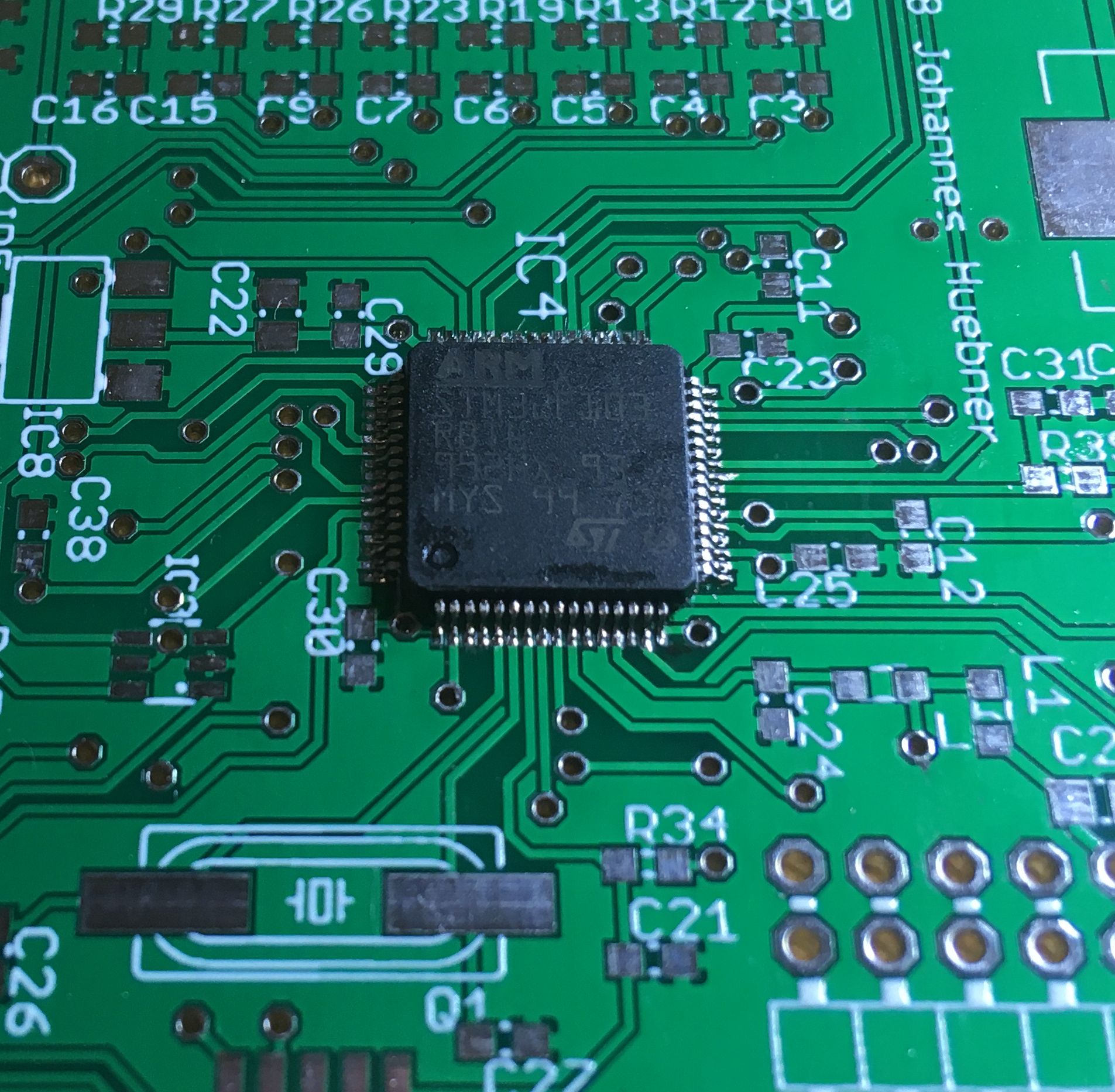

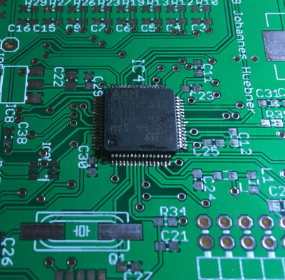

Here below is my trial with TQFP64 + Johannes v3 board. According to some videos, like:
"www.youtube.com/watch?v=K5NXu20749U"
I used flux (and should be more even I first expected), then maybe better will be to use flat iron, but I don't have this so I used normal sharp iron end.
Important: aligninig is very important like Johannes said - with good position it's really easier. Like is visible - mine is not perfect :)
So, next will be board from Damien (thx Damien - PCB arrived in good condition) with TQFP100, hmm we will see...

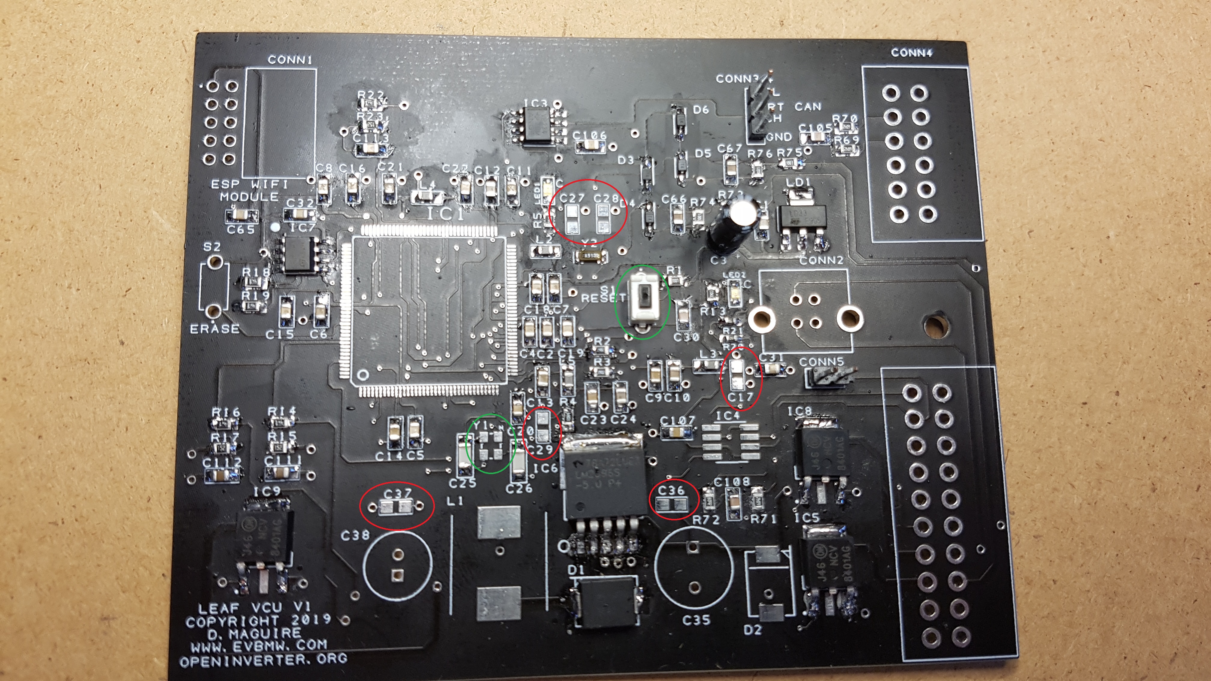

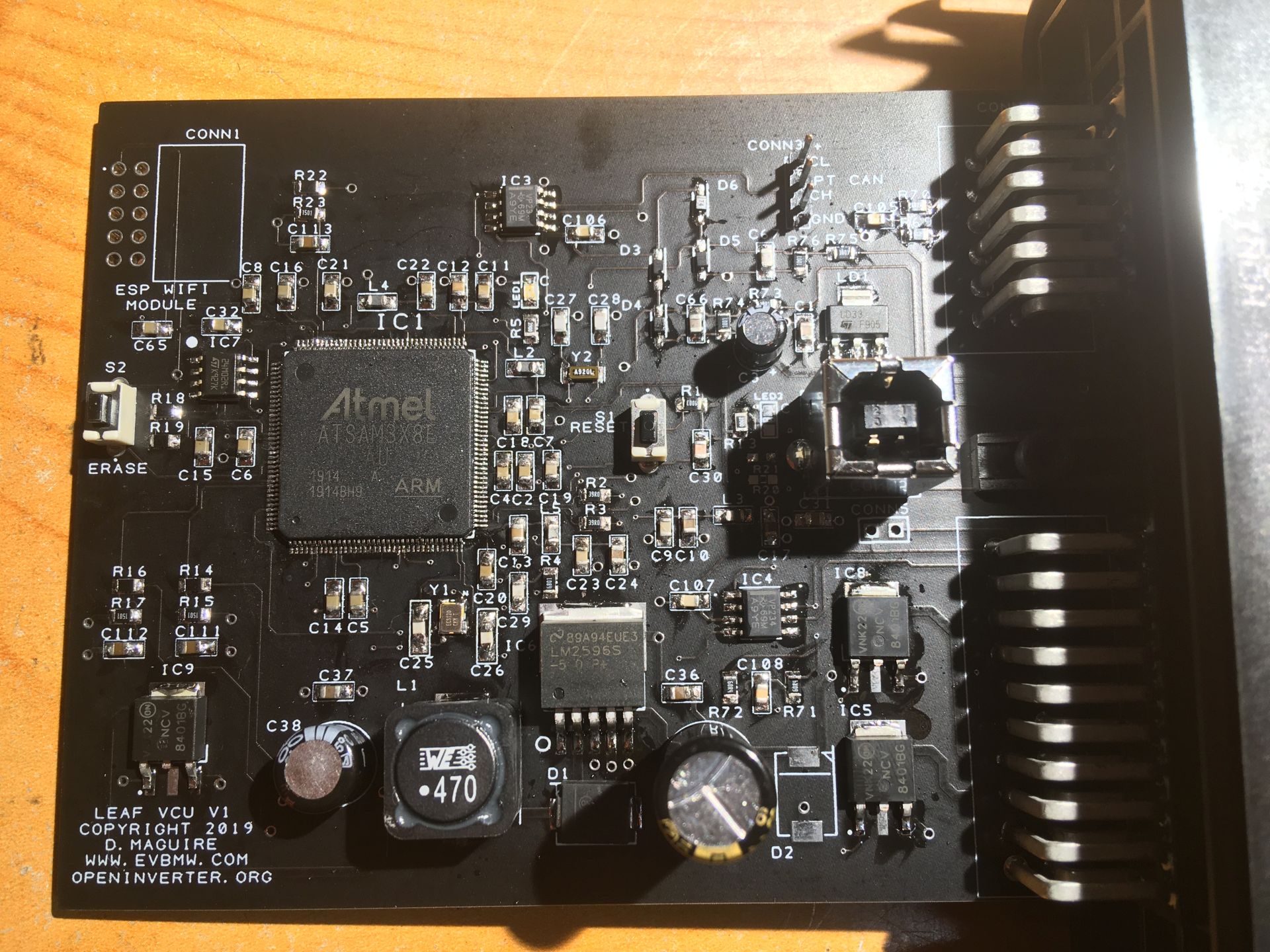

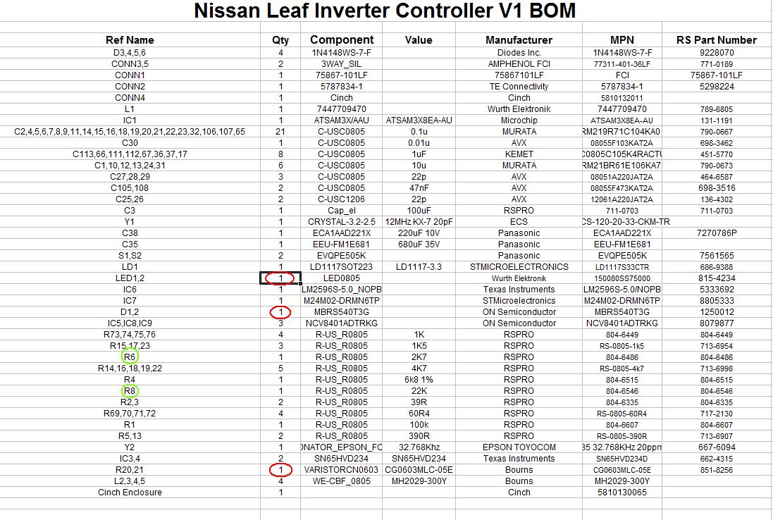

OK, so spent the last two nights piecing Damiens VCU board together and have a couple of questions. You can see right away I have not attempted the chip yet. Waiting on a couple of suitable solder tips before I attempt this. Not the tidiest but waiting to do a bit more before cleaning the board down.
Has anyone worked on this and noticed that on the board that C17, 27, 28, 29, 36, 37 (all circled in red) are missing from the BOM? Also, in the BOM, C38 and C35 are nowhere on the board. Can you shed some light Damien if you are reading this?
The others (circled in green) are just component orientation questions. Do I have S1 the right way with the small gap/arrow pointing to the dot on the board? The other is Y1 crystal. There are 3 square pads, and one with a notch taken out of it. Does the 'notch' align with the 'N' on the board?
Thanks all!

Cookie6000 wrote: Sun Nov 24, 2019 10:16 am OK, so spent the last two nights piecing Damiens VCU board together and have a couple of questions. You can see right away I have not attempted the chip yet. Waiting on a couple of suitable solder tips before I attempt this. Not the tidiest but waiting to do a bit more before cleaning the board down.
Thanks all!
I have updated the BOM to reflect the missing parts. C38 and C35 are most certainly on the board. Look closer:)
The switches are not polarity dependent. Y1 is. Now this is the fun part: some versions of Y1 have the notch in the wrong place so if it doenst talk over usb this is my first port of call. Just flip it 180 degrees. Don't ask me how I know this.

Ah!! Of course... I was leaving C38/35 till later. Brain fart sorry.
Thanks for filling in the blanks on the updated BOM and Y1. I have one or two components that were ordered but cannot find so, small order to be made. Thanks. Hope to have it completed during the week.

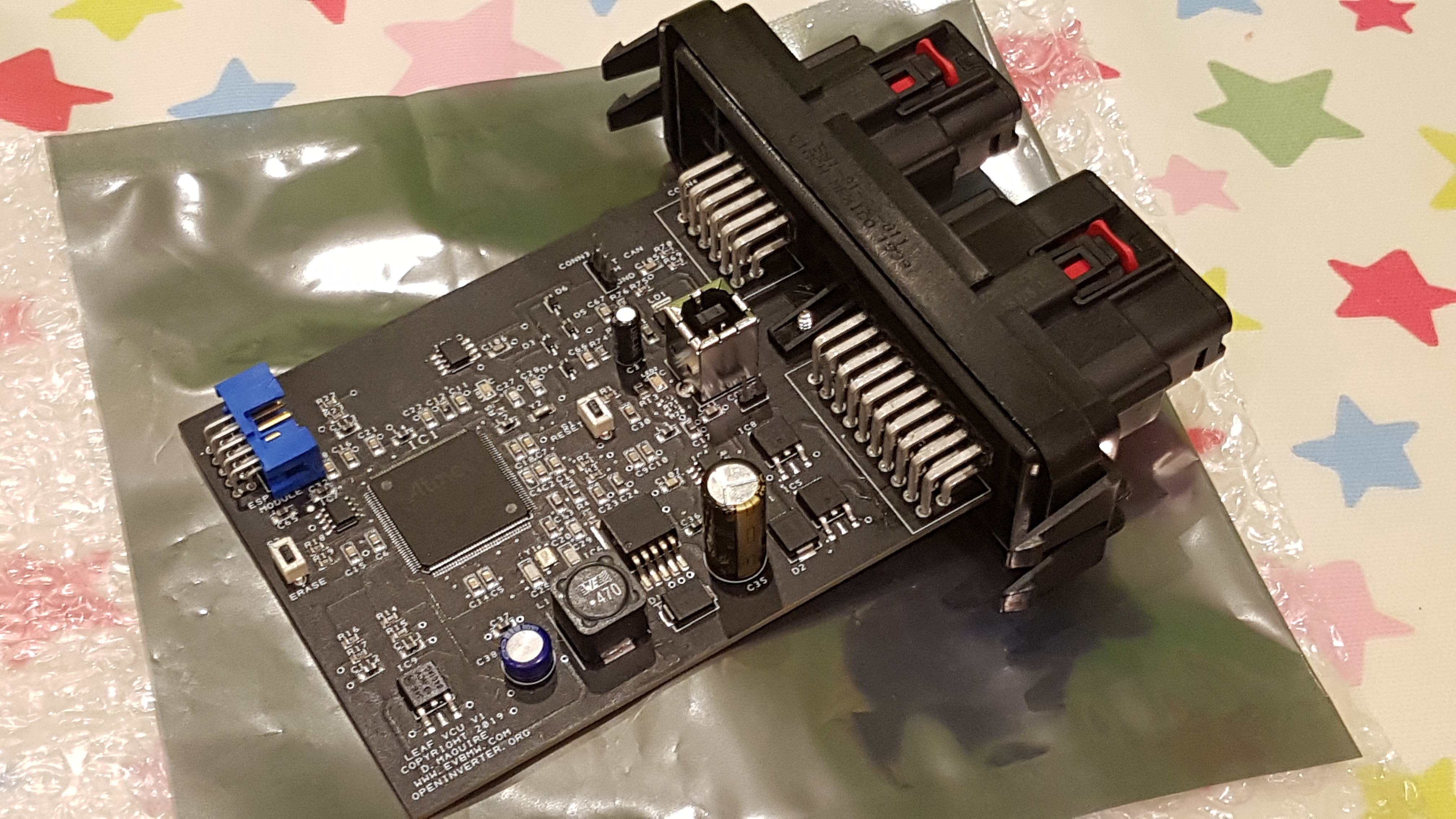

Ok, my board is almost done because of my fault I've missed 3 parts. In BOM are (in red) by 1 pcs, but on pcb are 2. I was looking in quantity column into BOM and now I have to wait until christmas will end :(
Another thing - R6 and R8 (in green), like Cookie6000 wrote are missed in action - will wait, until I will have new glasses.
Below is my board - I hope it will work.
Next days I will start new topic in Projects, where I will start show my progress with BMW E87 with Leaf motor/inverter. I hope it will help other users to go on.
Regards.
d.lo

Today my board is soldered and finished end even LED2 is working, so 3V3 is on board. I want to program this to make some trials, but I haven't present some external libraries.
Previously I want to ask all of You where I can found missed libraries but in meantime I found them, so here are links. Maybe someone will need them also
- due_wire.h (now i found this at https://github.com/collin80/due_wire/bl ... due_wire.h
but then I need to find twi.h which I found at https://github.com/esp8266/Arduino/blob ... 8266/twi.h
- Wire_EEPROM.h at https://github.com/collin80/Wire_EEPROM
Of course we need to install arduino due boards and then on my PC was possible to compile sketch.
Then after compile I had error 0x285e0a60 when I tried to write program to ATSAM8E. That means I had to change board from Due-Programming port to Due USB Native Port. Now was possible to write program. Now LED2 shines and LED1 blinks so I think program is working?
On the CAN port interface I hope will be visible some data so later I will connect this to inverter.

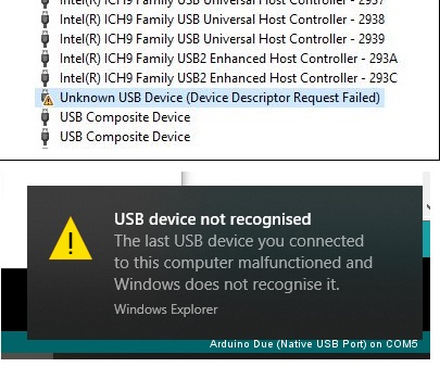

Took a while but, got the board back from resoldering the microcontroller. Nice job too. Today I finished soldering the remaining items including wiring up and labelling the VCU connectors.
After that, I proceeded with getting on with the Arduino IDE with the board connected up. When I connect up my FTDI or Arduino Due, no problem. They setup just fine and you can see them. However, when I connect the Leaf VCU, I just get USB connection errors. I try and update drivers with no success. All drivers are up to date.
Damien M did say that there was the odd chance that a crystal could be reversed on the board as their orientation markings changed depending on manufacturer. Does this look like that or is it something more basic I am missing? Tried on two laptops now. Due and FTDI work fine, Leaf VCU not.
Posts: 3667
Has thanked: 12 times
Been thanked: 353 times
Re: Leaf Gen 1 Inverter Board
The crystal is backwards. That Damien M guy sounds like a moron.

Crystal flipped. Still nada. R2 and R3 are correct at 39ohm. Dilbert suggested checking as they might have been 3.3ohm.
Next step?
**EDIT - did a bit of a tidy up. small bridge. Can see it now on COM port 8... onto the next stage. As you were...

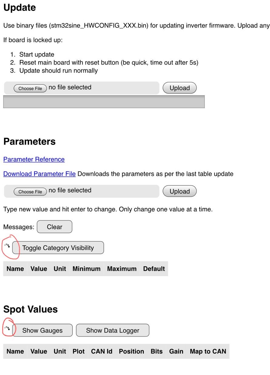

Good few nights this week to get where we are now. Followed arbers instructions flashing the ESP8266 via the FTDI board all the way down to the last line - connect your board to Johannes board...
Am I correct in saying that the Johannes web interface will work with the @evbmw Leaf VCU or have I missed a beat? Reason I ask, James (project Fig-leaf) and me have been working together to get to this point and where we see this when we both connect up our inverter and boards. No settings.
Should we be doing everything through IDE or should http://192.168.4.1/ be working? All ready to go...

So folks where exactly did it say that I had implemented a fully featured interface for this thing using the inverter web front end? I think it's a really cool idea by the way but sadly my attempts to clone myself have been .... well.....messy so far thus I have not done so.
Now, it is your lucky day as I have just been doing some donuts in the grey goose and have posted a new firmware AND a Wifi display on the github. You will however have to wade through my feeble attempts at C programming to calibrate your throttle etc.

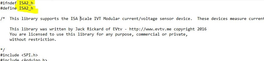

Ploughed ahead and flashed the leaf vcu with the new firmware update as outlined below. Tricky finding the ISA.h libraries but found the zip file here in the end at the end of the page:
http://store.evtv.me/proddetail.php?prod=1kshunt
I found though when compiling, an error appeared referencing ISA2.h library
Opened the .h and .cpp file that were causing the error and removed the '2' in 3 locations in the code and all ran fine then. I am a basic programmer but it made sense to me to do it. Correct me if I made a balls. Now I have a vcu newly flashed with all the updated features added complete with slower flashing led for ref.
