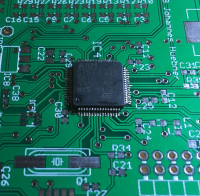

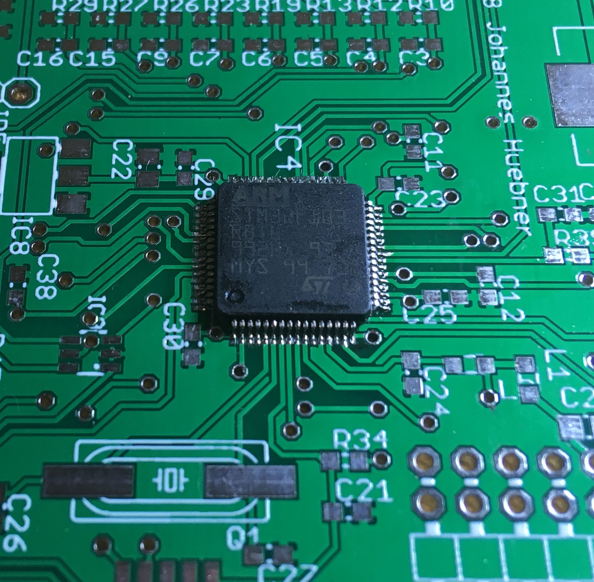

Hello,
Here below is my trial with TQFP64 + Johannes v3 board. According to some videos, like:
"www.youtube.com/watch?v=K5NXu20749U"
I used flux (and should be more even I first expected), then maybe better will be to use flat iron, but I don't have this so I used normal sharp iron end.
Important: aligninig is very important like Johannes said - with good position it's really easier. Like is visible - mine is not perfect :)
So, next will be board from Damien (thx Damien - PCB arrived in good condition) with TQFP100, hmm we will see...

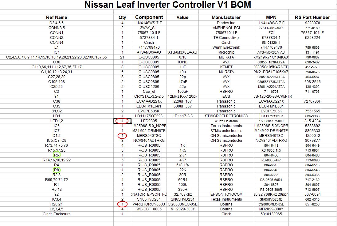

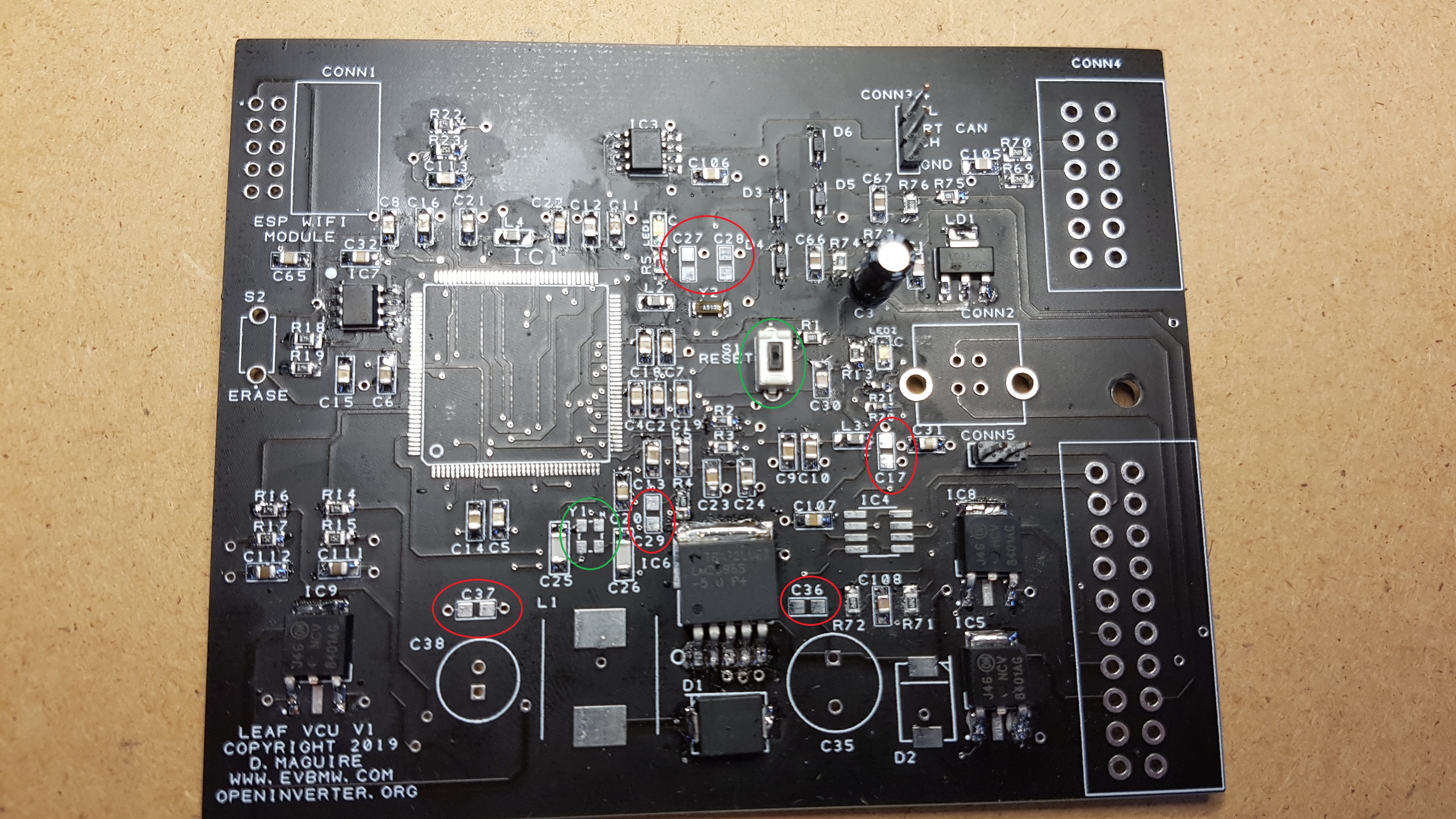

OK, so spent the last two nights piecing Damiens VCU board together and have a couple of questions. You can see right away I have not attempted the chip yet. Waiting on a couple of suitable solder tips before I attempt this. Not the tidiest but waiting to do a bit more before cleaning the board down.
Has anyone worked on this and noticed that on the board that C17, 27, 28, 29, 36, 37 (all circled in red) are missing from the BOM? Also, in the BOM, C38 and C35 are nowhere on the board. Can you shed some light Damien if you are reading this?
The others (circled in green) are just component orientation questions. Do I have S1 the right way with the small gap/arrow pointing to the dot on the board? The other is Y1 crystal. There are 3 square pads, and one with a notch taken out of it. Does the 'notch' align with the 'N' on the board?
Thanks all!

Cookie6000 wrote: Sun Nov 24, 2019 10:16 am OK, so spent the last two nights piecing Damiens VCU board together and have a couple of questions. You can see right away I have not attempted the chip yet. Waiting on a couple of suitable solder tips before I attempt this. Not the tidiest but waiting to do a bit more before cleaning the board down.
Thanks all!
I have updated the BOM to reflect the missing parts. C38 and C35 are most certainly on the board. Look closer:)
The switches are not polarity dependent. Y1 is. Now this is the fun part: some versions of Y1 have the notch in the wrong place so if it doenst talk over usb this is my first port of call. Just flip it 180 degrees. Don't ask me how I know this.

Ah!! Of course... I was leaving C38/35 till later. Brain fart sorry.
Thanks for filling in the blanks on the updated BOM and Y1. I have one or two components that were ordered but cannot find so, small order to be made. Thanks. Hope to have it completed during the week.

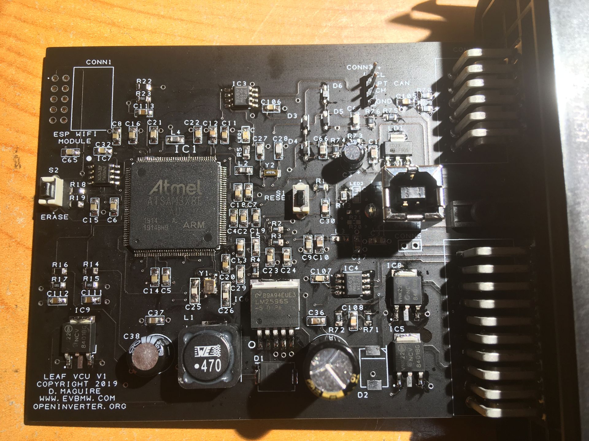

Ho, ho, ho :)
Ok, my board is almost done because of my fault I've missed 3 parts. In BOM are (in red) by 1 pcs, but on pcb are 2. I was looking in quantity column into BOM and now I have to wait until christmas will end :(
Another thing - R6 and R8 (in green), like Cookie6000 wrote are missed in action - will wait, until I will have new glasses.
Below is my board - I hope it will work.
Next days I will start new topic in Projects, where I will start show my progress with BMW E87 with Leaf motor/inverter. I hope it will help other users to go on.
Regards.
